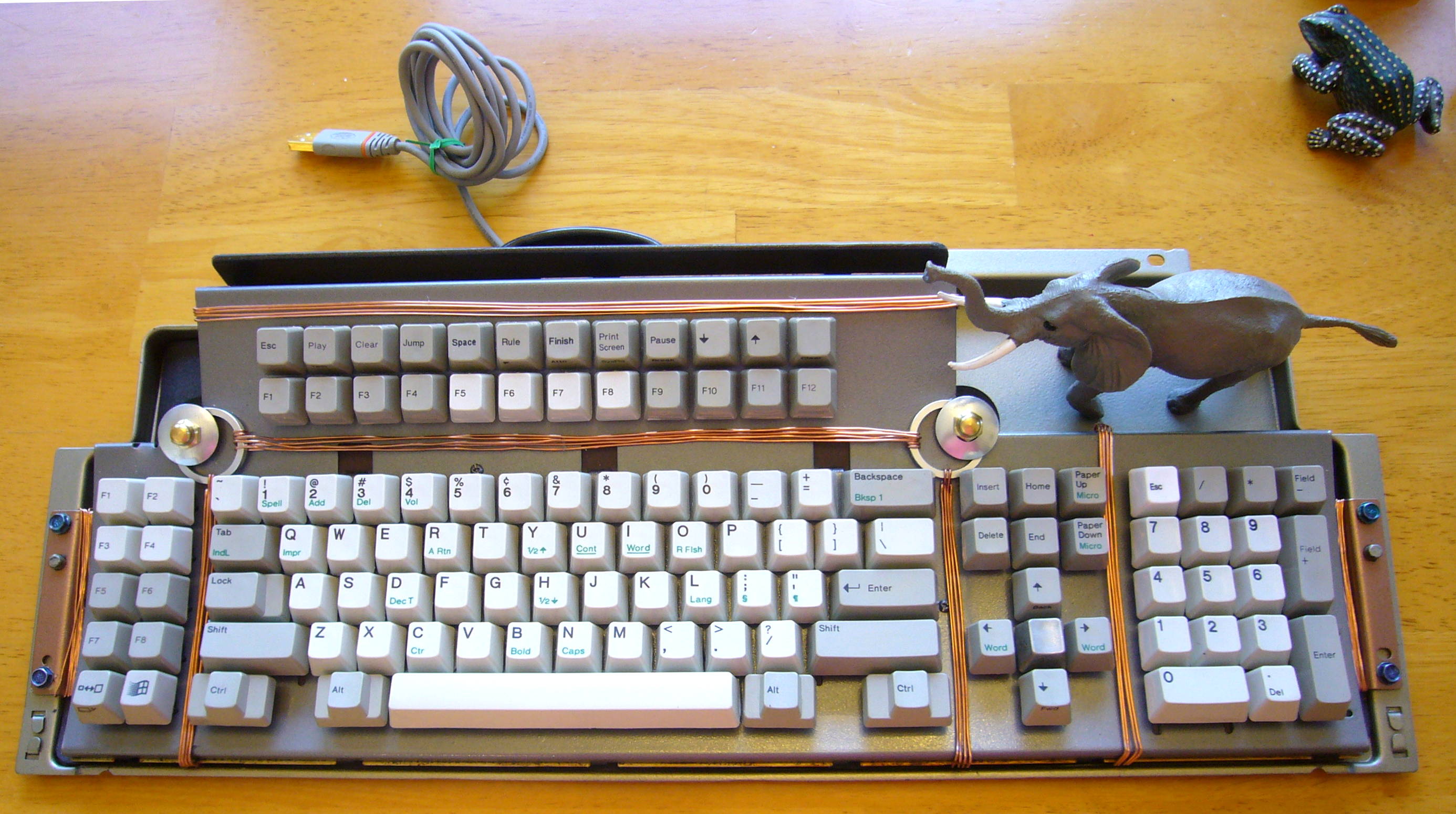

A "real" Model F (122-key, anyway) has a metal bottom pan that the internal assembly screws into, which provides all the base and structure that you need, the top case shell is truly superfluous.
The Model M case is intended as a "sandwich" affair which suspends the internal assembly in the middle. I think that you would need to fabricate some sort of custom case bottom for this to be comfortable and secure.
- F-122-top-copper-elephant-wire.JPG (493.14 KiB) Viewed 7245 times

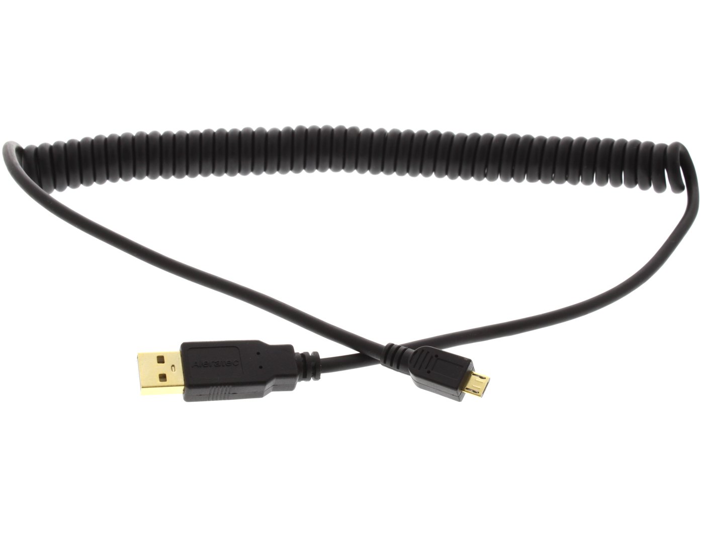

So I was thinking... it would be cool to have a coiled USB cable to match the SDL ones. There are in fact USB coiled cables around, although they're pretty elusive-- especially the longer ones.
The best micro USB coiled cables that I could find are made by Aleratec:
https://www.amazon.com/Aleratec-250343- ... +usb+cable
And the one most will be interested in, the USB B coiled cable from "L-COM Global Connectivity", whoever they are:
http://www.l-com.com/usb-coiled-usb-cab ... ype-b-male

Unique for sure. But 2.5 feet (unstretched) is still fairly abysmal. It probably would be long enough for me, but not long enough for most others. I suppose a USB extender could go on the A connector side to bring it out more-- but then you have a lump in the middle of it. So... the best solution would be to solder on a longer USB A side.This unique cable assembly features a polyurethane jacketed coil cord plus a latching Type A USB connector providing improved mating retention with any USB Type A jack. The latches lock into the channels on each side of a USB jack when fully mated. Retracted length is approximately 2.5 feet expanding up to 12.5 feet. Fully shielded and USB 2.0 compliant, this cable contains two 28 AWG power conductors plus one 28 AWG twisted pair for the data lines. Color is black.

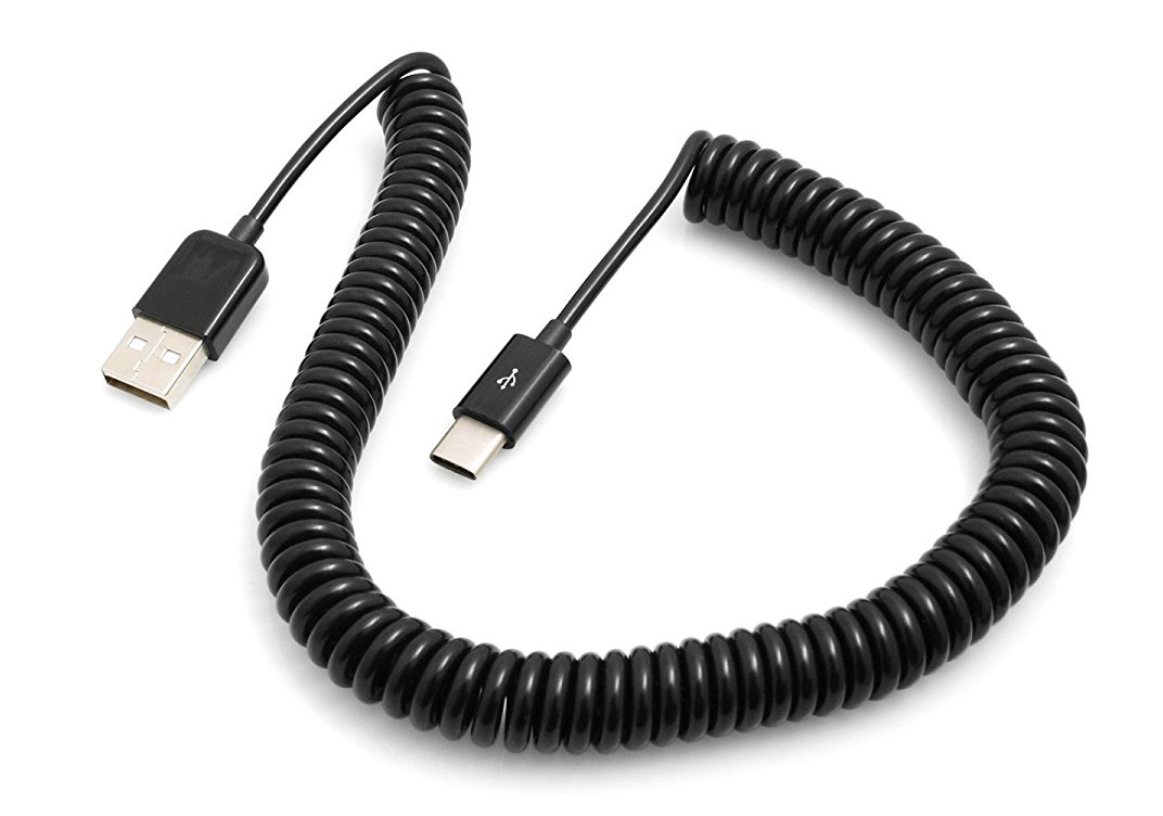

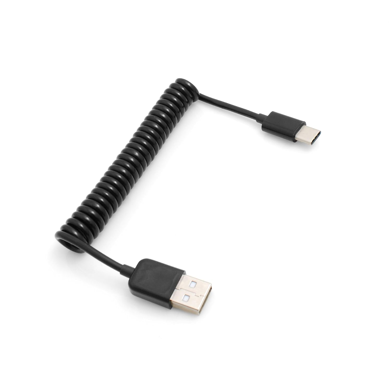

Coiled is indeed nice - found this USB-C on Amazon Germany. It also comes in white.
https://www.amazon.de/gp/product/B01D37 ... UTF8&psc=1

Yes, don't buy this though, it's the most ridiculous thing IRL:
https://www.amazon.de/System-S-Spiralka ... d_cp_107_0
