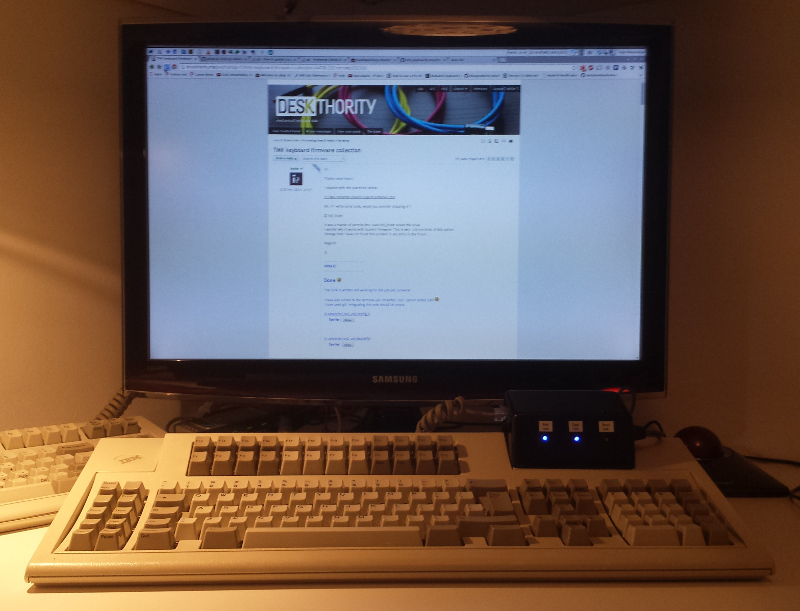

The prove follows
(I am typing with the model m keyboard WITH CAPSLOCK ON)
I also have a model f to try but I need to find the time to put together a new external case like the one you can see in my pictures. It is a different connector.
- tmk_terminal_usb_LEDs_Working.jpg (229.82 KiB) Viewed 15689 times

Hello Hasu,
I have connected a model m 122 and a model f 122 to your terminal_usb controller and it works nicely. This includes my modification to add support to LEDs

Stop
(This is the follow up of my commercial above
