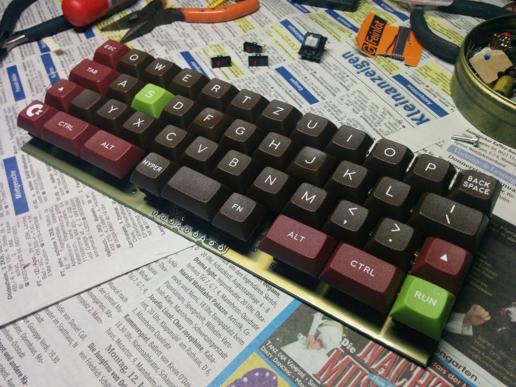

Halvar
12 Jan 2015, 23:12
Typing on my new HyperMicro, that has columns for rows and rows for columns... :D
It's an adorable little keyboard if you ask me ... now I'm excitedly following the case discussions.
Thank you 7bit for the design and my DT voter price, and everyone in this thread for your help, especially matteo for the row/column assignments and the firmware including the "for dummies" tutorial and suka for your answers!
Attached is the firmware folder for the transposed SYM100 layout. The untransposed matrix for SYM100 is also in there (commented out in keymap_common.h and keymap_halvar.c, for use with matteo's config.h/matrix.c).

Halvar
12 Jan 2015, 23:20
I was too lazy to desolder all the diodes and resolder them the other way around, so I just flipped rows vs. columns in the firmware. Now I have 12 rows and 4 columns...
