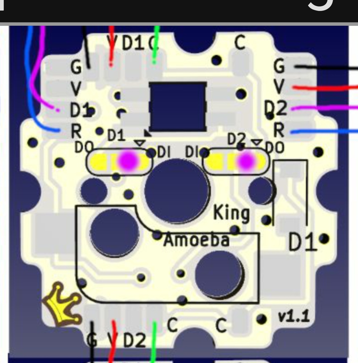

Real_ET wrote: 01 Aug 2021, 23:55 What is the purpose of the solder-jumpers on the amoeba?
I am no expert, but I believe it has to do with the LED matrix. There are 4 pads on the LEDs, so I assume it's to make sure the Data line is going the right direction.
Pink being the Data line in the crude wiring diagram I shared previously.
In at the top, out at the right. Jumper points in the direction out.

Hi, I'm looking to build a keyboard with the King amoebas, but I don't quite understand the wiring/pinout and am slightly afraid of committing as this is the first time I'm building something like this (using amoebas + hopefully using RGB with it as well).
My understanding is that R denotes Switch Row and C denotes Switch Column like usual handwiring, and that only one of the two provided column pins on each side have to be used, but there are a few things I don't understand as I don't know much about PCBs, so I would like to ask the following questions:
1) In the 2x3 ortho board example provided by superami, why are G and V connecting both pcbs in the outermost columns, but the middle column doesn't have that?
2) I'm guessing that D1 and D2 are for data in and data out? (Please correct me if I'm wrong.) If I were to connect a third row to this, do I do D2 to D2 on the left column or the right column?
3) Does the closed off end of the diode silkscreen mark the cathode or the anode? (I'm guessing it's the cathode because of the line on the diode, but I could be very wrong.)
4) What are the pads marked in yellow and purple in the wiring diagram for, and do I have to do anything about it?

StarlitUniverse wrote: 21 Jan 2022, 16:04 Hi, I'm looking to build a keyboard with the King amoebas, but I don't quite understand the wiring/pinout and am slightly afraid of committing as this is the first time I'm building something like this (using amoebas + hopefully using RGB with it as well).

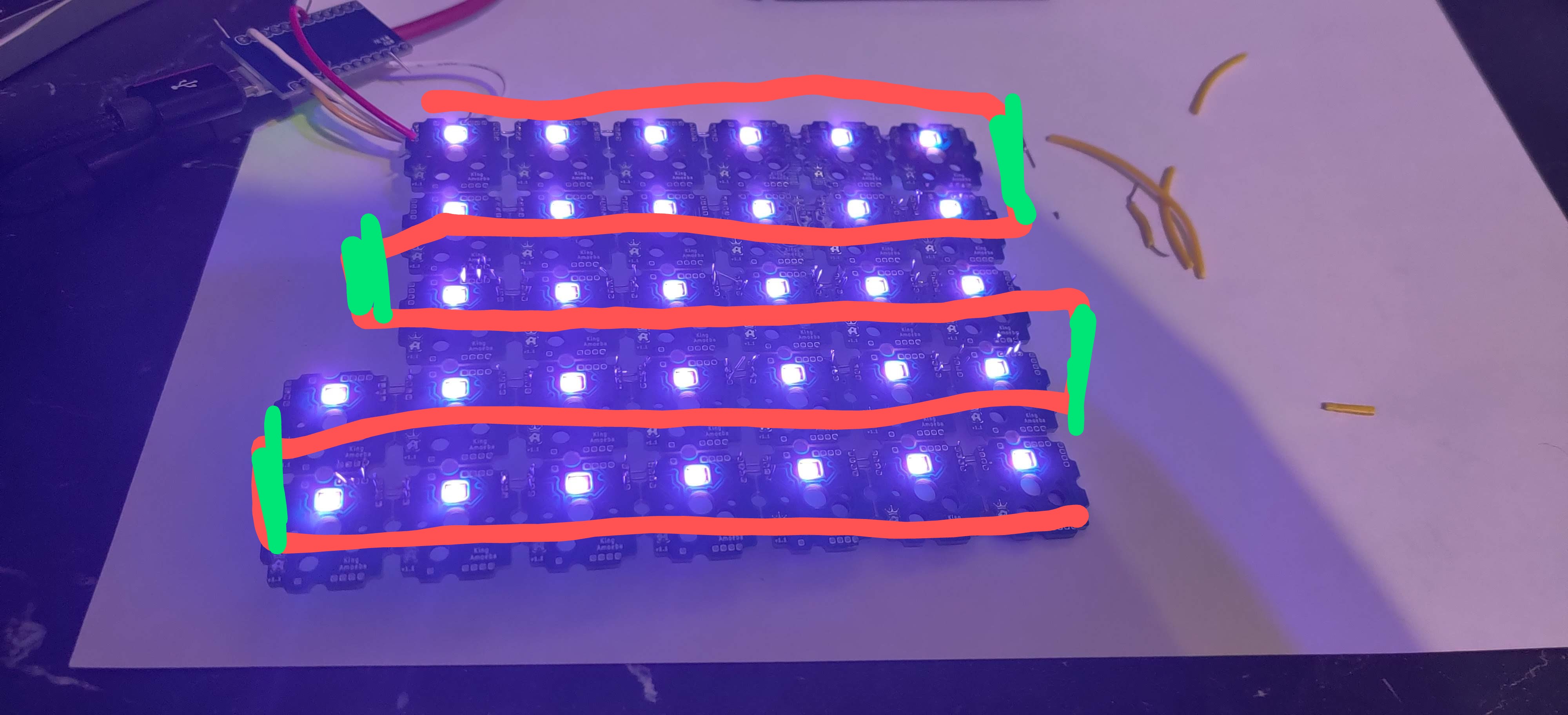

I like to think of the keyswitches as a separate circuit as the RGB. G, V, and D are all part of the LED lighting.
The G and V and D lines only need to snake(or alternate) around the keyboard, like so:
StarlitUniverse wrote: 21 Jan 2022, 16:04 2) I'm guessing that D1 and D2 are for data in and data out? (Please correct me if I'm wrong.) If I were to connect a third row to this, do I do D2 to D2 on the left column or the right column?
Basically, the solder pads indicates the direction of the data. Data goes from your microcontroller, into the D1 port, (then stops at the first set of solder pads.) You bridge D1 and Di to mean Line D1 is the Data-in line. Next you bridge middle and right-most pad on the right set of pads to mean D2 is the Data-Out. Hope that makes sense. So you would just make sure whichever pad you connect it to, is following the same data-line direction.

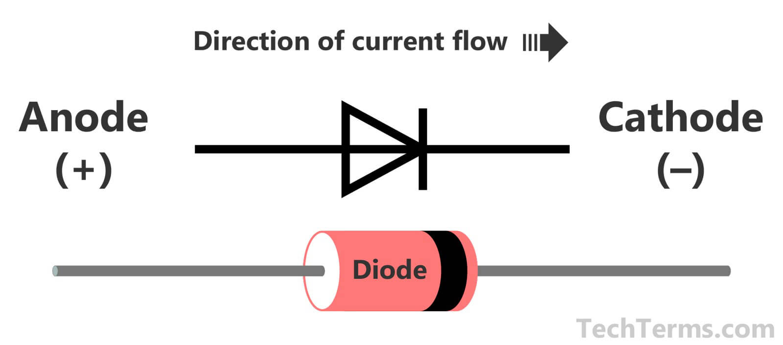

StarlitUniverse wrote: 21 Jan 2022, 16:04 3) Does the closed off end of the diode silkscreen mark the cathode or the anode? (I'm guessing it's the cathode because of the line on the diode, but I could be very wrong.)
Cathode is correct.
Here are a couple pics I thought might help:
StarlitUniverse wrote: 21 Jan 2022, 16:04 4) What are the pads marked in yellow and purple in the wiring diagram for, and do I have to do anything about it?
Thank you all for your time and patience!
I believe this was answered in question 2. Let me know if you have any other questions.

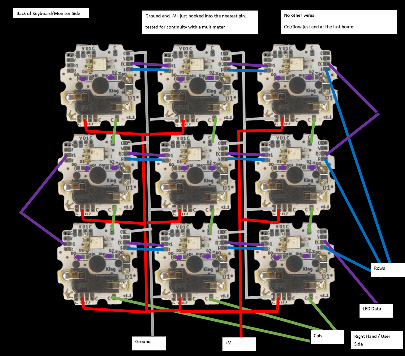

I wired the right half of the keyboard and set it as the master in the firmware in QMK. I'm doing some testing but I can't get any keys to register. I'm trying to figure out if its a software or wiriing issue or how to better debug other than checking all the traces with a multimeter.
The pro-micro shows up in device manager but just won't type any keys. Does anything on my attached sample wire diagram look wrong? I Joined the G and V lines for simplicity. The Row and Columns on the ends don't need to connect to anything right?
Maybe it won't work without the left controller hooked in? I am hoping to get one side working before starting the other.
Thank you for the help! :D
