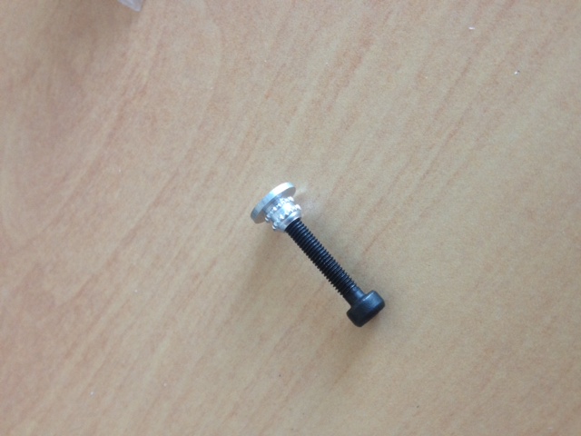

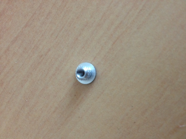

Found something interesting in RC parts store and bought some for my custom keyboard:
photo 1.JPG (88.64 KiB) Viewed 6184 times
photo 2.JPG (86.13 KiB) Viewed 6184 times
This is a M3 nut, the height of the nut is 4mm and the exterior diameter is 4mm, this type on nuts can be inserted in the bottom plate and should give a nice flush look, no more nasty hex nuts. These are made from aluminum and work great on wood, and in theory should work nice also in acrylic. I will make some tests on an acrylic plate I have.

it would be great if they could be found in M2.5. Can you take a picture of the head?

Hope this is what you wanted to see:
photo 3.JPG (73.49 KiB) Viewed 6174 times
This type of screws/bolts come also in the M2.5 flavour the exact size is M2.5x27.6 mm but only half of the bolt has a thread:
The nut is actually a wood nut, and they have it also in M2.5 and M2 flavors. And I liked this design better than the classic one with retaining claws like this:
Posted: 12 Jun 2014, 11:32
by matt3o
sorry, I wasn't clear. I mean the nut head, not the screw head. I'll post pictures of the wood nuts later, they are really nice.

I made some photos of the nut, hope are clear enough:
Posted: 12 Jun 2014, 12:04
by matt3o
oh, they are holed. I kinda wished they where flat
Posted: 12 Jun 2014, 12:17
by DanielT
That would have been perfect, a flat bottom would give a clean riveted look, but I'm happy I found even this, here I don't find easy stuff like that :(
