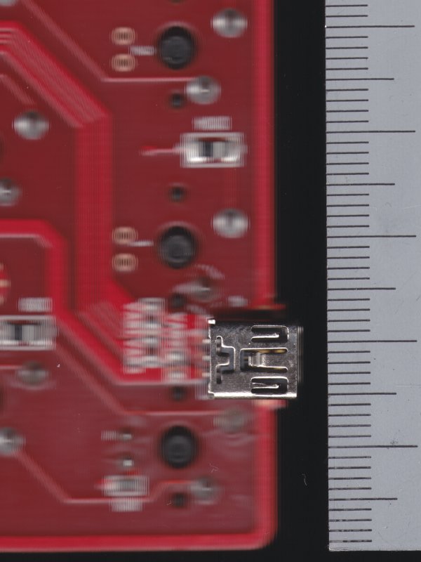

11 Aug 2012, 08:48
This is the best I've got on the USB connector. Those are millimetres to the right.
