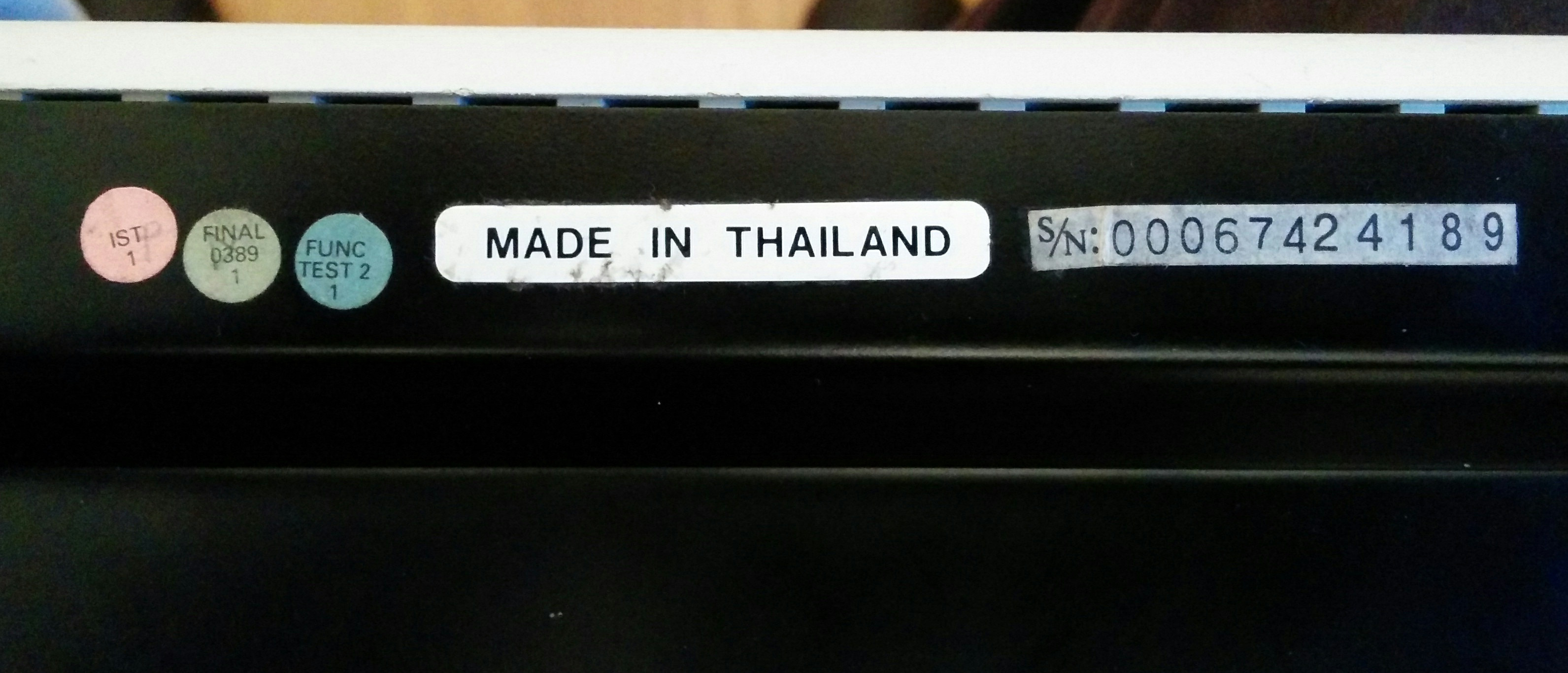

Someone managed to date mine to December of '85 - as it was made in Thailand, was that after NMB had acquired Hi-Tek then? It seems to really be a borderline case because there are no NMB markings on it at all.

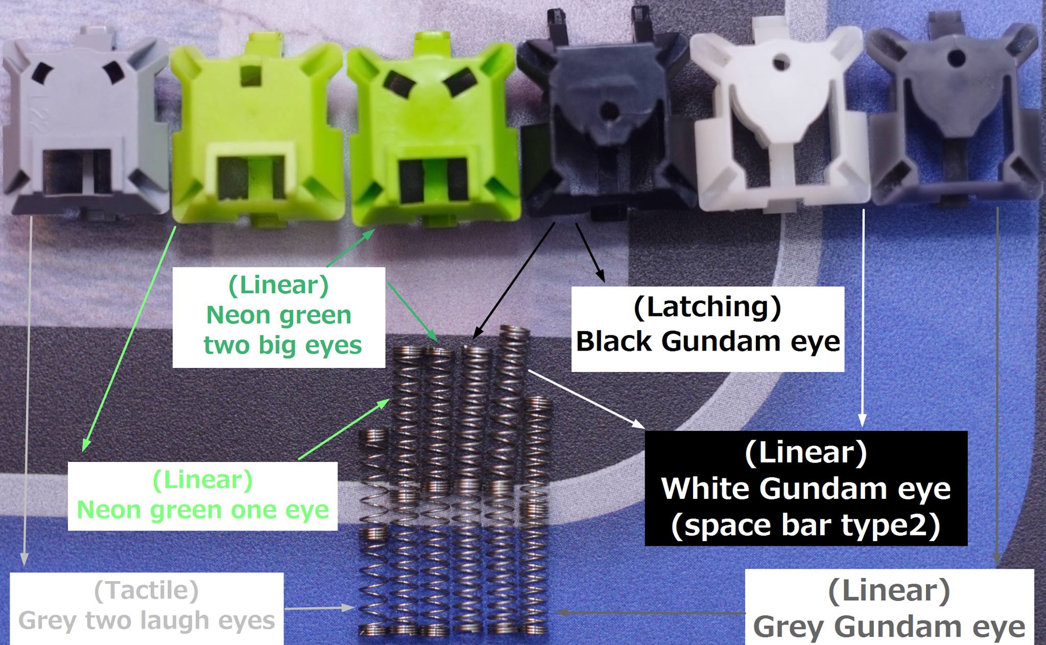

I'm counting like 13 variants for tactile/clicky switches alone if my maths are correct, and it could well be that the list isn't complete.
- Chyros
- Location: The Netherlands
The clicky switches aren't based off the tactile design though, they're modified linears.tactica wrote:Hello D'Milo,
According to our current wiki entry
http://deskthority.net/wiki/NMB_Hi-Tek
I wonder if the tactile and clicky designs originated from when Hi-Tek was not under NMB yet. Of course, the real jackpot would be knowing how the colour coding for the switches worked
I wish these Space Invaders were still being made, they're pretty cool switches

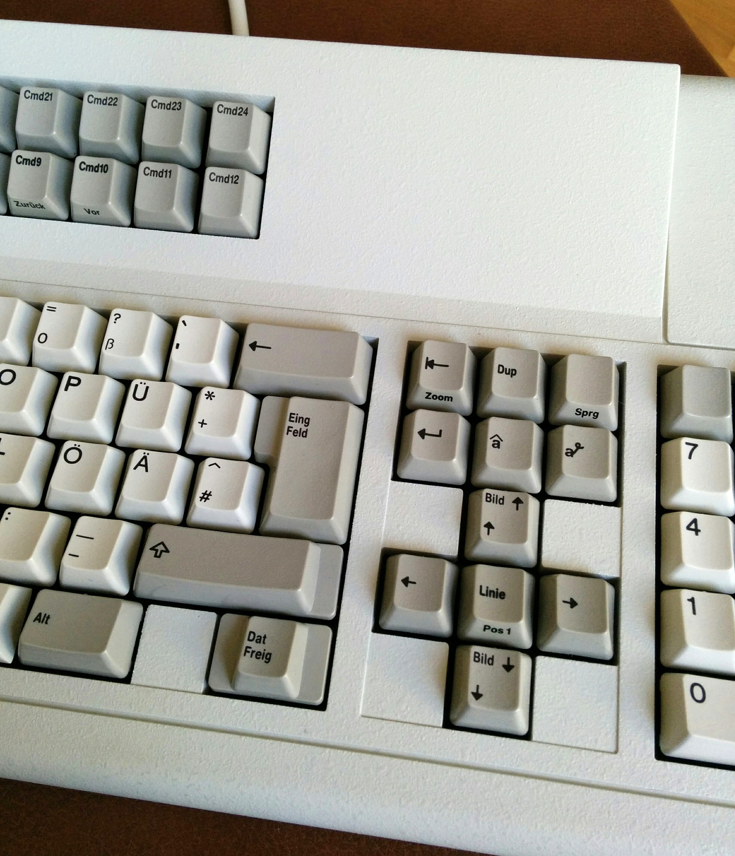

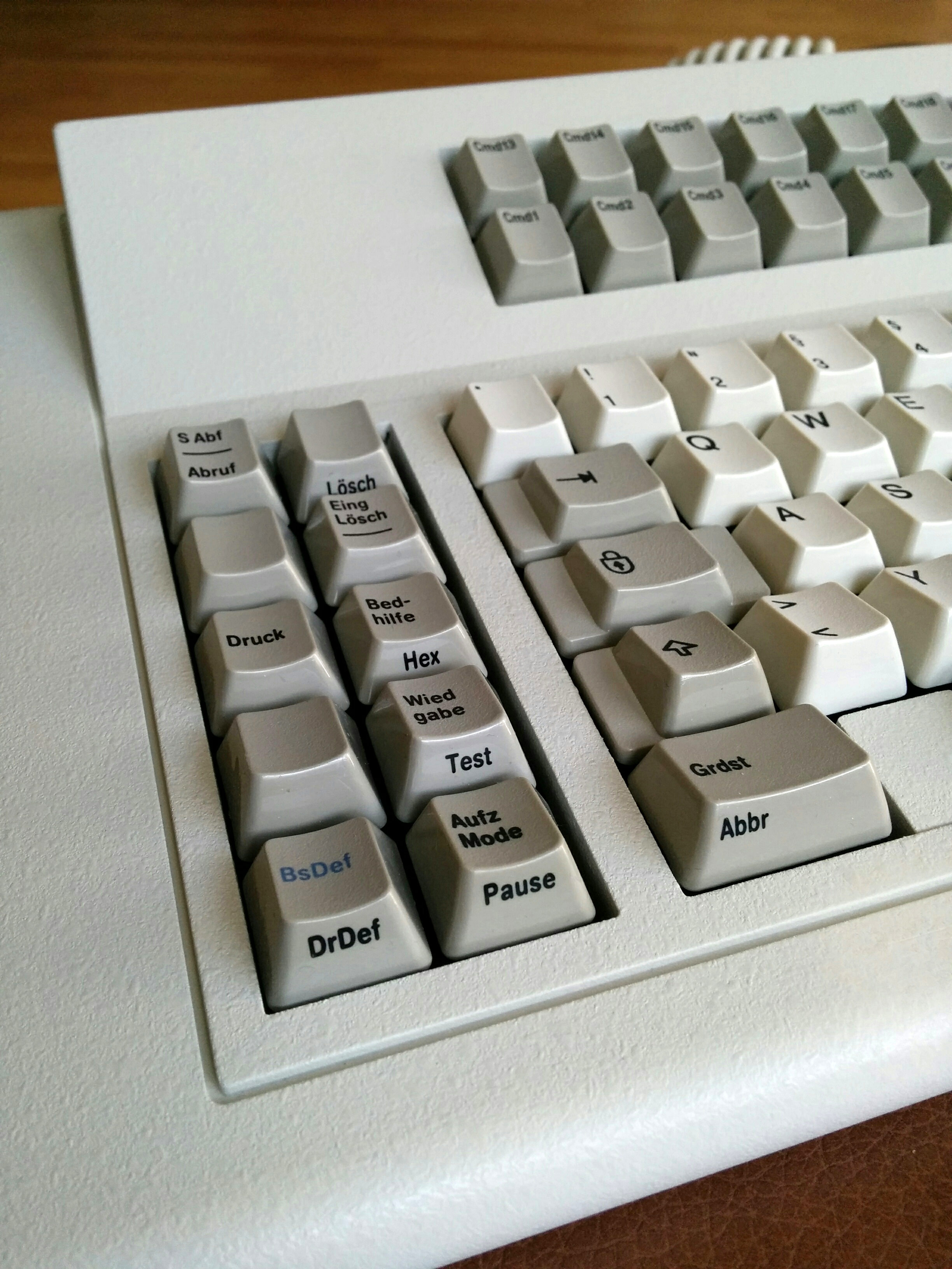

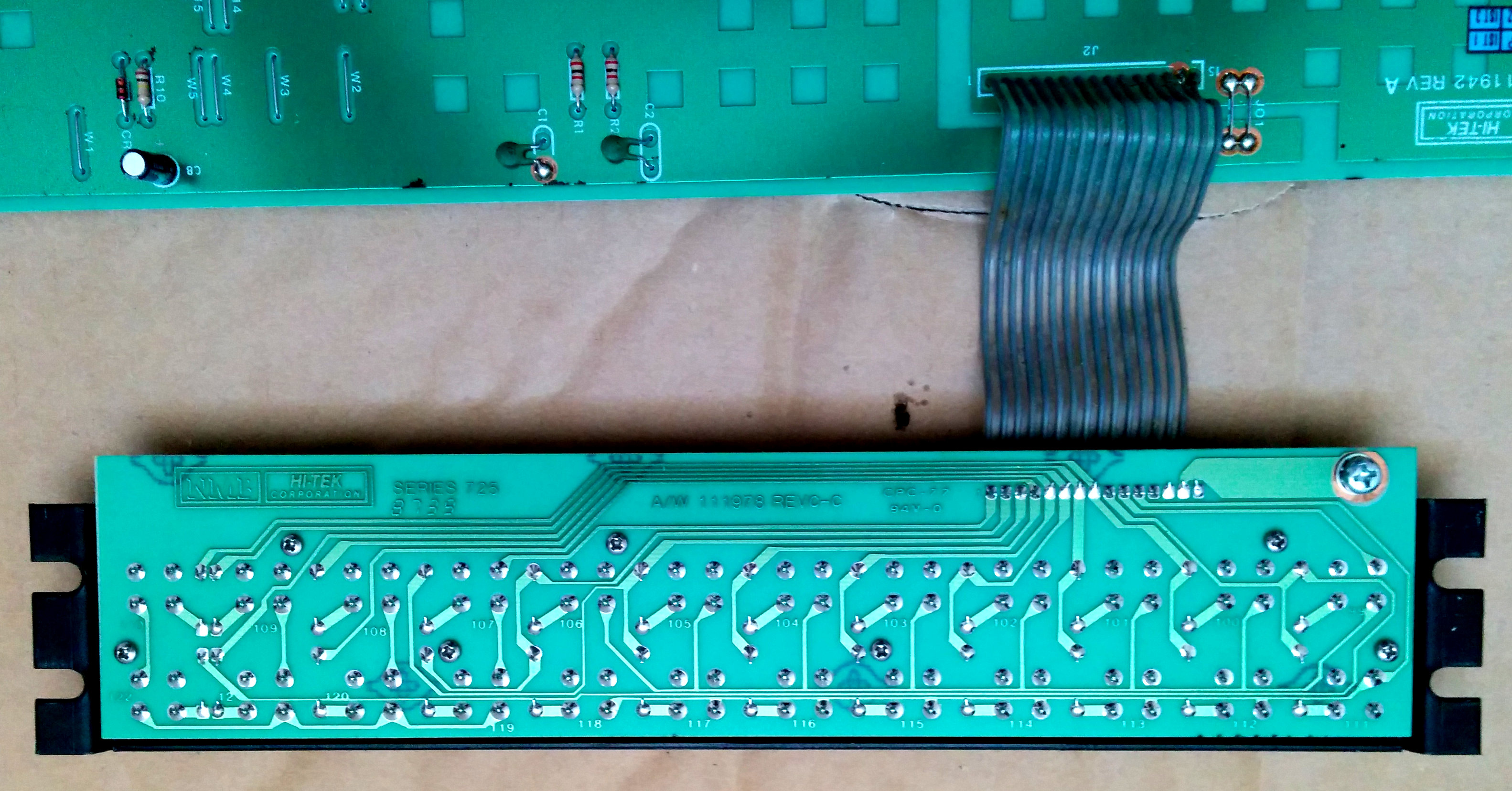

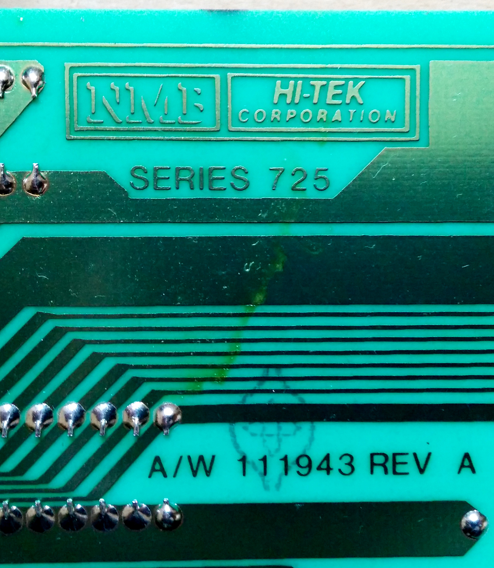

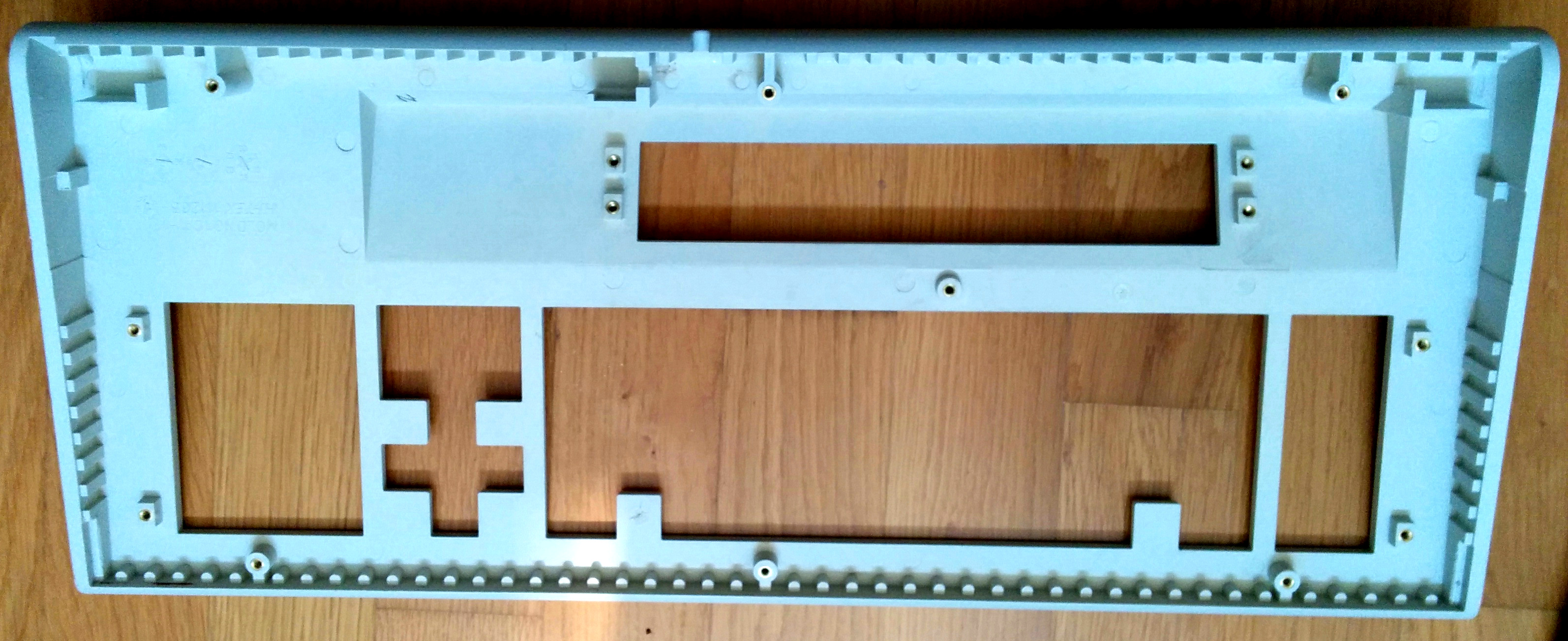

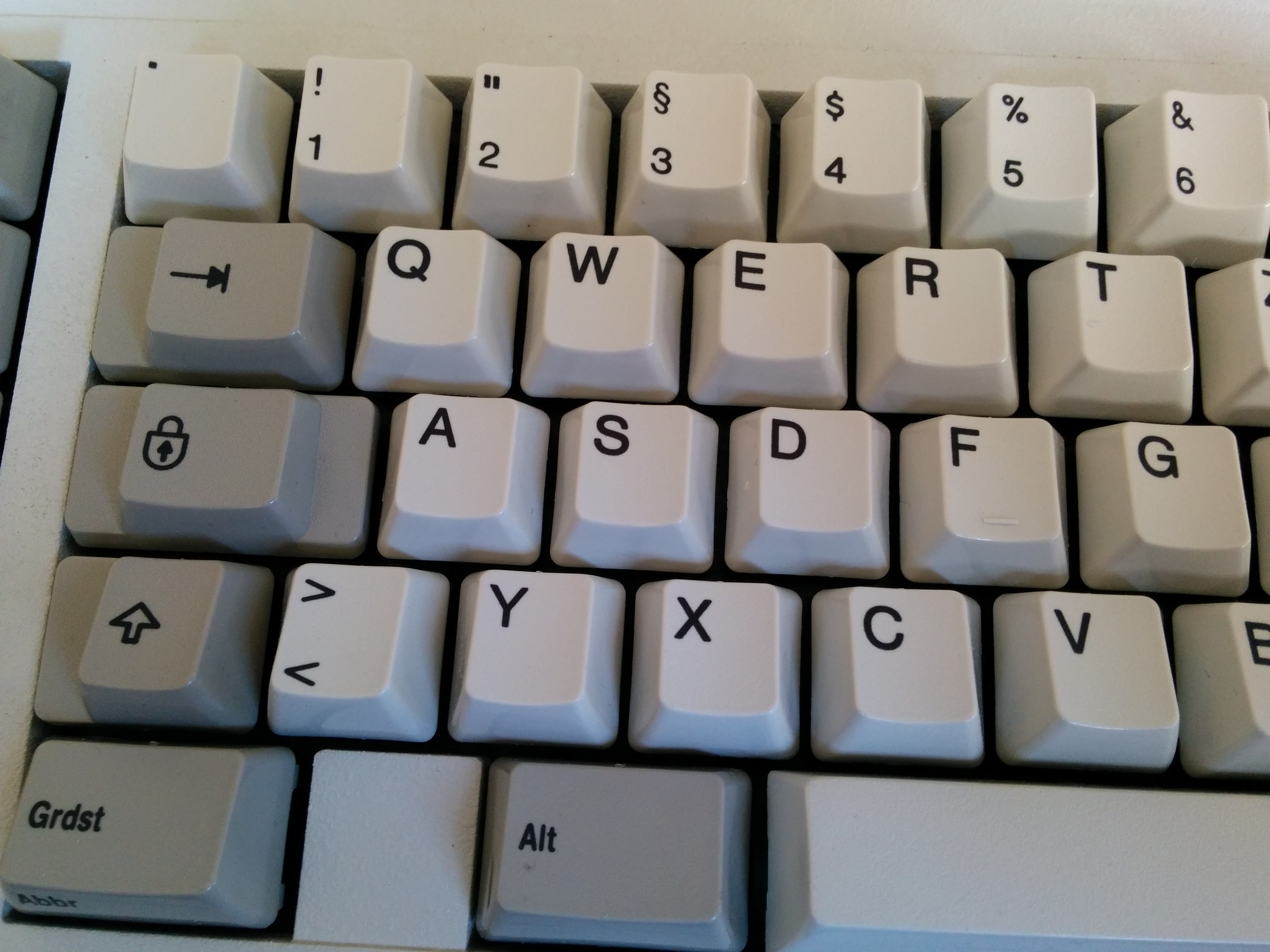

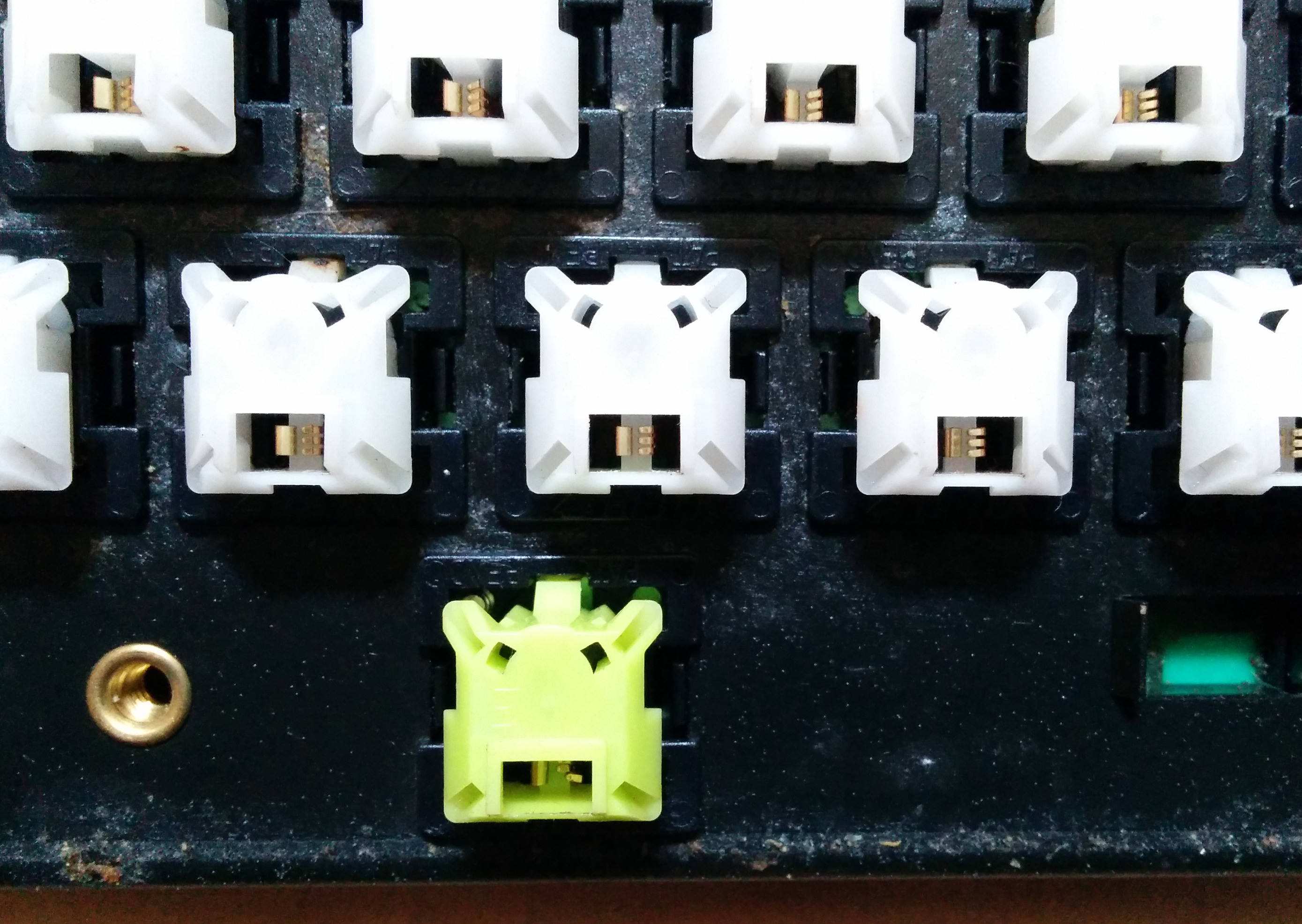

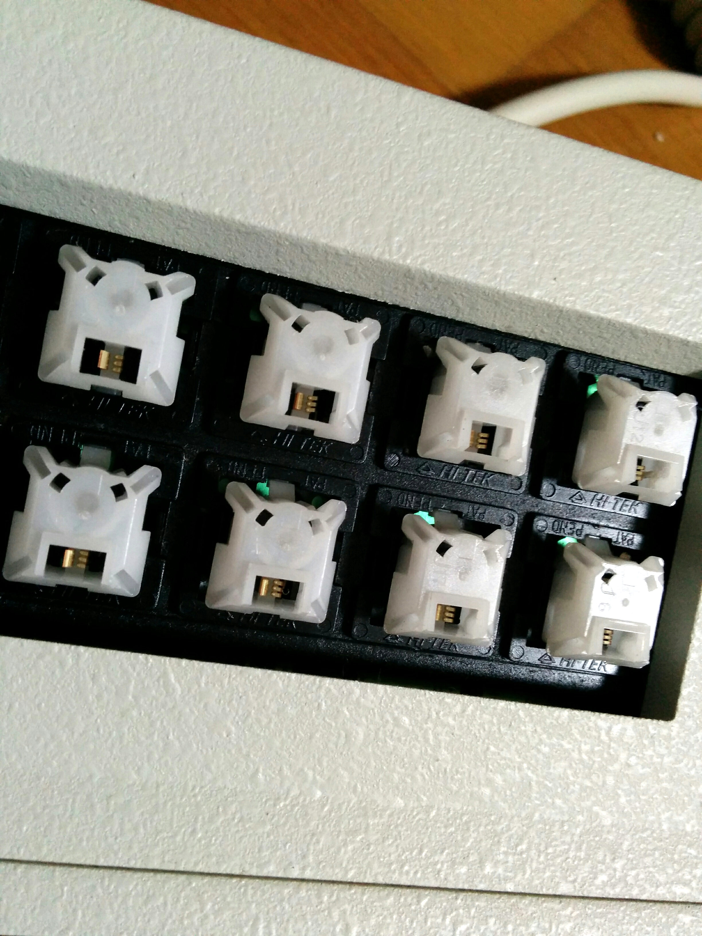

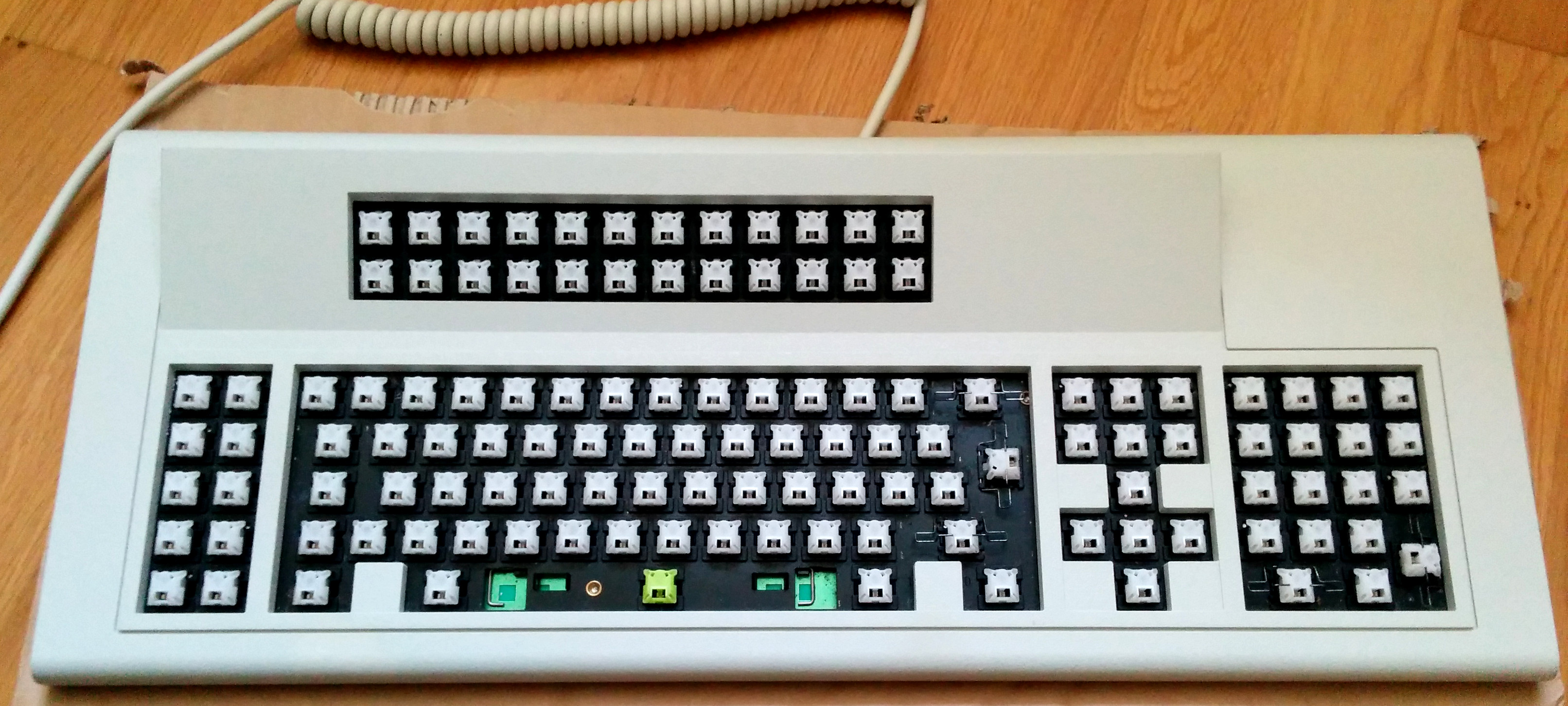

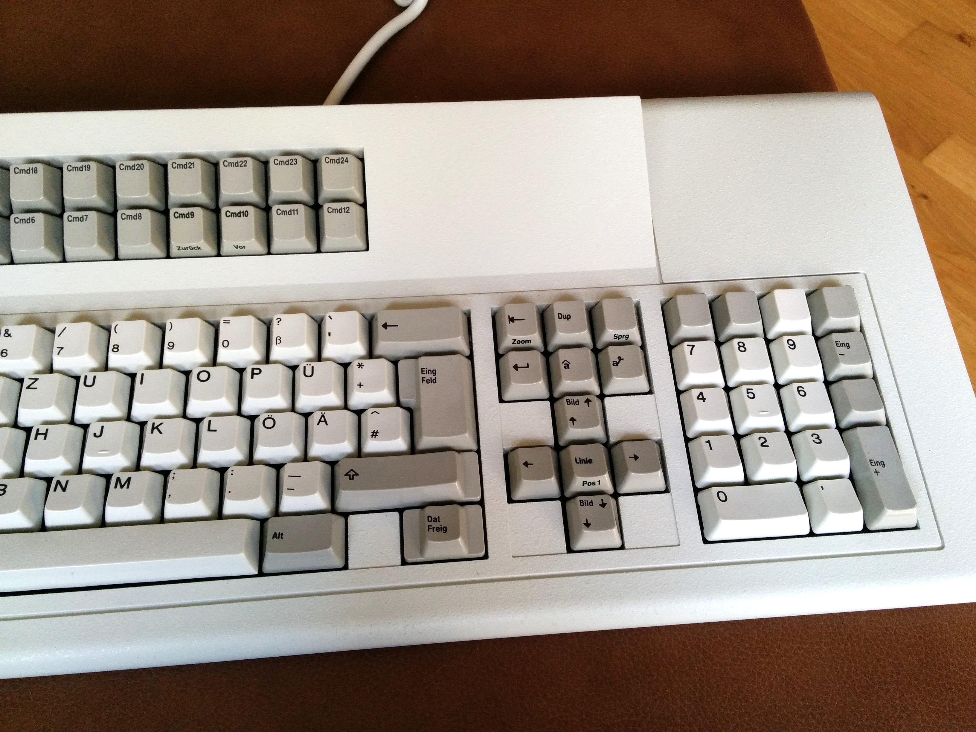

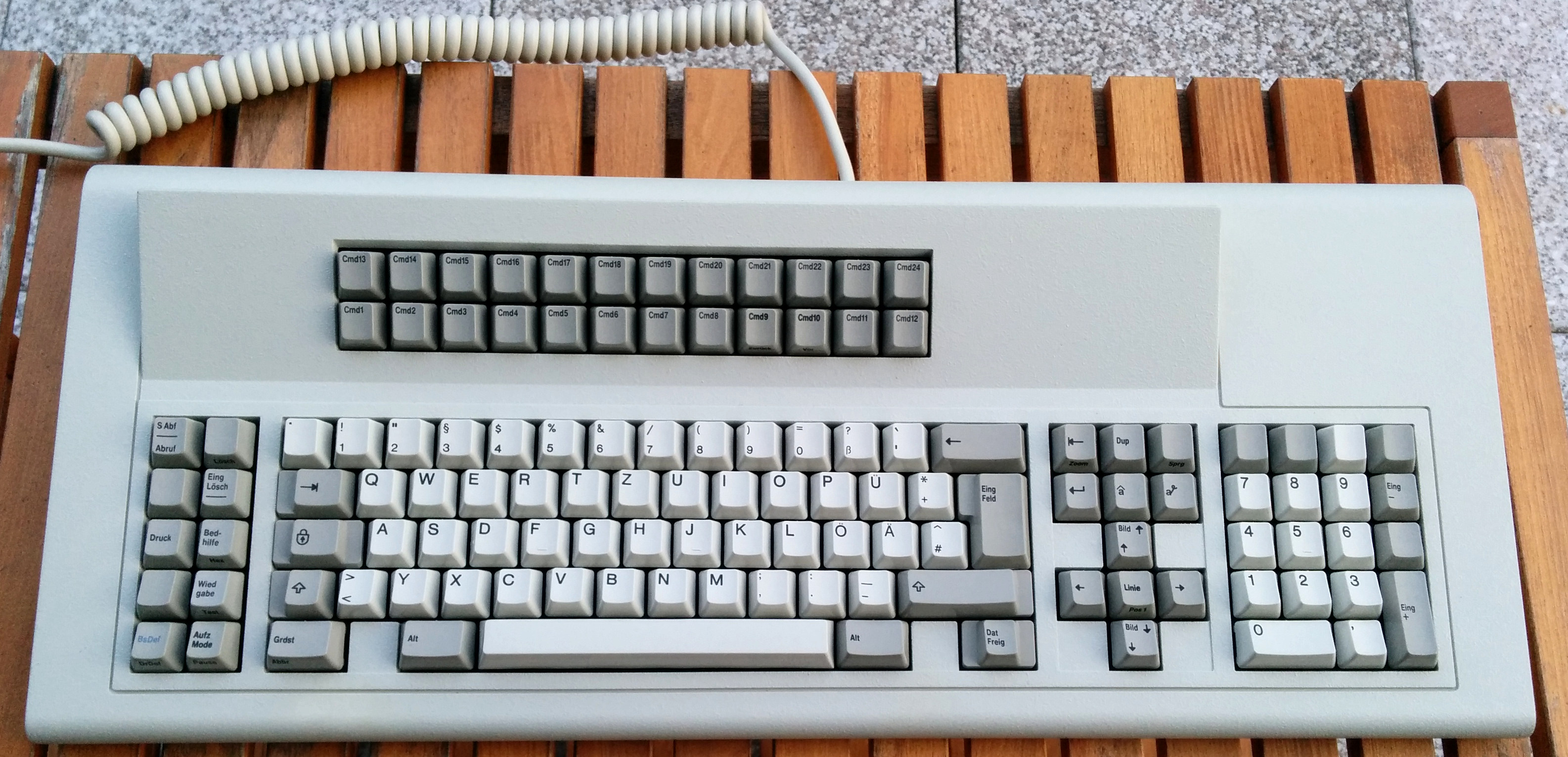

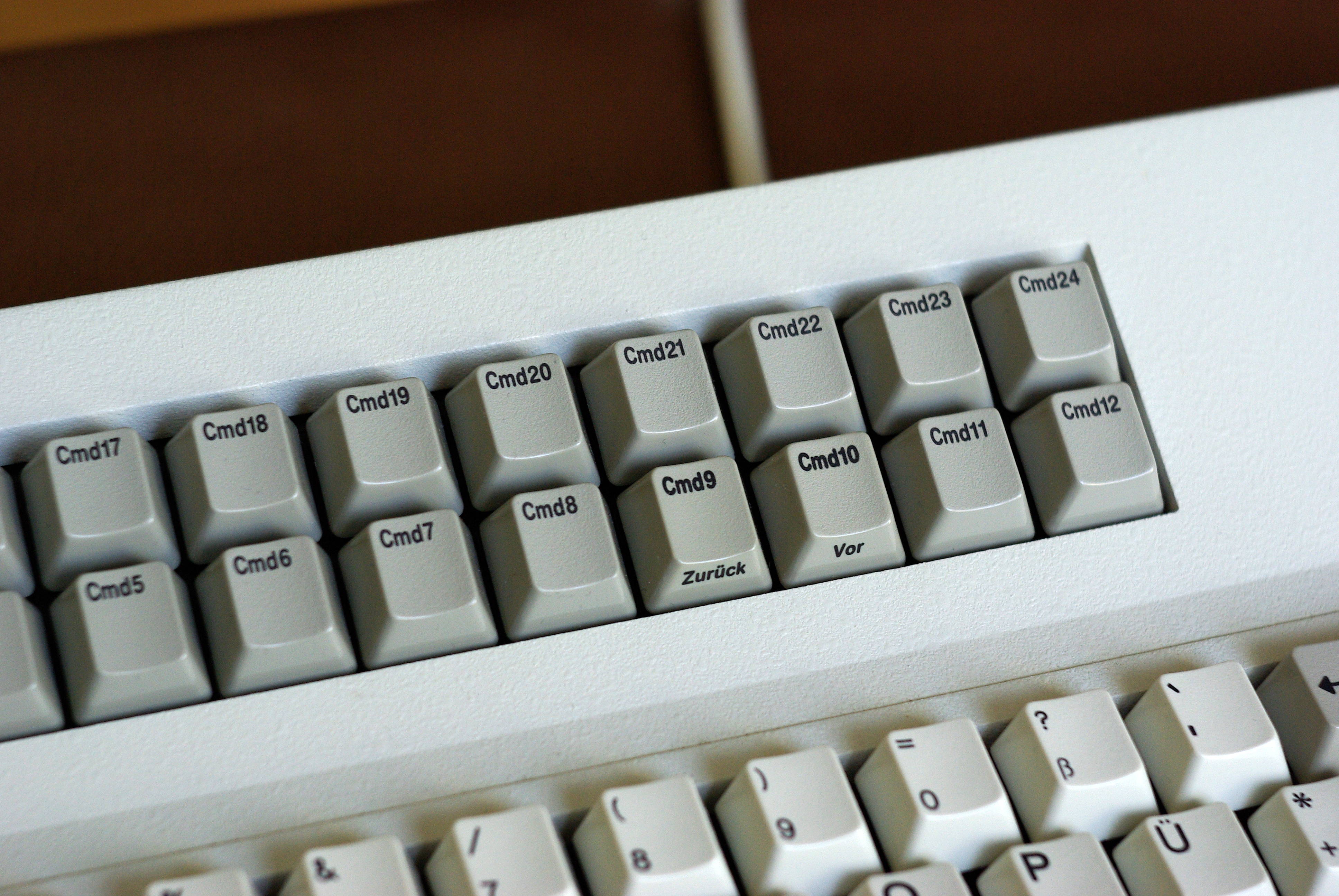

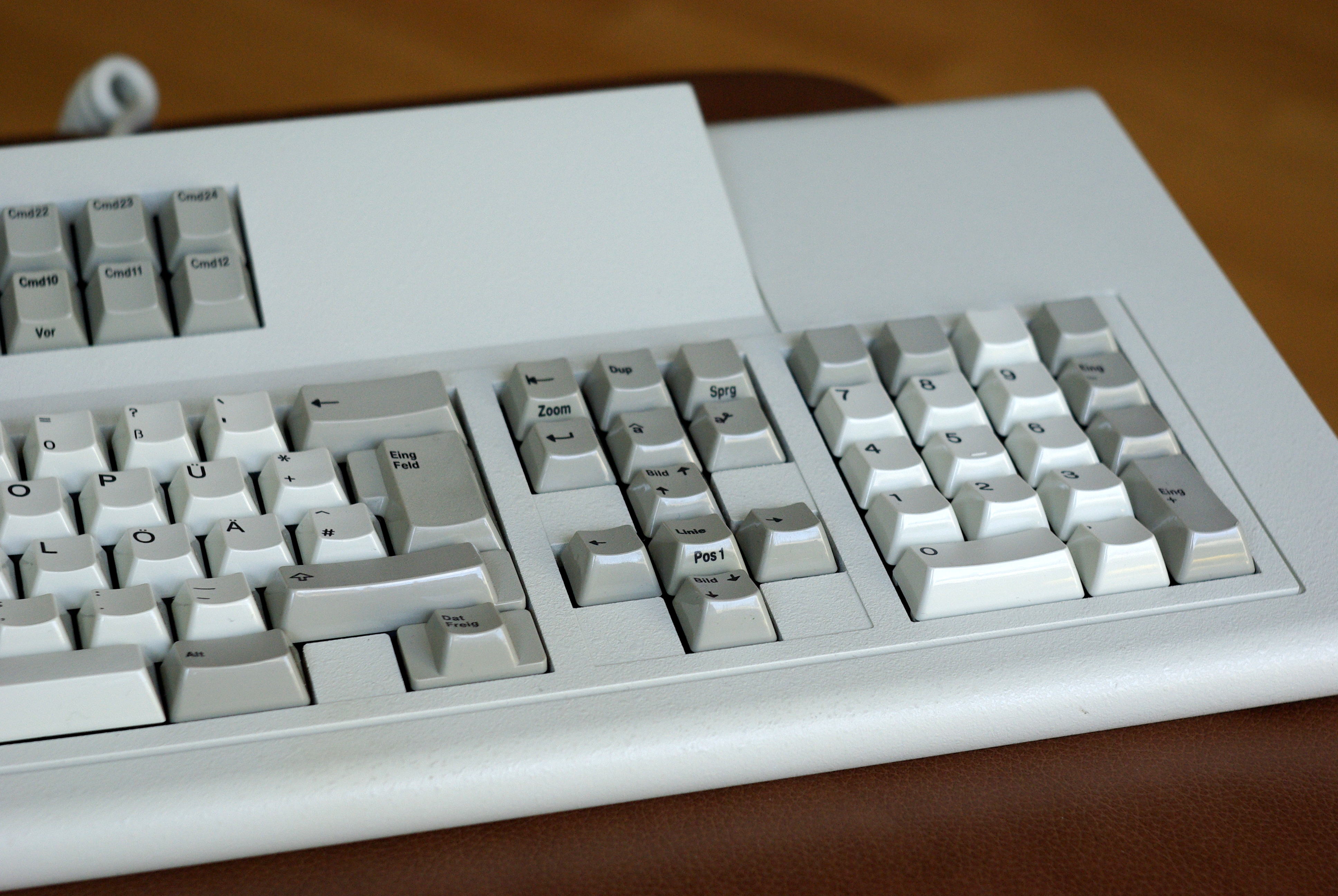

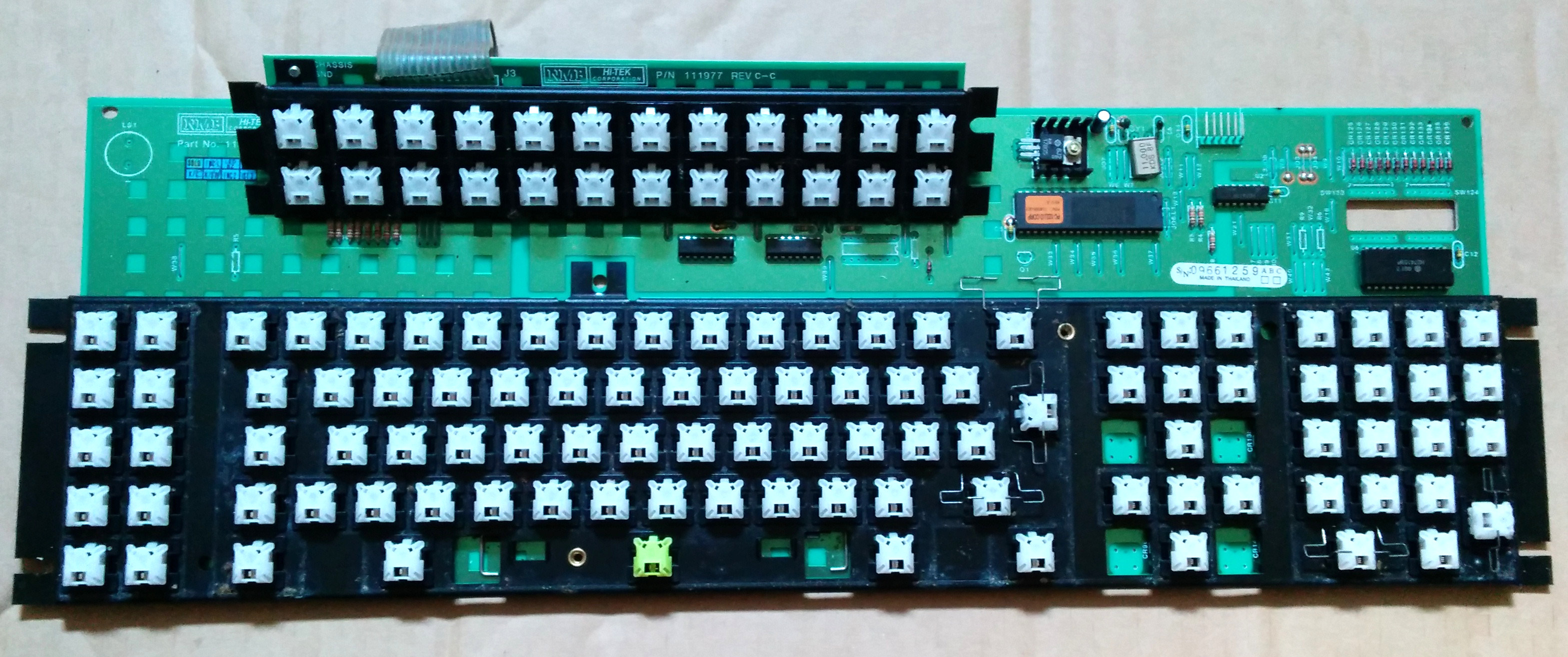

I'll continue here instead of opening a new thread on the same subject:
NMB HI-TEK Series 725 122-key
This one is in very good condition. It's almost impossible to convey the build quality of this keyboard through the pictures, I am a big fan of IBM Model F and M,in this case it might be arguable that this keyboard is sturdier and better build quality than an IBM M-122. Like all the space invaders I have tried, very smooth and consistent across the board unlike the Omron B3G series for example.
This keyboard uses white linear two-small-eyed NMB-HI-TEK "space invaders" Series 725 and a neon-green two-small-eyed heavier weighted linear switch for the spacebar similair to what appears in terrycherry's recent elaborate Hi-Tek 725 series post:
photos-f62/i-throught-it-s-hi-tek-725-s ... 13595.html

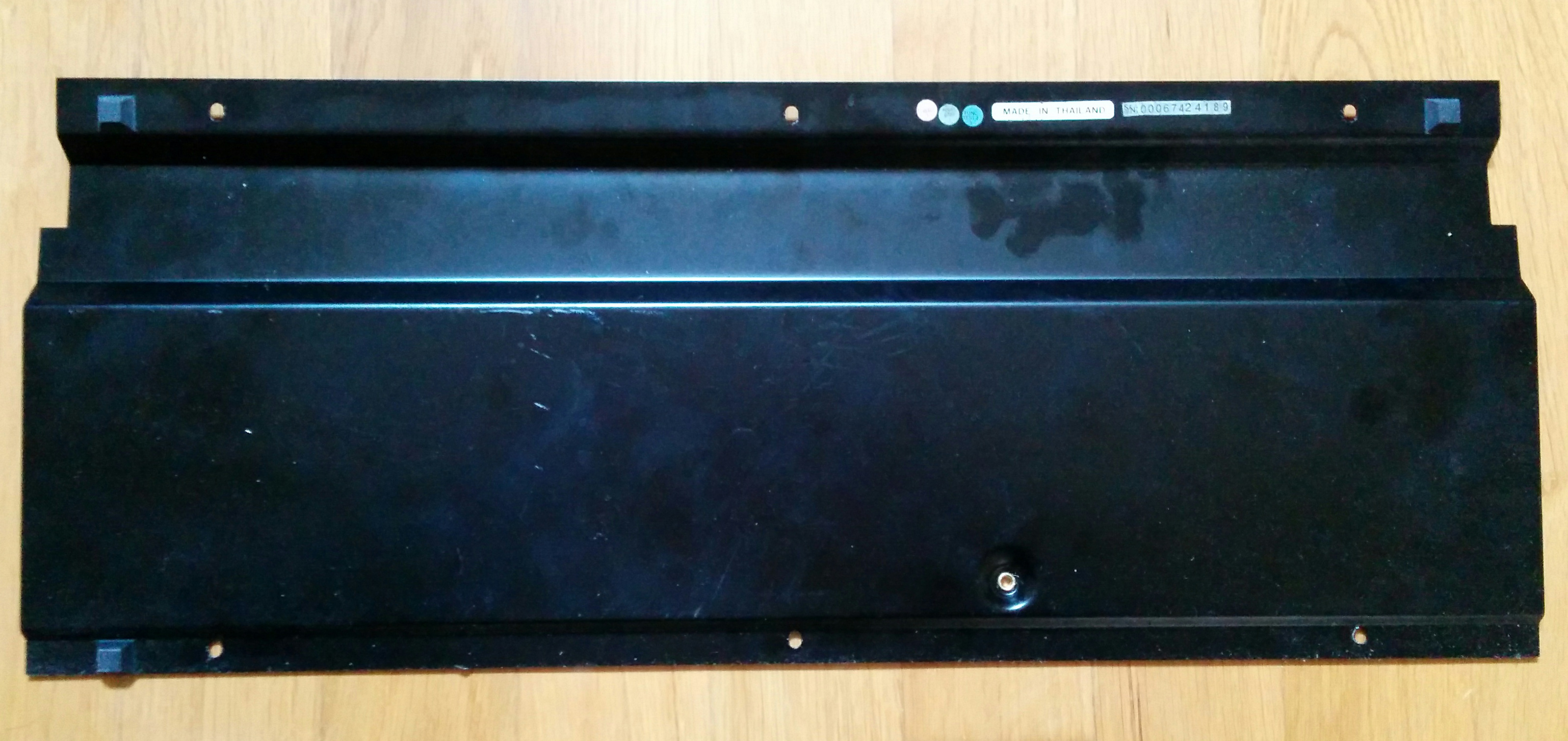

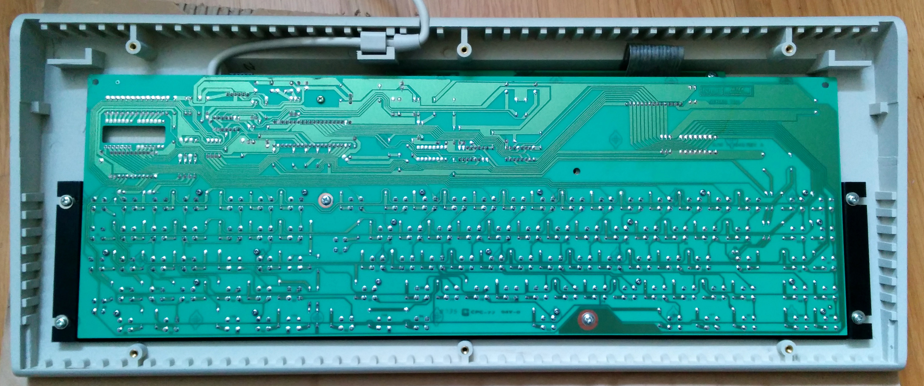

The space invaders are PCB mounted, this keyboard has a very sturdy metal backplate.

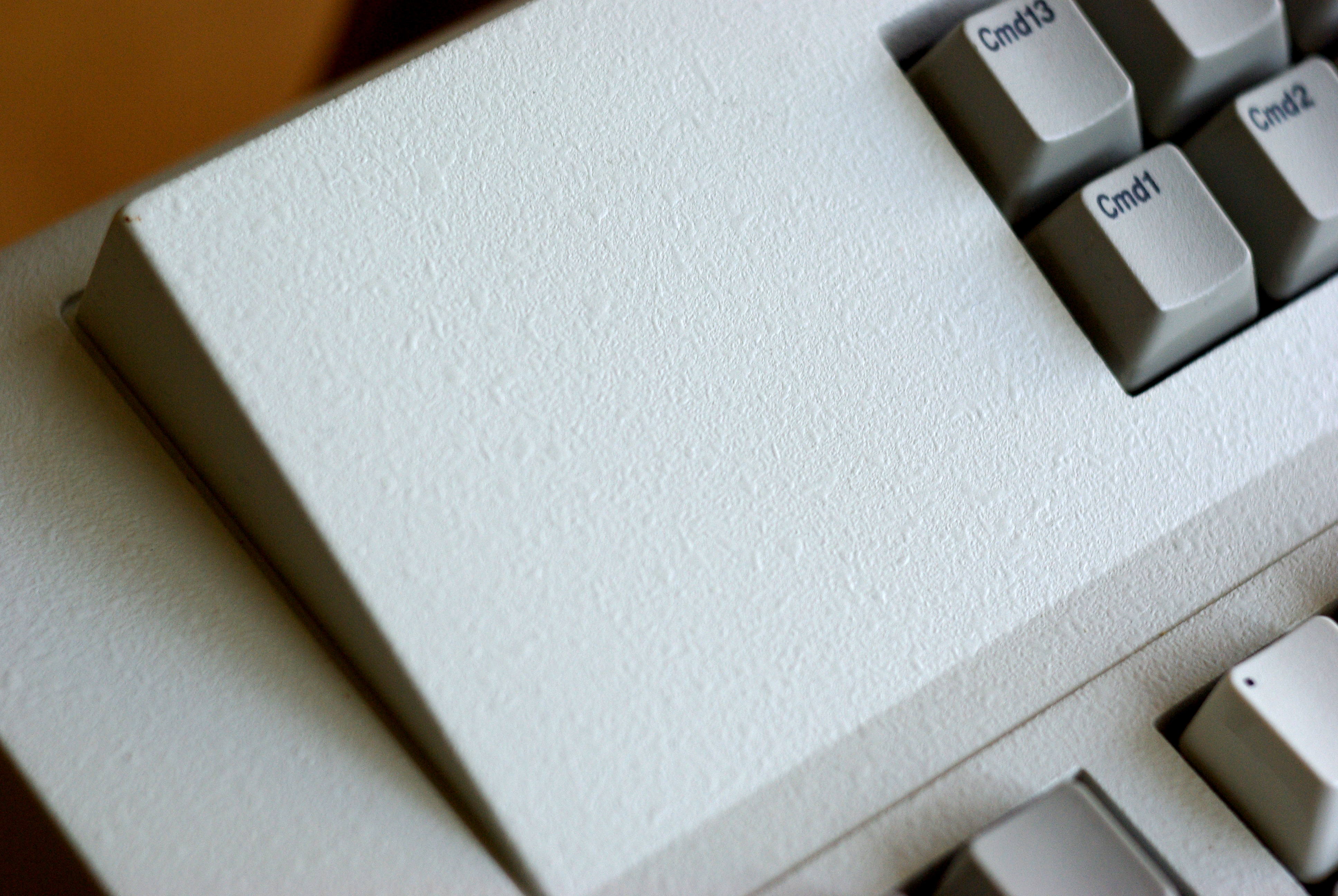

The case has a very nice texture to it.

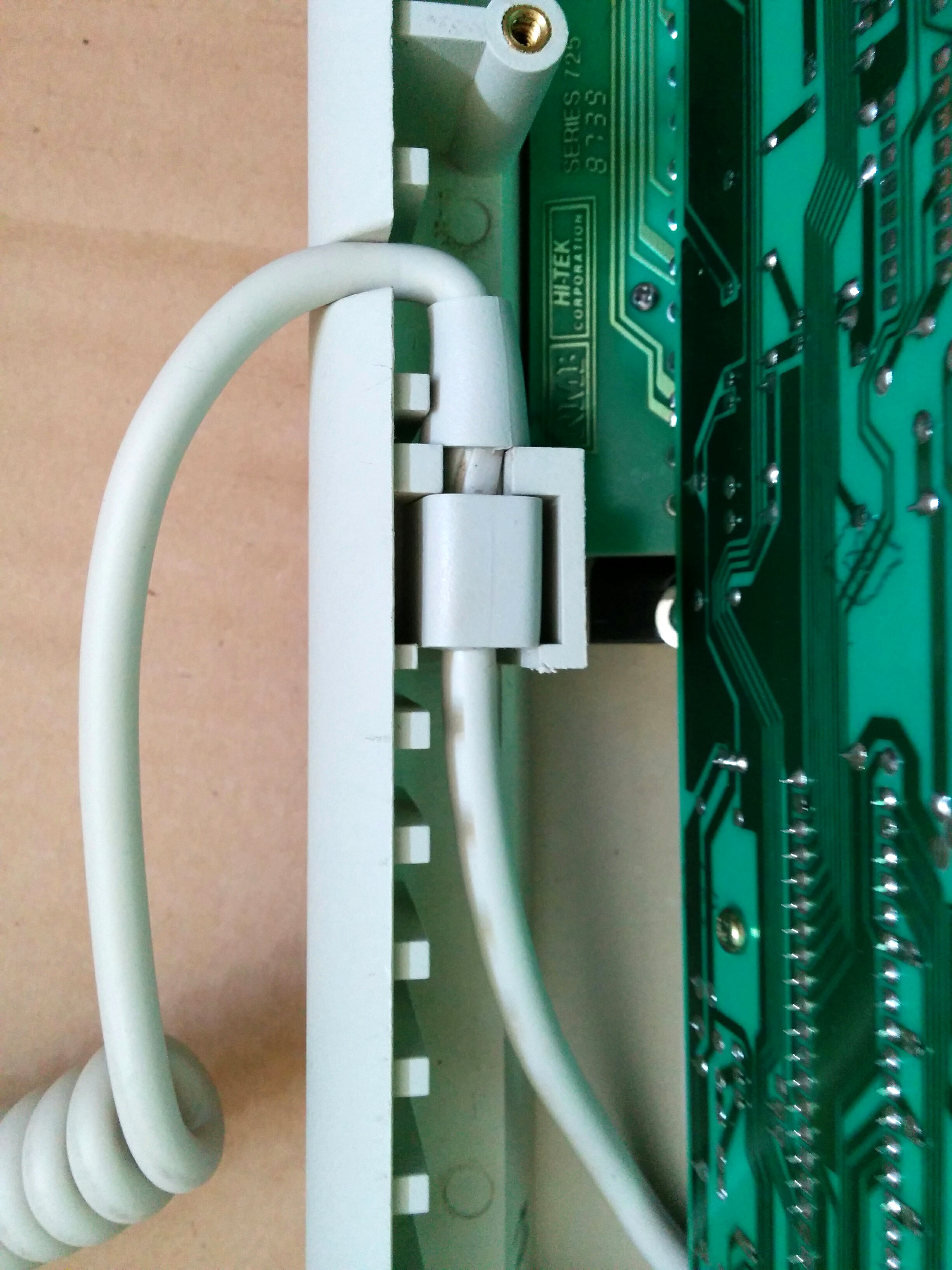

The solution to holding the calbe in place inside the case is the best I have ever seen.
It's a shame NMB-HI-TEK keyboards are not more common, anyhing nearly like this is awesome.
Chyros Tandon branded HI-TEK Series 725 keyboard which is a more compact XT style keyboard that predates mine has certain elements like the flip-feet, the inside of the case amd the shape of the metal backplate look identical to mine. Notice how Chyros PCB only reads "HI-TEK" while mine reads "NMB HI-TEK", both were manufactured in Thailand during that Minebea / Hi-Tek transition period.
Weight: 2810g
Dimensions:
55,5cm wide
22,5cm deep
2cm tall at front
5,5cm tall at top of function rows

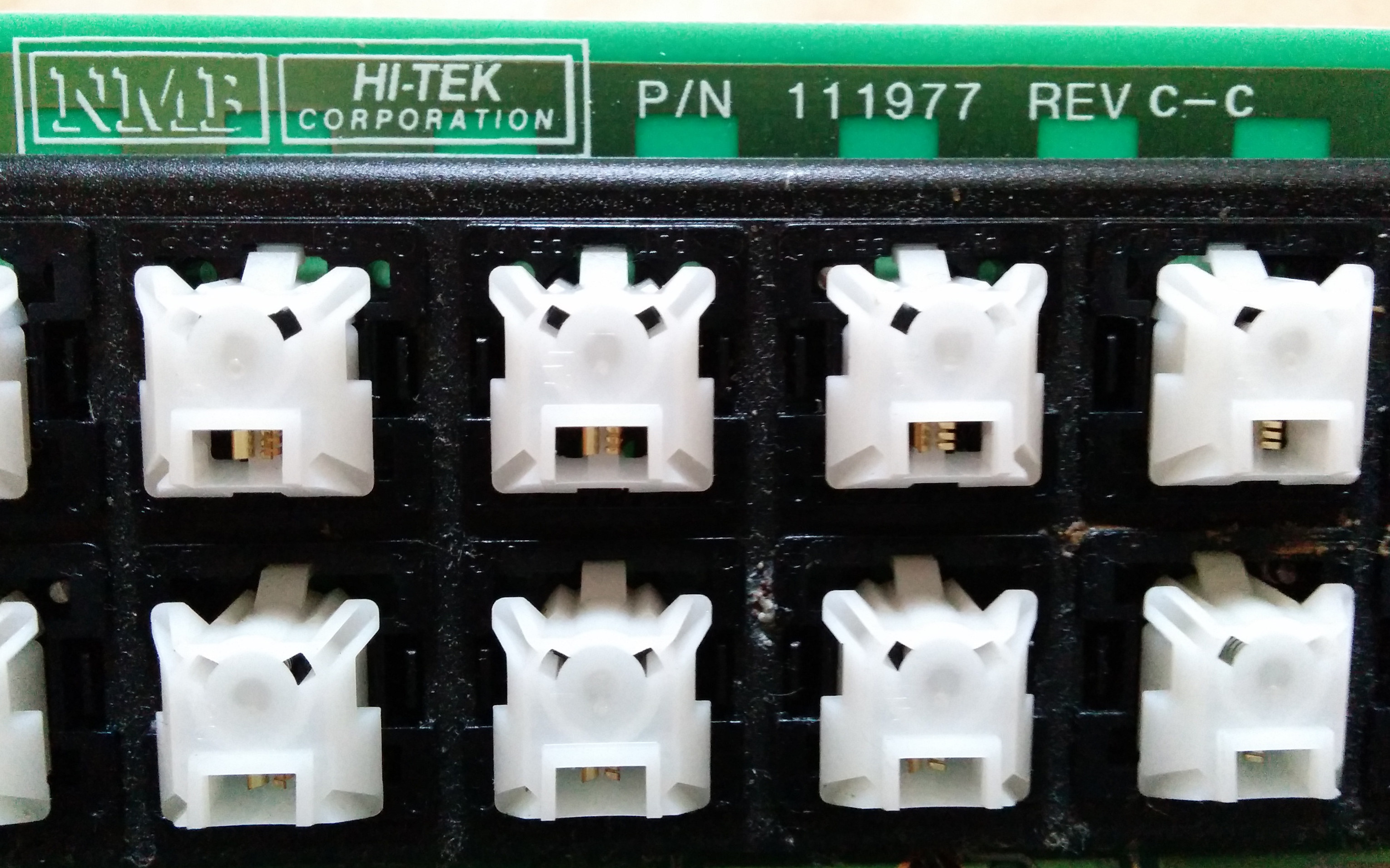

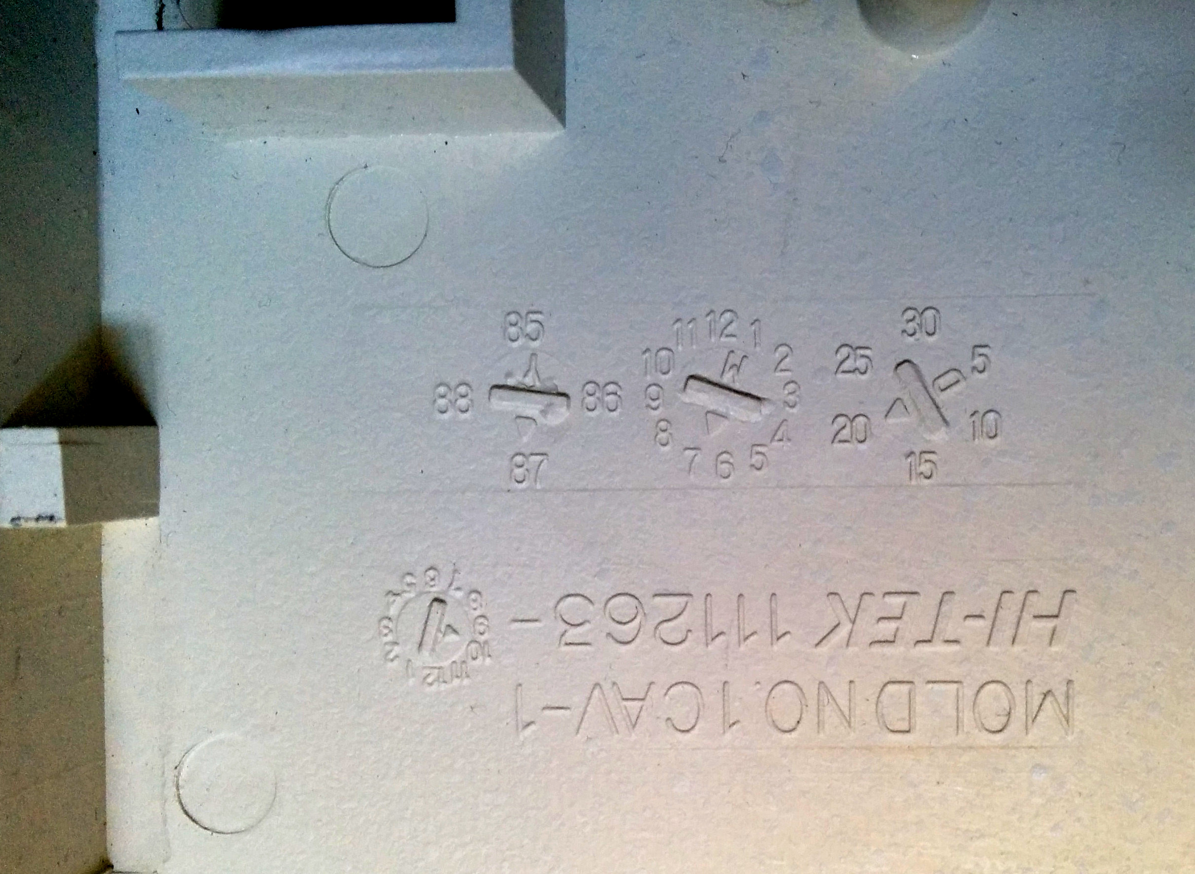

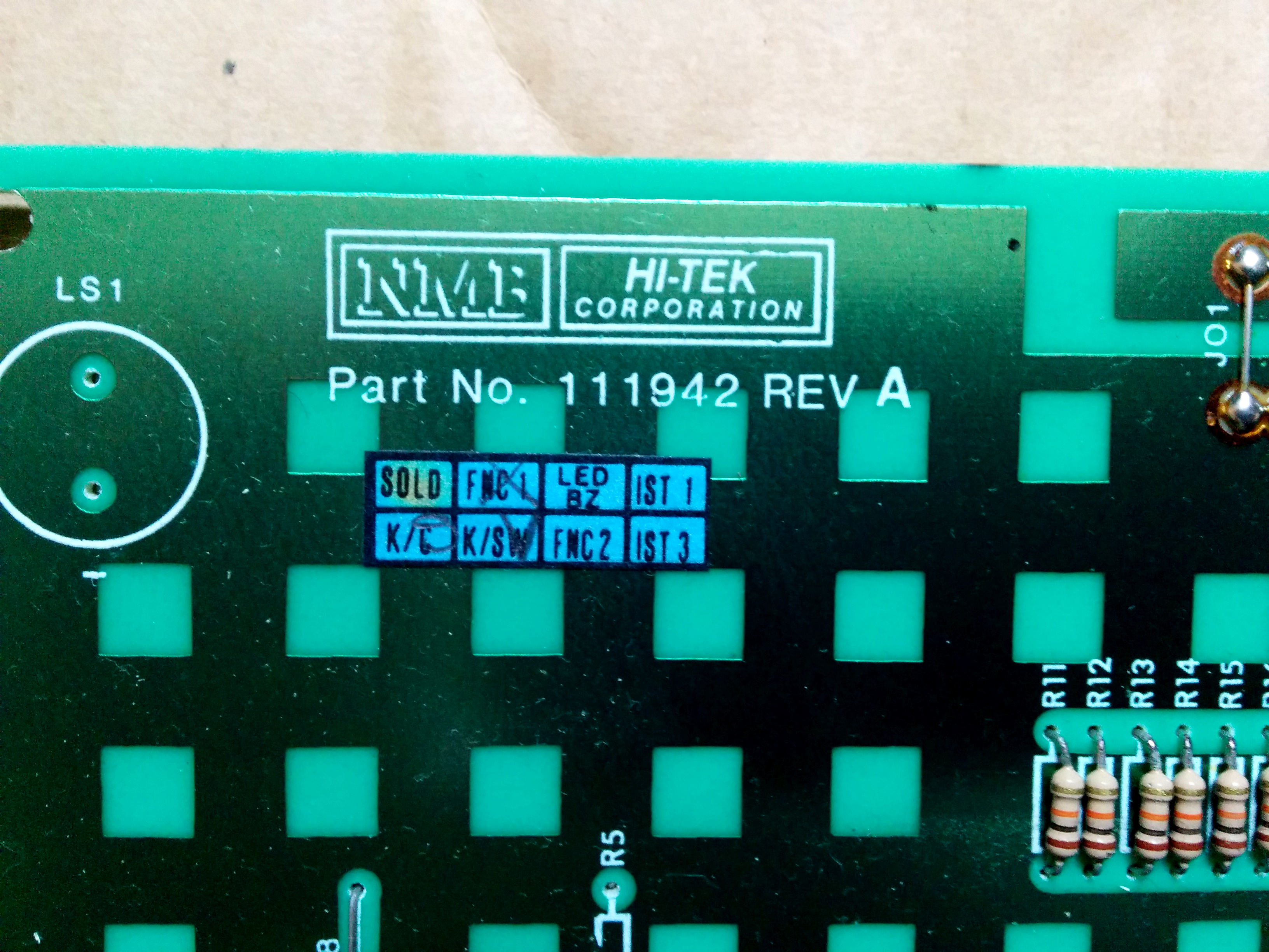

According to the sticker on the backplate, the PCB and the markings inside the case this Series 725 keyboard was manufactured on 20-7-1987 at a Minebea facility in Thailand.D'Milo Hallerberg:
So, Chyros, regarding the dating of your keyboard, I can't really help except to say that when Minebea acquired Hi-Tek there was a big plan to build a manufacturing facility in Thailand. If I remember correctly the plan was to build the new thin film keyboard design we were working on at the time. However, I don't think this keyboard ever made if off the ground. It looks to me like the Thailand facility was indeed completed and they manufactured the Series 725 keyboard there for some time. I think the Made in Thailand sticker on your keyboard confirms that.

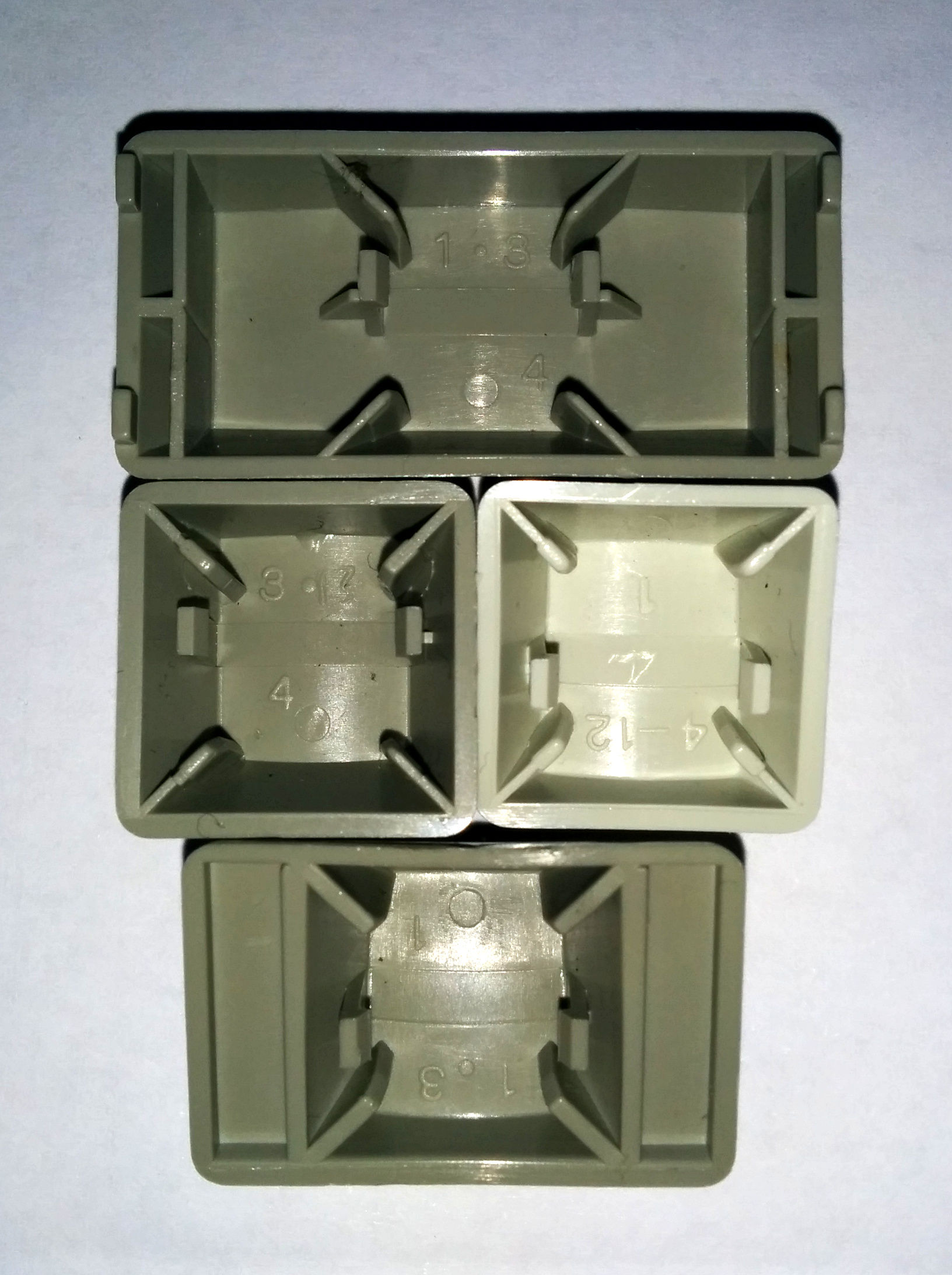

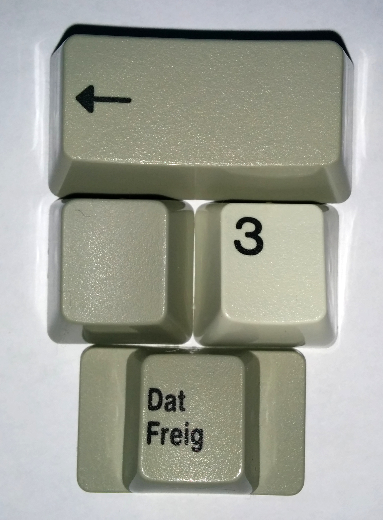

The keycaps are dyesub on PBT with legends in the top right of the keycap for the alphas. The fuction keys are grey with an elegant "thin" font, some with secondary ledgends on the front.D'Milo Hallerberg:
The keyboard you have is made with the Series 725 switch we developed in the last few years before selling to Minebea. The 725 refers to the ergonomic standard (Max .725" off the desk surface) that came out during that period that effectively obsoleted the standard series we'd been making for many years prior.
Weight: 2810g
Dimensions:
55,5cm wide
22,5cm deep
2cm tall at front

More pics:
- IMG_20160501_143019.jpg (924.23 KiB) Viewed 10390 times
- Chyros
Very nice! I didn't know there were Space Invaders battleships ( :p ). It definitely has LOTS of things in common with mine, but I also noticed it has the outside notches of the RT-101, which I thought were unique to that board. Most interesting! Definitely looks very well-built like all these very old NMB Hi-Tek boards
- seebart
- Offtopicthority Instigator
- Main keyboard: Rotation
- DT Pro Member: 0061
I like the sound of "Space Invader battleships".
