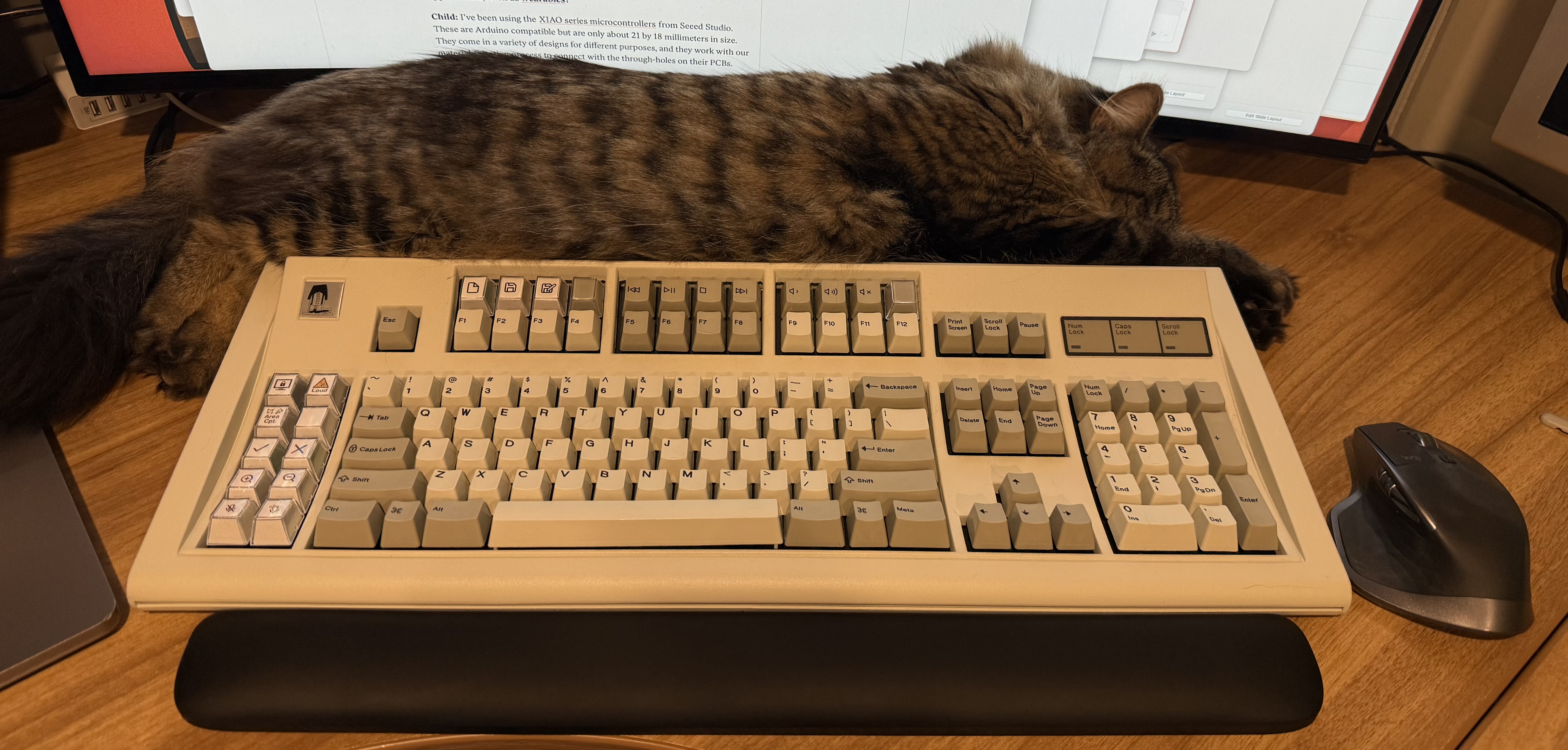

I have used M122s for quite some time now. So I'm quite used to the 22 extra keys.Ellipse wrote: 01 May 2025, 20:39 Please do share photos of how you have customized your transparent relegendable Model F / M keys, whether new or original, as I have not seen too many such photos. Any advice for how to use these keys?
For me, the left 10-key-block is where I put things I use very often for me that's
- Escape. It's there, because M122s don't have a key where the Esc key is on standard keyboards. So on my M, I mapped the most left upper key to Esc which is that one. I have become so used to this position, that I also mapped it there on my F. I'll have to see how fast I can retrain my muscle memory to use the standard Esc position.
- MS Teams raise hand
- Print (= Screenshot) Window
- Print (= Screenshot) Area
- Output Volume Up
- Output Volume Down
- MS Teams mute mic
- Hardware mute mic
- Stop (On my M I used to have LCtrl there)
- Play/Pause (On my M I used to have LGui there)
F20-F24 map to hardware control (turn on/off touchpad etc.)
For optical reasons, I've always kept these F13-F24 instead of relabeling them (a meaningful label would require a too small font).
While I like the labels on terminal keys, I also like my keys not to be misleading. I'd rather prefer an unlabeled key (like the LGui/RGui keys on my F122) than misleading ones. This is why I don't use "original" terminal keys for my custom keyboard functions.

Thought I'd post a photo of my F122 w/ bonus cat. I don't have a use for all my keys yet so there are a few blanks. The ones I have added a legend for so far have used the template from @Cyber_engineer -- super handy.
I'd love to hear advice from folks on a few things I've been dealing with. The main one is that pressing "x" or "." bumps the space stabilizer a little, which causes the spacebar to rattle -- making the experience unpleasant. Is there any way to adjust (bend?) it so it clears freely and doesn't interfere with those keys at all?
Second issue is that I've not been able to find a setting or hardware arrangement for my solenoid that makes a nice subtle haptic "tak" -- it's more like a loud typewriter, even with settings that barely get the solenoid to fire at all. Am I doing something wrong or were my expectations just not reasonable?
- IMG_1204.jpeg (2.98 MiB) Viewed 13 times
Nice photo TheJBW! Thanks for posting it. I would focus on the spacebar wire. I've also had success bending it in the other direction. I've just updated the manual with this additional information and a new photo. See action step 4 and let me know if this helps. Added text: "Additionally, as shown in the second photo below [added just now], you can bend the spacebar in the other direction, which would move the wire farther away from the > . key. "
Movement can also be reduced by pushing down the metal spacebar tabs slightly, not too much so as to slow down its movement.
You should not be adjusting the dwell times or other settings like that. Check out one of my last couple blog posts as someone modded the solenoid with electrical tape after adjusting the bracket to the shortest possible distance for the solenoid cylinder to move. Please keep us posted!
