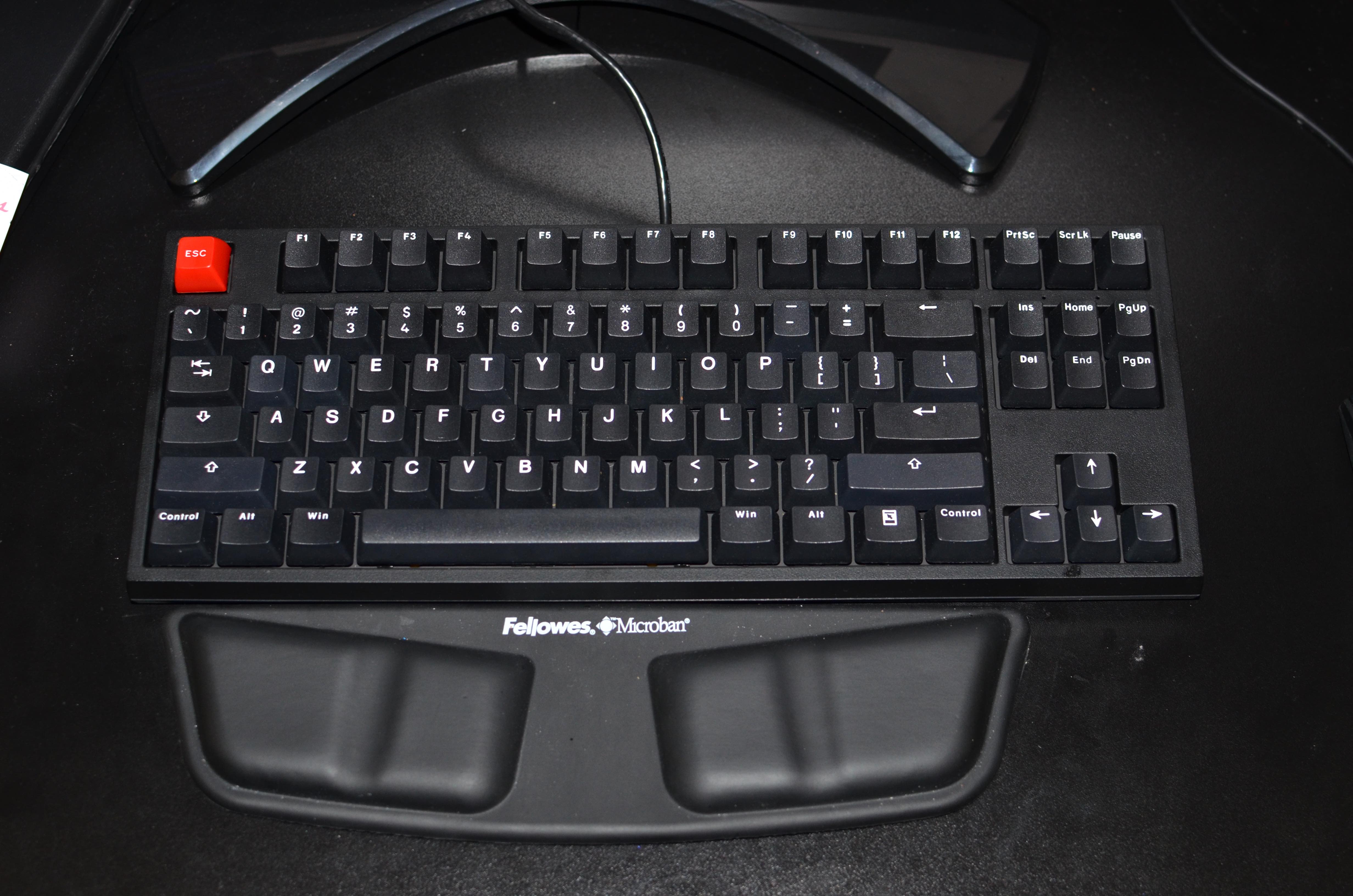

These are thick PBT double shot keys, white legends on a black background. They're fantastic, and work well with a CM Novatouch as well as Costar clone Cherry keyboards such as the WASD v2. Here they are on my keyboard:
Double shot PBT caps are tricky to make. On my sets a couple of keys have very slightly raised legends (you can feel them if you know which key and where and go look for it) and some legends are slightly thicker or thinner than others. Also it is somewhat harder to get extremely crisp glyphs with tight (small radius) corners so e.g. the Menu key's symbol is not as crisp as it should be.
I find these keys to be delightful.

Here are some better key cap photos. Since I replaced the ESC with a red SP SA ABS doubleshot, the old Esc key is within reach. 1.46mm thick on my calipers.
(Photography suggestions welcome - this is a Nikon D7000 DSLR using the built in flash indoors, perhaps a narrower aperture would have been better for these. These are potato pics for this camera compared to its capabilities.)
