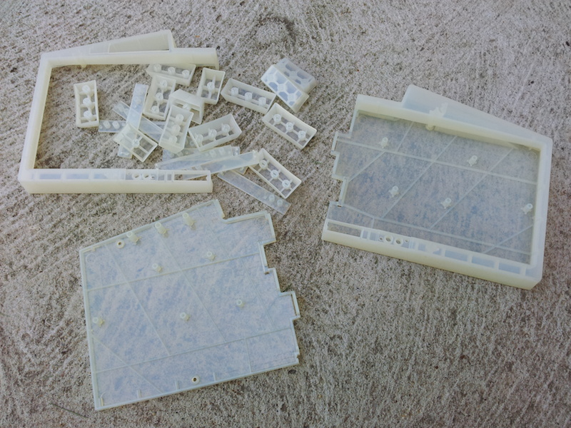

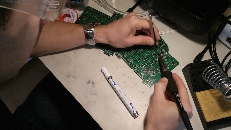

Can't say I understand a lick of what the diagram's about. But looks like a 3D printed split ergo with custom PCB and MX switches… and 3D printed caps?

so this is your own personal project? Is the prototype (visually) going to stay the way it is now? It's a very specific design with that middle connector!

The idea is pretty neat, though, the keyboard "clips" together if you want to. That's a pretty smart design.

I removed the diagram in the meantime because it's not so important and made people falsely assume things. Yes, it's a 3D printed split ergo keyboard featuring MX switches, soon to be kickstarted. Our keycaps are standard DSA keycaps.

we actually already covered the UK, what I would really appreciate is a kicad step by step tutorial

I'm the lead developer but I'm not doing this alone. Luckily we have a small team. Yes, the prototype will stay the same visually. If you take a look at our website you'll have an very good idea about how the final product will look like. Only very subtle changes are to be expected.

I better do a video tutorial on KiCad eventuallymatt3o wrote: we actually already covered the UK, what I would really appreciate is a kicad step by step tutorial

please do!mondalaci wrote:I better do a video tutorial on KiCad eventuallymatt3o wrote: we actually already covered the UK, what I would really appreciate is a kicad step by step tutorial
