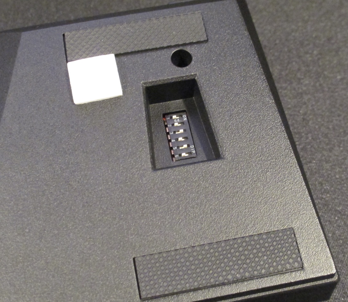

Features. As shown in Figure 2, There are 6 DIP switches on the bottom of the keyboard. These provide 15 configurations including a variety of placements for Escape, Fn, CapsLock, Tab, Win, Alt, and Menu. The Fn key can be used in combination with other keys to control some 36 functions. The DIP switch and Fn options are clearly listed in the manual, and functions in the Fn layer are displayed on the front of the keycaps as shown in Figure 1.
The Matias-switch versions of the KBP V60 keyboard do not include backlighting, as found in the Cherry mx versions of the V60. I prefer not to have backlighting, in part because I usually swap out stock keycaps for solid caps without windowed legends. There are, however, two indicator LEDs -- one for CapsLock and the other under the Right Shift to indicate that certain keys have been toggled to arrow keys.

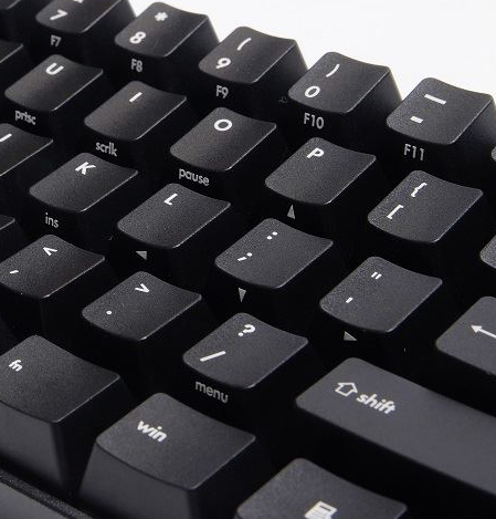

Enhancements -- Layout.
The KBP V60 keyboards have a wealth of DIP switch settings and Fn key combinations, but while I found some of the DIP switch settings useful, I promptly remapped the keyboard to my favorite layout (that of the HHKB Pro 2 and Mac OS X mode) using Karabiner software for the Mac. Fortunately, it is possible to swap Fn with a remappable key, so that even though I ended up discarding all the default Fn-key functions, I was able to define my own by using Karabiner. This enabled me to swap Backspace and Backslash, remap CapsLock as Control and Fn+Tab as CapsLock, and to set up the bottom row as Ctrl, Opt/Alt, Command, Spacebar, Command, Opt/Alt, Ctrl, Fn.
Enhancements -- Keycaps.
Like many contemporary keyboards, the KBP V60MTS-C and V60MTS-Q keyboards are populated by thin ABS keycaps with laser-engraved infilled legends. In the case of Cherry mx keyboards, there is a wealth of excellent replacement keycap sets available, and I usually opt for dye-sublimated PBT for aesthetics, longevity, visibility, and feel. To me, ABS feels clammy and overly smooth, whereas PBT feels agreeably dry and slightly textured -- some PBT keycaps feel somewhat like pumice stone.
Unfortunately, as good as Matias switches are, they have key stems that are compatible only with Matias or some Alps-mount keycaps. Although Matias will be offering keycaps on their web site relatively soon, these will only be ABS, at least at first, and it is not yet known if they will offer keycaps to fit the bottom row of the KBP V60 Matias keyboards. Consequently, in order to replace the stock ABS keycaps on the KBP V60 Matias keyboards, they must be sourced from vintage Alps-switch keyboards. Fortunately, such keyboards can still be found.

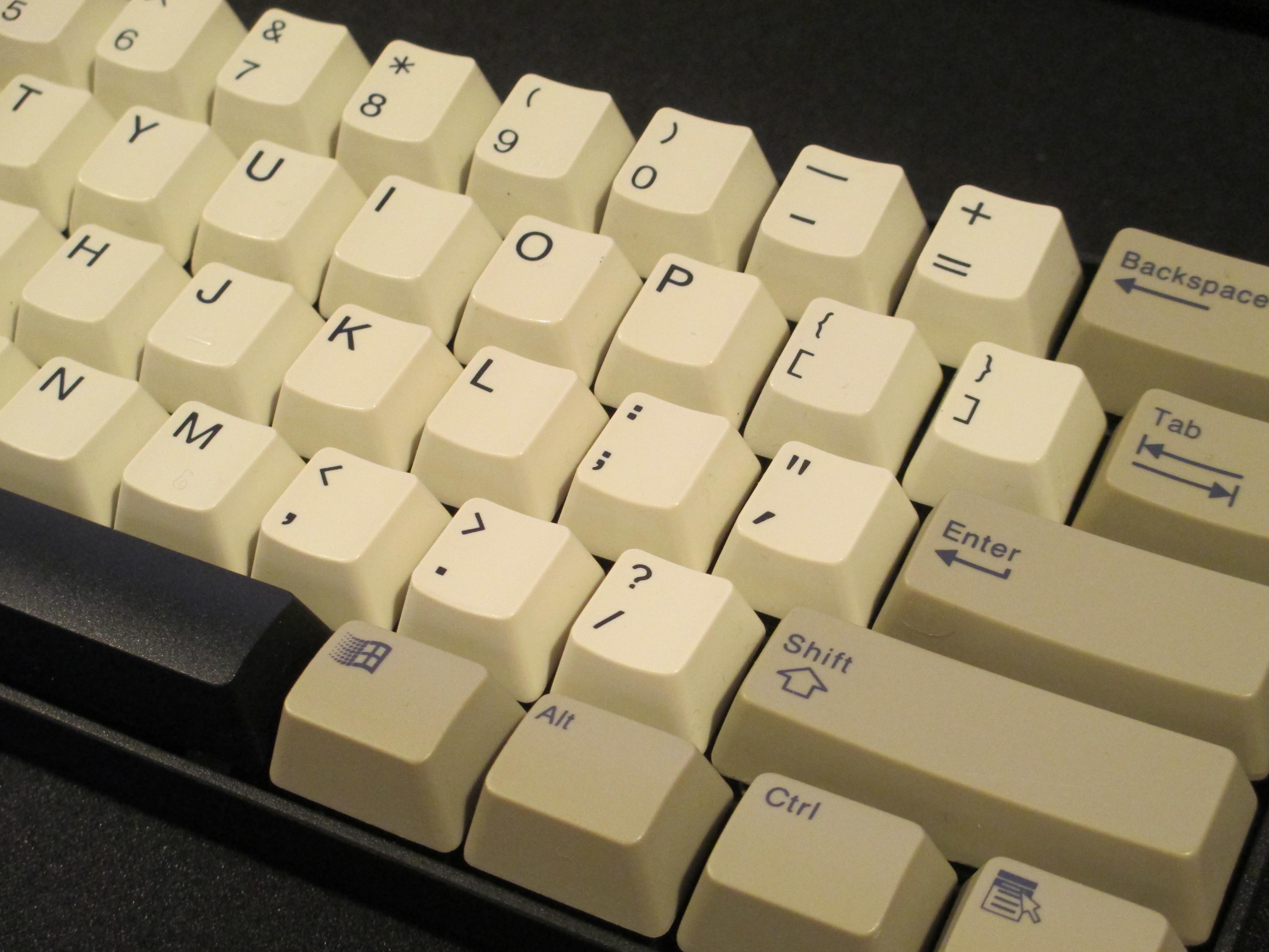

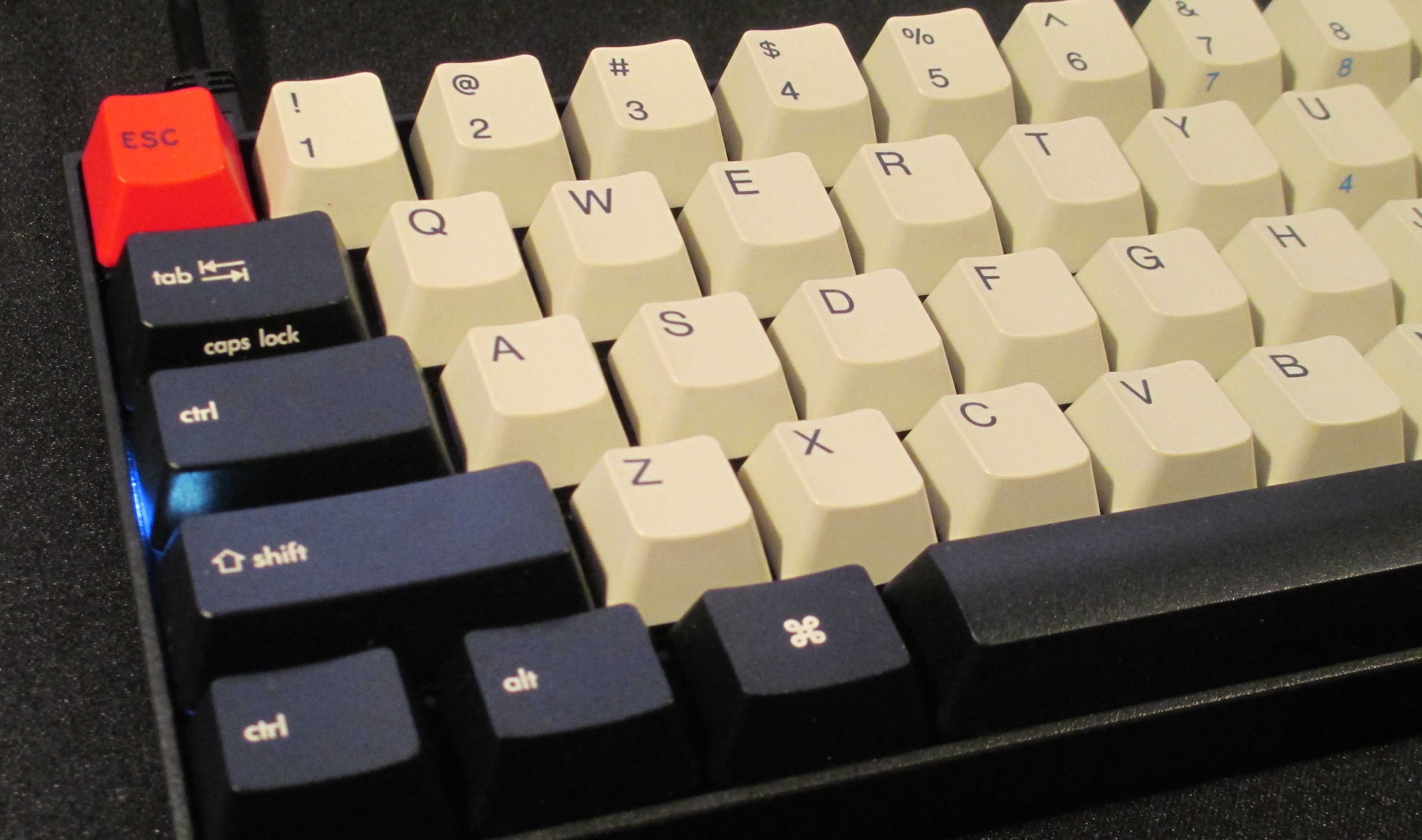

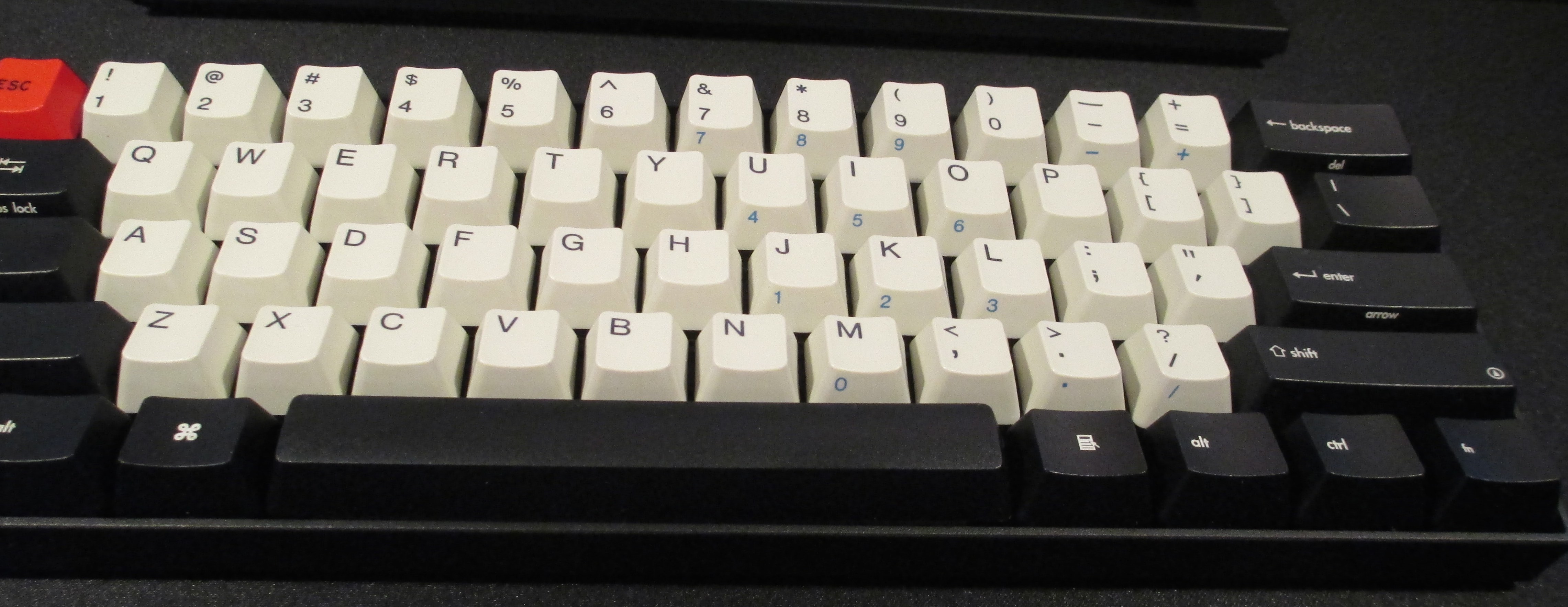

For example, Figure 3 shows the KBP V60MTS-Q with lasered ABS modifiers from a Dell AT101W and alphanumerics from a SIIG Suntouch Jr. The doubleshot caps look great, but being ABS they feel clammy.
Figure 4 is a view of the V60MTS-C with dye-sublimated PBT keycaps from an IBM 5140 convertible computer. The IBM keycaps look beautiful, and they have the unmistakeable dry touch of PBT. The modifiers are stock ABS; the red Escape key is doubleshot ABS from Signature Plastics. This Figure also captures a minor quibble: only one Mac OS X Command keycap was included with the extra keycaps. This omission reflects the default setup options, which do not include having a Command key on each side of the spacebar, but this is possible using the right combination of DIP switch settings and Karabiner software.
Figure 5 illustrates another minor quibble. Neither the CapsLock nor the Control keycap for the CapsLock position had a window for the indicator LED, although there is sufficient light leakage to see when the CapsLock is on (Fn+Tab in my case).

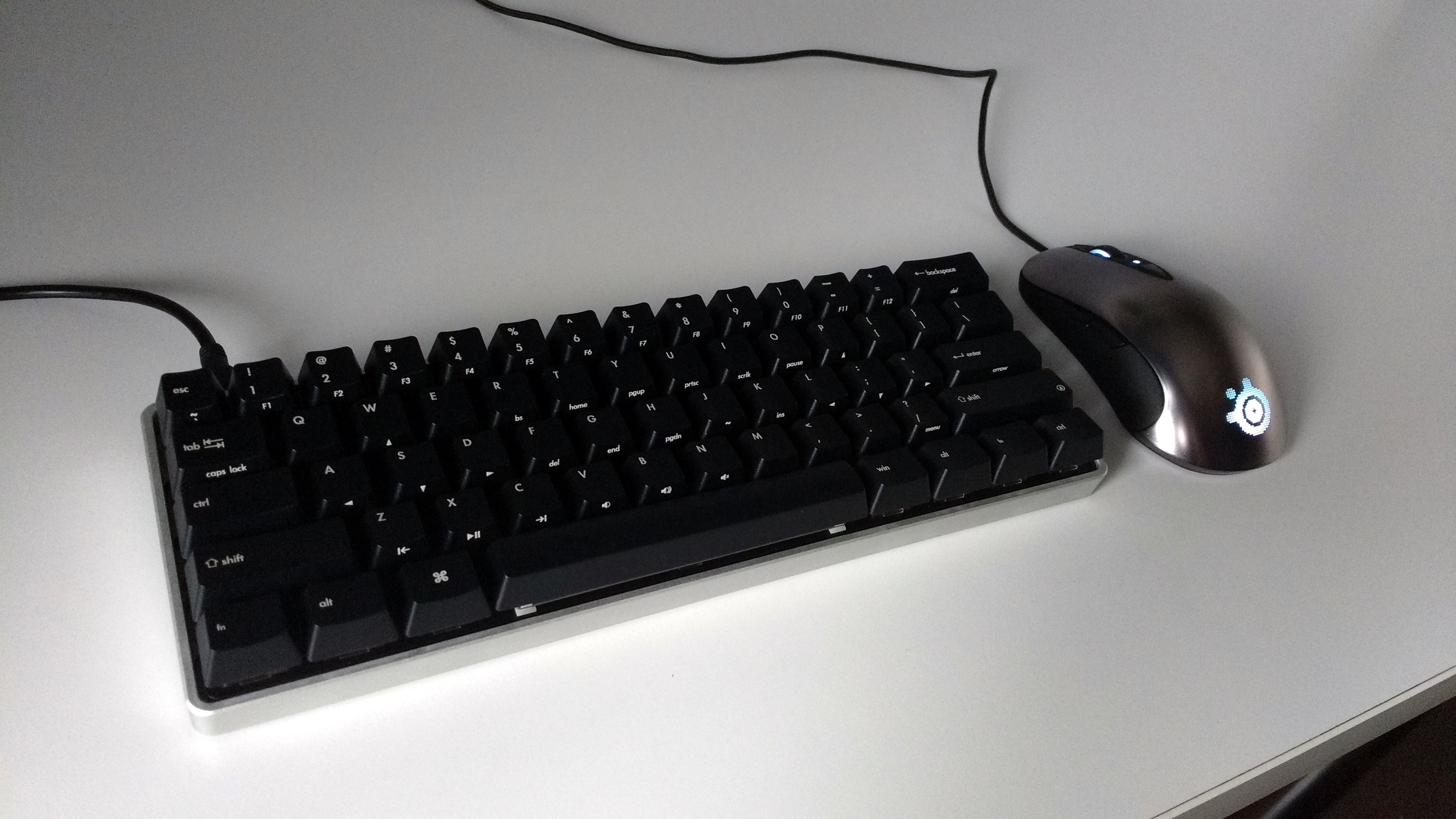

I did however install the keyboard into TEX aluminium case. A bit ghetto, only using 2 springs on sides (the rest would require drilling, and I'd rather replace the plate with custom one than drill this one).
As for the keycaps, I expected much worse. I thought they would be just like the standard Filco/QFR ones, but they are more like keycaps that come standard on G80 keyboards. Not ideal, but passable. I think I can live with those.
That's how it looks in aluminium case:
Not pretty?
