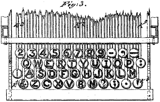

now while a kind of evil conspiracy going on sounds exciting I bet that this also had to do with either some change in production optmization or it might also be that there was a change in some symbol format standard at some point where flat topped 3´s where not allowed anymore. When and why that change took place would be interesting.
Qwerty Layout from 1878 look at the 3.
Olympia Typewriter 1964:
these images are from wikipedia btw.
http://de.wikipedia.org/wiki/Tastaturbelegung
