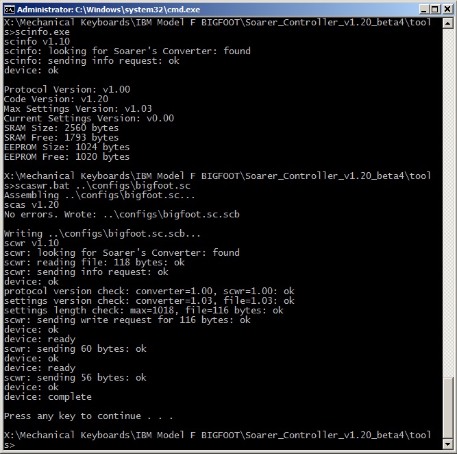

Preliminary results - it works! :)
Big thanks to Soarer (firmware), Cindy (the keyboard), AlinH (shipping), Quantalume and ScottC (for arduino-specific information)! Such people make this forum great.

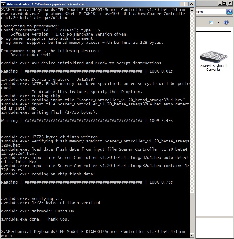

Beside Soarer's controller firmware, one needs the Arduino software (for the Windows USB driver, mostly) and the winavr windows installer (for avrdude) to be ... well, installed.
The arduino micro comes with the bootloader pre-installed; to flash, one needs to know the right COM port to use, and also must hit the avrdude command right after resetting the board AND windows sees the device. To see the COM port, keep the device's driver window open - the COM line in the list will also display its port number.
This is how the process will look, when it works:
Next step, load a config. file - Soarer made one just for the Bigfoot, so will use that - first run 'scinfo' just to see if communication is setup alright:

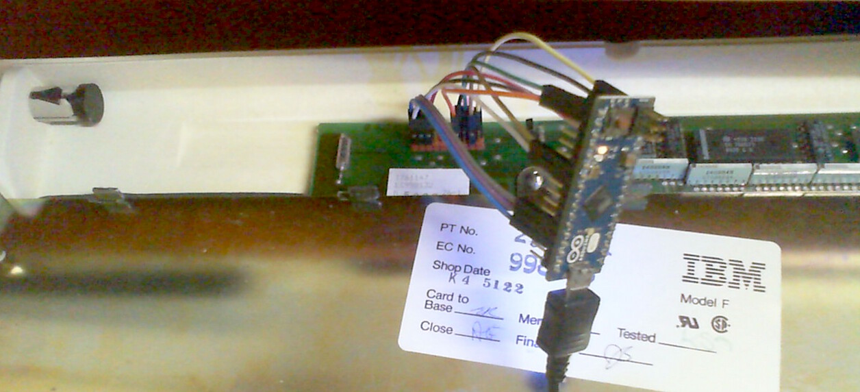

Next, use the table so generously provided by Quantalume to hookup the board to the Model F's PCB:

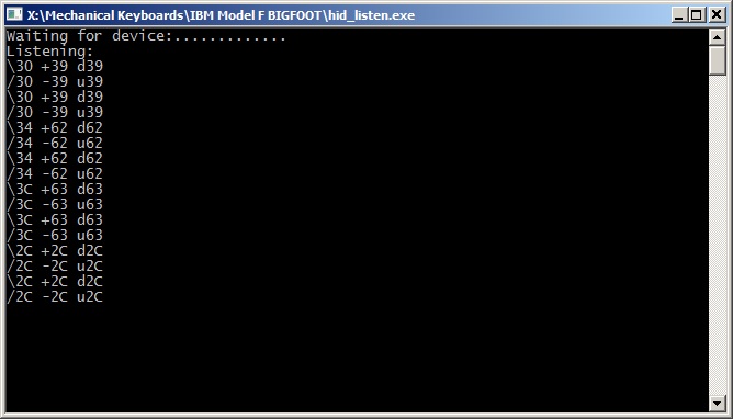

Big moment, start hid_listen, connect the cable, hit some keys - all seems to be ok - yesss!

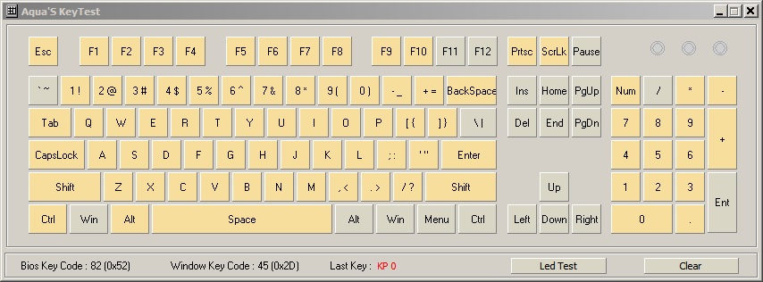

... and finally, the (limited, available in the config) keys seem to register in AquaKey:
So - so far, success from 1st try :)

:) Any questions, just shoot a PM (or here) - right now i'm thinking a nice solution for hooking the arduino to the keyboard case (space is somewhat cramped). It would have been better to have the arduino without those pins soldered in.
Also i'll use a floppy cable for the connections PCB <-> arduino, as one end of the cable can be hooked directly to the PCB socket.

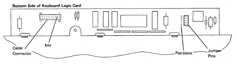

I'm trying to build an external controller for this, so I'm using the DB15 connector.
I've mapped each pin of the internal ribbon cable with each pin on the DB15 connector, but can't seem to figure out the "correct" numbering from :
taken from quantalume's post here
This is my internal ribbon cable. Is the white key the 19 | 4 slot in the above picture?
Posted: 02 Jan 2015, 22:37
by Laser
In my understanding, the "IBM numbering" shows pin numbers on the PCB (in the mirror to the cable end in your picture, when you hook it to the PCB, i mean, not as it is displayed in your image), while the "Ribbon numbering" deals with "the usual IBM ribbon numbering". So the white key on the cable socket goes to the (missing) "pin" number 2 on PCB.
(Disclaimer: that's from memory, i'm still away from any custom keyboard.)
In short, use the blue numbers (IBM numbering), with missing pin on PCB / white key on cable end as number 2 for orientation.
Reference (Soarer's thread - original manual)

The "IBM numbering" is how it appears in the figure Laser attached in the previous post. "Ribbon numbering" is how a standard insulation-displacement ribbon cable is numbered, not IBM's wire bundle. For my Bigfoot controller, I cut one end off of a 20-pin flat ribbon cable, soldered the appropriate wires to the Teensy, and plugged the other end into the board.
