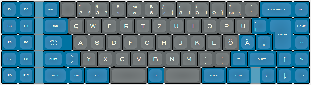

by Nuum
A layout like this would appeal to me, it's very symmetrical and should be doable with Unicomp keycaps.
SPH custom.PNG (65.45 KiB) Viewed 8929 times
Go, SPH international kit, make it to MOQ!

by Hypersphere
Nuum wrote: A layout like this would appeal to me, it's very symmetrical and should be doable with Unicomp keycaps.
I do like the idea of a short space bar (or two of them), but I have never been able to appreciate layouts that fall into the twilight zone between 60% and 80% (TKL). But this is why we do what we do to make personalized layouts.

by Muirium
Doable besides the all doubleshot legends!
2.25u mini spacebars are a nice idea, especially with the no-wire stab system they use. But they wouldn't be round profile. (Checks IBMs…) The difference isn't as pronounced on IBM/Unicomp caps as on SA, but a repurposed Shift cap still wouldn't make an ideal spacebar. The Shift keys bulge upwards at either end. Spacebar is more uniform, with a smooth lip all the length of the front for your thumb. It does feel nicer to press than any of the mods, forgiving its wire stab.

by 0100010
Besides the right shift, this layout would work on Kishsaver.
Or it could work with a custom plate / PCB. Or remove the bottom outer edge modifiers and you have HHKB.
EDIT : You can't see it in this image, but that number row also has front function legends printed.
