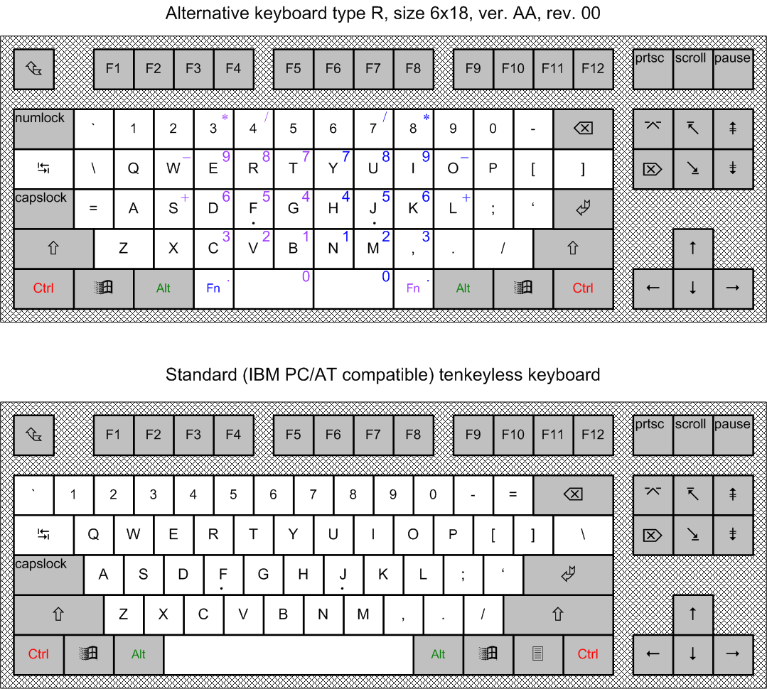

It used to be pretty common in the early 80's. I really wouldn't mind to have all alphanumerics 1 units, and all other keys 1.5 units except space... for me personally smaller than 2.25 is a no go.
For example:
with a few more modifiers for modern systems and the smaller spacebar would be just fine.

A non-staggered TKL layout. However the two Shift and Space keys are 2x.
