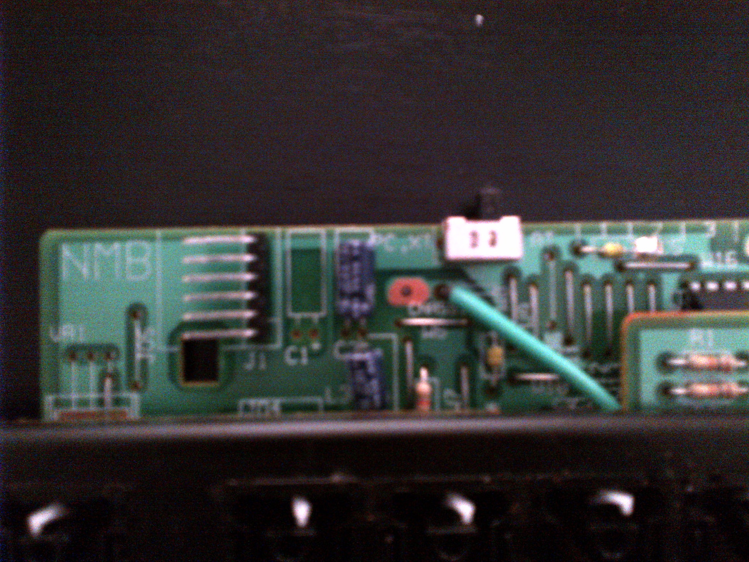

I recently salvaged an Everex keyboard with black Hi-Tek switches. It has a DIN 5 connector that plugs in to a six pin header on the keyboard. Next to it is a switch - one side is labelled "AT" and the other "PC,XT" on the circuit board. I searched around and could not find any information about these modes. What do they mean? Is it possible this keyboard supports USB with the appropriate cable?

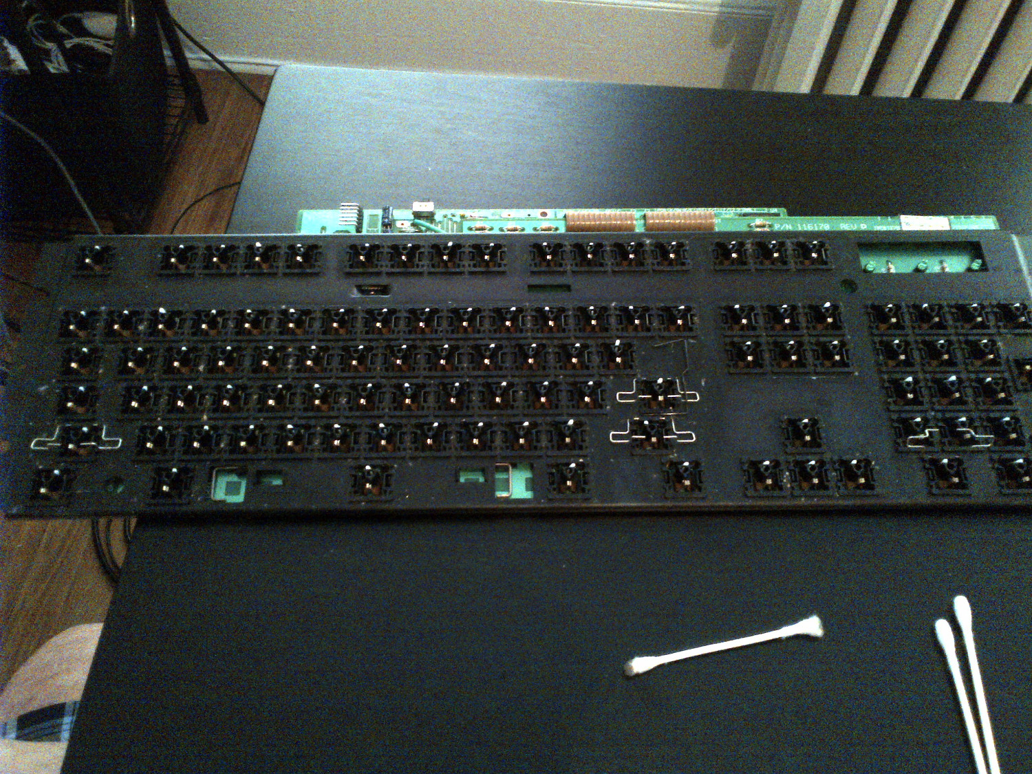

I have the keyboard in pieces for an extensive cleaning at the moment. I've posted pictures - note the dirt on the black metal piece with the switches on it. Any thoughts on how I can clean that? I cannot separate the black metal plate from the rest of the keyboard.

02 Nov 2014, 17:07
AT is basically PS/2 with a bigger plug. You will want to set the switch to AT. XT is the previous, incompatible protocol.
To use that keyboard with USB you will need to buy a [wiki]converter[/wiki].

Aw darn, I was hopeful. At least I learned something new. Thanks.

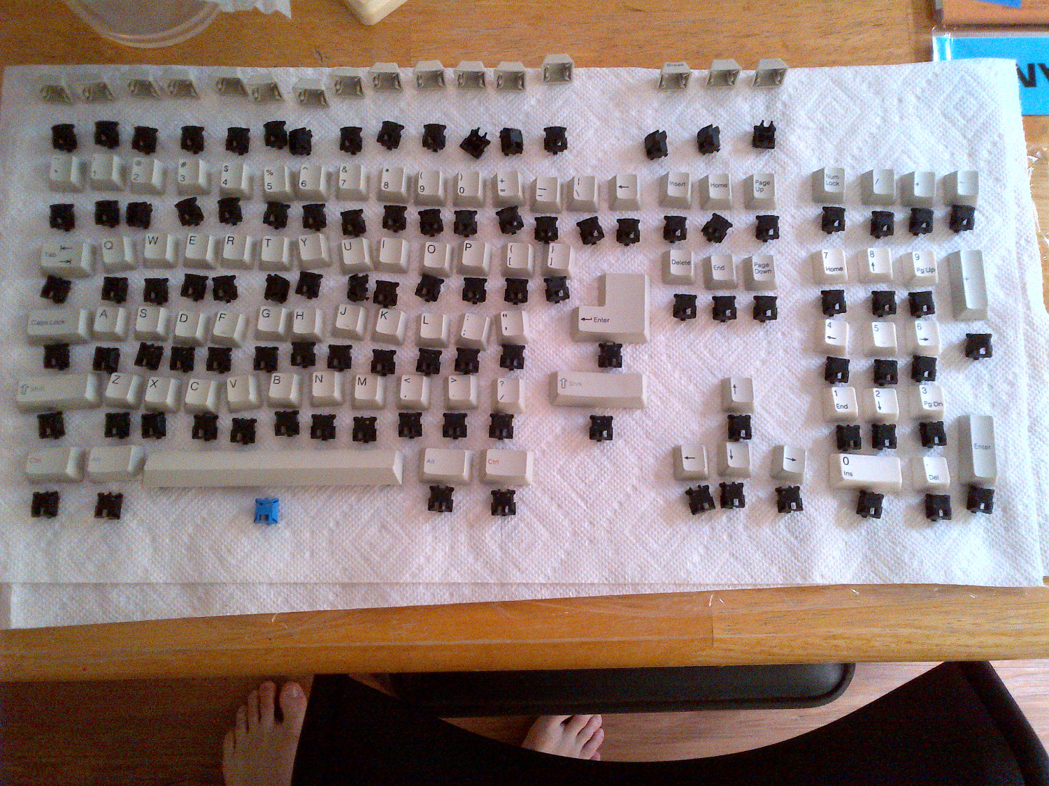

You pulled all the switch tops? That's a lot of work!
Be really careful not to bend any of the contacts when putting the switches back together. I did that once :(
