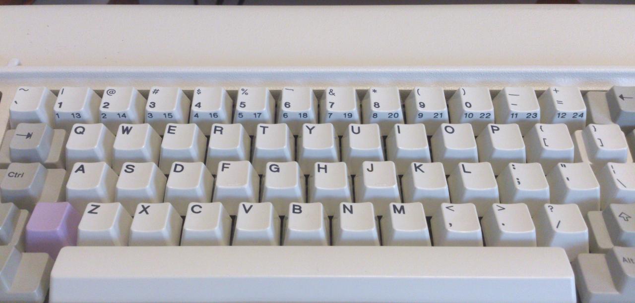

The Model F keyboard from the IBM 5291 terminal, affectionately (or not) dubbed "bigfoot," seems to be much maligned in the keyboarding community. However, I recently restored one that I obtained through one of Cindy's hauls and have been using it daily. Thanks to the brilliance of Soarer's controller (and the instructions for adapting it to bigfoot here), it's a relatively simple matter to interface it to a modern computer and have greater flexibility in key mapping than with just about any present-day factory keyboard.
I'm currently using it with my standing desk.
Set to its middle elevation (the legs allow 3 different heights), it is perfectly level with my CST trackball. While the extra case material in front of the space bar might be objectionable for seated use, it works perfectly well for a standing desk, and I find it convenient to rest my hands there when not typing. The extra case material on the sides places the pointing device 12 mm further away than the XT, but it's still on par with the AT in that regard and 67 mm closer than the "enhanced" Model M.
Being essentially an XT sans controller on the inside, it has the same clicky, pingy goodness (on the upside for most) and layout (on the downside for most).
However, I've never had any issues with the XT layout, and bigfoot has rather nice numeric caps with front-printed legends that lend themselves to remapping the function keys there. I use F13-F24 for quick-launch functions, so this is a definite plus for me.
Putting the function keys on top frees up the left-hand cluster for macro and other usage, and this is the mapping which I currently use on my XTs and bigfoot:
Am I the only one who likes this board?

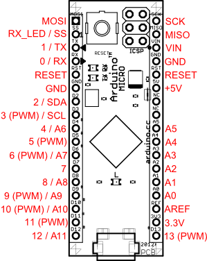

Laser wrote: Q1. What is the teensy 2.0 <-> arduino micro (not the micro pro, but the larger model, with the reset button) pin mapping, usable for Soarer's controller?
Or, alternatively (teaching fishing instead of asking for fish), how do i find out this mapping?
(edit: i may have found it, after some reading)
Yes, that's the chart to use. You might want to take the Arduino Micro pin out I've pasted here and annotate each position with the actual processor pin function from the chart you linked, as it will make hookup easier.

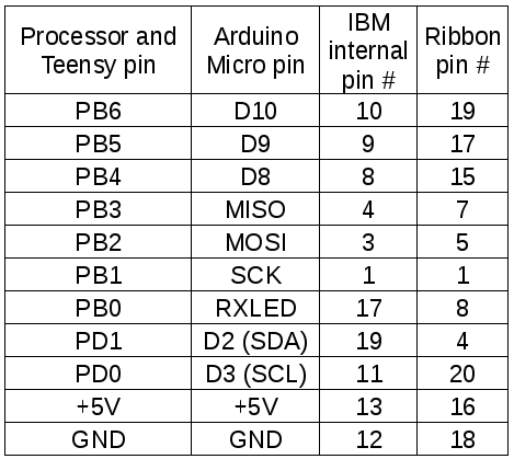

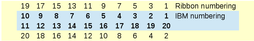

Assuming you are going to install the controller inside, one thing you might want to be careful of is the difference between the way IBM numbered the 20-pin connector and the way ribbon cables are usually numbered. Getting this wrong could fry something! This little diagram shows the difference:
ribbon numbering.png (17.87 KiB) Viewed 16591 times
This table brings everything together:
Of course, you could also connect to the external 15-pin D connector.

I was reading Soarer's thread and thought to combine the connector information from the 5291 maintenance manual (p38) with the picture of the teensy hooked to the PCB jumpers, and go from there, but your data above solves it :)
