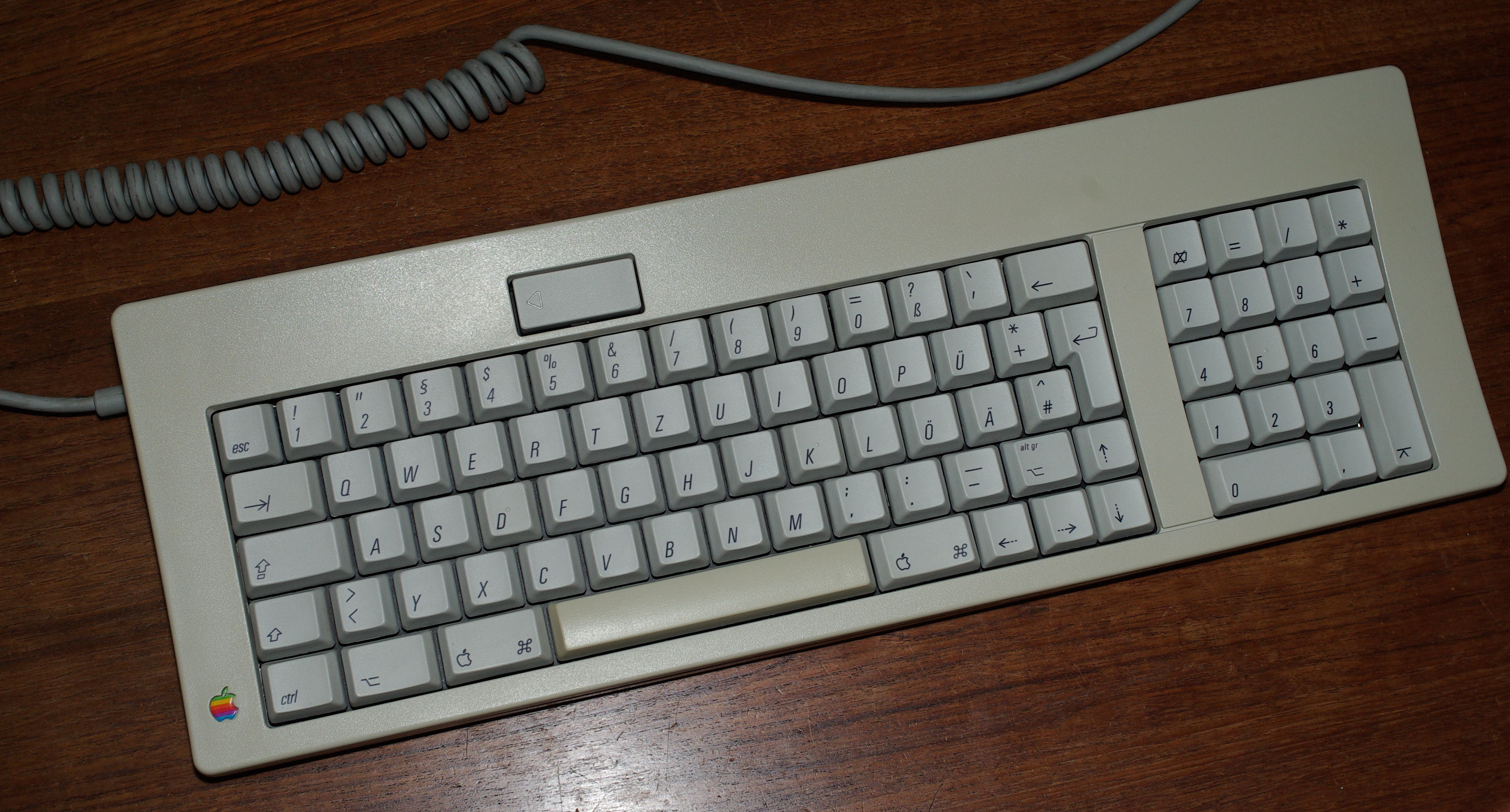

Thanks. ;) This baby is ready for some action (retrobright candidate of course):
