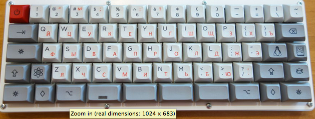

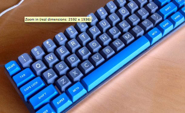

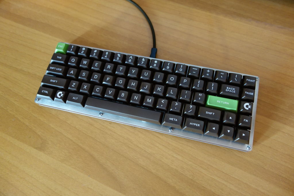

Got anything in mind for a layout? Matteo has experimented with quite a few, and even tried a compact keyboard with zero stabilised keys: Bianca.
Now he's got his own CNC, he's working on a custom keyboard kit of sorts. Here's his self-manufactured case prototype:
WASD are indeed the source for Costar stabs, the kind that Matteo likes so much. They come as separate components for cap inserts and plate inserts and wires. You need the lot.

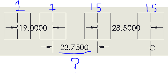

The other thing I'm a bit confused about is the cutouts on the case. You guy said that the complex shaped cutouts make it so you can remove the switches without de-soldering. I'm just a bit confused about how these things are fitting in there. How do the notches hook into the switch? And if you just have a plain square is the only thing from stopping the switch from falling out the top of the board the wiring?
I think I'll try to keep it simple this time around. I just want a compact, and somewhat minimalist keyboard. Like i said, i really do like the brown fox.I recommend something with split halves (or at least some extra distance between halves and a bit of angle), a split spacebar, and some extra thumb keys.

amp625
Okay so, I've started playing around with some CAD for a layout, and i'm confused about one thing.
So if the units are measured from the center of one key to the center of the next one, how do you deal with key caps of different sizes that are right next to each other. In specific how do you know the space between two different caps, because each of those two caps will have a different length hanging off the switch?
Do you just take half of the measurement per unit on each side and then add each:
19/2 + 28.5/2 = 23.75

Looks about right. Switches are usually dead centre under their caps, with a handful of exceptions like stepped Caps Lock keys (don't use those!) and some oddball space bars. Maybe PM Matteo for confirmation about exact dimensions, though.

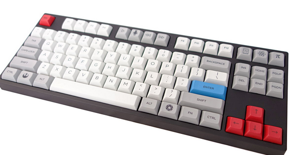

amp625
So I've been looking into the very confusing market of keycaps, and can't get the right naming for the keycaps I like aesthetically. I know they are DSA, but they're different then say WASDs keycaps. They are more rounded, and I like the look a lot better. Where could i find keycaps like the ones below?
