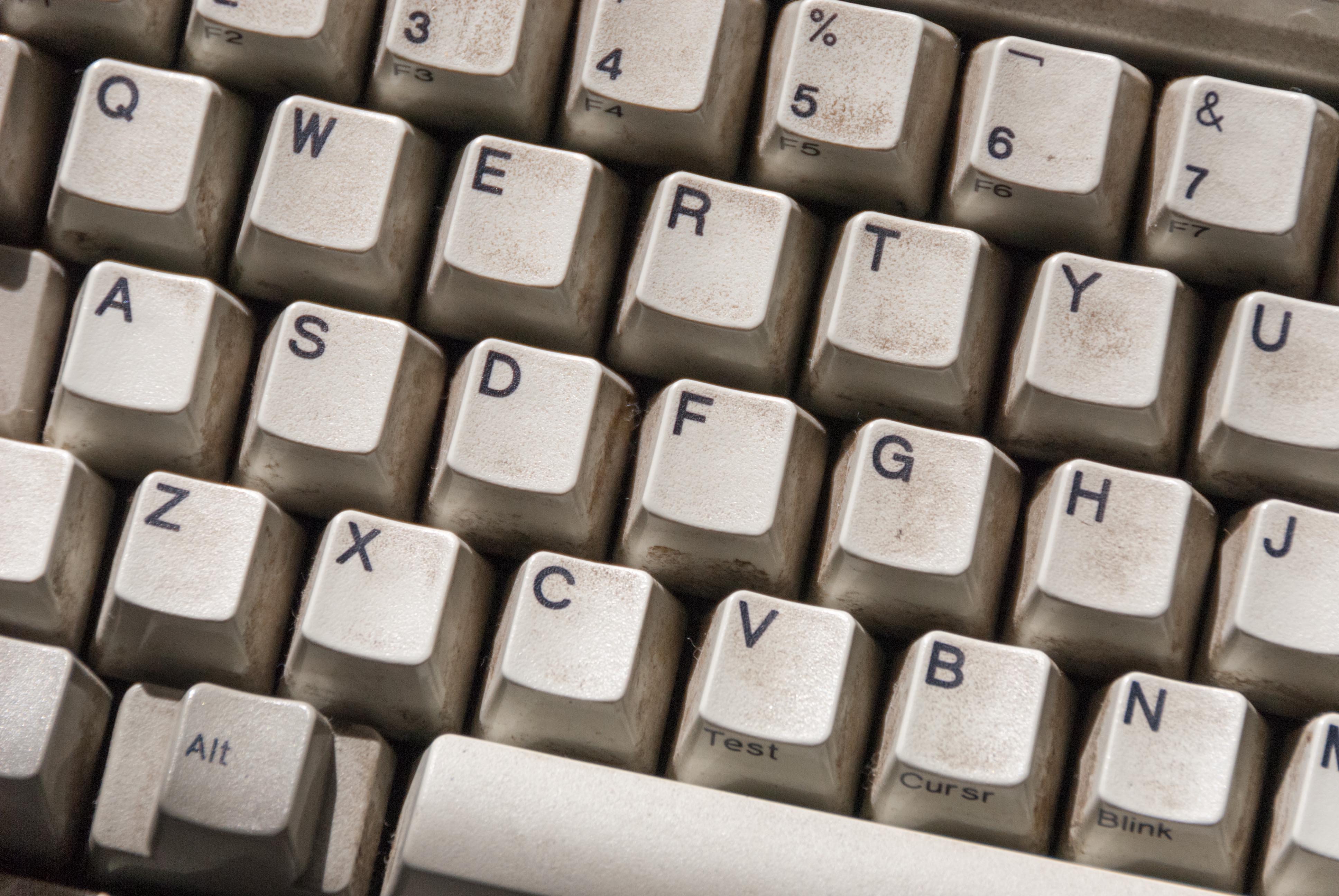

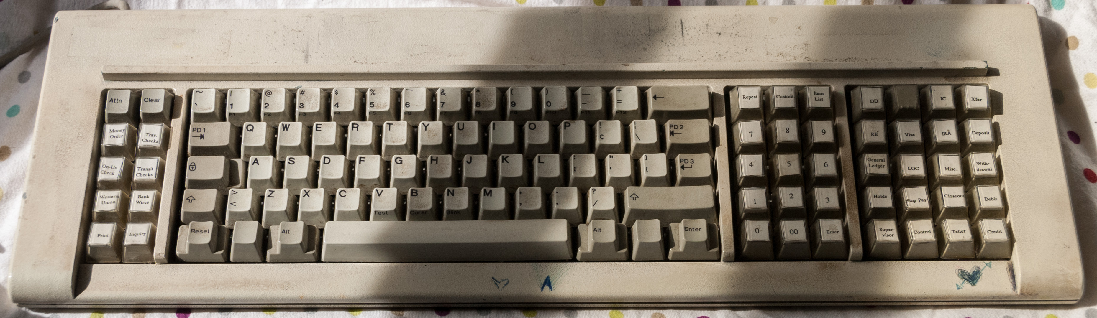

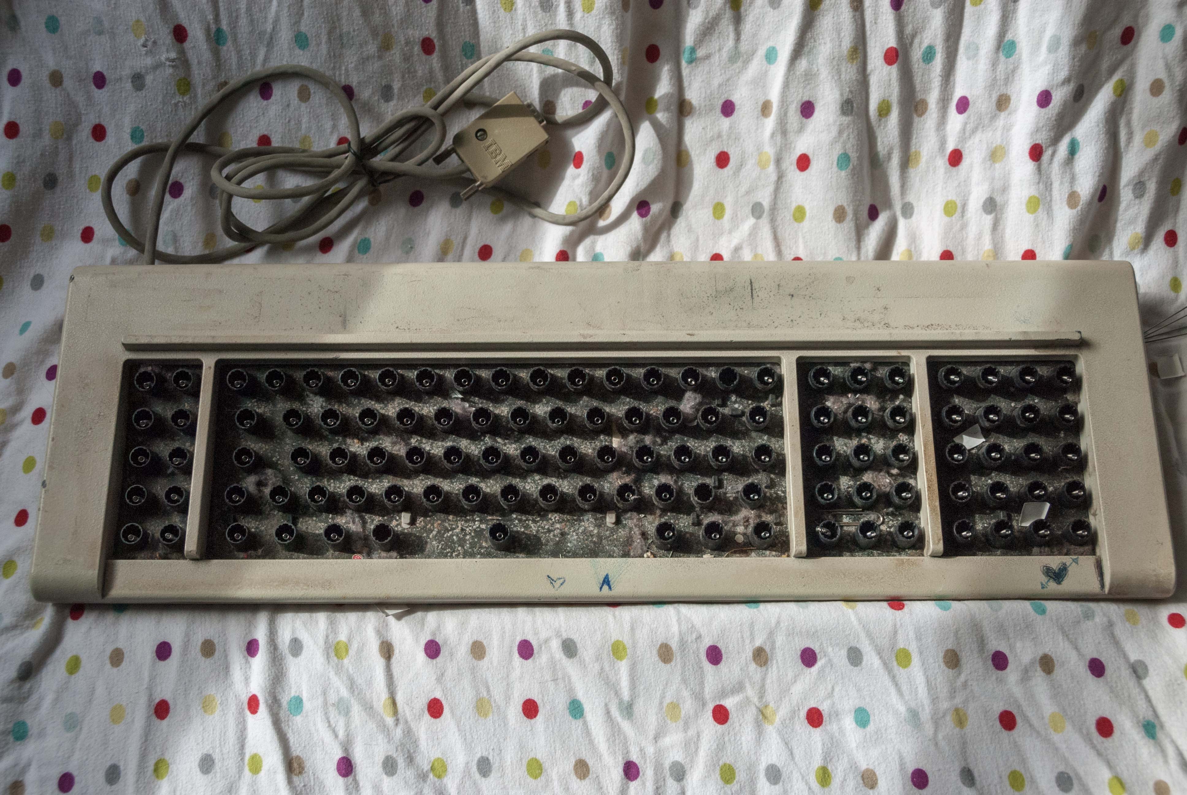

Hello Deskthority. Earlier this week I received from Cindy a neat 107 key IBM 4704 Model F. While no where near as elegant as the lovely Kishsaver or 77 key models, this is still quite an awesome keyboard. I immediately broke it open after tearing it out of the box, and began to bring it back to life. My end results are to get it looking pretty and running one of Xwhatsit's lovely converters. I figured I would make this post as something of a worklog, if anyone else was interested, and to get some answers to a few questions. I will post all the images I take in full resolution to this Flickr album, and I will post the more pertinent images here on DT. As always, you can use my pictures for any purpose you see fit. Let's get started!
Out of the box, it was pretty damn dirty. Partially sticky, pen drawings on the case, peeling, chipping, and eroding paint, and grimy. Just what I expected from a bank teller's keyboard. On the back the label was still intact. It was manufactured in the Armonk, NY factory, January 1985. There is also a stamp on the inside of the top case that says January 25, 1984, as well as a stamp on the bottom half of the case that says December 8, 1984. First impressions of typing on the keyboard were good. All of the keys felt and sounded like they were buckling smoothly, with all of the stabilized keys working properly.

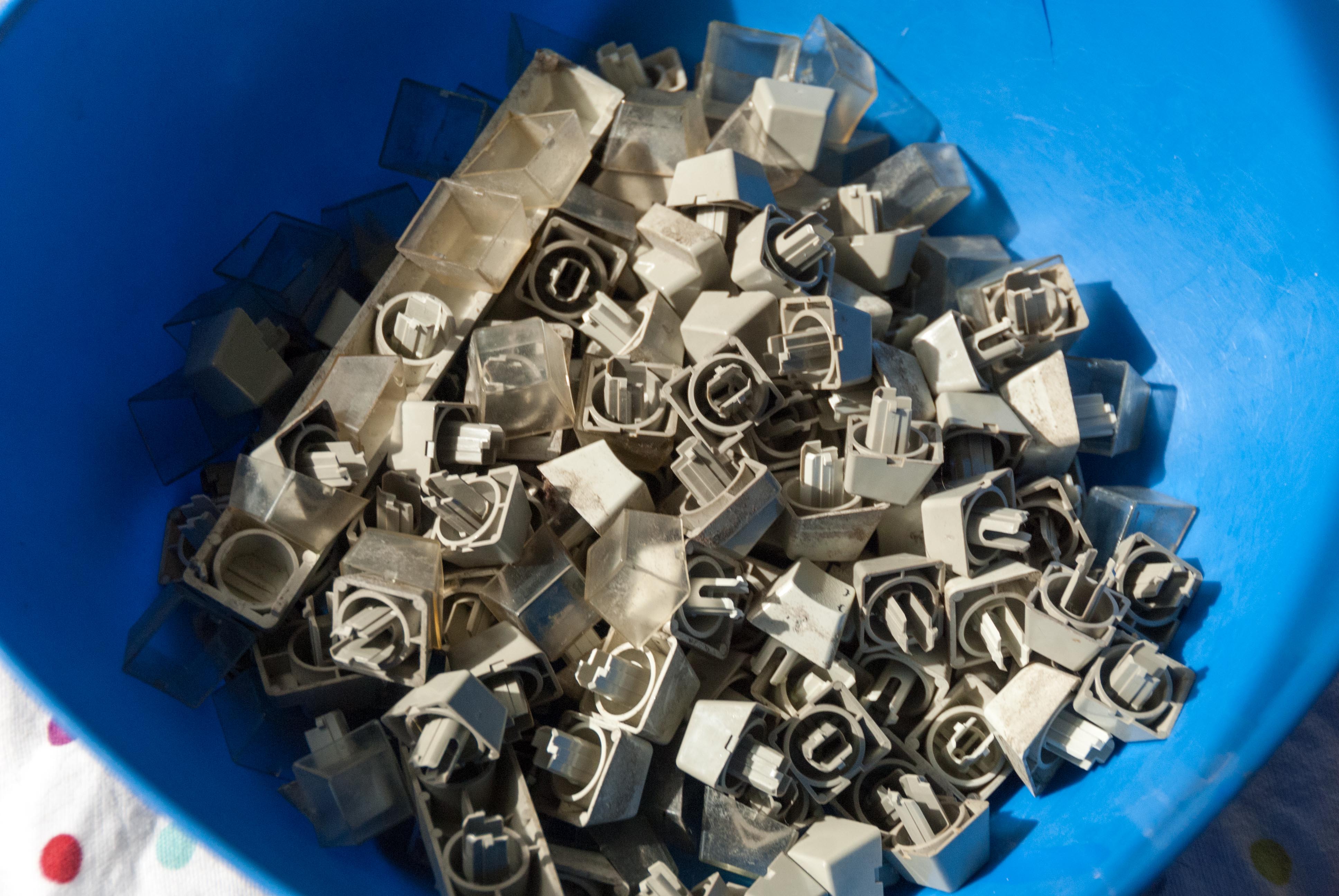

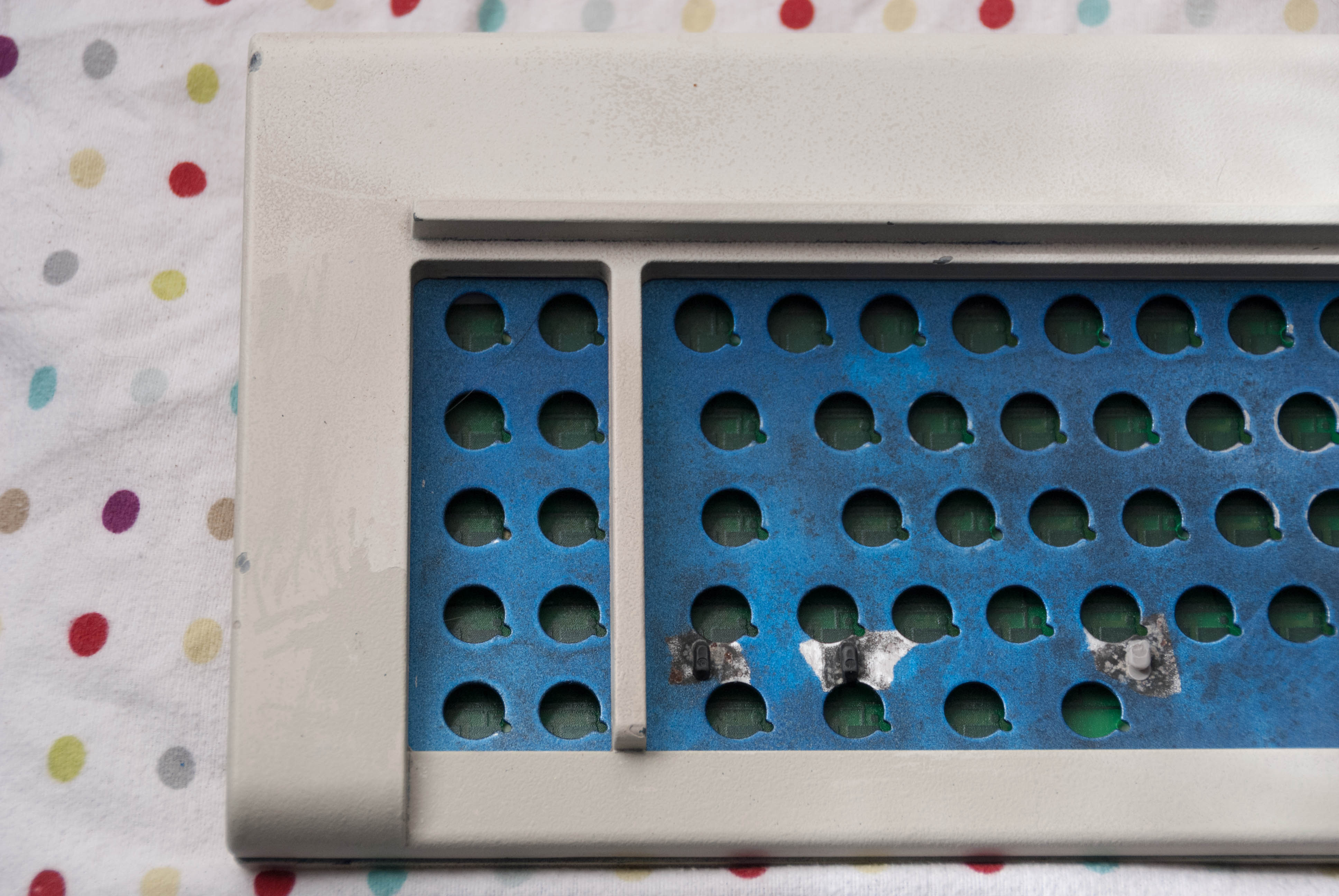

Soaked the keycaps in a bowl with warm water and laundry detergent for a few hours. Separated the windowed keycaps, and removed the labels. Everything looks great now, except for the tops of the windowed caps are a good deal yellowed, with some cracks in the casing.

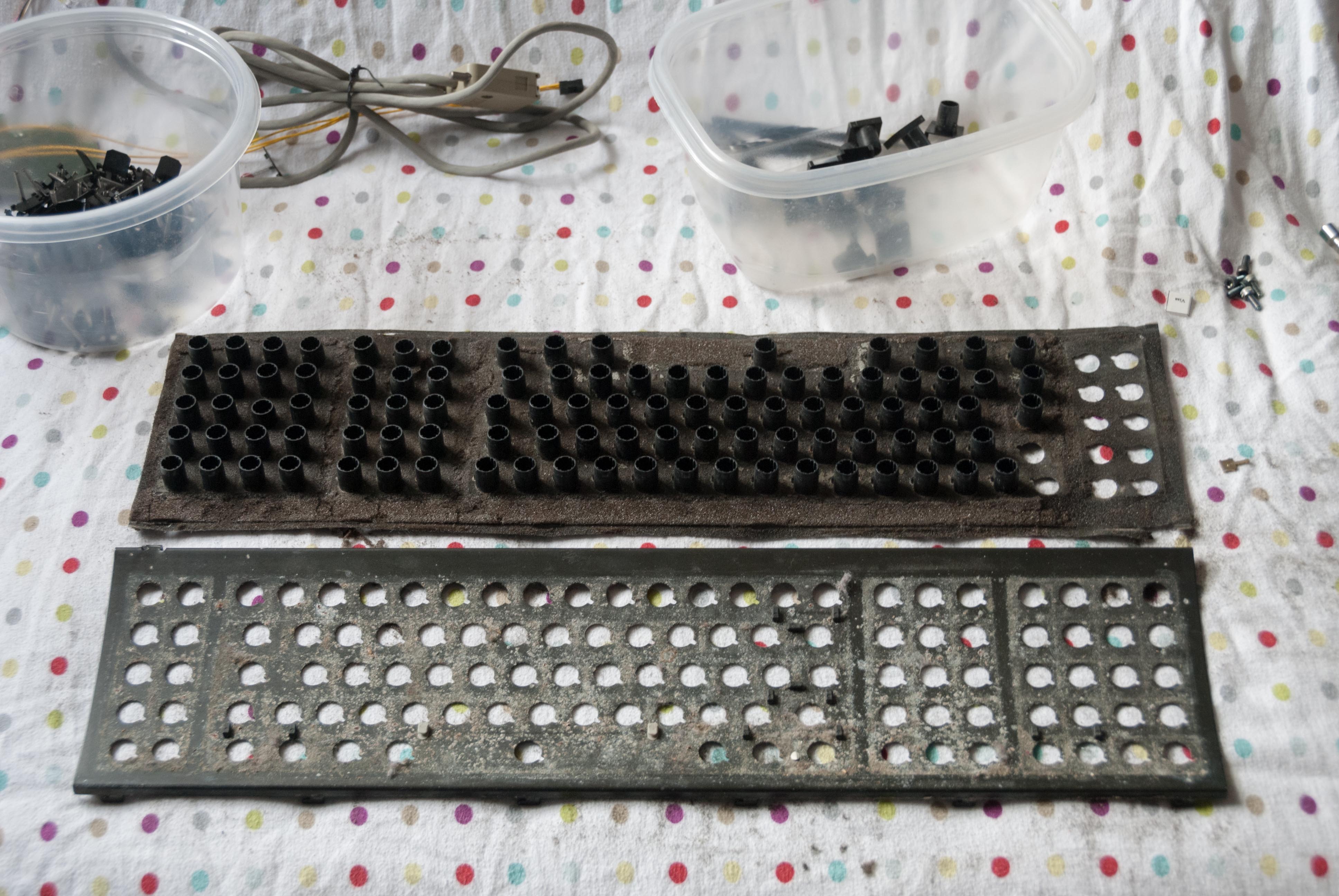

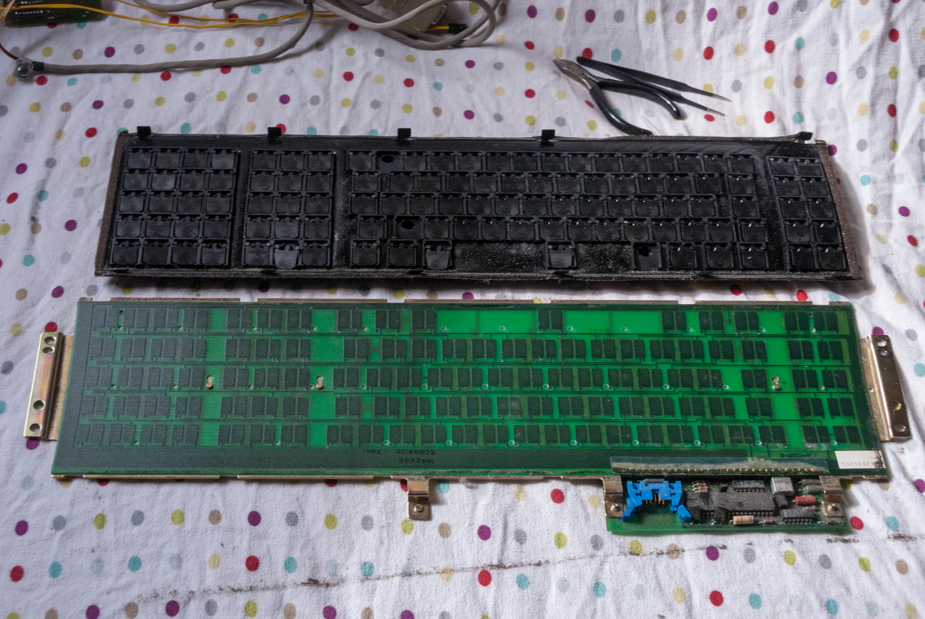

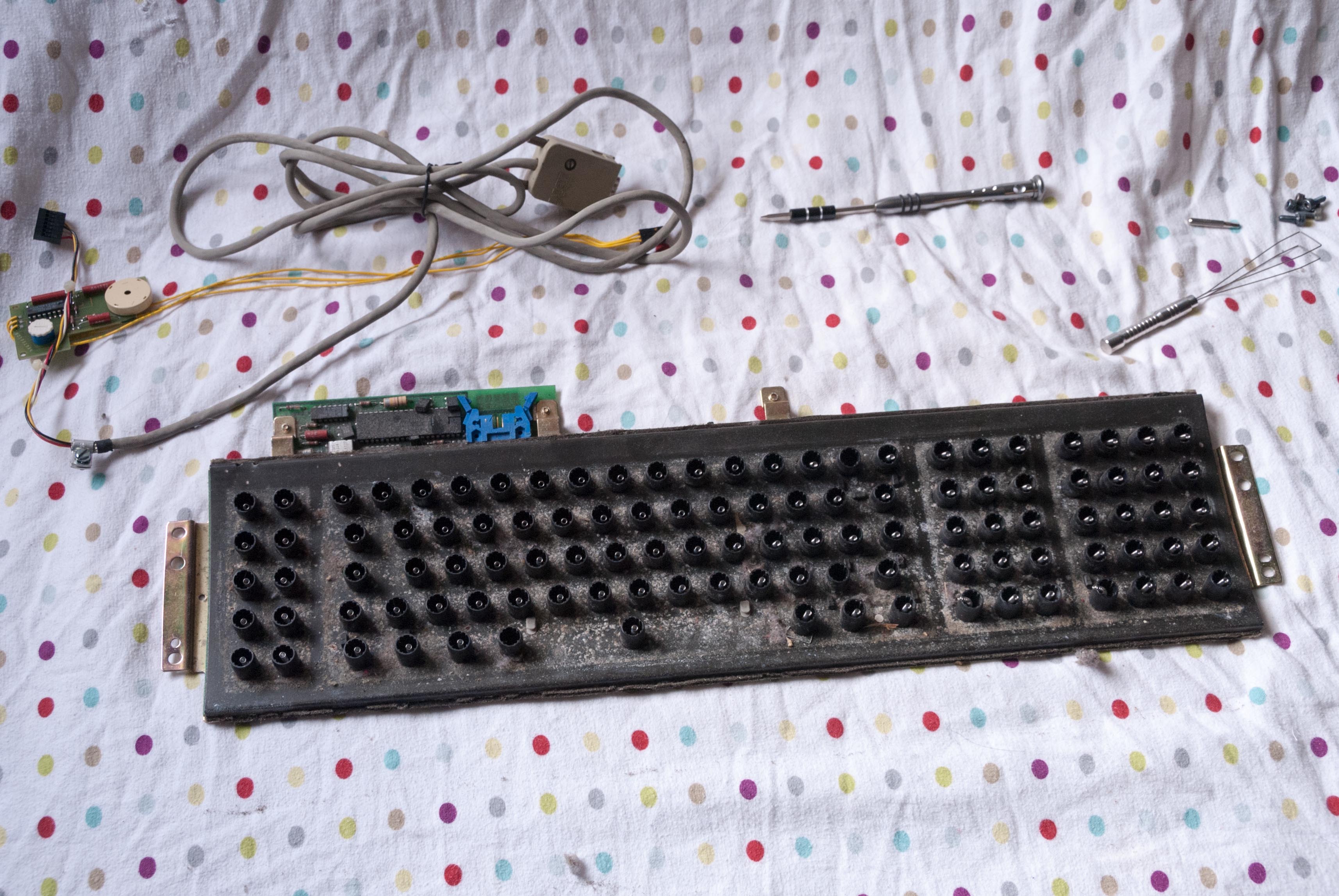

While this is the first time I have ever cracked the case of a Model F, with the amount of reading I have been doing here on these types of boards, I felt pretty confident I could do it. And sure enough, it wasn't bad at all. The barrel plate was clearly a mess. It had corrosion and a bit of rusting, as well as crap sticking to it like crazy. The PCB is in excellent condition. Besides a minor possible issue (which I will get into later) it looks great. All of the flippers (flippies?), barrels were also looking great.

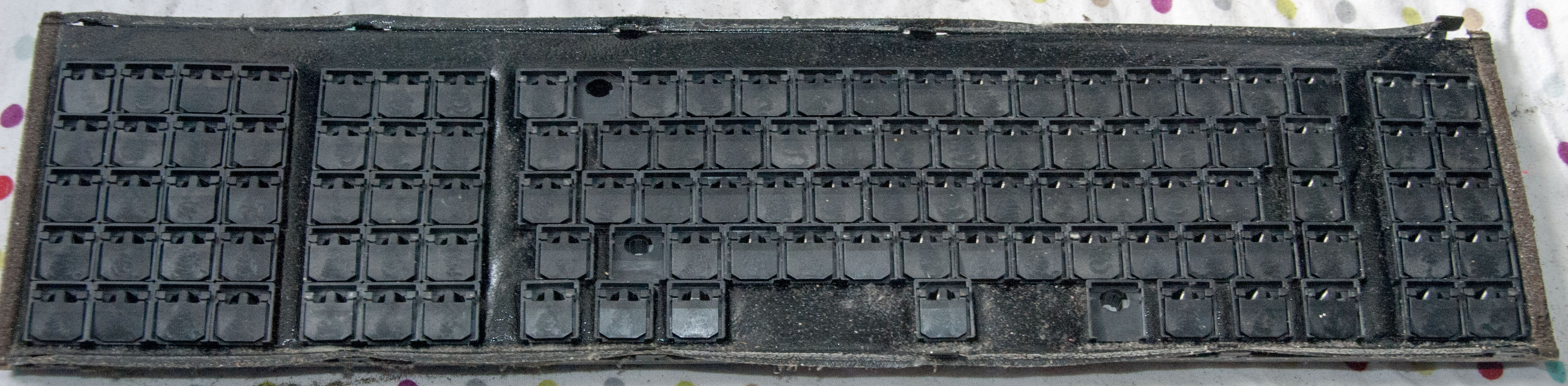

The foam however, was not okay. It was attached fine, but it was disintegrating. Its hard to describe, but some of the sections had no foam left at all. I tried to be as careful as I possibly could when removing the foam from the barrel plate, but in the end it had turned the sheets I had been working on (weird place to work I know, but that room had some good lighting for taking pictures) black with dust and bits of foam. While its not going to be easy, I am gonna have to replace the foam.

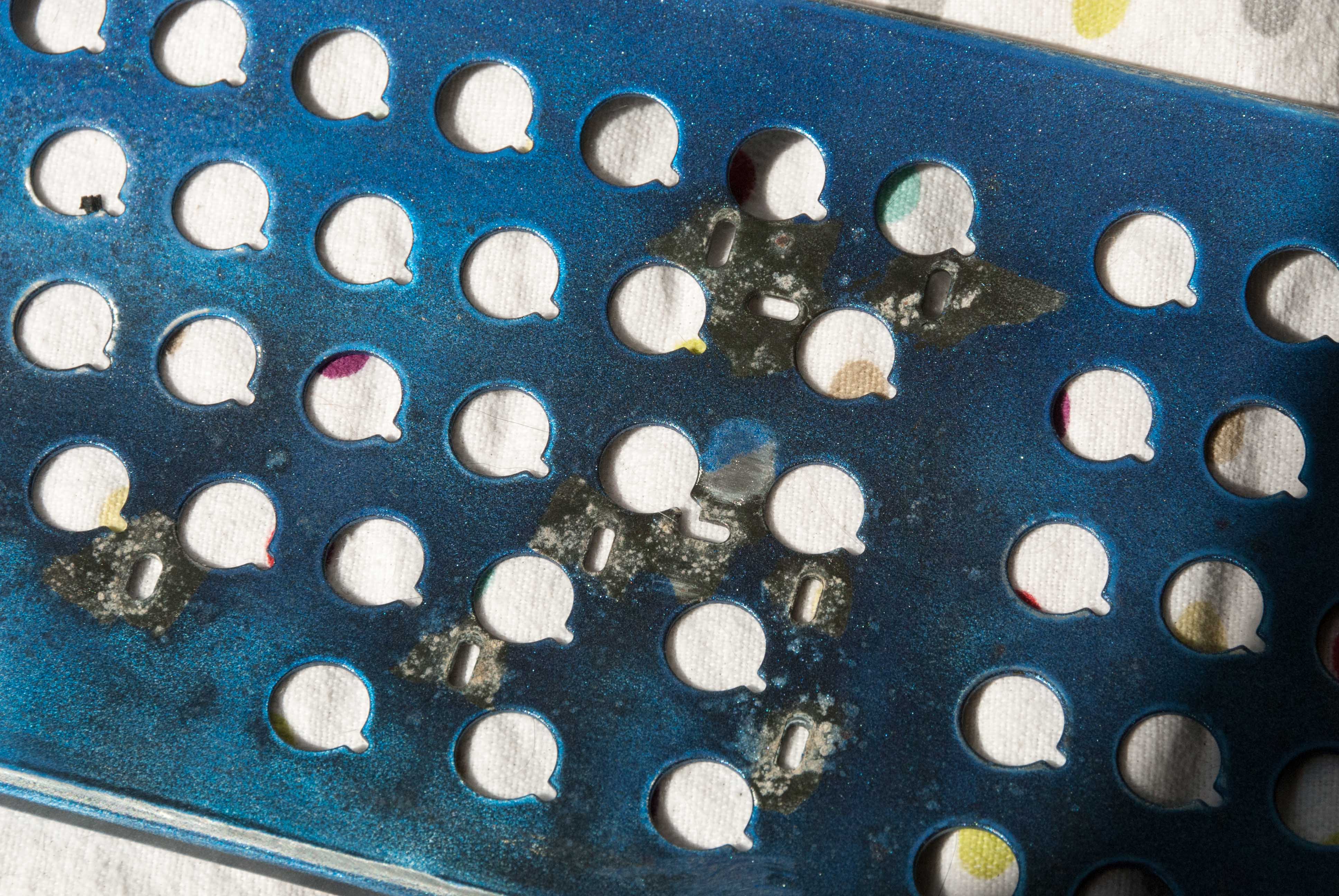

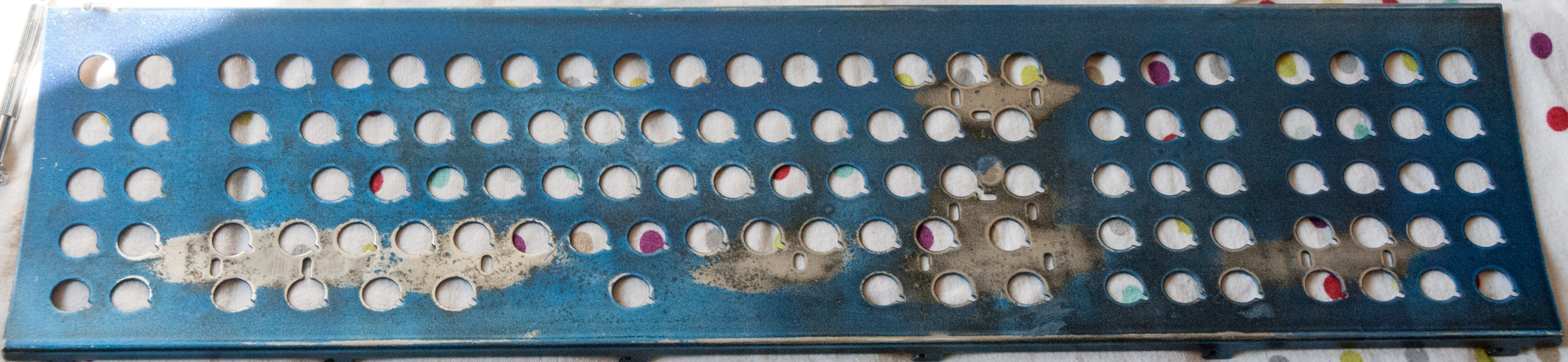

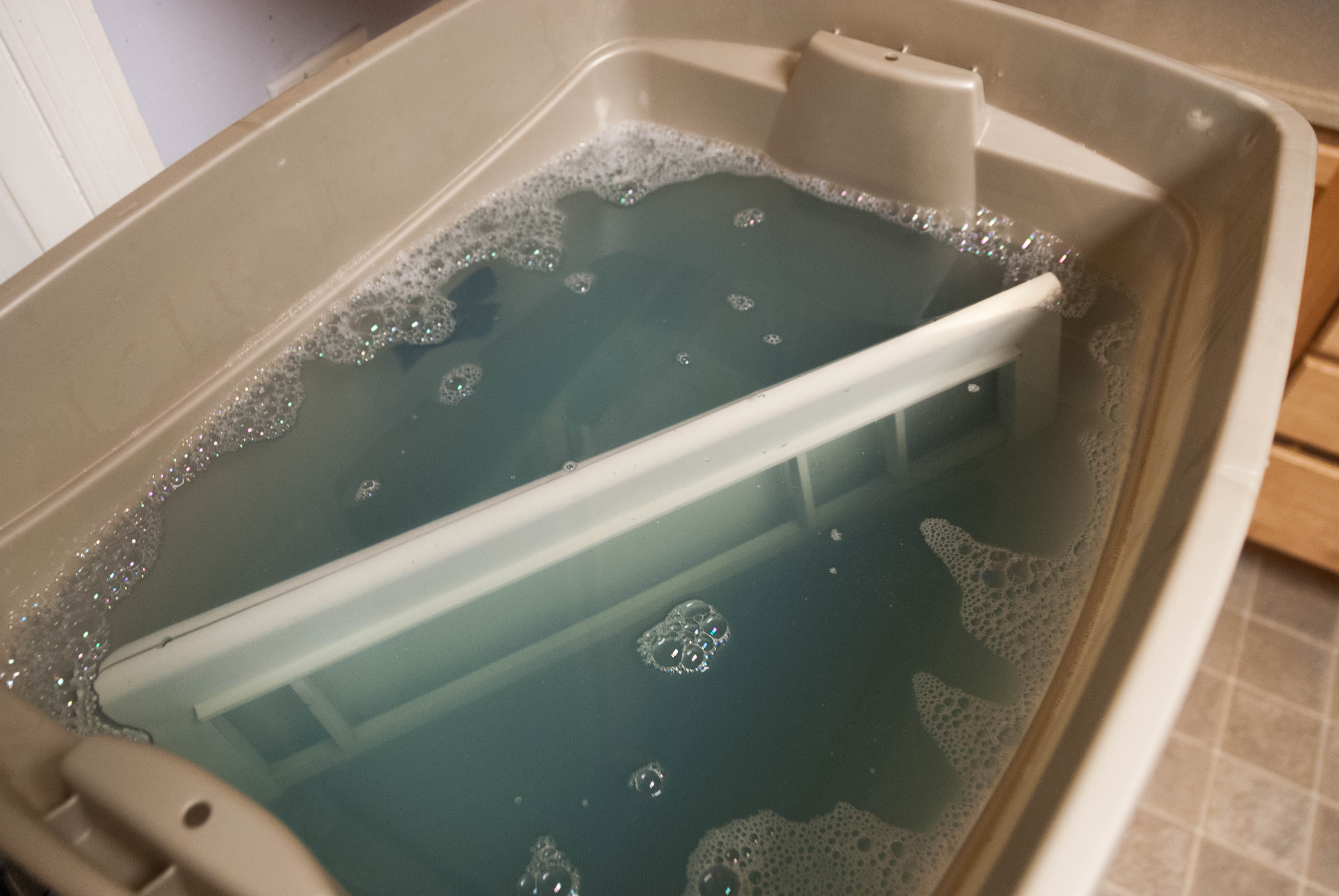

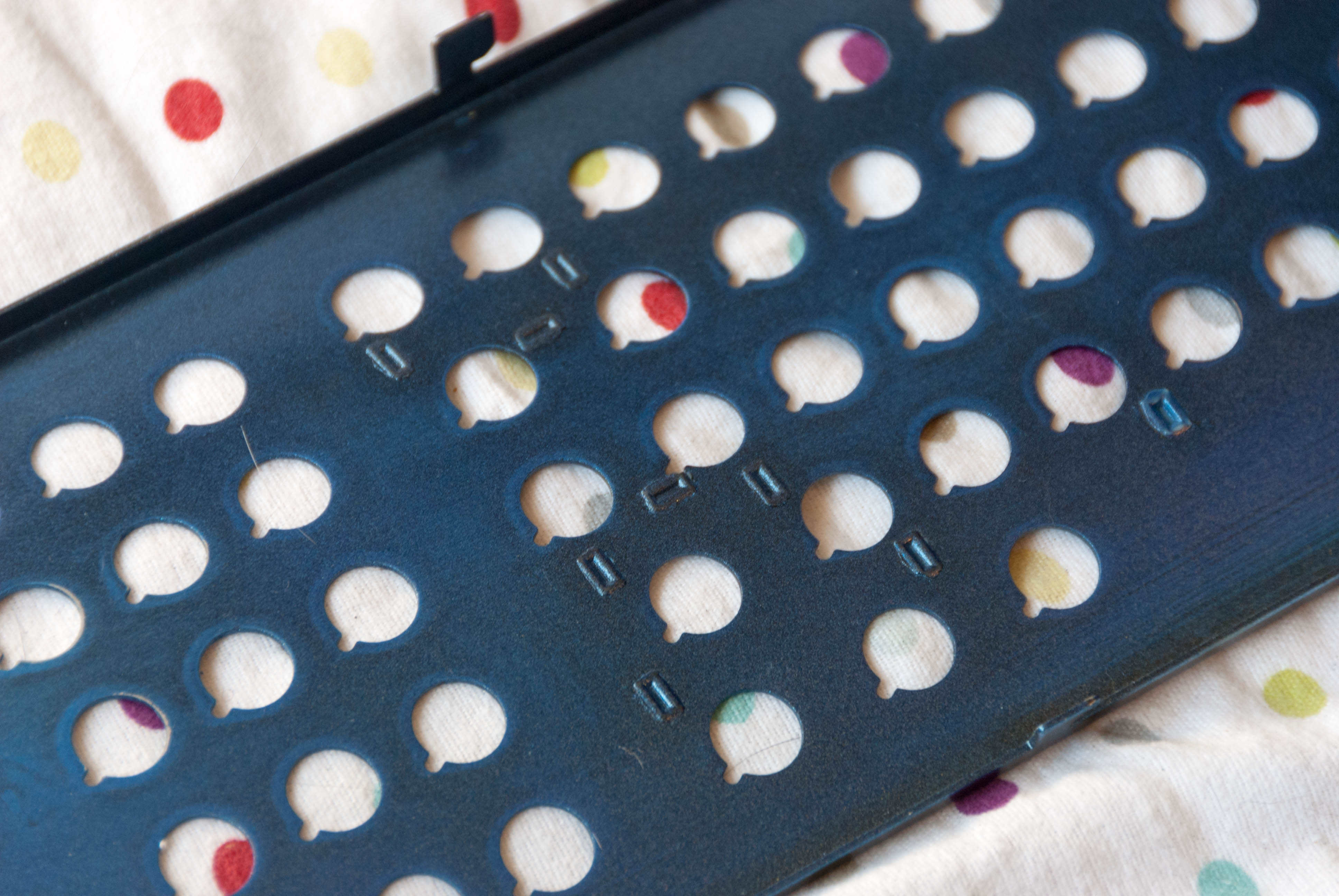

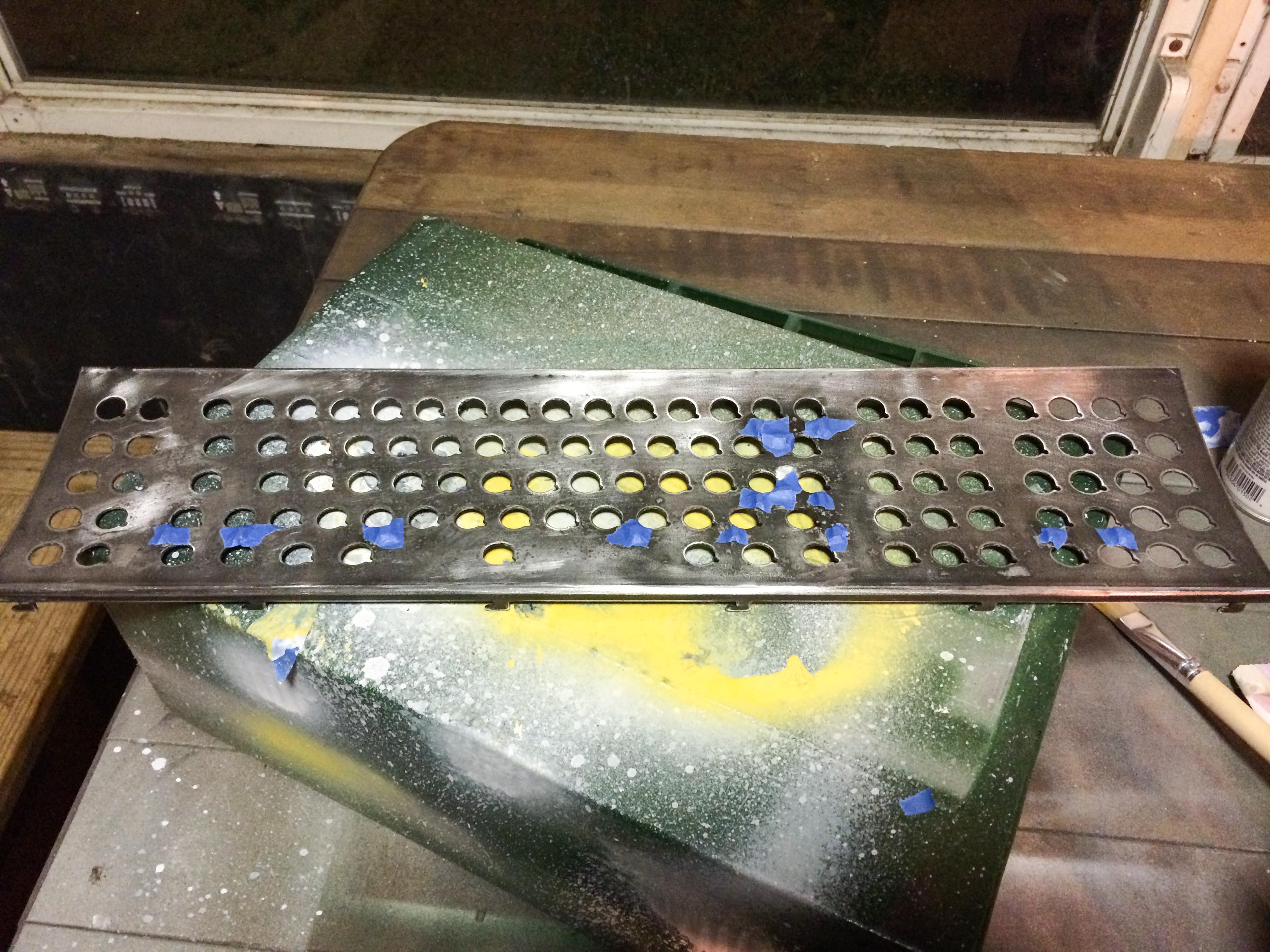

The next steps were to find a tub large enough to submerge the entire 12 pound case to soak it in detergent for a few hours. While it was soaking, I went and sanded down the barrel plate with some 600 grit sand paper. I got it as smooth and corrosion and rust free as I could. In order to keep it rust free, I taped up all of the stabilizers, and sprayed it with a few coats of Rust-Oleum, Stops Rust paint. I sanded in between each coat with 1500 grit, and gave it plenty of drying time. I am aware that it is blue, but it was the only adequate paint I could find at the time :lol:

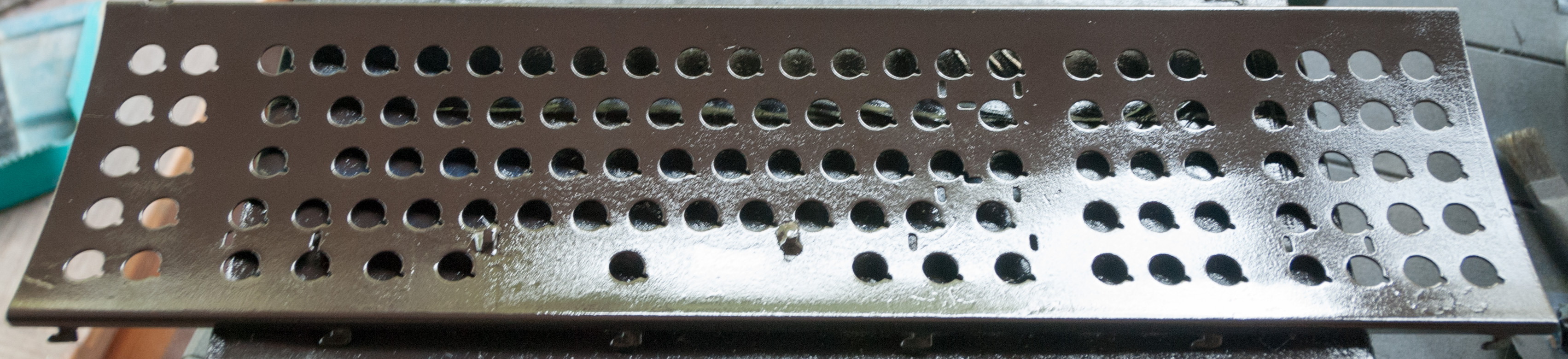

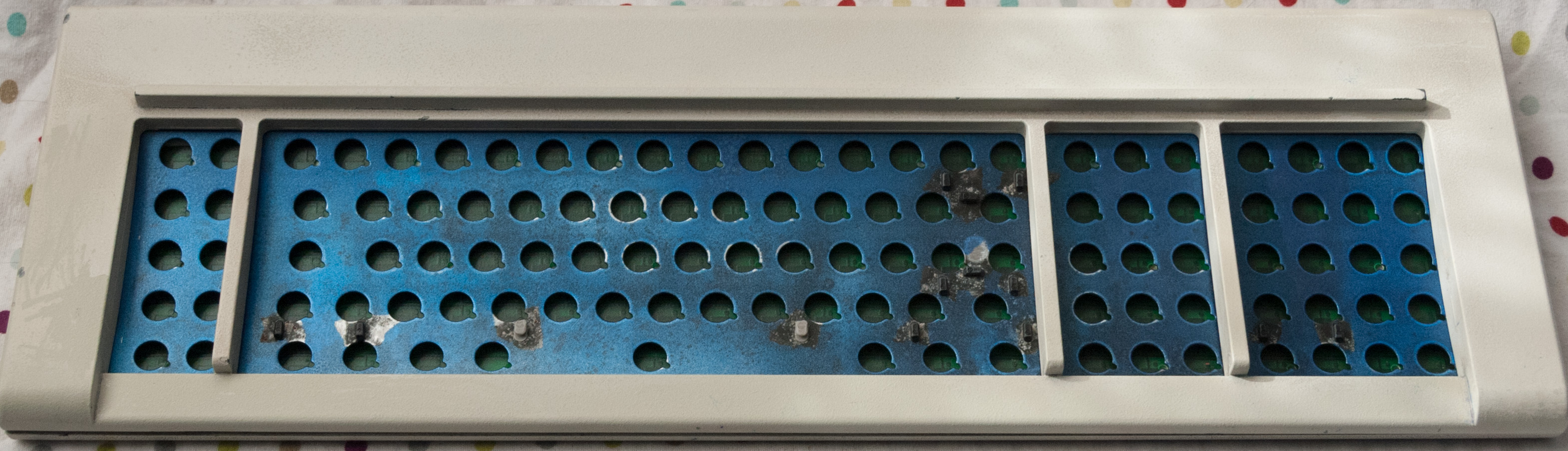

Finally, this is how everything looks after being washed, and sanded/painted. As you can see the paint does not look great. Some how it looks like I might have scratched a bit of paint off of the left hand side, and there is discoloring around the top. It looks a hell of a lot better then before, but still not perfect.

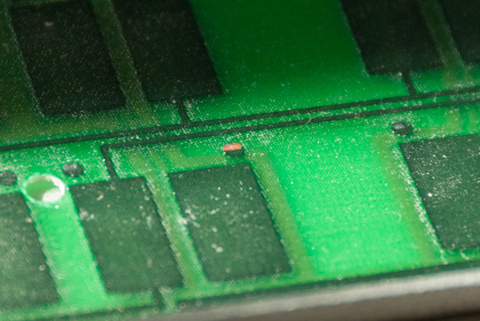

I mentioned that there was a tiny, possibly non existent problem on my PCB. It looks like a bit of the solder mask chipped away on this part of the pad. I understand the basics of how these capacitive switches work, but I can't really tell if this small chip is really going to effect anything.

There are already a few threads here about the best kind of replacement foam to use in these Model F's. For example:
This excellent thread
There are a lot of options to choose from. Any feedback on the foam mat, the PCB, or what to do about the case... Actually, any feedback at all would be greatly appreciated. Also let me know if the amount of pictures here was overkill, or if I should add the images into spoilers or whatever to make things load faster. I will continue to update this, when ever I make any more progress.

i would not worry too much about the solder mask as long as its not on the switch area it will be fine , i removed the mask on mine ( when i say mine i mean my 122) in one place on each row and each col to test continuity and had no problems so don't worry about that if the whole trace was bare and it could corrode then yeh possibly worry about it but i would not think twice on what is shown in your photo. (EDIT: fi anyone knows a good way to clean a PCB i would love to know as my backup XT PCB is very dirty i tried mild soap and water but its still very dirty)

Thanks! Good to know about the soldermask. It didn't really look serious, but good to know its probably fine. The case is all metal, its what most contributes to its 4.5kg weight! Like you said, getting it repainted sounds like the best option. I have seen some really great looking powder coated and painted Kishy's here, so I imagine I can do something similar.

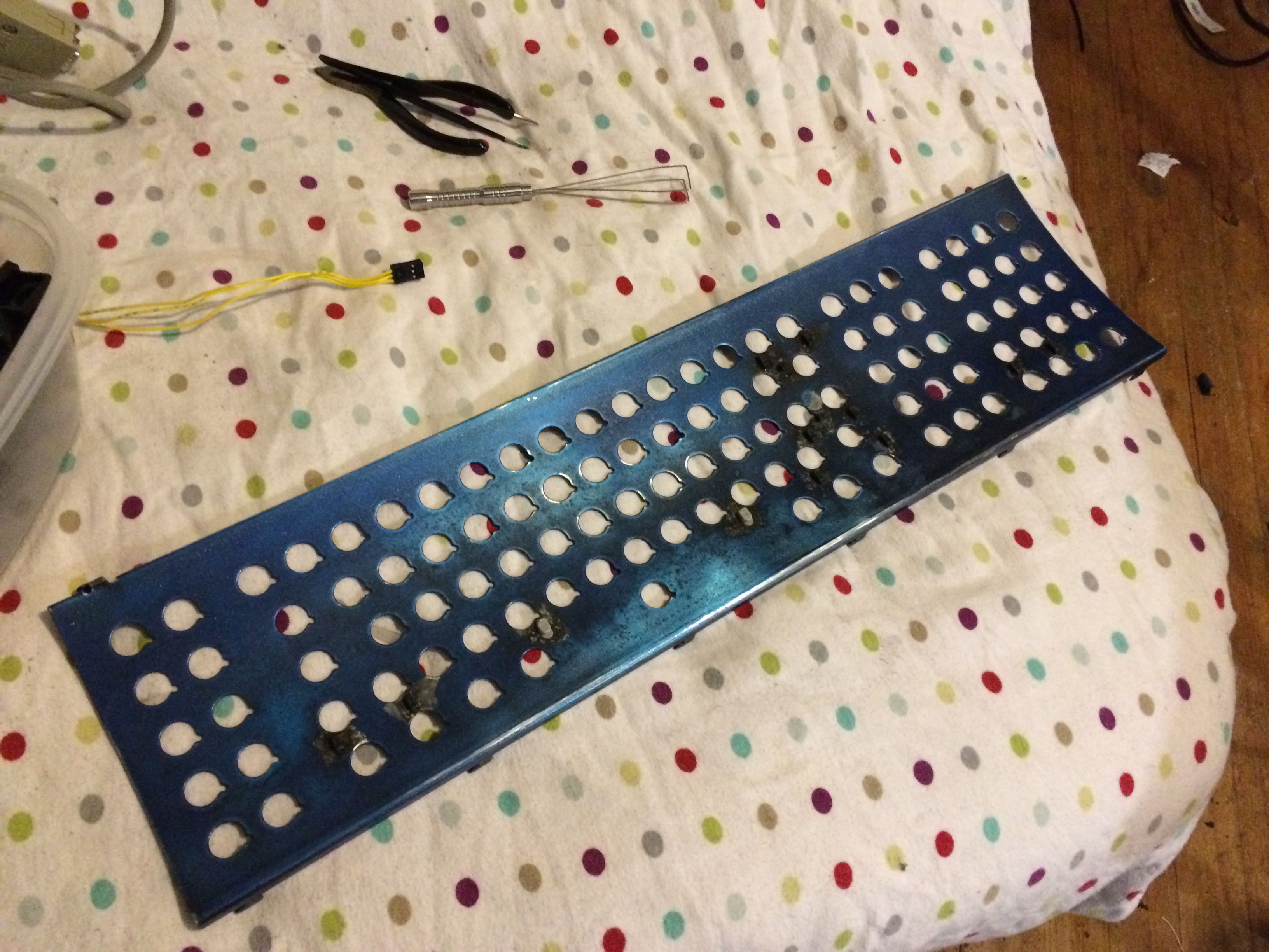

Hey, Im restoring mine aswell! Thought id share a few quick snaps but my camera is to crappy and no good light source was near. Ill try in the morning! Besides opening it to check for corrosion Ive only switched the yellowed and rusted connector for a brand new one from on of these: http://www.ebay.com/itm/380994154944
Contrary to what I read on gh, mine opens up with a torx 15 bit, Oddly enough It looks as if some one started to sand it.

My case also opened with a torx bit. I don't remember what size though. And what part does it look like someone started sanding? The barrel plate or the case?

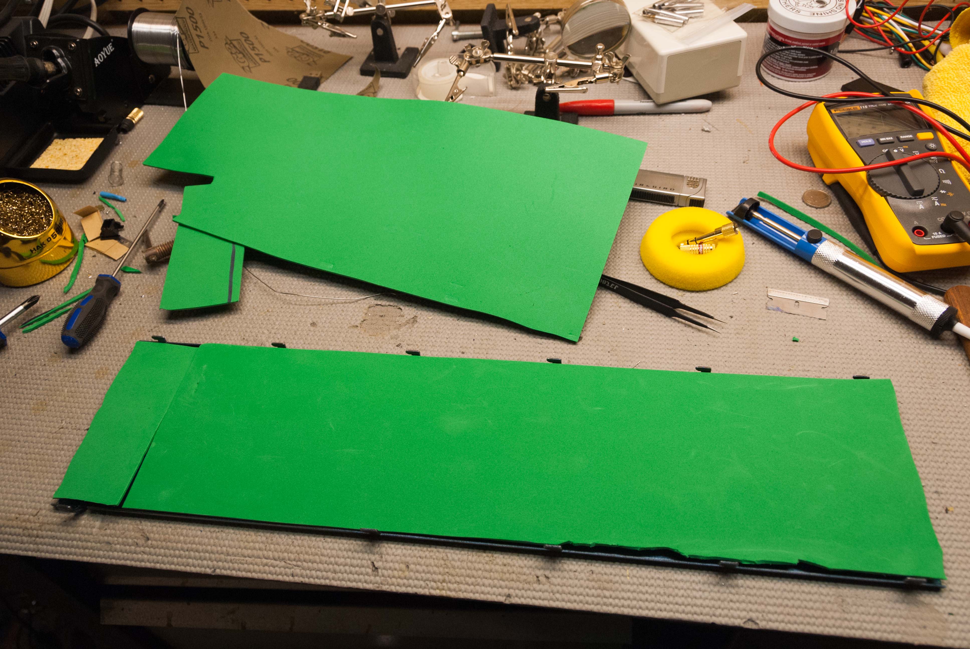

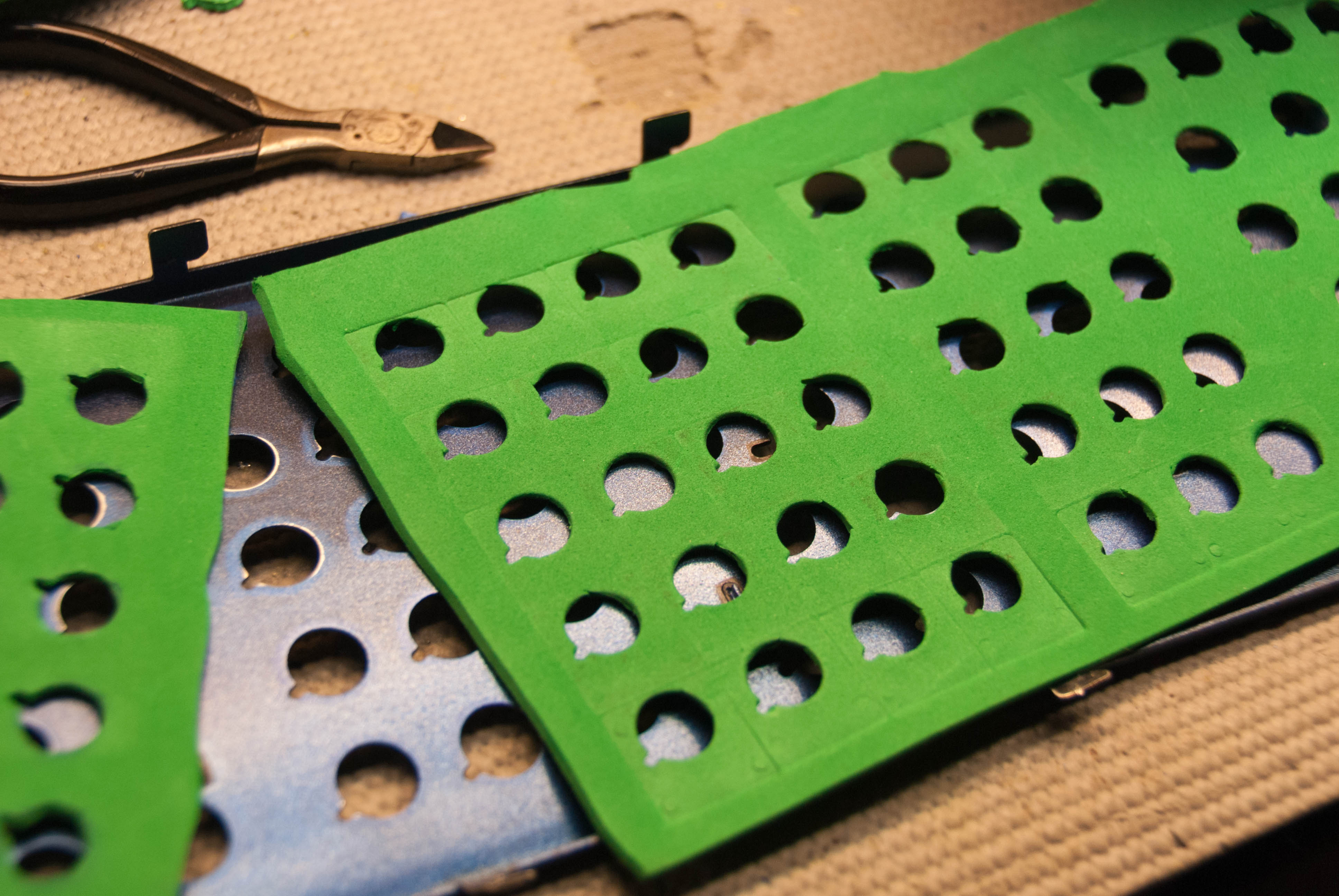

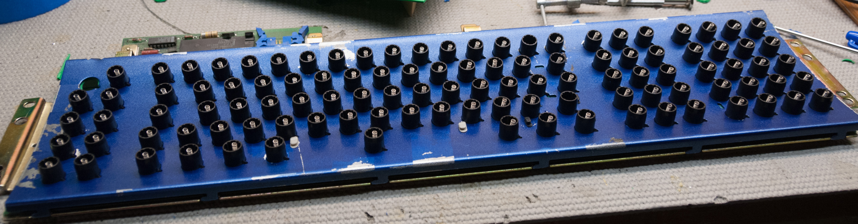

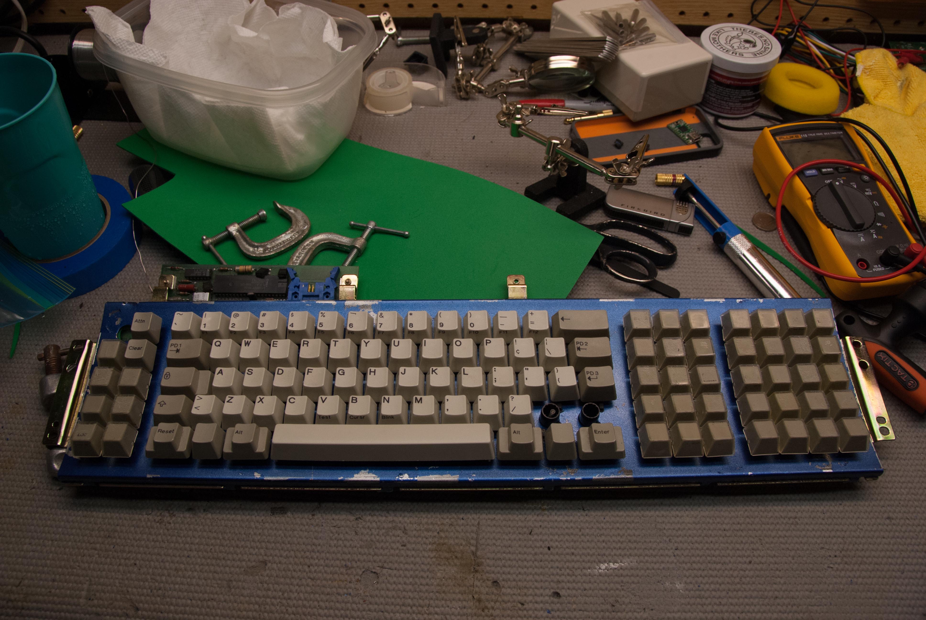

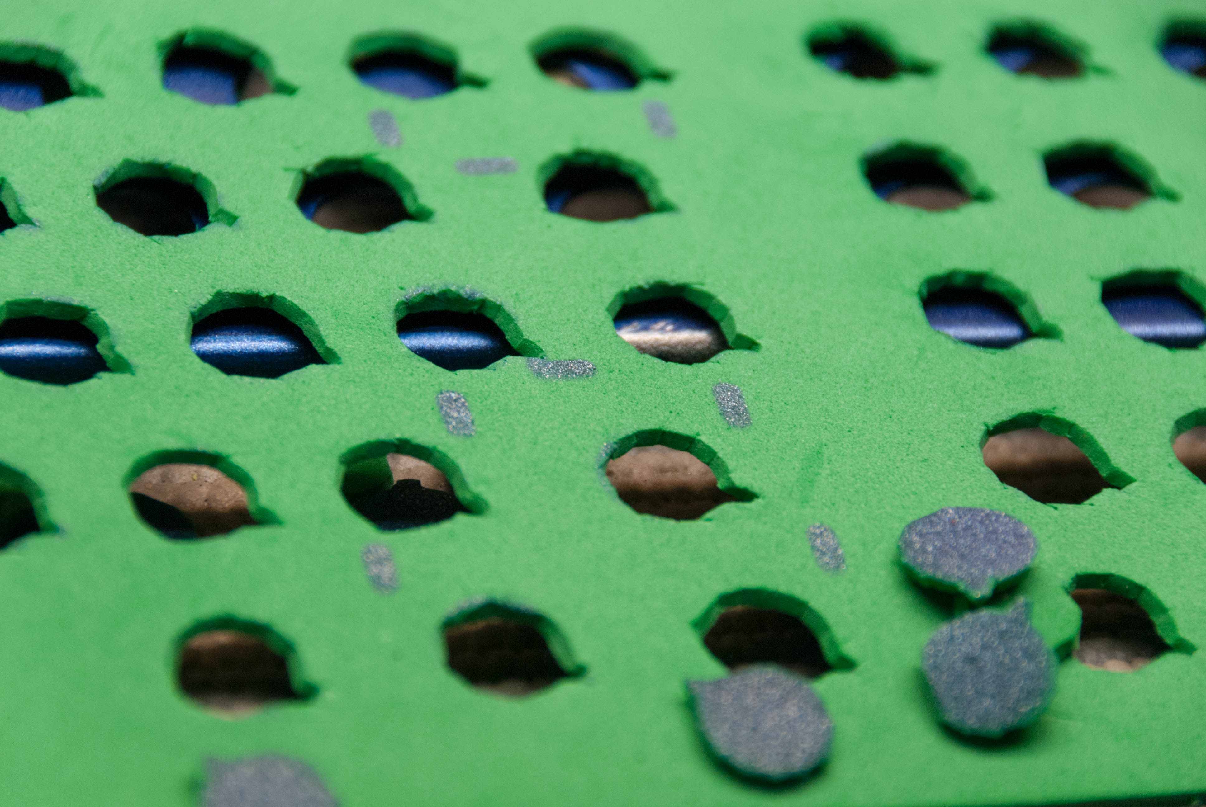

I realize that this thread has a ton of photos in it already, but I will show no mercy. I will continue to fill this thread with pictures, mobile users and capped bandwidth users be damned :evilgeek:

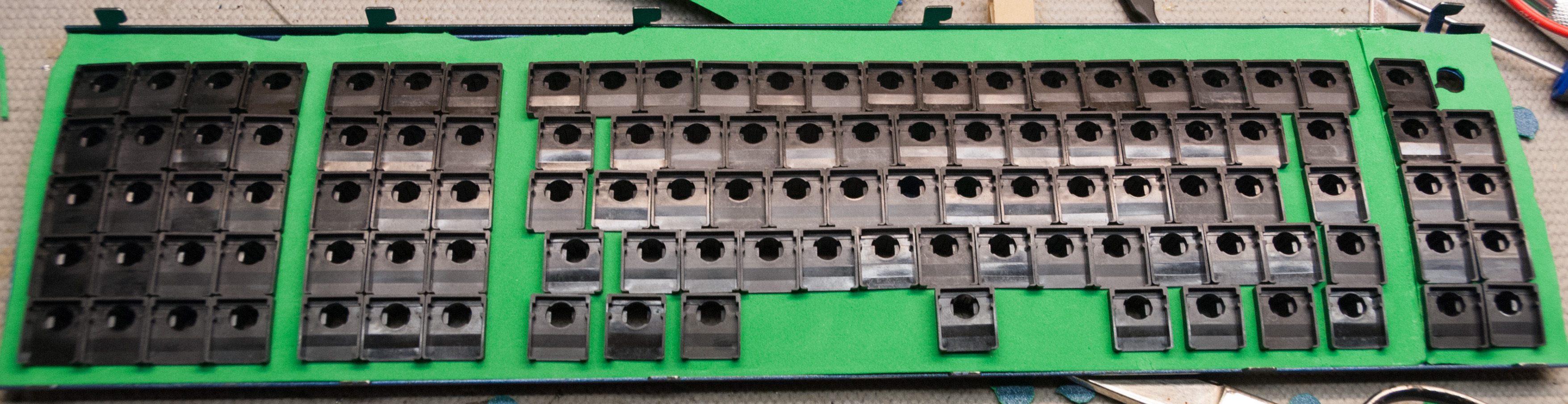

I made great progress the past couple days. I managed to quite easily tackle the replacement foam issue. Based on reading a bunch of threads, I chose what was not only recommended, but would be the cheapest and easiest to obtain. That would be .49 cent sheets of craft foam from the local craft store. I picked up $7 worth, and only used 2 sheets. Overkill at its finest.

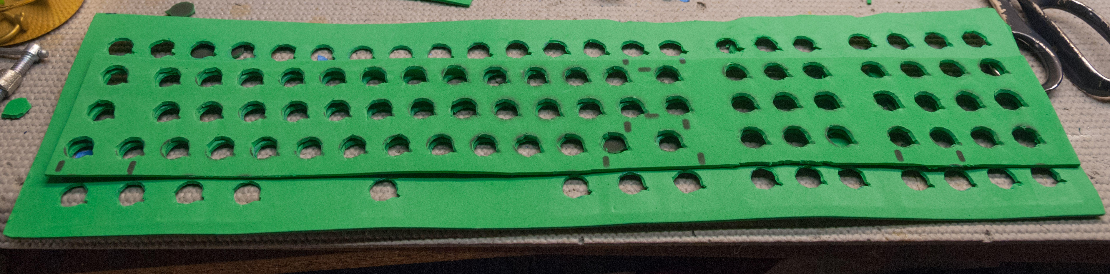

I want to start by saying that I did everything manually, with scissors. I have the proper tools somewhere buried in the mess of my workshop, but due to impatience, I did just about this entire process using scissors and a razor blade.

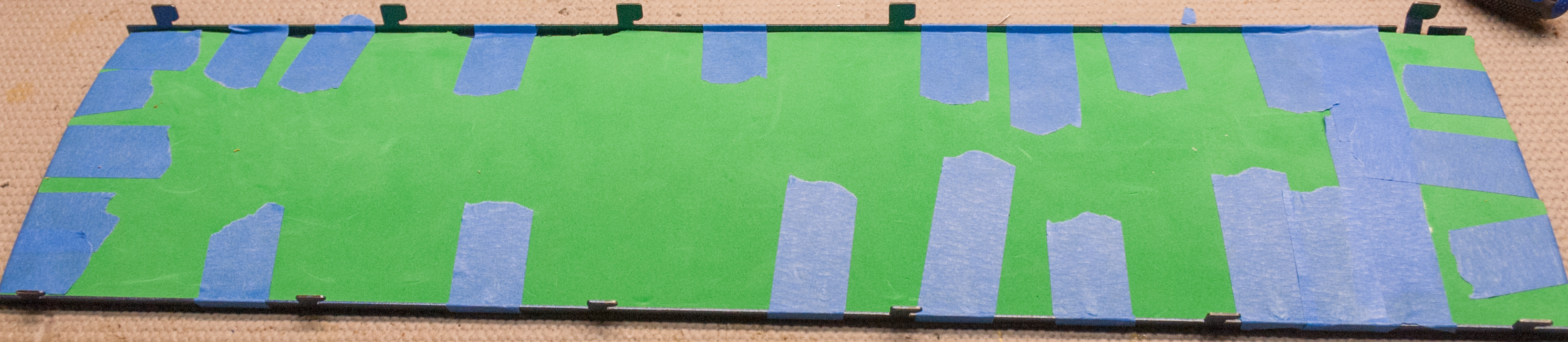

Cutting the foam horizontally was the first step. Getting it to fit into the edges of the barrel plate, was easy. The first thing that I noticed was that being such a huge ass keyboard, the foam that I bought would not reach the last (technically first if looking at it right side up) column of 10 barrels. So I had to cut out a separate block. I taped the felt down to the plate with what I thought would be safe, blue tape. Then I did a coat or 2 of paint onto the plate, leaving wonderful outlines on the foam.

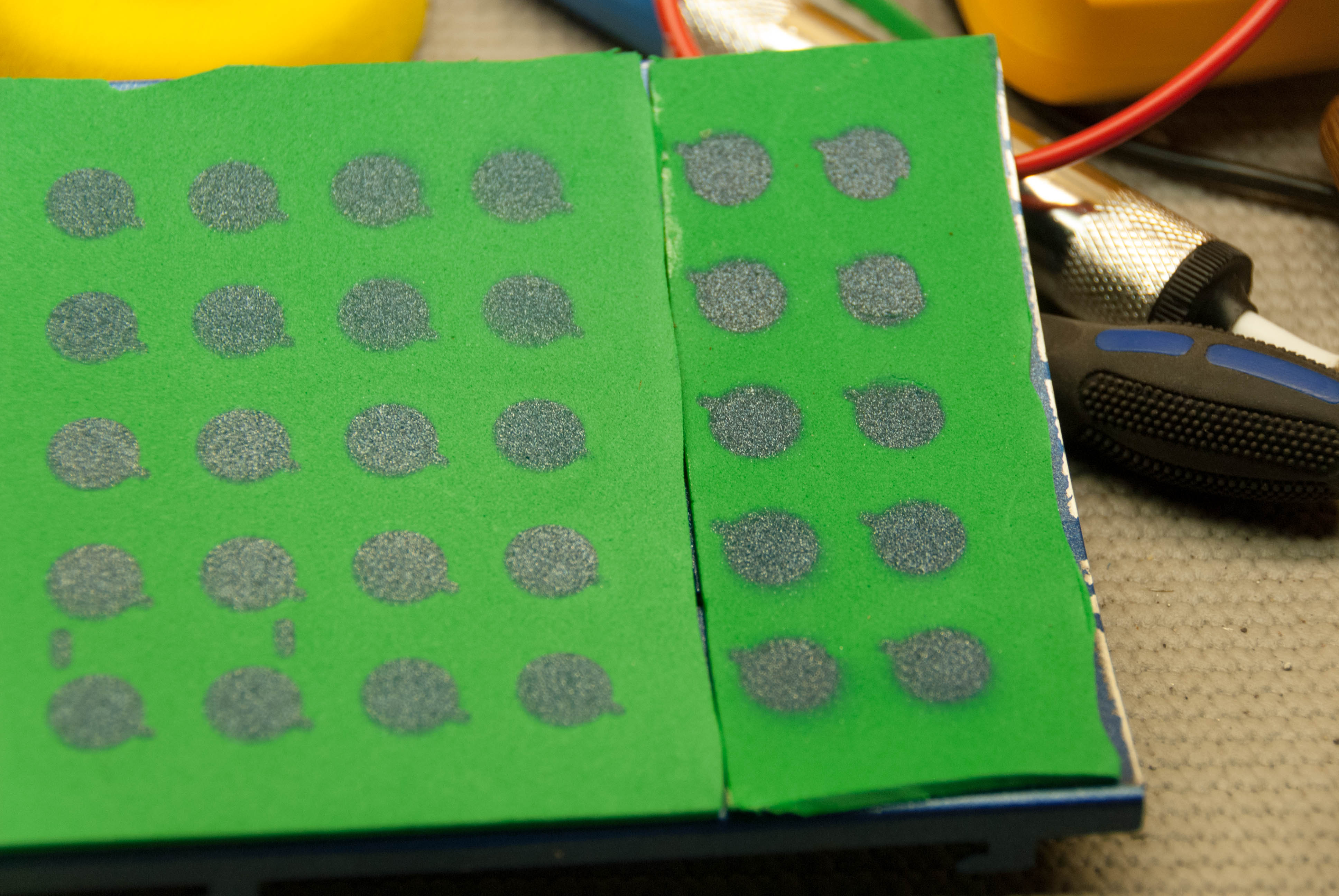

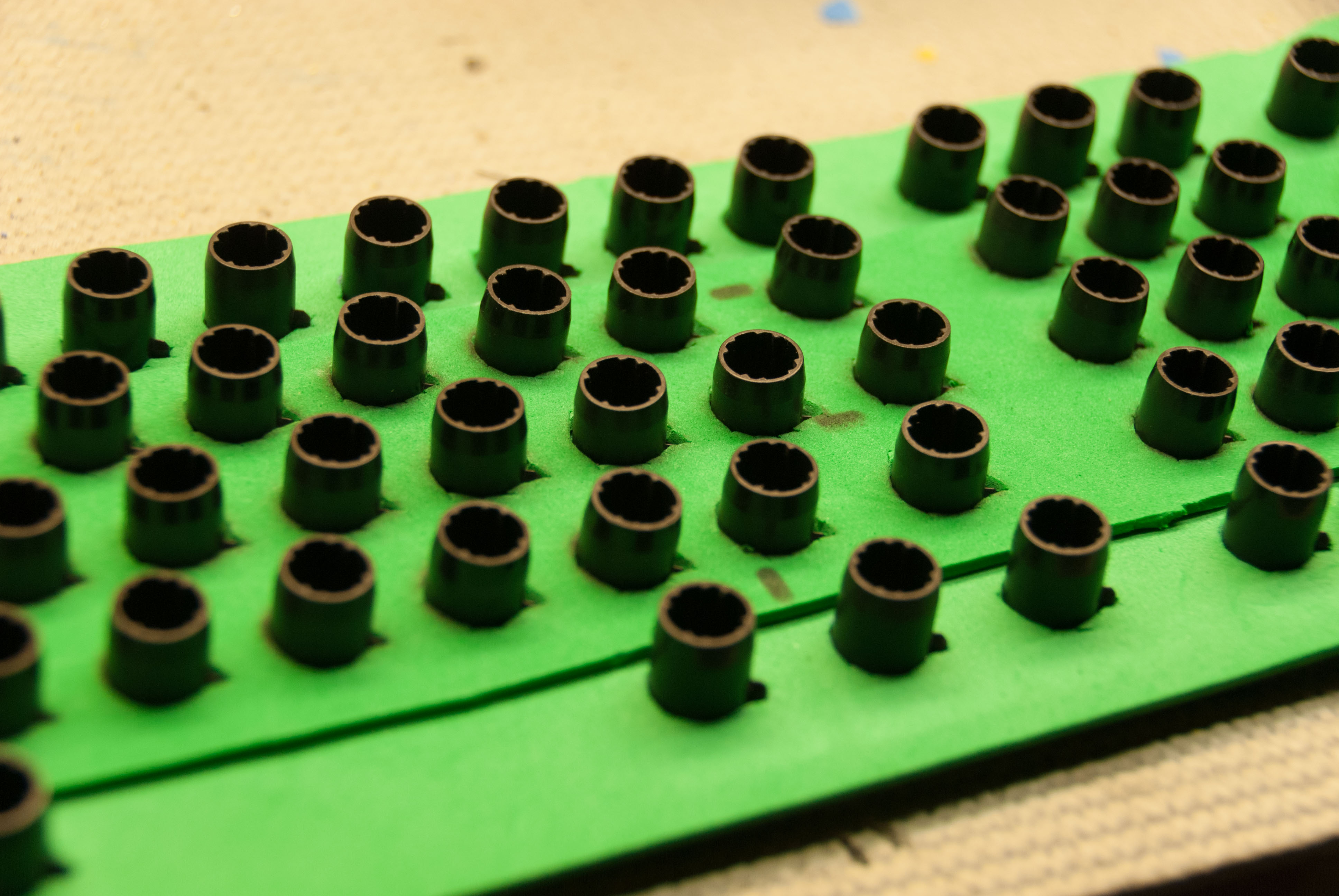

I proceeded to cut out each individual circle. At this point, I was planning on using my drill press to cut out each individual circle. I tried on the first hole, and it tore up the edges of the foam pretty bad, and it also meant I would need to cut out the small notch manually, anyway. The only x-acto knife I had was super dull, so that meant, and like I mentioned, my leather punches were buried, and I had no desire to go dig for them. In the end it took me about an hour exactly to cut out all of those holes. While they don't look pretty, they hold the barrels perfectly, and I didn't manage to screw any of them up.

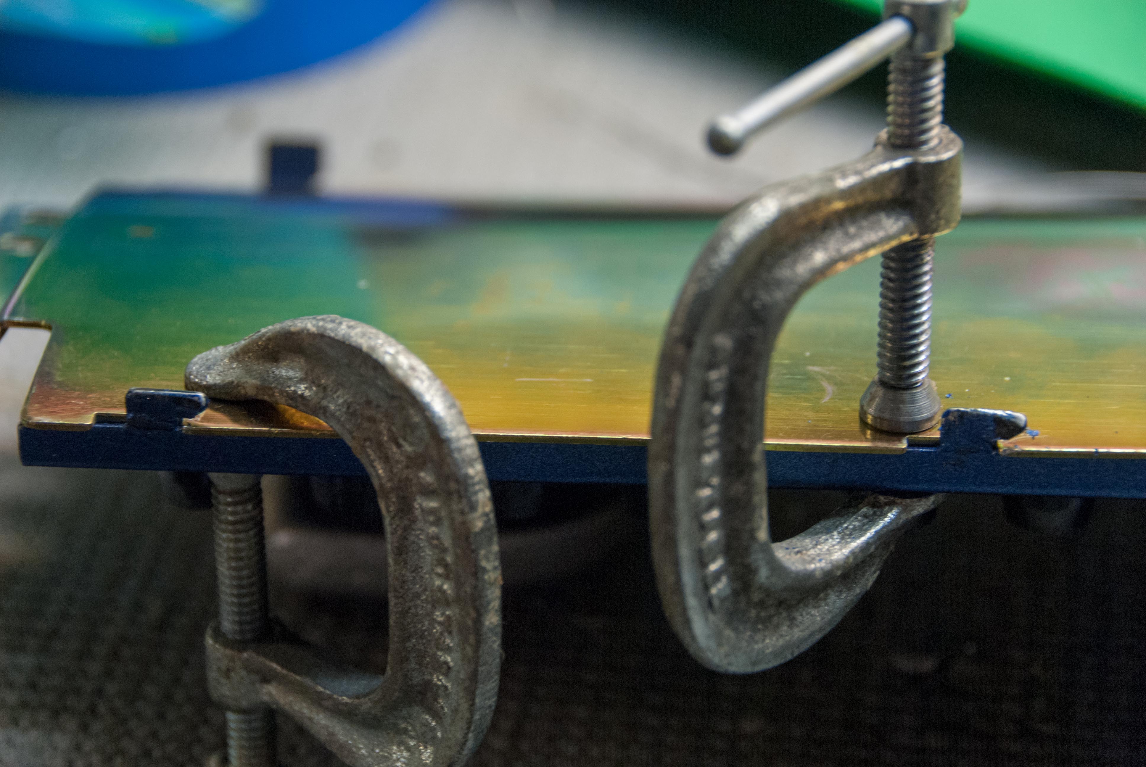

This part was the most tricky to figure out. I still don't know whether I did this appropriately, but I do know that it works. After installing all the stabilizers in backwards (minus the spacebar) and popping in all of the flippies (including some in the wrong barrels), I needed to find a way to get the PCB onto the plate. The same thread that was fohat mentioned using craft foam, there was also discussion about using clamps for something. To be honest I did not read that entire thread, as carefully as I should. When I got to this step, I knew exactly what they were talking about with the clamps. These are the steps I used to very easily get the plates back together. I don't have any more pictures of this process sadly:
  • 1. Lined up the PCB and the barrel plate, and hooked in the side of the barrel plate/PCB with the longer fatter metal tabs.
    2. On the side with the smaller thinner metal tabs, I took a pair of needle nose pliers and bent them back from the plate.
    3. Using clamps I tightened the PCB and plate together, until the PCB passed the edge of the tab.
    4. Then I bend the tab back into place over the PCB using pliers, and do that for all the tabs.
As you can see, the plate looks like crap. The paint got torn up for a couple reasons. The primary being the fact that I did not really give the plate time to cure. This probably only had 6 hours at most to cure from the last coat, to trying to assemble everything. The clamps, the blue tape, and a screw driver (inserting stabs) all proved to destroy the paint. For this reason, I highly recommend allowing any paint 3 days to fully cure (yes 3 whole days), as well as using heat shrink (or duct tape etc.) on the edges of the clamps. This should help to reduce the destruction of your beautiful paint.
I was impatient with assembly because I was already pretty sure I wanted to repaint the plate with a more drab color, and I wanted to test to see if that foam worked at all, or if I needed to get to work on something totally different.

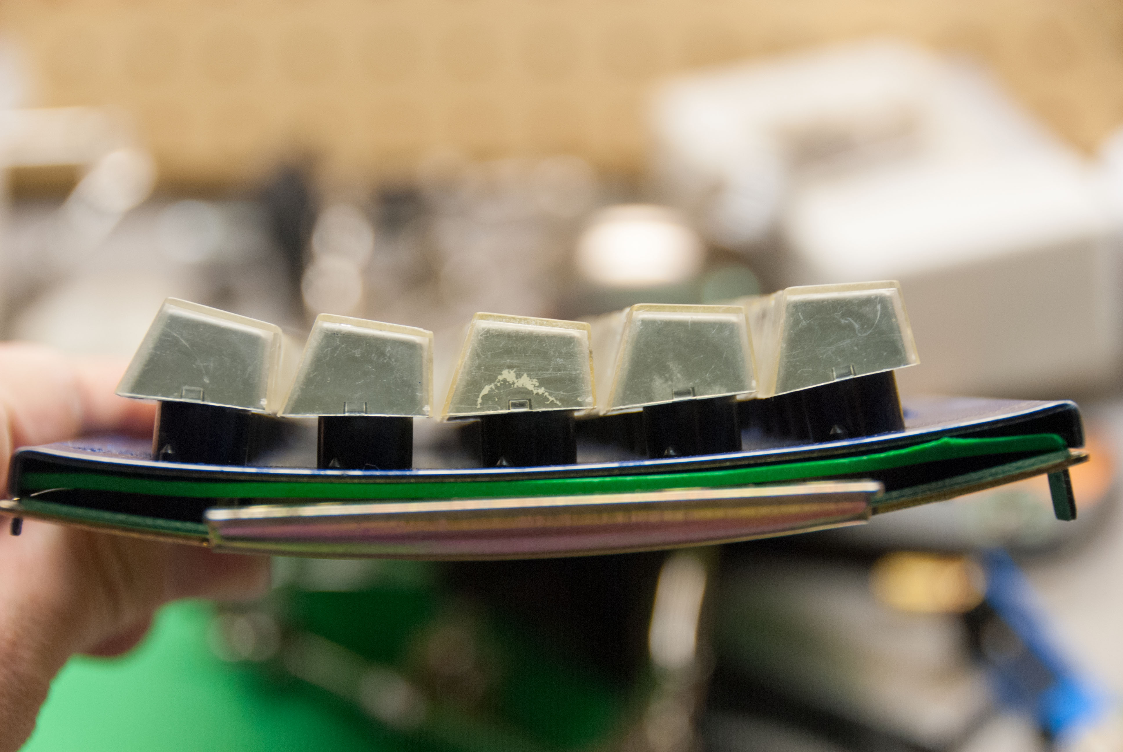

After assembling all of the keycaps, I noticed that the top and bottom row keys felt insanely sturdy and were surprisingly not all that pingy. The center 3 rows on the other hand felt very "light", they pinged like a piano, and if you wiggled around the "F" key, R, D, G, C, V, R, and T all moved around with it. I also found out that I put a few flippers in the wrong spots for the stabilized keys, and some how I have managed to lose a single barrel+flipper, with no freaking idea where it went!
Opening everything back up, I found exactly what I suspected. There was not enough foam on the middle rows. You can see by the marks left in the top and bottom row, with hardly anything on the middle 3 rows! I have remedied this by cutting out a second piece of foam for the middle 3 rows.
I have also decided to repaint the plate with a nice Walnut color. I am also clear coating the plate, and it is currently drying in a nice spot, and will be curing for 3 days. I will not be reassembling everything until Monday.
I will close this project update with a question. I want to update my key layout on this board. Specifically I would like to lengthen the left shift, possibly do a HHKB style right shift, and extend the enter key. I would also like to replace all of the windowed keys. I want nav keys in the first block of 15, and then turn the block of 20 into a numpad, with something like F1-10 in the block to the far left.

pyrelink wrote: (I assume the same as the XT caps?)
put a model m cap on a barrel right next to it ( with its top on) if they are a tiny tiny bit shorter they are XT caps but i think all 1 part caps are the same, and awesome ( at least the IBM ones )
Hypersphere
04 Oct 2014, 01:36
@pyrelink: Really appreciate your detailed posts with pics. This is extremely helpful for all of us who are undertaking work on our F-107 keyboards.
Regarding painting the plate, I learned from my work on my XT that you need to follow the recommendations on the Rustoleum can and allow the allotted time for drying between coats, which I think is something like 48 or 72 hours. I found that the best way was to apply several coats with light sanding between coats and allow the specified time between each coat. I used wet sanding followed by a thorough rinse with water and then a wipe-down with 70% (v/v) isopropyl alcohol to remove all traces of sanded paint before applying the next coat.
For my next project, at least for the 107 with its metal case, I think I will look into commercial powder coating. I had not realized that a commercial outfit could do the surface preparation for me -- this is the most tedious part, and yet it is vitally important.
