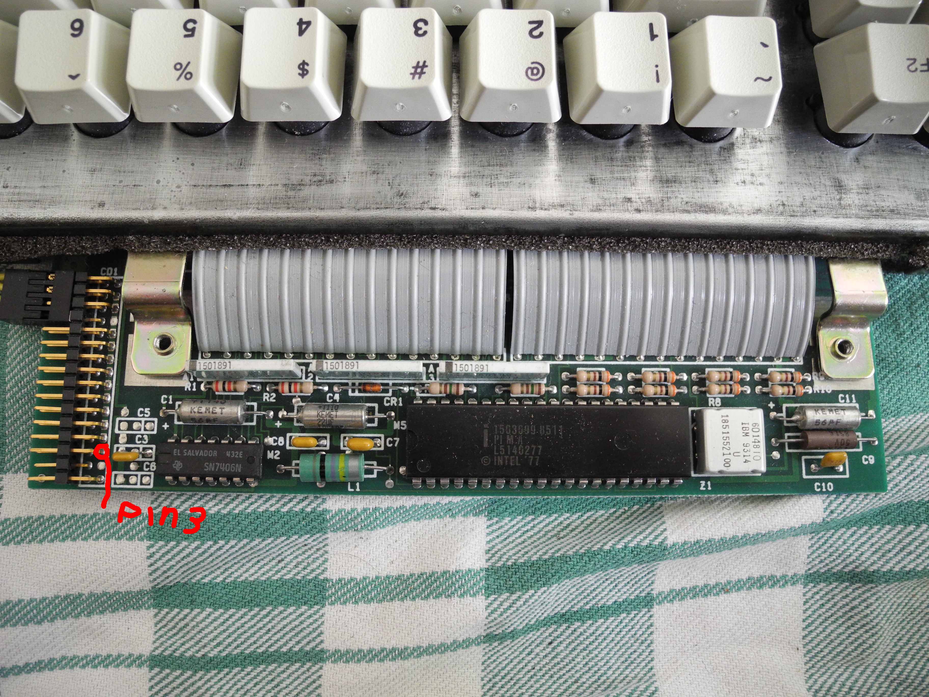

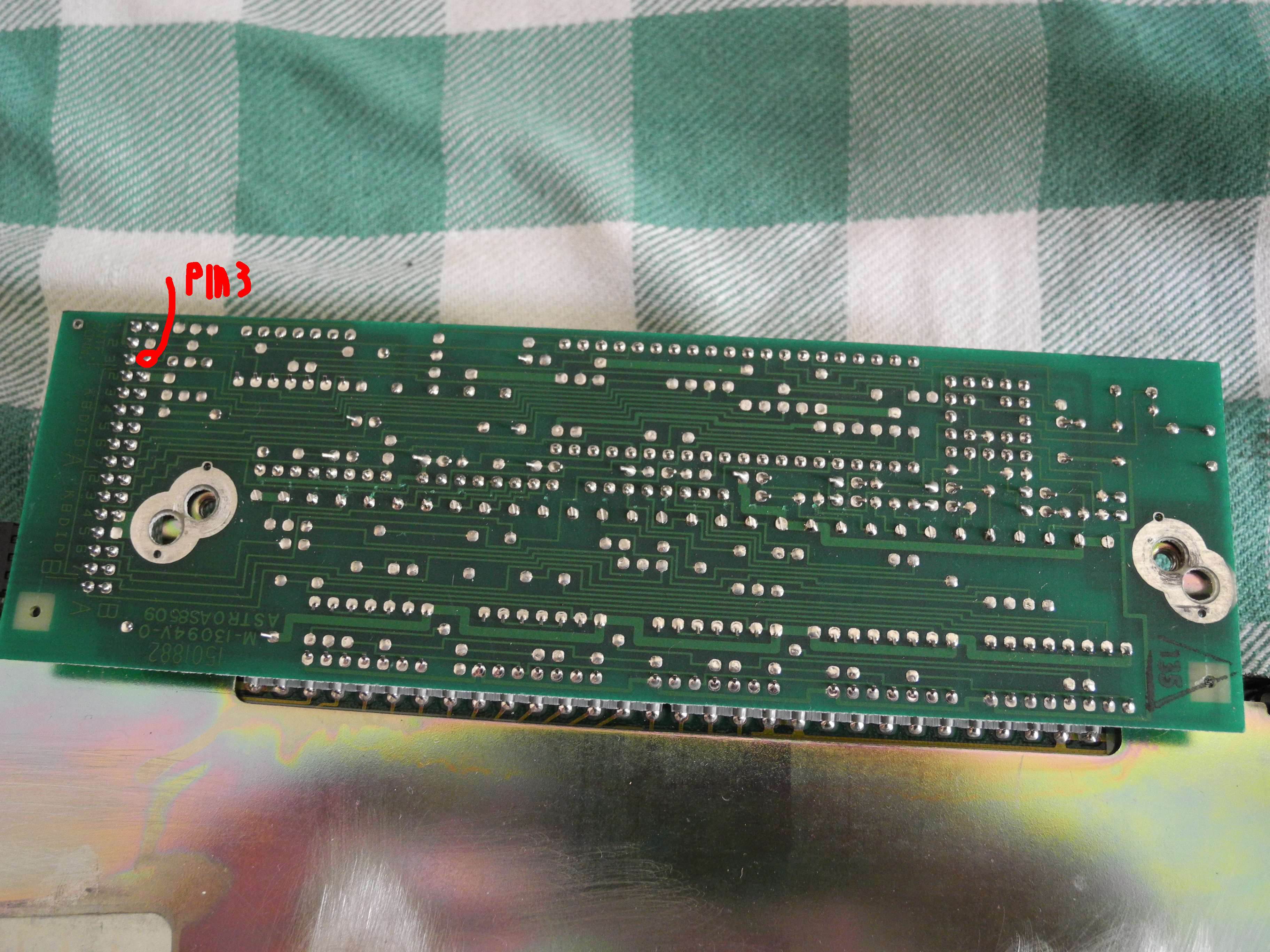

I also checked the cable:
cherry-jade wrote: white V
black G
red and brown c d or d c .
PS2 is OK.
Ground, Voltage, Clock and Data are all fine. These should be the PS/2-relevant lines. Also the shielding is fine. But the green cable comes out on the pin 3 of the DIN 5 connector (See diagramm below) but doesn't lead to anywhere on the DIN 5 to PS/2 adapter. Maybe that is the problem?
Here is, where Pin 3 connects to the controller:
DSCN3412 Pin 3.jpg (898.56 KiB) Viewed 6790 times
DSCN3417 Pin 3.JPG (885.03 KiB) Viewed 6787 times
Does anyone know what the marked Pin on the controller or Pin 3 on the DIN 5 connector does?
Posted: 23 Aug 2014, 16:19
by Halvar
The diagram of the connector that you posted shows it: it is unconnected and has no purpose. The AT and PS/2 protocol only needs 4 cables: data, clock, +5V and gnd.
Posted: 23 Aug 2014, 16:28
by Nuum
That's right, would have thought that, too. But I tracked the line and it connects to the capacitor C4 and then connects to one pin of C7, C8 and C4 and then goes into the bottom right pin on the "El Salvador" chip, where it splits and ends up at the black cable, which is ground.
Posted: 23 Aug 2014, 16:33
by Muirium
There was a fifth earthing pin on IBM terminal keyboards, which would separate at the controller and lead to an earthing wire which led to the backplate and often the space bar, too. The keyboards work fine without it connected. Although I actually use the earth provided by the USB socket. You can earth by connecting to the outer shielding foil in USB cable. In fact, standard practice is that the exterior of USB, DIN and mini-DIN sockets are all earthed, so you just ride that chain.
Posted: 23 Aug 2014, 16:41
by Nuum
Ok, then that's probably not the problem, thanks you two.
