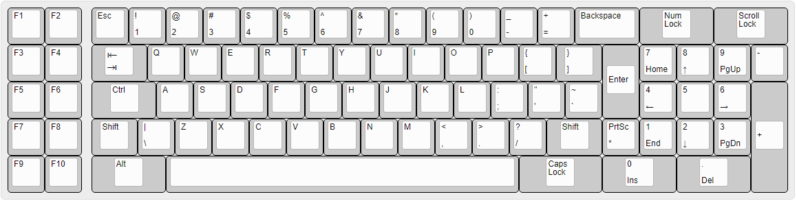

And a more complex setup with multiple layers and more macros for my IBM XT.
###				XT
###				For the original IBM PC/XT Model F
ifset set1
layerblock
	fn1 		1
	fn2 		1		# One for each hand, where available
	fn1 fn2		2		# Press them both for a hard to reach second layer
endblock
# Base layer remaps time
# need to map the FN key into the base layer (0)
remapblock
# Just for the PC/XT keyboard
ifset set1
layer 0
	LCTRL		FN1					# The all important function key
	PAD_ASTERIX FN2					# And the second one: currently the same
	PAD_PLUS 	PAD_ENTER			# Puts an enter at the far right edge
	LALT 		LGUI				# Command!
	CAPS_LOCK 	RGUI				# And again
	PAD_0 		RALT				# Option spills over onto the numpad
	PAD_PERIOD	RCTRL				# Control does too
	F9 			LCTRL				# Mirror image for left and function keys
	F10			LALT				# Completing the 6 mod set
	SCROLL_LOCK SYSTEM_POWER		# Closest I got to Eject, works nicely
	# NUM_LOCK	F13					# Inverse colours mode toggle
	PAD_1 		END					# Hijack the numpad for cursor controls
	PAD_2 		DOWN
	PAD_3 		PAGE_DOWN
	PAD_4 		LEFT
	PAD_5 		DOWN				# Impure, but practical when I forget
	PAD_6 		RIGHT
	PAD_7 		HOME
	PAD_8 		UP
	PAD_9 		PAGE_UP
# 	Hijack the f-keys for media controls
	F1 			F13					# Brightness
	F2 			F14
	F3 			MEDIA_VOLUME_DOWN	# Volume
	F4 			MEDIA_VOLUME_UP
	F5			F10					# MEDIA_PREV_TRACK	# Playback
	F6			F9					# MEDIA_NEXT_TRACK
	F7 			F11					# Exposé
	F8 			F12
endblock
# Primary Function Layer: HHKB + ESDF Arrows
# the layer itself is just some remaps tagged with the layer number
remapblock
ifset set1
layer 1
# 	HHKB Arrows
	LEFT_BRACE 	UP
	SEMICOLON 	LEFT
	SLASH 		DOWN
	QUOTE 		RIGHT
	L 			PAGE_UP
	PERIOD 		PAGE_DOWN
	K 			HOME
	COMMA 		END
	H 			PAD_ASTERIX
	J 			PAD_SLASH
	N			PAD_PLUS
	M			PAD_MINUS
# 	ESDF Arrows
	E			UP
	S			LEFT
	D			DOWN
	F			RIGHT
	R			PAGE_UP
	V			PAGE_DOWN
	A			HOME
	G			END
# 	Restore the Numpad
	PAD_1		PAD_1
	PAD_2		PAD_2
	PAD_3		PAD_3
	PAD_4		PAD_4
	PAD_5		PAD_5
	PAD_6		PAD_6
	PAD_7		PAD_7
	PAD_8		PAD_8
	PAD_9		PAD_9
	PAD_PLUS	PAD_PLUS
	PAD_PERIOD	PAD_PERIOD
	PAD_0		PAD_0
# 	Restore the Function Keys
	F1			F1
	F2			F2
	F3			F3
	F4			F4
	F5			F5
	F6			F6
	F7			F7
	F8			F8
	F9			F9
	F10			F10
# 	Media keys across the number row
	1			F13					# Decrease Display Brightness
	2			F14					# Increase Display Brightness
	3			F10					# Exposé: All App Windows
	4			F12					# Dashboard
	5			F11					# Exposé: Show Desktop
	6			F9					# Exposé: All Windows in All Apps
	7			MEDIA_PREV_TRACK	# iTunes / media playback controls
	8			MEDIA_PLAY_PAUSE
	9			MEDIA_NEXT_TRACK
	0			MEDIA_MUTE			# Volume controls
	MINUS		MEDIA_VOLUME_DOWN
	EQUAL		MEDIA_VOLUME_UP
	BACKSPACE	DELETE				# Delete for Backspace
	LCTRL		CAPS_LOCK			# Capslock lives, out of harm's way
	ENTER		PAD_ENTER			# Enter for Return
	ESC			EUROPE_2			# This § symbol
	BACK_QUOTE	EUROPE_2			# In both places I might look for it
endblock
# Secondry Function Layer: Live mods with number row function row
ifset set1
remapblock
layer 2
# 	Live Mod Function Row			# Leave those mods alone
	1			F1
	2			F2
	3			F3
	4			F4
	5			F5
	6			F6
	7			F7
	8			F8
	9			F9
	0			F10
	MINUS		F11
	EQUAL		F12
endblock

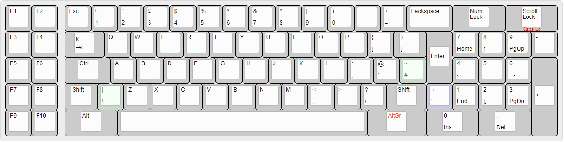

# Let the going get weird
# Match the PC/XT's unusual legends
ifset set1
macroblock
	# Shift 2 = "
	macro 2 shift -ctrl -alt -gui
	press QUOTE
	endmacro
	# Shift ' = @
	macro QUOTE shift -ctrl -alt -gui
	push_meta set_meta lshift
	press 2
	pop_meta
	endmacro
	# Shift 3 = £
	macro 3 shift -alt
	push_meta set_meta ralt
	push_meta clear_meta shift
	press 3
	pop_meta
	pop_meta
	endmacro
	# Option 3 = #
	macro 3 alt -shift
	push_meta set_meta rshift
	push_meta clear_meta alt
	press 3
	pop_meta
	pop_meta
	endmacro
	# Shift Option + # = ±
	# Corresponding with § remap, this time with shift
	macro BACK_QUOTE shift alt -gui -ctrl
	press EUROPE_2
	pop_meta
	endmacro
	macro BACK_QUOTE -all
	press 3
	pop_meta
	endmacro
	# Command + Escape = Command + Section break (for app window cycling)
	macro ESC gui -ctrl -shift
	press EUROPE_2
	endmacro
#	Swapped over to using USB TKL friendly F13 for inverse colours
#	# Num Lock = Ctrl + Cmd + Opt + 8 (Negative / night colours mode)
#	macro num_lock -shift
#	push_meta set_meta rgui ralt rctrl
#	press 8

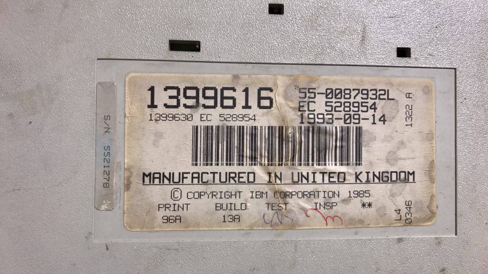

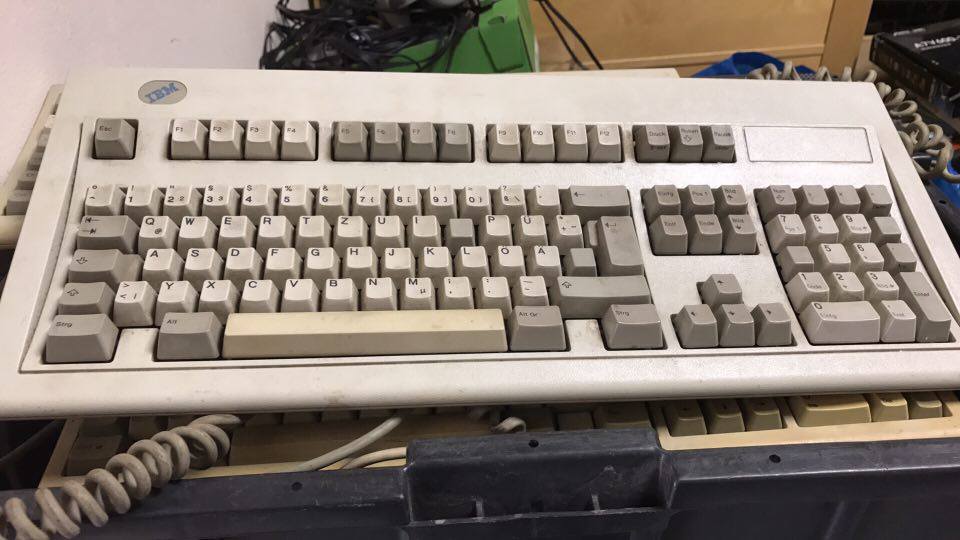

My ISO config for my Terminal Model M 1399616, hope this helps someone.
ifset set3
# Terminal Model M 1399616
remapblock
	EUROPE_2		EUROPE_2
	RIGHT_BRACE		RIGHT_BRACE 		# Should be star
	EUROPE_1		BACKSLASH 			# Should be u''
	EUROPE_2		EUROPE_2 			# Should be left angle bracket
	CAPS_LOCK		LGUI				# Caps lock to windows key
	F23				PRINTSCREEN    		# Printscreen"
   	F24				SCROLL_LOCK    		# Scroll lock
   	LANG_4			PAUSE        		# Pause
	F13				ESC					# Esc
# These are the 4 keys along the top of the numpad
	ESC				NUM_LOCK			# Num lock
	NUM_LOCK		MEDIA_VOLUME_DOWN	# Volume down
	SCROLL_LOCK		MEDIA_VOLUME_UP		# Volume up
	EXTRA_SYSRQ		MEDIA_MUTE			# Mute
# The 3 buttons along the right side
	PAD_ASTERIX		PAD_MINUS			# Minus
	PAD_MINUS 		PAD_PLUS			# Plus
	PAD_PLUS 		PAD_ENTER			# Numpad Enter
endblock

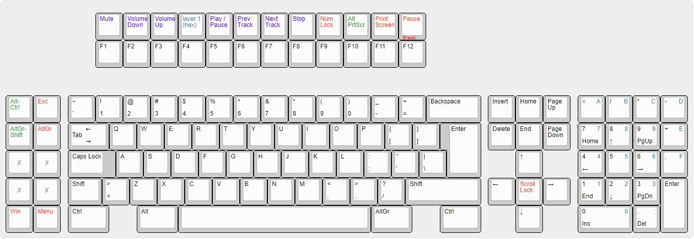

I've been fiddling around the configuration for my M122, and this what I am using:
Diagram of my remapped M122.
This is the .sc file that I used to get this:
# Soarer Converter's configuration for an IBM Model M122 (1390876) keyboard.
# Author: Depleted Vespene.
# Date: 20171105.
# Version: 1.0.
##### BEGIN ########
macroblock
  # On my M122, some Alt-Ctrl-arrow combinations don't register properly.
  # I use them a lot, so I need to wade around that problem (and, as it
  # turns out, this key assignment is pretty comfortable).
  macro EXTRA_F1
    SET_META LALT RCTRL
    onbreak norestoremeta
    CLEAR_META RCTRL LALT
  endmacro
  # Diacritics galore!
  macro EXTRA_F3
    SET_META RALT LSHIFT
    CLEAR_META LSHIFT RALT
  endmacro
  # This is actually quite more convenient than what would be expected at a
  # first glance.
  macro F22
    PUSH_META CLEAR_META all
    MAKE LALT
    PRESS PRINTSCREEN
    BREAK LALT
    POP_ALL_META
  endmacro
  # On my national layout, Shift-0 outputs the '=' character. Adjust this
  # as needed.
  macro PAD_EQUALS
    MAKE LSHIFT
    PRESS 0
    BREAK LSHIFT
    POP_ALL_META
  endmacro
endblock
remapblock
# Left-side function keys.
# EXTRA_F1      (see macro above)
  EXTRA_F2      ESC
# EXTRA_F3      (see macro above)
  EXTRA_F4      RALT
  EXTRA_F5      UNASSIGNED
  EXTRA_F6      UNASSIGNED
  EXTRA_F7      UNASSIGNED
  EXTRA_F8      UNASSIGNED
  EXTRA_F9      LGUI
  EXTRA_F10     APP
# Main alphanumeric block. This remapping is non-negotiable.
  EUROPE_1    BACKSLASH
# Top-side extra function keys.
  F13           MEDIA_MUTE
  F14           MEDIA_VOLUME_DOWN
  F15           MEDIA_VOLUME_UP
  F16           SELECT_1
  F17           MEDIA_PLAY_PAUSE
  F18           MEDIA_PREV_TRACK
  F19           MEDIA_NEXT_TRACK
  F20           MEDIA_STOP
  F21           NUM_LOCK
# F22           (see macro above)
  F23           PRINTSCREEN
  F24           PAUSE
# Navigation cluster; only the "Rule" key needs to be reassigned.
  LANG_4        SCROLL_LOCK
  # The numpad's gray keys are made to behave as normal in the default
  # layer (except what would be NumLock). The extra key becomes a comma.
  ESC           PAD_EQUALS
  NUM_LOCK      PAD_SLASH
  SCROLL_LOCK   PAD_ASTERIX
  EXTRA_SYSRQ   PAD_MINUS
  PAD_ASTERIX   PAD_PLUS
  PAD_MINUS     COMMA       # PAD_COMMA doesn't cut it.
  PAD_PLUS      PAD_ENTER
endblock
# Layer 1 changes the numpad into a hexpad (0..9, A..F and ':').
ifselect 1
macroblock
  # On my national layout, Shift-. outputs the ':' character. Adjust this
  # as needed.
  macro PAD_PERIOD
    MAKE LSHIFT
    PRESS PERIOD
    BREAK LSHIFT
    POP_ALL_META
  endmacro
endblock
remapblock
  ESC           A
  NUM_LOCK      B
  SCROLL_LOCK   C
  EXTRA_SYSRQ   D
  PAD_ASTERIX   E
  PAD_MINUS     F
  PAD_PLUS      PAD_ENTER
# PAD_PERIOD    (see macro above)
endblock
##### END ##########
The keys in red are those that I've moved around; green keys are for new assignments (whether made through simple remappings or macros); media keys are in purple; Cmd16 activates or deactivates the hexpad (as defined in layer 1). I still have four left-side function keys unused.

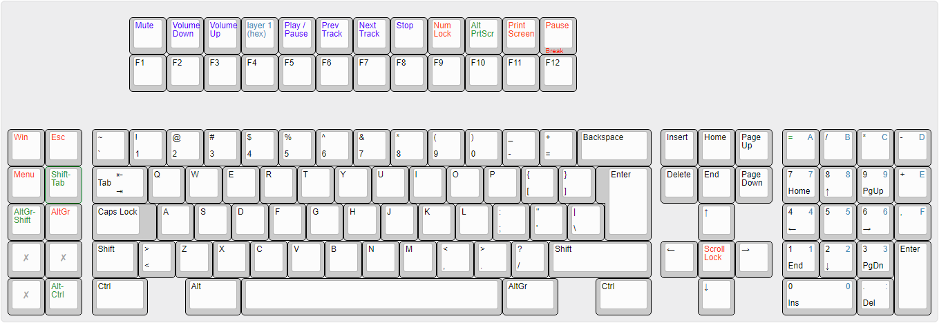

EDIT: See below for version 1.2 of this remapping file.
Further refinements to my previous SC file yield this remapping, which I'm now using on both the M122 and the F122:
Diagram of my remapped M122 and F122, v1.1
This is the (v1.1 of the) .sc file that I used to get this:
# and an F122 (6110345) as well.
# Date: 20171110.
# Version: 1.1.
macroblock
  # Right to the left of TAB.
  macro EXTRA_F4
    MAKE LSHIFT
    PRESS TAB
    BREAK LSHIFT
    POP_ALL_META
  endmacro
  macro EXTRA_F5
  endmacro
  # On my M122 (but NOT on the F122), some Alt-Ctrl-arrow combinations
  # don't register properly. I use them a lot, so I need to wade around
  # that problem (and, as it turns out, this key assignment is pretty
  # comfortable).
  macro EXTRA_F10
    SET_META LALT RCTRL
  endmacro
  # first glance.
  macro F22
    MAKE LALT
    PRESS PRINTSCREEN
    BREAK LALT
    POP_ALL_META
  endmacro
  # as needed for others.
  macro PAD_EQUALS
    MAKE LSHIFT
    PRESS 0
    BREAK LSHIFT
    POP_ALL_META
  endmacro
endblock
remapblock
  EXTRA_F1      LGUI
  EXTRA_F2      ESC
  EXTRA_F3      APP
# EXTRA_F4      (see macro above)
# EXTRA_F5      (see macro above)
  EXTRA_F6      RALT
  EXTRA_F7      UNASSIGNED          # Future "Layer n".
  EXTRA_F8      UNASSIGNED          # Future "Layer 0".
  EXTRA_F9      UNASSIGNED          # Keep unassigned until I stop hitting it accidentally!
# EXTRA_F10     (see macro above)
  EUROPE_1    BACKSLASH
  F13           MEDIA_MUTE
  F15           MEDIA_VOLUME_UP
  F16           SELECT_1
  F20           MEDIA_STOP
  F21           NUM_LOCK
  F23           PRINTSCREEN
  F24           PAUSE
  LANG_4        SCROLL_LOCK
  ESC           PAD_EQUALS
  NUM_LOCK      PAD_SLASH
  PAD_MINUS     COMMA       # This way, I get ";" with Shift-PAD_MINUS.
  PAD_PLUS      PAD_ENTER
endblock
ifselect 1
macroblock
  # as needed.
  macro PAD_PERIOD
    MAKE LSHIFT
    PRESS PERIOD
    BREAK LSHIFT
    POP_ALL_META
  endmacro
endblock
remapblock
  ESC           A
  NUM_LOCK      B
  SCROLL_LOCK   C
  EXTRA_SYSRQ   D
  PAD_ASTERIX   E
  PAD_MINUS     F
  PAD_PLUS      PAD_ENTER
endblock
Later on, when I decide on other uses for the numpad, I'll make LHS EXTRA_F7 become Layer Select N, and EXTRA_F8 shall be Layer Select 0. I may or may not keep current Cmd16/F16 as Layer Select 1 (which activates the hexpad).

Basic remapping of an IBM Model F XT layout for usage with a modern ISO-based national layout.
The Model F XT layout looks like this:
Plain vanilla Model F XT layout.
If one should want to use this keyboard with an ISO-based national layout on top of it, some adjustments will be needed. The first, and more obvious, is to get an AltGr key; some of the keys need to moved around as well (it's not immediately apparent, but the \| key is not actually the BACKSLASH key and the `~ key is not BACKQUOTE).
This remapping for the Soarer's Converter:

produces THIS layout:
Model F XT layout for (ISO) UK English.
The changes are these:
  • Caps Lock is now AltGr.
  • Ctrl-Scroll Lock is now Caps Lock.
  • The two keys in green are remapped so they'll output what they are expected to output by the national layout definition.
  • The (modern) BACKQUOTE key doesn't exist in this keyboard, so */PrtSc (in blue) is mapped to it.
Further changes can be defined afterwards at the user's discretion, but this remapping defines a usable starting point.

This is version 1.2 of the .sc remapping file for M122 and F122 keyboards. It corrects the mapping for EF4 (made to be Shift-Tab), which was improperly done, has EF9 output an enlightened advice (for demo purposes) and improves a bit the comments. Use this version instead of either 1.1 or 1.0 and adjust as needed.
# Soarer Converter's configuration for IBM Model M122 (1390876, etc.) and
# F122 (6110345, etc.) keyboards.
# Date: 20181010.
# Version: 1.2.
macroblock
  # Backtab (Shift-Tab, actually) - right to the left of Tab.
  macro EXTRA_F4
    PUSH_META SET_META LSHIFT
    PRESS TAB
    POP_ALL_META
  endmacro
  # AltGr-Shift - for diacritics galore!
  macro EXTRA_F5
  endmacro
  # This shows how to assign an entire phrase to a single keystroke. Do
  # take into account that the entire macro cannot exceed a certain length.
  macro EXTRA_F9
    MAKE LSHIFT
    PRESS T
    BREAK LSHIFT
    delay 5
    PRESS H
    PRESS E
    PRESS SPACE
    delay 5
    MAKE LSHIFT
    PRESS I
    BREAK LSHIFT
    delay 5
    PRESS N
    PRESS S
    PRESS E
    delay 5
    PRESS R
    PRESS T
    PRESS SPACE
    delay 5
    PRESS K
    PRESS E
    PRESS Y
    delay 5
    PRESS SPACE
    PRESS I
    PRESS S
    delay 5
    PRESS SPACE
    PRESS G
    PRESS R
    PRESS E
    delay 5
    PRESS A
    delay 5
    PRESS T
    PRESS PERIOD
    PRESS SPACE
    delay 5
    MAKE LSHIFT
    PRESS U
    BREAK LSHIFT
    PRESS S
    PRESS E
    delay 5
    PRESS SPACE
    PRESS I
    PRESS T
    delay 5
    MAKE LSHIFT
    PRESS 1
    BREAK LSHIFT
    PRESS ENTER
    POP_ALL_META
  endmacro
  # don't register as would be expected. I use them a lot, so I need to
  # wade around that problem... and, as it turns out, this key assignment
  # is pretty comfortable for other things as well.
  macro EXTRA_F10
    SET_META LALT RCTRL
  endmacro
  # Alt-PrtScr in a single keystroke - this is actually quite more
  # convenient than what would be expected at a first glance.
  macro F22
    MAKE LALT
    PRESS PRINTSCREEN
    BREAK LALT
    POP_ALL_META
  endmacro
  # On my national layout, Shift-0 produces the '=' character. Adjust this
  macro PAD_EQUALS
    MAKE LSHIFT
    PRESS 0
    BREAK LSHIFT
    POP_ALL_META
  endmacro
endblock
remapblock
  EXTRA_F1      LGUI                # "Windows" key.
  EXTRA_F2      ESC
  EXTRA_F3      APP                 # "Menu" key.
  EXTRA_F6      RALT
  EXTRA_F7      UNASSIGNED          # Future "layer n".
  EXTRA_F8      UNASSIGNED          # Future "layer 0".
# EXTRA_F9      (see macro above)
  EUROPE_1      BACKSLASH
  F13           MEDIA_MUTE
  F15           MEDIA_VOLUME_UP
  F16           SELECT_1            # Toggles layer 1 (see below).
  F20           MEDIA_STOP
  F21           NUM_LOCK
  F23           PRINTSCREEN
  F24           PAUSE
  LANG_4        SCROLL_LOCK
# Numpad. In the default layer, the gray keys are made to behave as they do
# in a regular full-sized keyboard, EXCEPT: a) the top left key outputs the
# equals sign instead of becoming the NumLock key; b) battleships have two
# 1U keys instead of a single 2U plus key - of those, the top one remains
# plus and the bottom key outputs a comma.
  ESC           PAD_EQUALS
  NUM_LOCK      PAD_SLASH
  PAD_MINUS     COMMA
  PAD_PLUS      PAD_ENTER
# Bonus: on my national layout, Shift-, produces the ';' character. With
# the direct remapping above (instead of a macro), pressing Shift-PAD_MINUS
# has the same effect. Replace with a macro if needed.
endblock
# Layer 1 changes the numpad into a hexpad (0..9, A..F, Enter and colon).
ifselect 1
macroblock
  # On my national layout, Shift-. produces the ':' character. Adjust this
  # as needed.
  macro PAD_PERIOD
    MAKE LSHIFT
    PRESS PERIOD
    BREAK LSHIFT
    POP_ALL_META
  endmacro
endblock
remapblock
  ESC           A
  NUM_LOCK      B
  SCROLL_LOCK   C
  EXTRA_SYSRQ   D
  PAD_ASTERIX   E
  PAD_MINUS     F
  PAD_PLUS      PAD_ENTER
endblock
