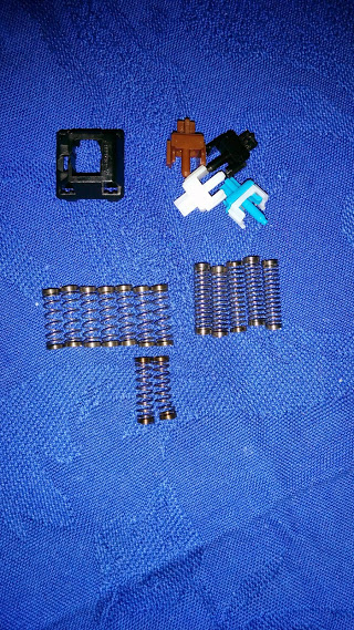

So! Im currently venturing into mx swicthing past the standard stuff(brown,blue.black?) And ive been given some springs and stems, and i need help identifying them since im going to buy more mx switches types for testing. Regarding the pic, the bottom 2 springs are from my g80-3000 linear blacks the other two types above i don't know, also how do you separate the clears from white versions?. Regarding the types i've tested, i did like the browns for work and the blues at home, so, since i like tactile switches and also clicky i was wondering about the other types...there's many, so 7bit will have some orders soon

Left is from the clear/white switch and the springs to the right is from the blue/brown switches.

Really? I tried the right ones with the blue stem but it didn't seem to click much compared to a full blue switch keyboard i tried....hummm.....im also considering buying one of these KBT/KBC Pker/Pure/Race keyboards with plate mounted switches to test the switches (and use of course

How much it clicks has nothing to do with the spring, at least not in MX switches and not something I can notice (I have both an MX Green and an MX Blue in my keyboard).
The difference between how a switch behaves when mounted in a keyboard and when simply held in hand is also very different, so that is why the switch seems to make less noise than your keyboard with blues.
