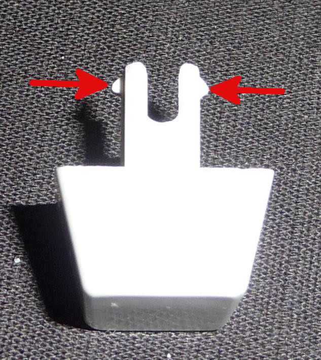

I mean use a fine file or piece of sandpaper to take a small amount of material, on the order of 0.1mm, from the areas producing the friction, likely the retention "ears" illustrated below.timbetty wrote: I swaped the '1' and the '.' key from the number pad, the '1' was very scratchy and the '.' felt normal, but after the swap both feel a little scratchy, but the '1' key feels better, but still not fine, so it is probably the sum of the barrel and the stem?
What do you mean by filing?
Edit: After splitting apart another Model M today, I took a look at the inside of the barrels, and it is definitely not the retention ears that would be causing the friction. They only contact the barrel plate at the very top end of their travel. It is most likely some other part of the stem rubbing.
It's possible the surfaces responsible for the friction will wear away over time, so another option is to just wait and see.

Thanks very much.quantalume wrote:I mean use a fine file or piece of sandpaper to take a small amount of material, on the order of 0.1mm, from the areas producing the friction, likely the retention "ears" illustrated below.timbetty wrote: I swaped the '1' and the '.' key from the number pad, the '1' was very scratchy and the '.' felt normal, but after the swap both feel a little scratchy, but the '1' key feels better, but still not fine, so it is probably the sum of the barrel and the stem?
Since I'm currently writing my thesis on that keyboard, which involves a lot of programming and writing, I think I will waite a month.
If those keys are still scratchy by that time I will try the method you proposed.
