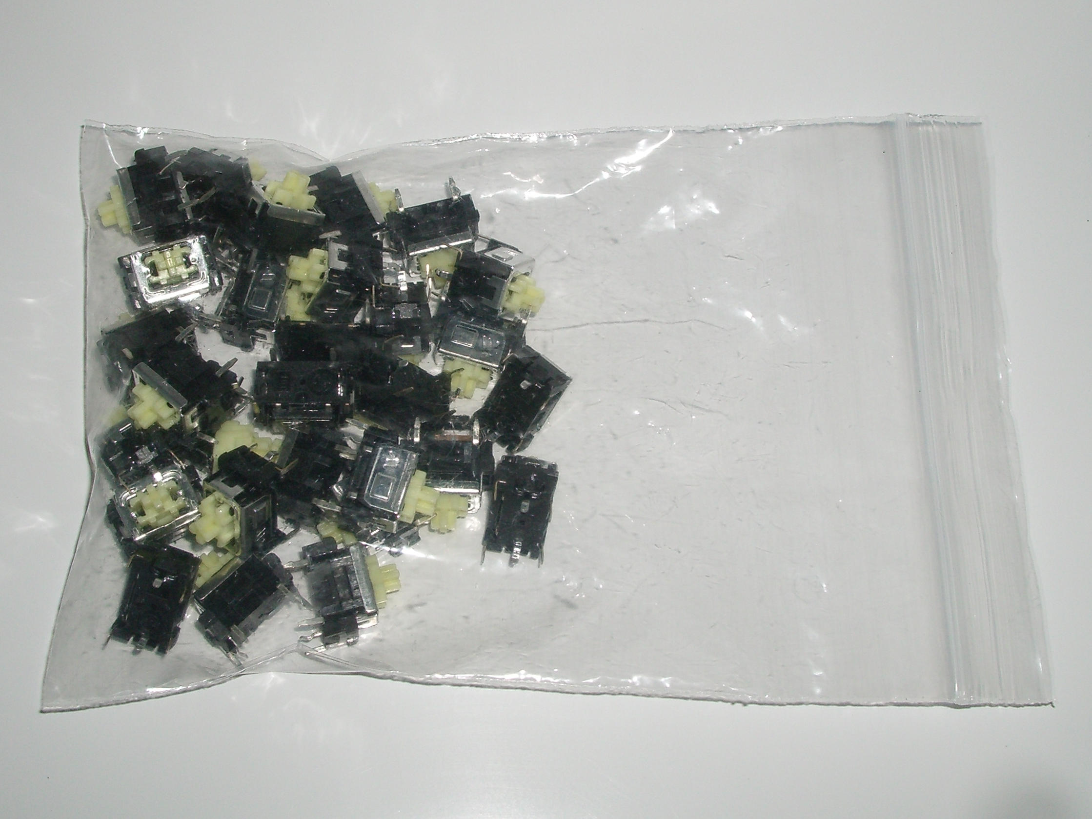

Devlin Goody Bag no. 2 arrived today from Nick Hoskings. Nick originally told me I'd be getting some Mitsumi KLT2 switches, but having checked the part number, he's determined that they're KLT-11, and KLT2 might be the product range. They're moving premises, and Nick saved these from being thrown out, but all the paperwork is already gone. Google has no record of either code, so we may never know.
I wasn't sure what I would be getting; it turned out to the adorable little mini switches! 29 of them:

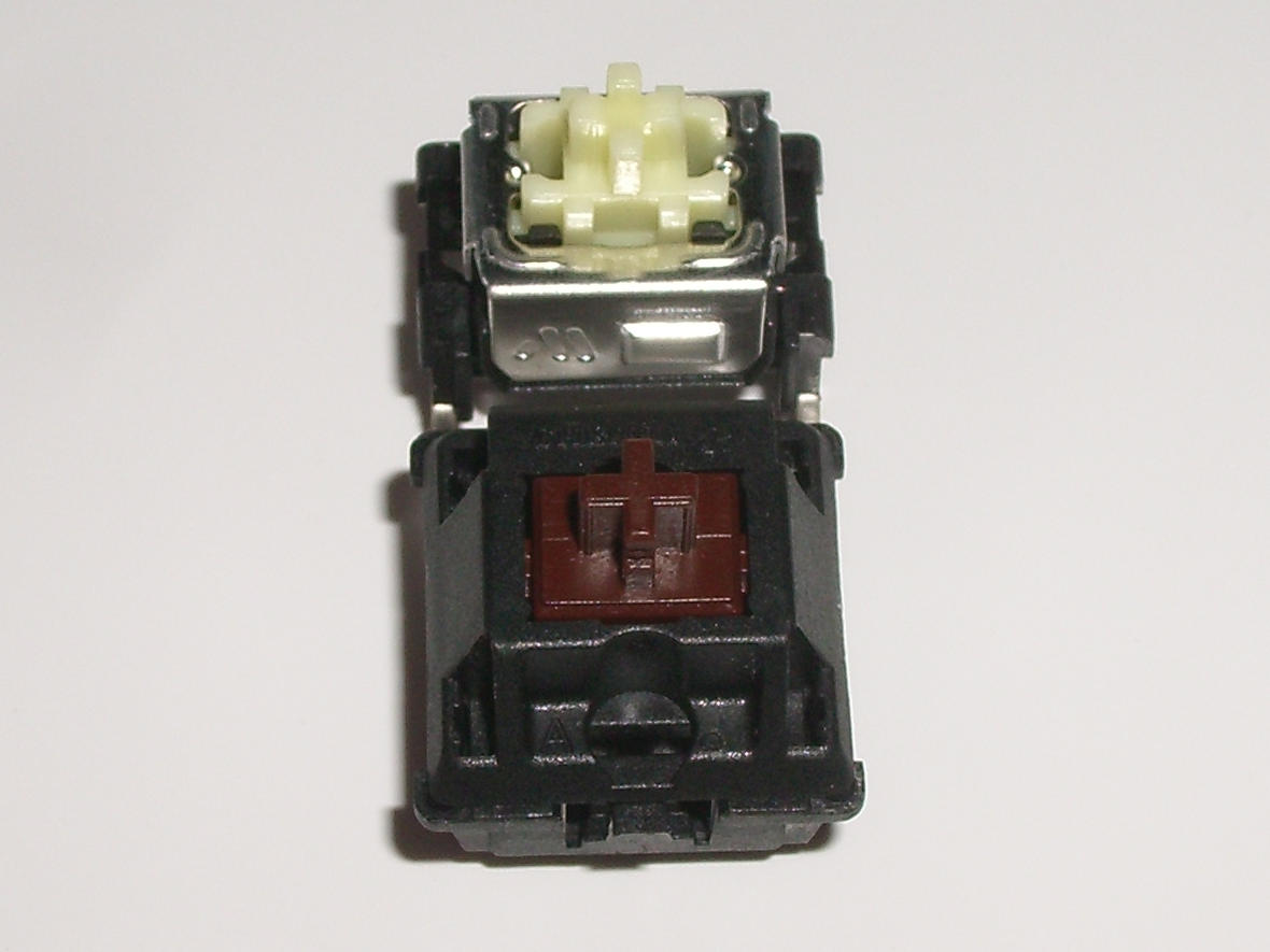

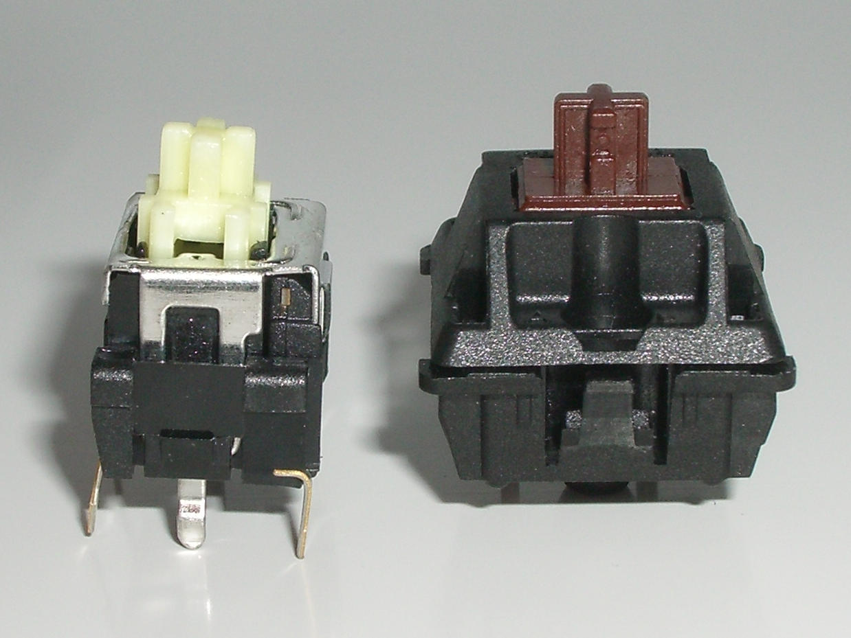

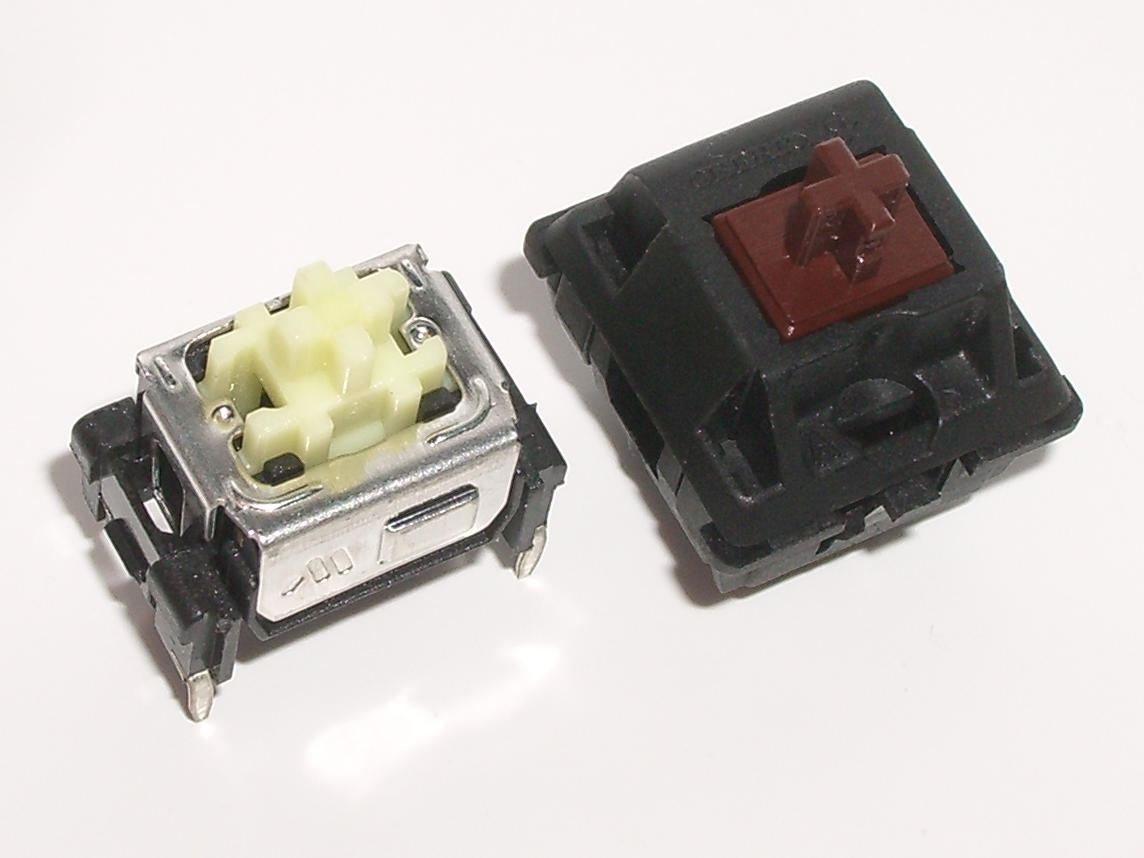

It's hard to tell from photos exactly what size they are. They're the same width as a Cherry MX switch, but much shallower front-to-back, and not quite as tall:
2. Comparison with MX Brown, 1.jpg (83.75 KiB) Viewed 6235 times
3. Comparison with MX Brown, 2.jpg (120.88 KiB) Viewed 6235 times
4. Comparison with MX Brown, 3.jpg (74.11 KiB) Viewed 6235 times

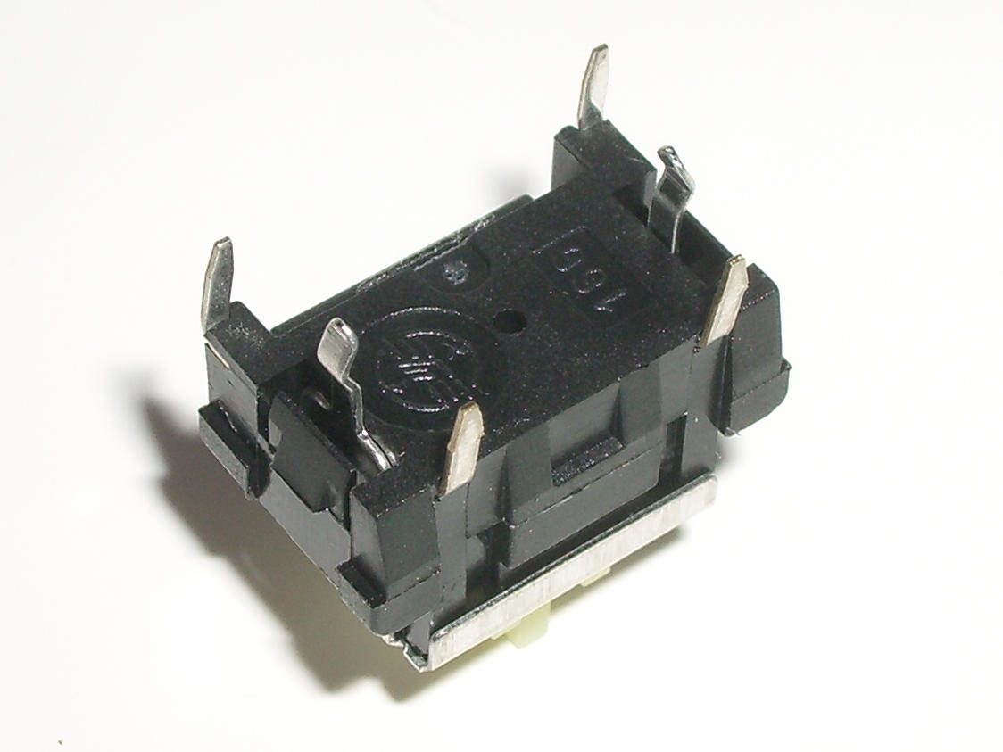

Mine have the old Mitsumi logo on the base and the new one on the side:
5. Base.jpg (71.16 KiB) Viewed 6235 times

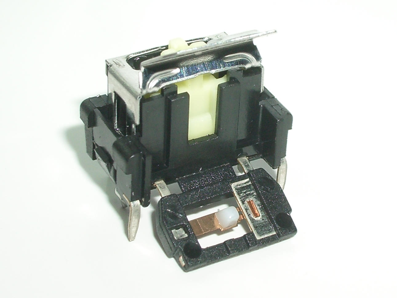

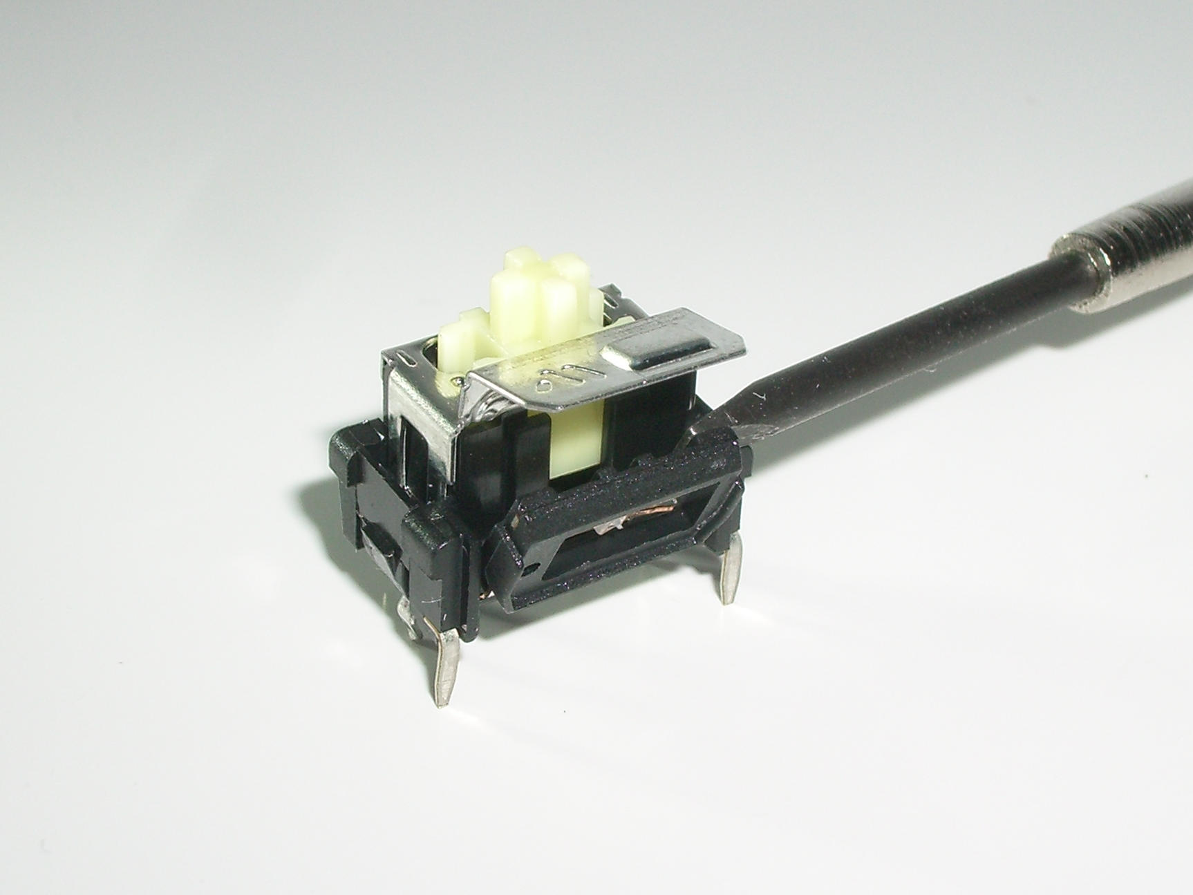

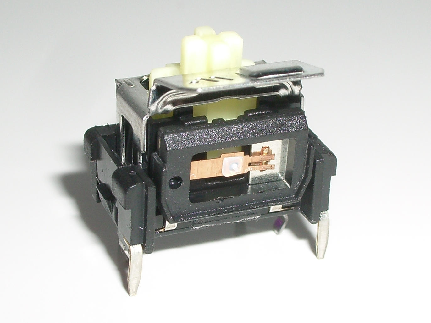

The front panel can be prised up like a car bonnet to reveal the contacts:
6. Contacts.jpg (117.7 KiB) Viewed 6235 times
If you bend it back down it seems to snap back into place and stay fully closed. I've tested a switch after doing this with a meter and it still registers correctly. The "bonnet" holds the contact frame in place; you can prise the contact frame downwards:
7. Open out contact assembly.jpg (113.36 KiB) Viewed 6235 times
The contact frame is formed from the same piece of plastic, with a "skin" keeping it attached to the rest of the base. It's formed from two layers with the contacts sandwiched inside.
8. Contact assembly.jpg (103.04 KiB) Viewed 6235 times
A small piece of plastic is inserted through the movable contact, and the slider presses on this to hold the contact open. When the slider is depressed, this plastic part drops back into a recess in the front of the slider, allowing the contact leaf to spring into its closed position. This makes it a "negative" contact switch like Cherry MX, so the keystroke force never reaches the delicate switch leaf; all forces on the leaf are set in the factory.

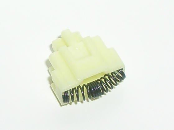

The spring is slung laterally under the slider:
9. Slider.jpg (25.24 KiB) Viewed 6235 times
(That's the largest photo I can take, as my camera doesn't have sufficient control or intelligence with the flash during super macro mode, and if I get any closer the image gets blown out — so that's just a crop of the centre. It depends on the camera's mood, of course.)
It's very hard to tell from the photos, but the peg in the base that would normally hold the spring, has a wide groove across the top to hold the spring laterally instead. As the slider is depressed, this spring is pulled down over this centre peg until it buckles. Just as with normal buckling spring, the tactile force is drawn off a single spring — there are no hooks or ramps for the tactility, which gives it its ultra-smooth force curve.

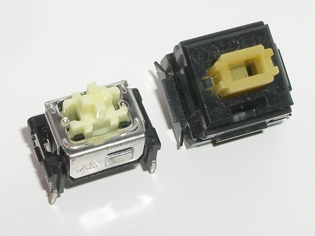

Comparison with Alps SKCL Yellow:
10. Comparison with Alps SKCL Yellow.jpg (83.37 KiB) Viewed 6235 times

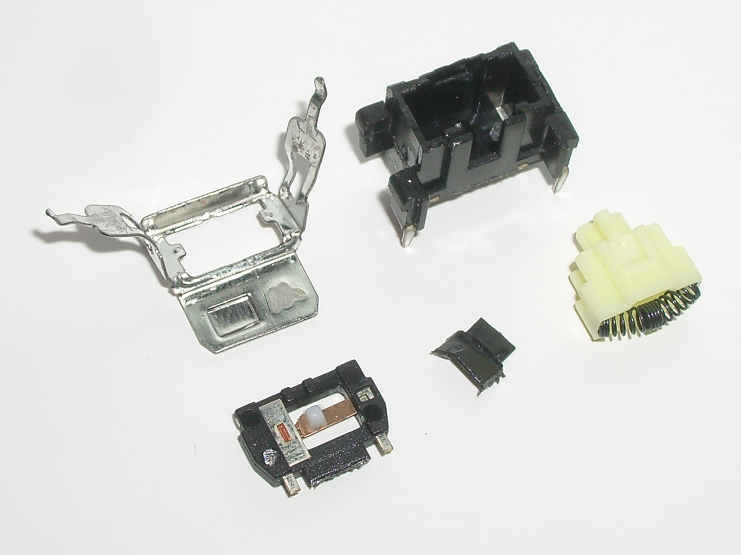

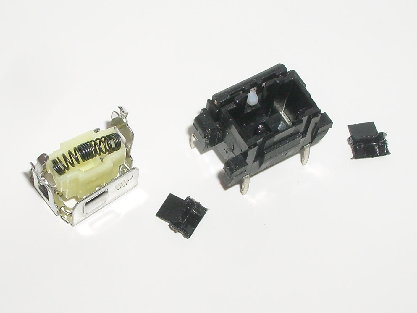

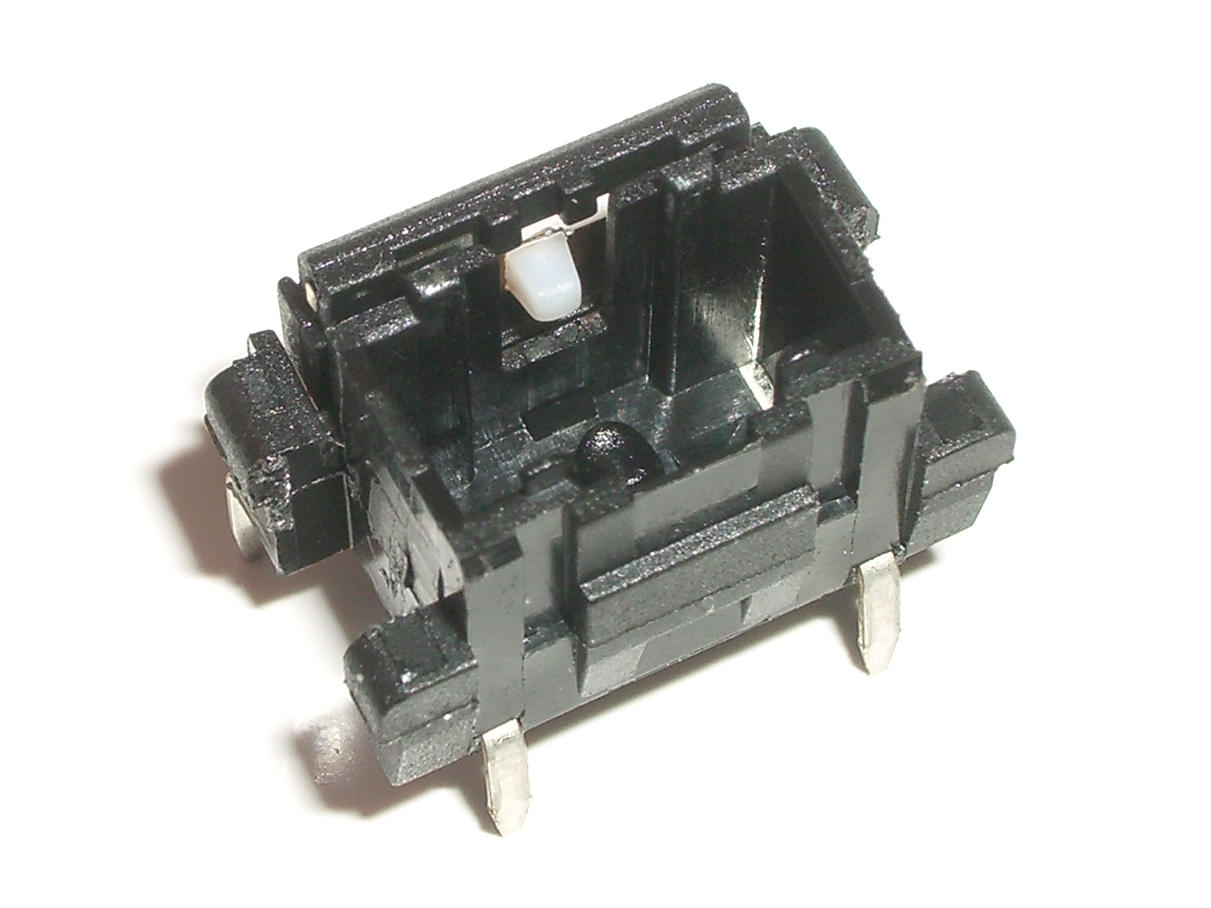

Those brainy Japanese guys know how to get these things apart, but I can't figure it out. The first attempt wasn't even an attempt — in the end I just tore it apart to see if I could figure out what was holding down the lid:
11. Hard to disassemble, 1.jpg (109.32 KiB) Viewed 6235 times

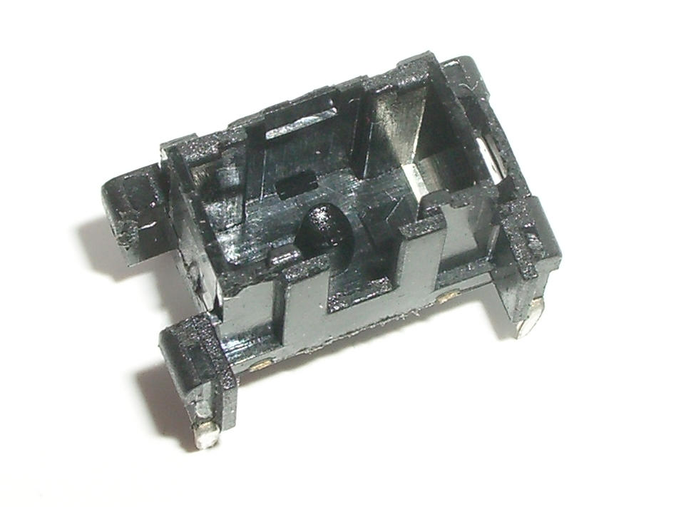

With the switch ripped apart you can see the specially-shaped guide recess in the centre peg:
12. Inside of base.jpg (64.56 KiB) Viewed 6235 times
I could see that little ramps on the inside the plate retention clips were holding down the metal lid. I took another switch and tore both retention clips right off the switch, and the lid came off easily:
13. Hard to disassemble, 2.jpg (89.28 KiB) Viewed 6235 times
What's hard to see, is that there are two extremely tiny ramps, one per side. The lid sides only have to be lifted a fraction of a millimetre to pull clear, but they're locked down by the ramps on the inside of the retention clips. I guess if you had lots of very thin tweezers you could somehow lift the plastic ramps and then force up the lid sides from behind, on both sides at once. I'm not too fussed as there are plenty of photos of these switches open, just very few showing how they actually work.
Finally, an inside view with the contact frame still present, showing the plastic doobrey from the inside.
14. Contact block seen from inside.jpg (93.06 KiB) Viewed 6235 times

HaaTa has confirmed that clicky switches exist, but since they're extremely hard to open safely, we may never know what's inside unless he's prepared to risk sacrificing a switch. (MouseFan appears to have done it, looking at his pictures, but then he's clever. HaaTa could probably do it too.)
The wiki page does now have an illustrated variants table of every variant HaaTa and I know of. There's potentially one more know variant, Mitsumi mount and cream, looking at Ripster's photos.
