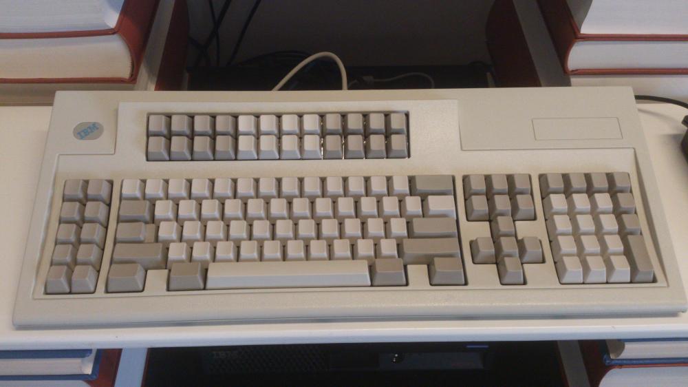

I recently performed a bolt mod on a 122-key Model M. After testing it for awhile, I discovered that a couple of keys would register slightly before the click. It was only noticeable if I slowly depressed the keys, not during normal typing. Upon further testing, I concluded that the problem was most likely the rubber sheet not being perfectly flat and uniform. I pulled everything apart and reassembled it without the sheet. Lo and behold, the problem is gone. Also, the tactility seems much crisper now. The feeling is somewhere between a beamspring and a Model F. I've never had a Model F apart, but I believe the hammers directly strike the PCB. This might explain why most people prefer the F over the M: the crisper feel due to the hammers hitting a solid surface. The rubber-less M does sound a bit tinnier than the F, most likely due to the smaller hammers and thinner metal backplane. I think the typing feel is just as good, however. The original IBM patent doesn't show a rubber pad. It's definitely loud now, perhaps not more so than the F, but not recommended for cubicle dwellers in either case. If I find my sound level meter, I'll do a comparison.
I wanted a 122-key "otaku" Model M in ANSI layout, and here's what it looks like. It still has 122 keys because I split the number pad zero. I've mapped comma to one side of 0 and period to the other.
I placed a Soarer's converter internally and put a usb socket in the back:
Now excuse me while I spend the next couple of months trying to find the optimal key mapping for a 122-key keyboard...

Nice look. And it sounds like hell! In a good way…
Someone did the same thing here with an SSK recently, if I remember. They said it sounded crazy. All the more reason to get back inside my own 122 key and try this out I suppose. Plus I want to expose some extra keys, too. Specifically split right shift and backspace.
Don't know if it's good for the hammers though, but light use is likely fine. By the way: Model F's don't use direct contact. They have a foam layer that I'm too shy to prise from my Kishsaver (as they always degrade) and I suspect the flippers are above that, while the capacitance sensors on the PCB are below.

Why didn't you split up all the other keys?
Except for the Return key, each can turned into a regular key.

7bit wrote:Why didn't you split up all the other keys?
I like a large backspace and large number pad enter, and I was happy to get rid of the small left shift. The only other modification I was thinking of making was a short right shift, but I wasn't sure I could find a blank key cap for that. It's not like there is a shortage of keys on this thing. :) On my 60%, yeah, definitely making use of every position.
