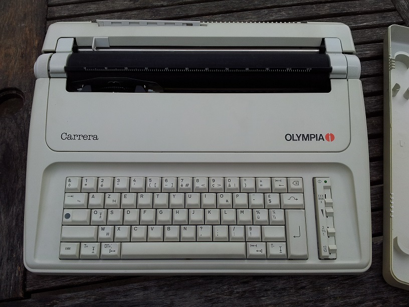

Picked this thing up for $5 non-working at a thrift store. Thought the linearness of the switches was odd and had to grab it.
I'm unsure of the specific type of Marquardt switch as it doesn't match up with any of the three on the wiki but it is a fairly smooth switch, more so than Cherry Red or Black in my opinion.
The caps do fit MX switches and vice versa. They appear to be dye sub caps, I believe ABS but I haven't confirmed yet.

14 Mar 2014, 22:30
Compgeke wrote:I'm unsure of the specific type of Marquardt switch as it doesn't match up with any of the three on the wiki but it is a fairly smooth switch, more so than Cherry Red or Black in my opinion. … In the mean time anyone know what switch this is specifically?
It turned up on Geekhack last August:
http://geekhack.org/index.php?topic=47597
It's mentioned on the wiki under [wiki]Marquardt Two Finger[/wiki] (the "regular" Marquardt switch) under the assumption that it's the same inside, but the insides are yet to be documented and there are no photos on the wiki of this alternative version.
The name is a mistake because it turns out that the [wiki]Marquardt Two Fingers Typewriter switch[/wiki] also has the same contact arrangement, suggesting that the one in your typewriter has the same contacts and is therefore likely to just be a "[Normal] Two Finger" variant.
Interestingly with the Geekhack photos, you can see the integrated diodes in the switches.

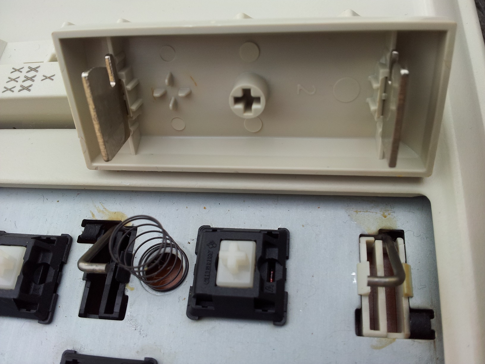

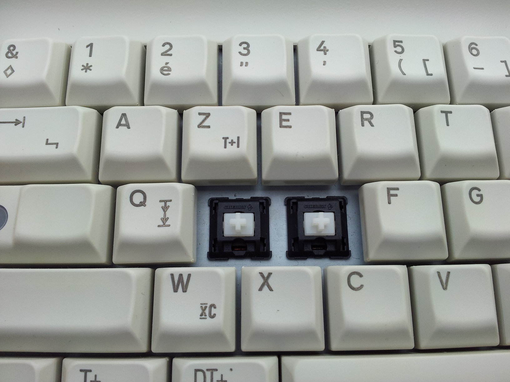

I did find this one last we in a second-hand shop
Its FR azerty version as you can see, but something very different inside...
Cherry switches !
Strange that they seem to be clears as they don't click on bottoming but they feel linear so I'm not sure about this kind of switches..
It contains also special stab system with a spring for the enter key
I can't open switch top normally bit I think its about plate so I'll first unsolder them before opening..
Kurk
07 Jul 2014, 13:05
The switches probably are vintage Cherry Whites.
http://deskthority.net/wiki/Cherry_MX_White
IvanIvanovich
07 Jul 2014, 17:08
They may be linear clears. They did make such thing and I have seen them in typewriters before as well as a couple computer keyboard. It's not a white as there is no cam on the switch to denote a click type.
