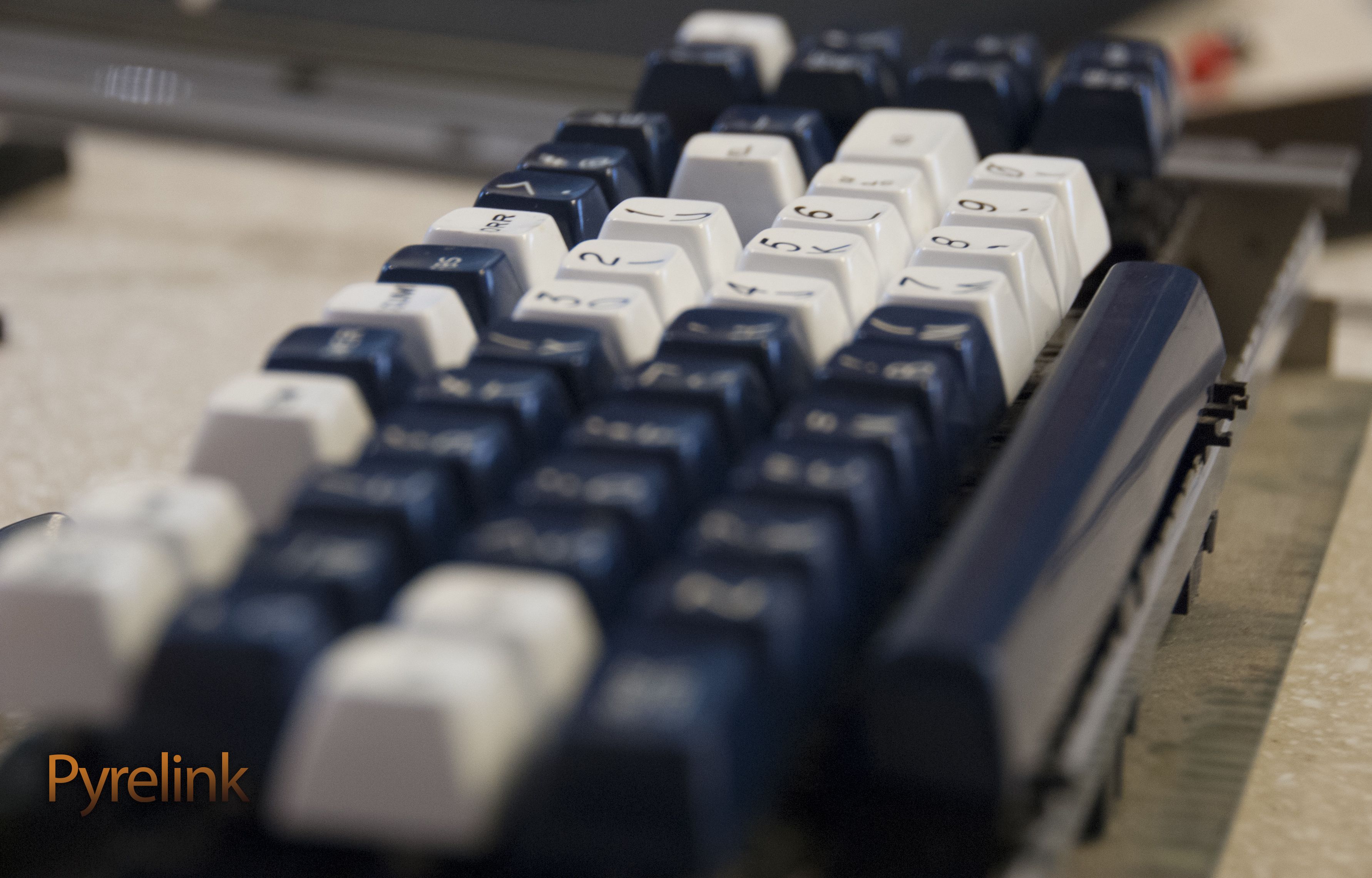

Why hello Deskthority, today I have a Honeywell Micro Switch keyboard for you. This keyboard has switches that I can not seem to identify anywhere. This is also my first post here, and before I begin with all of the photos, I think some back story would be useful. This will also serve as my introduction post, so it might be insanely boring, for someone only looking for the pictures.
SO without further ado here is my Vintage Honeywell Micro Switch Keyboard.
The last picture was the PCB when I took the board out of the enclosure last week, and this picture is one I took when I first had the board:
Based on the spaghetti wiring, and the soldering, my guess is that this was either a home built board, or down the line was modified, or something. The main thing of interest are the switches. They say Micro USA on the top, and the keycaps appear very similar if not identical to the other Honeywell caps, yet they do not appear anything like other Honeywell switches that I have found here or elsewhere:
One observation that I have made about the keycaps are the slots in the plastic for those metal stems. Some of the keycaps have 2 slots in them some have 1. In most of the Honeywell Micro Switch caps I have seen posted here on DT have none of those slots. My guess is this is an earlier version of those switches. If someone can decipher the date code in one of the first images in the thread, I assume that would be helpful. The following will be the insides of the dominate switch on the board:
There are multiple different model switches on the board. The most common switch is the 7030 7A1MS. I have not yet desoldered all of the switches on the board to check, but I have found 2 other models (not in the usual places, the space bar was the same as most of the alphas etc.) 7026 7A1MT and 7120 7A1MS. I only noticed these other switches as I was sorting my photos in Lightroom, so I have a phone picture of the switches but nothing in depth. If there is interest I can do some testing on the other switches like I do with this one:
I wanted to get some sort of measurement on the force required to actuate this switch. Since I do not have access to any expensive force measuring equipment, I went with the low cost but inaccurate route, in order to get some sort of benchmark for the switch. Yeah... I went for Ripsters Nickles. Take it for what you will, but its better then nothing:
So hooked up to my super high tech rig, consisting of a $10 helping hand, a Fluke Multimeter (testing for continuity), and some random alligator clips, it took 20 Nickles to get the switch to actuate. When those Nickles are then weighed on my super expensive, next gen, feature filled, generic kitchen scale, I get 3 and 1/2 oz. 3 and a half ounces converts to 99.2 grams. With the brand new math that I invented to compute this problem, I find that it is safe to round that to 100 grams.
I also felt that it was worthwhile to demonstrate how the actual switch works. I think it is pretty obvious but pictures and video are always fun:
Finally here are some photos of the keycaps:
I have a few more photos of the board and the switches and caps in the Full Imgur Album here: http://imgur.com/a/tgre2
There are probably tons of things that I am leaving out, and forgetting to mention, but I will add anything that I can remember. If you can't tell which I am only now noticing, I haven't really got a good photo showing the mounting system, but all the switches are "plate mounted" on a sort of rail system. As you can see in the first images of the switch, the 2 plastic pieces that the screws screw into, actually have a small lip on them. They actually hold the bottom part of the switch to the rail, and the "lid" on the switch also holds onto the top of the rail. They are then directly soldered into the PCB. I notice that compared to other Honeywell switches, these only have 2 pins on them, where as the others have 4. I am guessing that these are the switches 1 step before the Hall Effects switches that we see. They kept the same similar keycap design, and even added that bit of "backward compatibility" on some of their following key caps with that "stem slot"
So overall the switches feel incredible. There are perfectly linear and insanely smooth, They do require a decent amount of force and the actuation point is relatively further down in the press. I have really no clue what do do with this board. My thinking was eventually do desolder the switches that are left on the board and and wire them up and make like a makeshift mini board with a Teensy. I would prefer these awesome switches, and caps to go to waste, but in its current state I think it would be better off salvaged then restored. I don't plan on doing anything for a while so any suggestions or ideas would be great.
EDIT: Would like to add that this board also has 2 dummy switches on either side of the space bar switch. Heard that might be an important detail in dating this board.

Fantastic first post, Pyrelink, and a real gem of a keyboard. I'm the guy with the other, later Honeywell you mentioned. Yours is very different. The overall construction reminds me of one or two of HaTaa's many epic finds (he is the top dog par excellence when it comes to relics) and perhaps he and Dorkvader and others who know more about Micro Switch's earlier history will have the insight you are looking for. I think they'll be in for field day! Your keyboard could be very old indeed; in a good way. Hand wiring is a good sign it pre-dates mine by a long shot. As is the truly classic look.
The switches work via simple continuity? Hall Effect uses electromagnetism, so more than two pins are required. Differences abound.
Oh and welcome to DT. There's really not much to be bothered about regarding rules here. Just post as you like.

Very nice find and great pictures!
I guess you have figured out that these are Reed switches. They are indeed mostly found on very early keyboards. HaTaa posted about one here:
http://deskthority.net/keyboards-f2/mag ... t1596.html

Wow, awesome keyboard and photos! Nice deep blue/white colour scheme. It looks like a punch card keyboard.
What a pity those mysterious "bunch of people" screwed around with it.

Magnetic reed switches are well-known, but has anyone seen a Micro Switch version before? I honestly can't remember whether these have come up before, as these less-common switch types are often not documented on the wiki. It probably won't be the first time they've been seen, but they're certainly highly unusual.
Only three magnetic reed switches documented so far:
http://deskthority.net/wiki/Category:Ma ... d_switches
The Alps one wasn't even correctly categorised, and until now didn't show up. I thought there were several more magnetic reed switches than the ones listed, but a search for "magnetic reed" indicates otherwise. So many discoveries come and go without being added to the wiki, and get forgotten just as quickly as they are discovered.
So the wiring is noticeable right away. Back in the day you could get KB assemblies and hand-wire them up to things. I think HaaTa has a keytronic reed keyboard hooked up to a tiny sinclair computer. But I think a lot of legitimate computers and devices came with keyboards and had to be hand wired. This is long before my time, but I think companies like honeywell (microswitch) would provide a KB unit and the company would figure out the best way to use it on their device. I think this isn't home-made, just hand-wired.
I always wondered about those slots. I have a lot of honeywell hall effect keyboards from the mid-to-late 1970's and they all have those slots. When I saw your pictures with the metal stems, I knew that's what they are for. Microswitch updated the stems at least once during the lifetime of the switch, I guess around 1979 to not include those.
You can see them in my pictures of my hall effect KB from 1977 post I did a while ago:
http://deskthority.net/photos-videos-f8 ... t5395.html?
Usually the different model numbers are for various weights or options (angled stems, etc.) I would guess the different numbered ones were originally under some of the special or different keys, but there's no way to know for sure, sometimes.
The coinage test is a good test to get a general feel of a keyswitch weight. I like the way you write and hope you stay :)
As to what to use the board for: You can desolder the switches and wire them up with diodes to a controller. (or go with the original PCB and 2KRO). If you can find or figure out a method to make those metal tabs, I'd be happy to give you some spare hall effect keycaps to replace the missing ones They wouldn't match, but they would work. I think that keeping the original frame and mounting rails is a good choice.
If there's any other questions you have, please post! I am glad you ended up making this post here.
Oh! one other thing: the layout is called "data entry" and was used frequently on IBM cardpunches.

Oooh... I just noticed that some of the white keys are triple-shot. Nice.
dorkvader
08 Mar 2014, 18:34
mr_a500 wrote:
pyrelink wrote:Image
I think it's a trick of the light. In other pictures both legends appear black.
(otherwise I'd have asked for pictures of the undersides. I love microswitch tripleshots and they are done in a completely different way than IBM)
mr_a500
08 Mar 2014, 18:50
I think you're right. I saw that in another photo they were all black, but thought that you couldn't see the difference between black and dark blue because of the contrast. Now that I've examined all the photos, I can see that they're just black.
They're still very nice keycaps though.

Yeah I wish I had some triple shot caps, but sadly I just used my camera sorcery, to make those double shots appear triple shot.
08 Mar 2014, 21:58
35th week of 1970 makes sense. Early September?
http://www.wolframalpha.com/input/?i=35th+week+of+1970
It looks that old, anyway.
