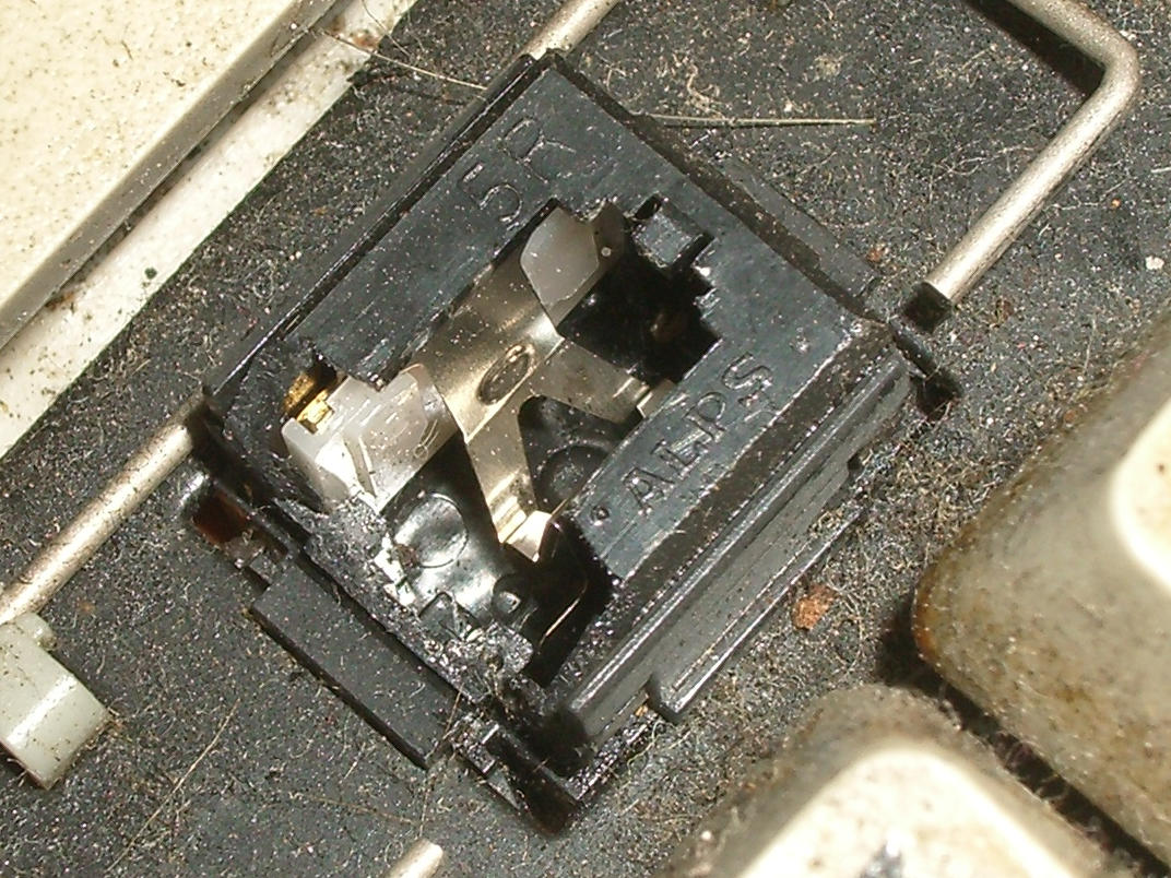

I am not aware that Alps ever sold any keyboard switch tooling to anyone. I'm referring to the switches you can see in those two eBay auctions — they're genuine complicated Alps, but they're not using the same moulds. The logos weren't engraved correctly into the moulds originally.
Genuine internals in one of mine (it arrived broken):
Plum white Alps.jpg (248.76 KiB) Viewed 3762 times
