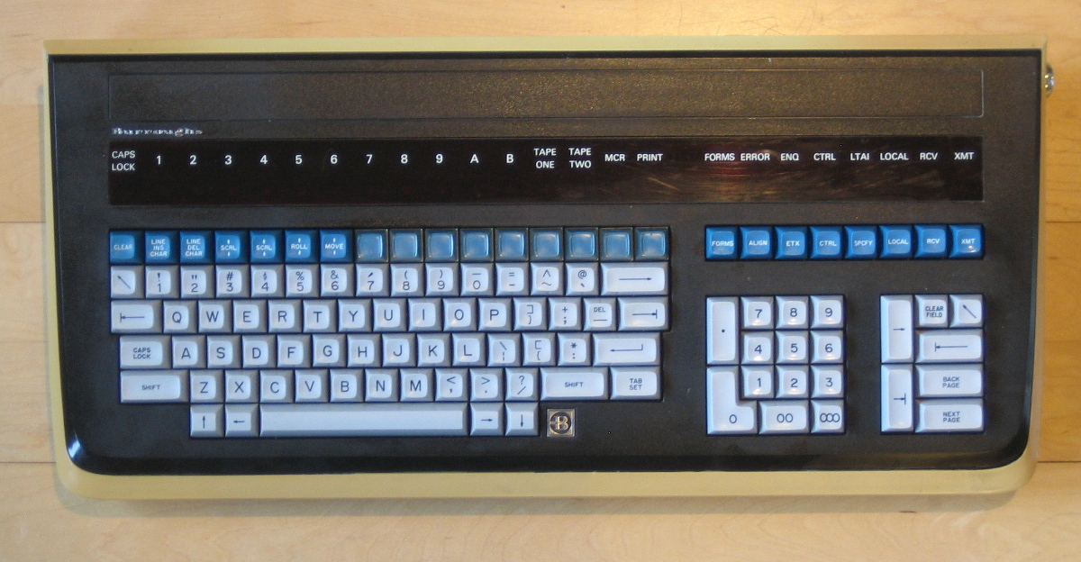

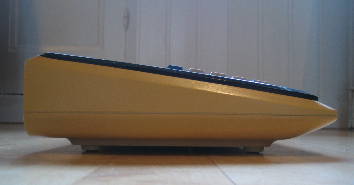

Recently I got a Burroughs TD019, the 'extended alphanumeric' keyboard that went with their TD730 / TD830 system, and which is partly programmable. The only document I could find about it dates from november 1979, and I have the feeling this keyboard dates from 1980 when looking at some of the numbers (it says '8002' somewhere), even though there is no human-readable date marked anywhere.

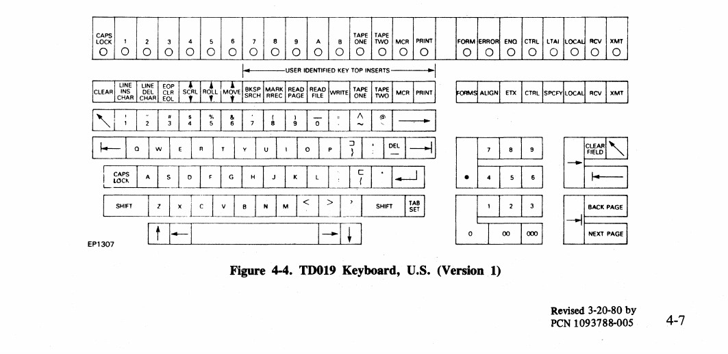

This document has a section about this keyboard:
https://archive.org/details/bitsavers_b ... 79_9065639
and it seems to be essentially the same keyboard as the TP130 HaaTa has:
http://deskthority.net/photos-videos-f8 ... t3664.html

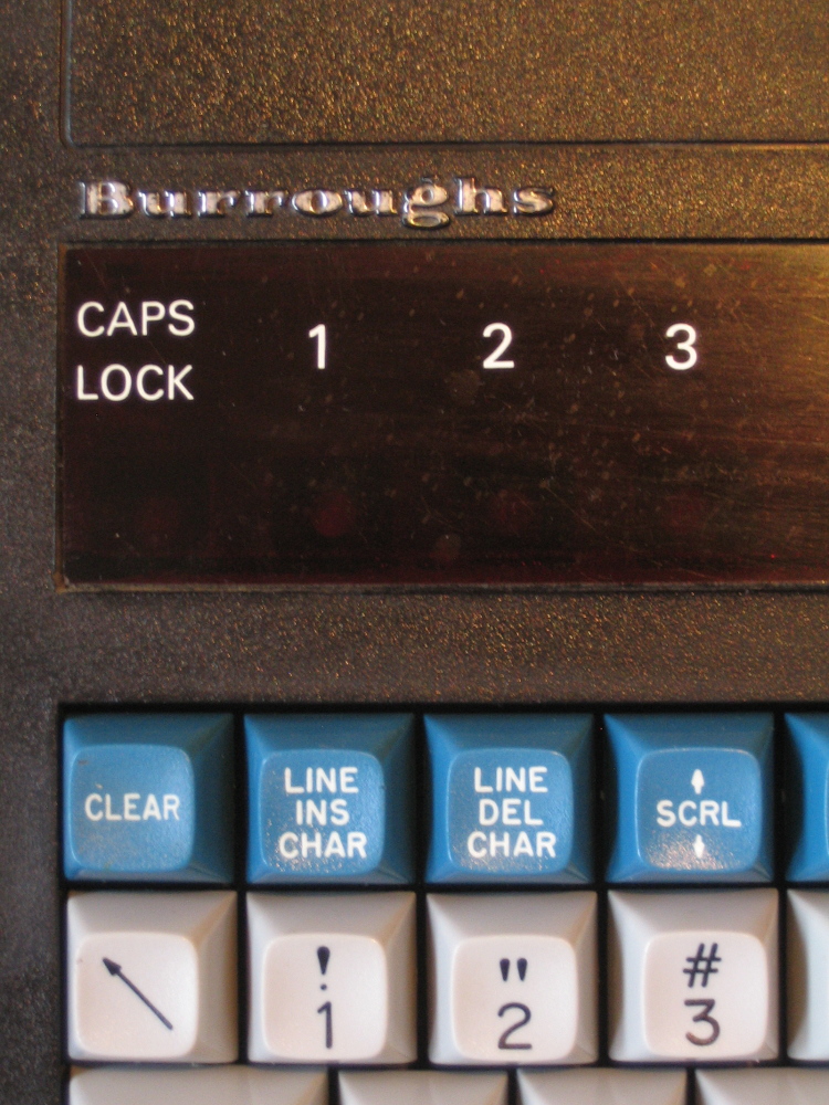

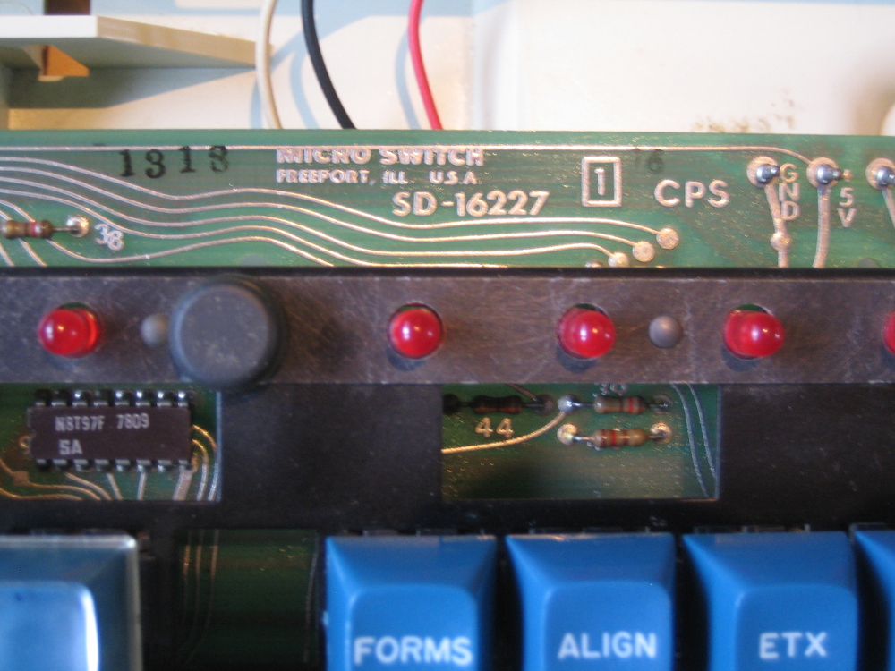

except that the TD019 has more (24!) leds and probably speaks a slightly different protocol.
I really like the design of this a lot, and a striking difference with IBM boards of the same time. I find the IBM board design more pure / simple and because of that perhaps more timeless, but these ones I find have much more the style of their period and I find them somehow more classy / camp, and because of that more retro / dated now. All that is very personal ofcourse.

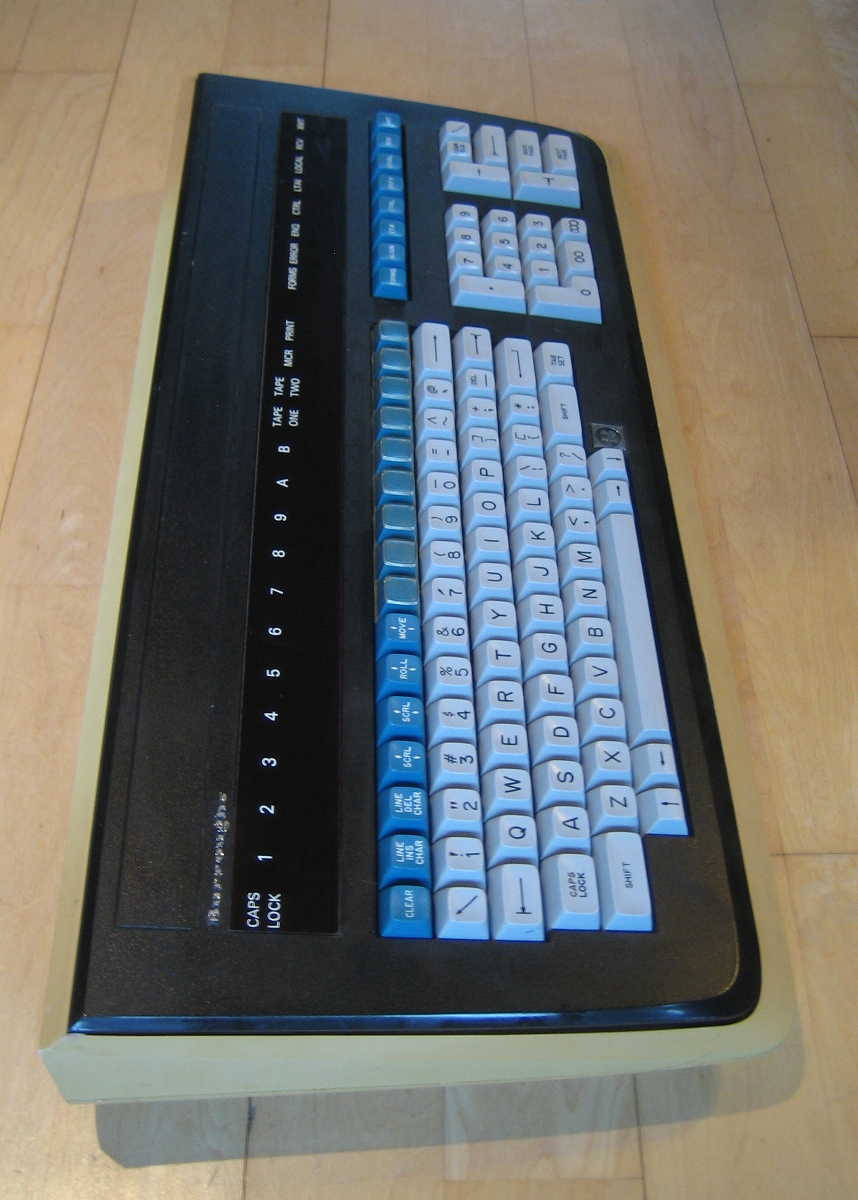

The case has yellowed a lot, so I guess this summer I should try to retrobright it. Espeicially on the monitor side the yellowing is extremely uneven, which makes it rather ugly.

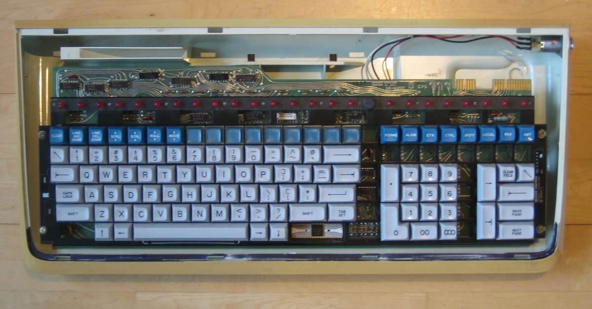

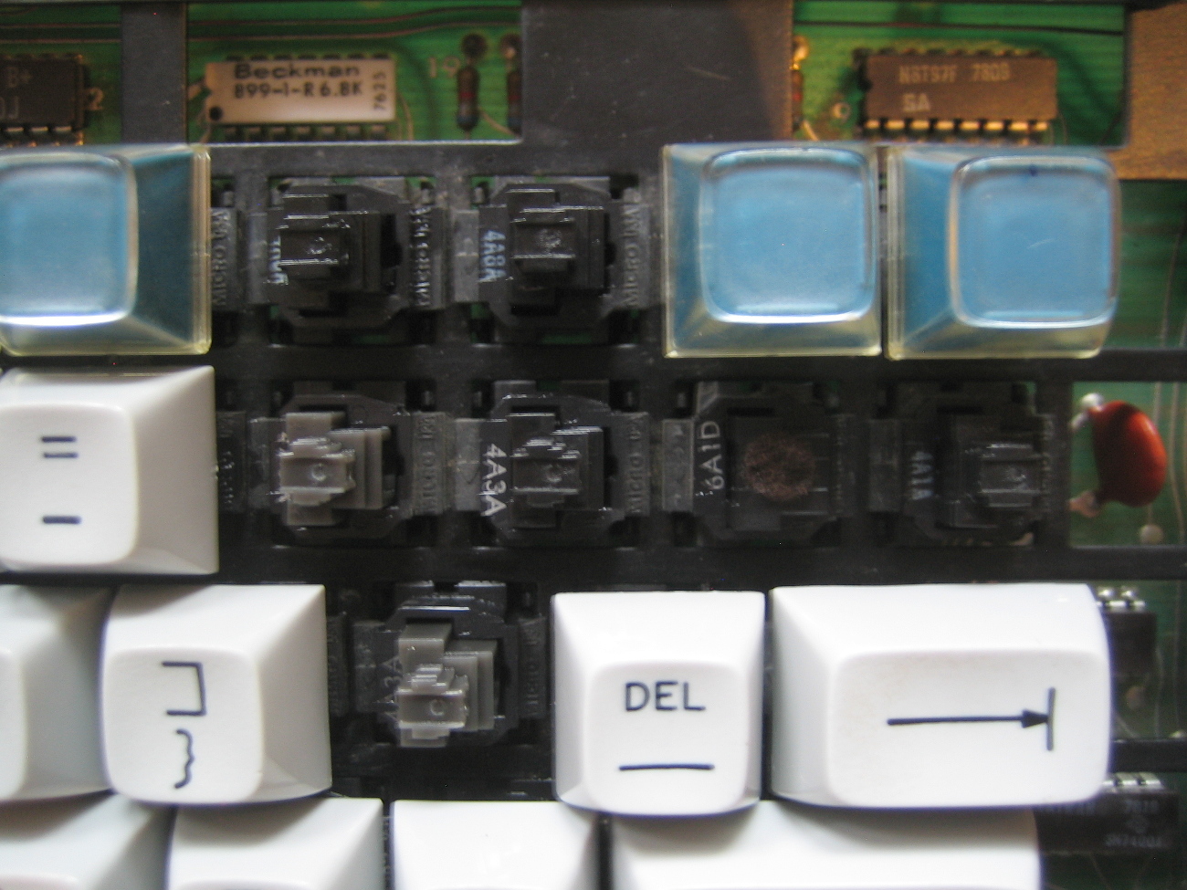

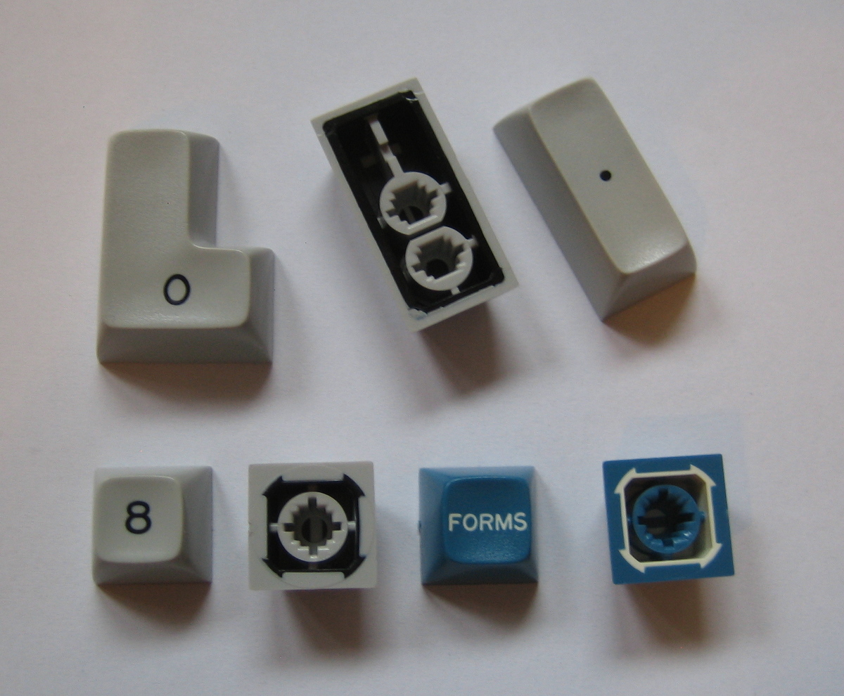

The switches are Hall-effect: I found them a bit scratchy and dissappointing at first, especially considering that my main reason to get this board was to try out these famous switches. But after some lubing they do start to feel fantastically smooth: I am not per se a linear person, but this is something else. Also the switches make it a very silent board, so much more useable in a shared environment than, say, a beamspring.

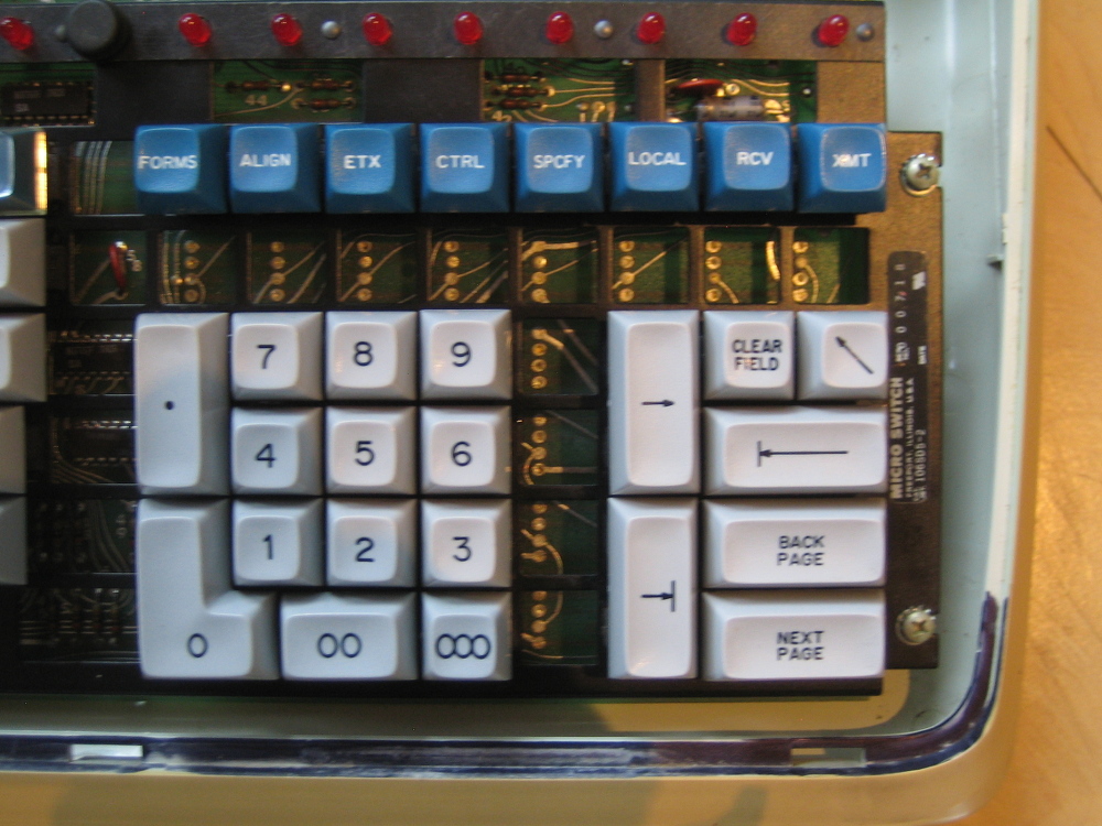

This picture has all the kinds of switches in it I could find on the board:
  • 4A3A are the standard switches, sort of comparable to vintage MX blacks, but more substantial, smooth and more 'even' somehow.
  • 4A1A are the lighter switches used in the larger keys that also have stabilizers: the key as a whole feels rather similar to the 4A3A, a bit lighter perhaps, but mostly they tend to feel a bit less smooth.
  • 6A1D are the stabilizers; no stem, very light, little fluffy thing on top
  • 4A8A are the switches used for the blue keys: they are very smooth, but mostly also VERY heavy. No way you will press these by accident, and they would make great continuous controllers (scroll faster by pressing harder). But I don't think that is how they work, ofcourse.

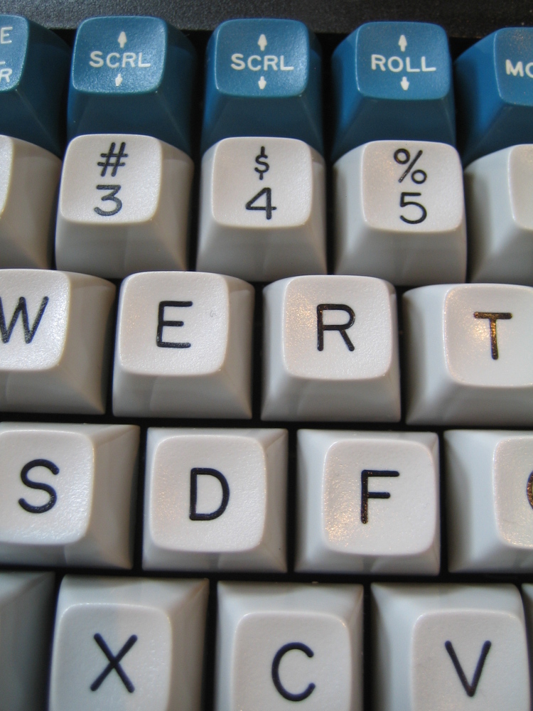

The caps are gorgeous and thick doubleshots, like the Honeywell caps.
Great legends too, and I like how the keyboard layout has not completely stabilized in this period into ISO or ANSI.

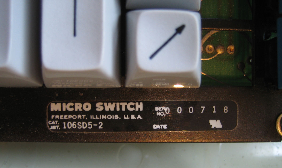

No date, low serial number...

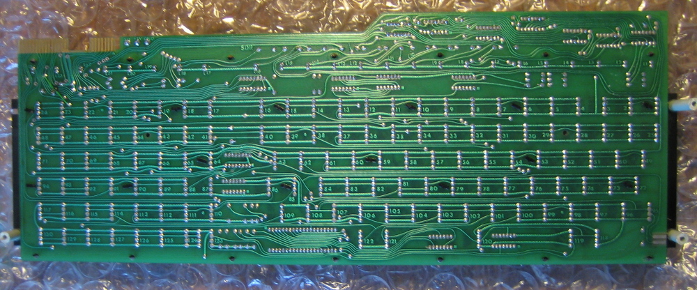

The pcb is double sided, so this is only half the story.

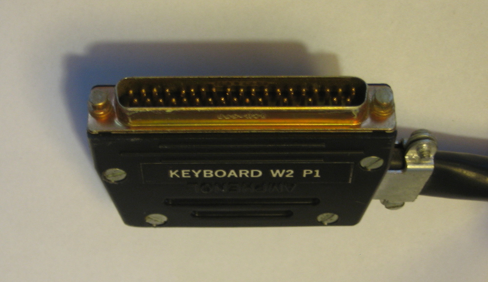

The board-connector on the other side of this cable has 30 wires going in to it: does anybody know how likely this is to work with Soarer's converter ? I have to seriously start looking into how that stuff works, first step will be to connect some 0-5V to it and see if some leds light up.

There's a good bit of overlap with the Honeywell, including, alas, a completely Soarer-unfriendly connector. Here's mine:
As parallel as they come. Soarer's converter is for serial interfaces (there's literally just one data line for XT, AT, PS/2 and the IBM terminals it supports). While the Honeywell pinout is reportedly:
None from Kbdbabel's list strikes me as the Burroughs'. Be careful probing it, obviously. I gave up after some experiments with a continuity tester brought up nothing while I pressed keys. It's not just a bare matrix. That would be too easy! Besides, Hall Effect switches don't work like that, they're more like capacitative sensors and need active electronics on board.

Aha, thanks for that pinout, I suspect mine will be very similar and has perhaps more pins because of those leds ? Some of those are probably controlled from the board, and some from the terminal it connects to. I had vague ideas to try to guess from the pcb what the data outputlines could be and then try to hook up an arduino or similar as a way to see what goes on on those lines, using it as a poor man's scope....
And then try the other way around to see how those leds are controlled.
Your diagram will certainly come in handy for such an excercise.
In principle that could work, but I doubt if the standard arduino routines are fast enough for that and I am not yet versed enough in those things to program them in C. And when I see the -12V in your pinout, it makes me abit more afraid to mess / blow things up...

So, mine are all serial (the TP130 and TP110). But, to do a converter realistically, I need a keyboard with the same protocol.
Doing something basic is doable, but usually there are peculiarities with each protocol.

hmm yes, now that you mention it, on that picure of a TP110 the cable is much thinner than on my TD019: that cable is so thick and unwieldly that I took it off.
In fact it makes the keyboard not sit flush on the desk, which I thought was a weird kind of oversight for such a high-end keyboard, so perhaps the case was originally designed for the TP130 ? Or my cable was put on later, or the wrong way around, or whatever.
