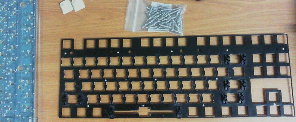

So, first i'll try it on a Ducky 1087C. Step 1, desoldering - done :)
Posted: 20 Feb 2014, 17:01
by Laser

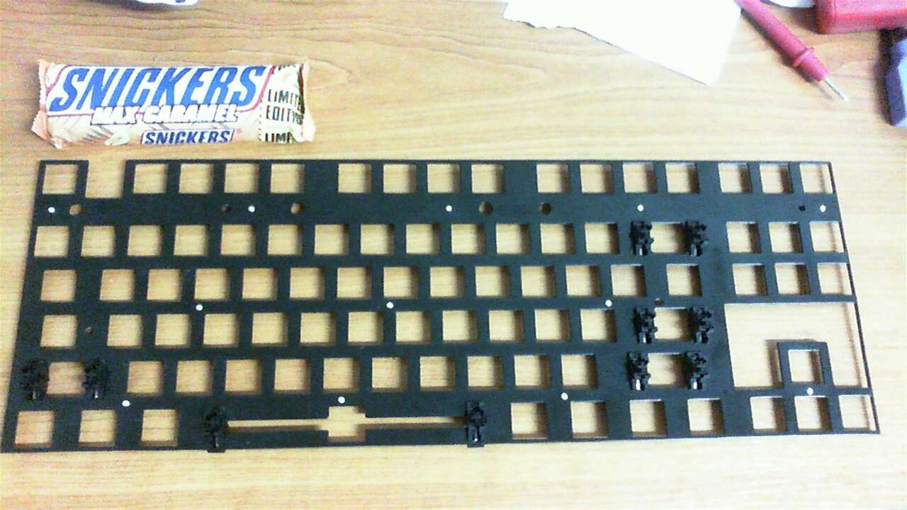

Step 2, "phanducky", done - plate doesn't look aesthetically TOO pleasing, but - it's functional:
I won't bother with the rest of the switch holes (modifiers and so on), since i intend to use non-clicky stems with black springs for those, no matter what the alphanumeric switches are.

It took a while to mod the plate - because i used a portable multigrinder with accumulators - i had 3 sessions, each in a different day, of 1-1.5 hours each (batteries span), so in total - around 4 effective working hours. I used a diamond coated conical head ("bit" i see it's called). I understand that a better solution would have been to use a "reaming bit drill", but i had no access to such thing. And expect some muscle fever in you back (vibrations + not-your-everyday-moves to keep the holes uniform).

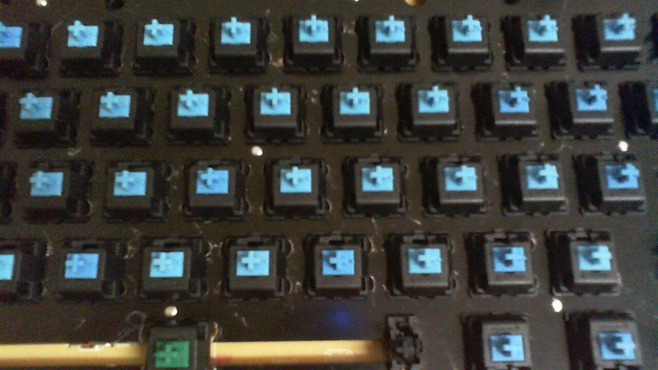

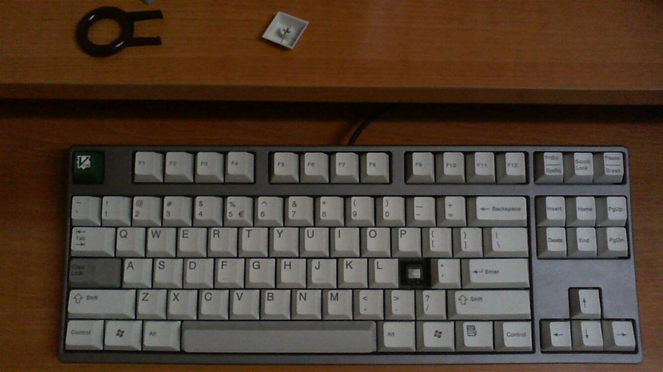

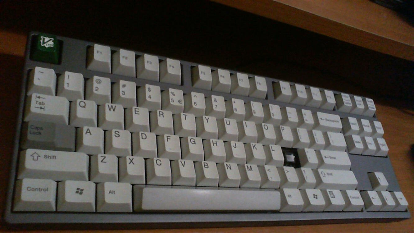

Meanwhile, i finished modding my other keyboard - i desoldered everything and mounted clear switches with springs from the original black cherries. I also took the (thin) PBT keycaps from a Cherry keyboard - can't believe how different they feel on a plate-mounted keyboard! I am very proud of the result: panda clears feel excellent, and the keycaps too :)
(and yes, i know the spacebar is upside down)

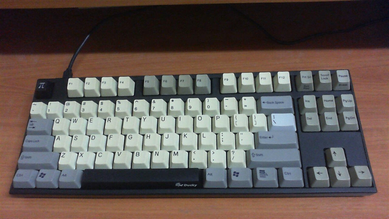

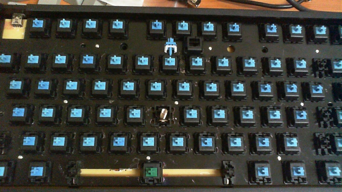

Ok, the post before the last one, coming back to the ducky, this is how it looks after soldering and testing that each key works. I won't remove all the top switches to test the holes, though :P
I decided to go for this keyboard with blue stems & 65g springs.

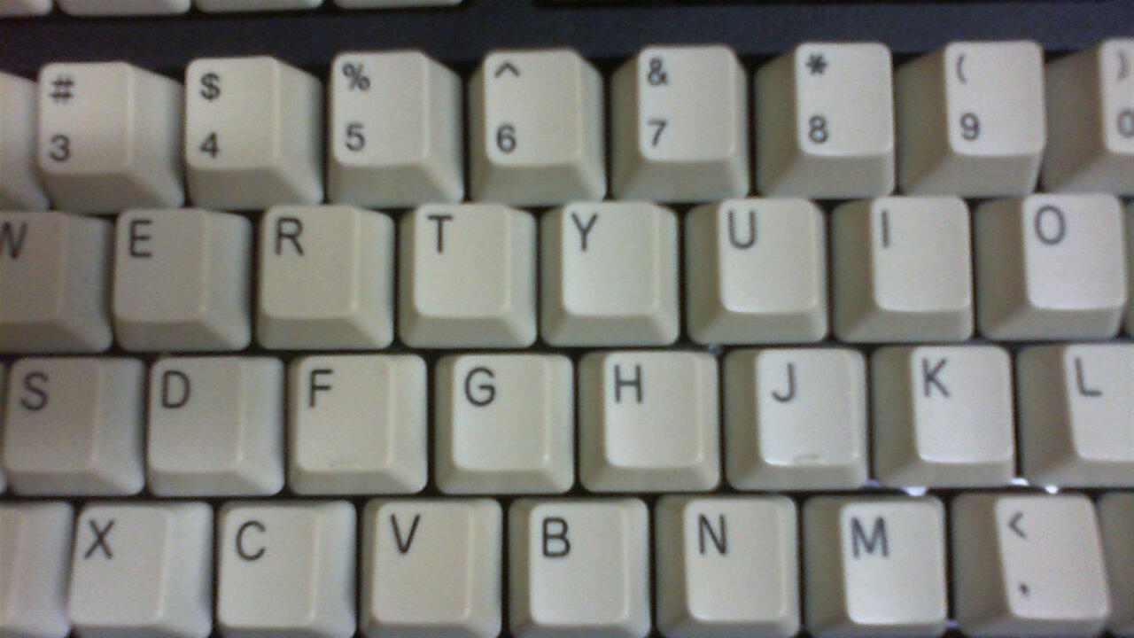

(For completion) Last step, completed keyboard with some mix of semi-matching new & old keycaps:
As you can see, the cutouts are sufficiently small not to be seen between the keycaps:
