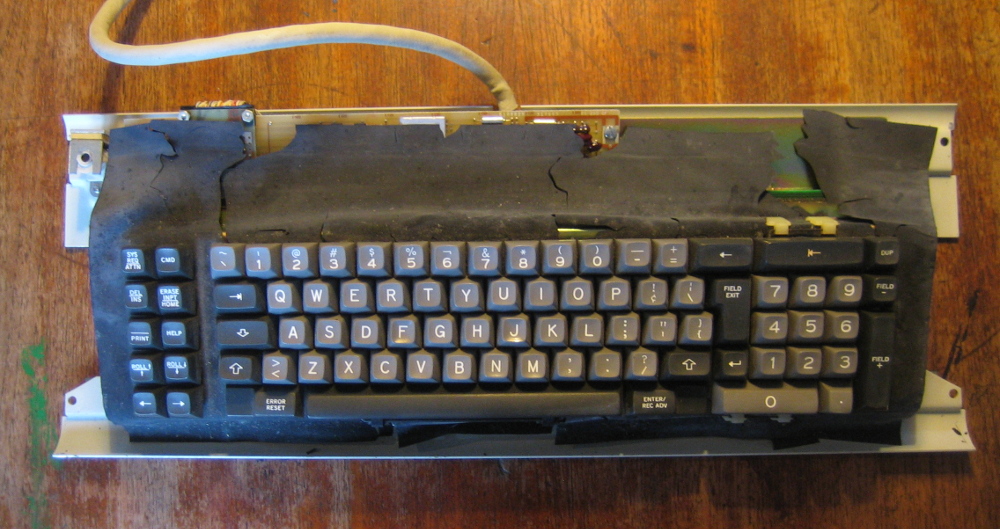

recently received the IBM 5251 beamspring keyboard I had been ogling on Ebay for too long already, and took it apart today to clean and see what it is like on the inside. Next step will be to make xwhatsit's converter and connect it, but dry typing on it feels very good indeed: very smooth and nicely tactile. Somewhere in between my two favourite switches so far: dampened white complicated Alps and buckling spring, but a definite improvement on both I think. And I find out that I like keyboards to be heavy !
Pictures are probably hardly unique and not very good due to my skill, crappy camera and gloomy lighting conditions, but still.

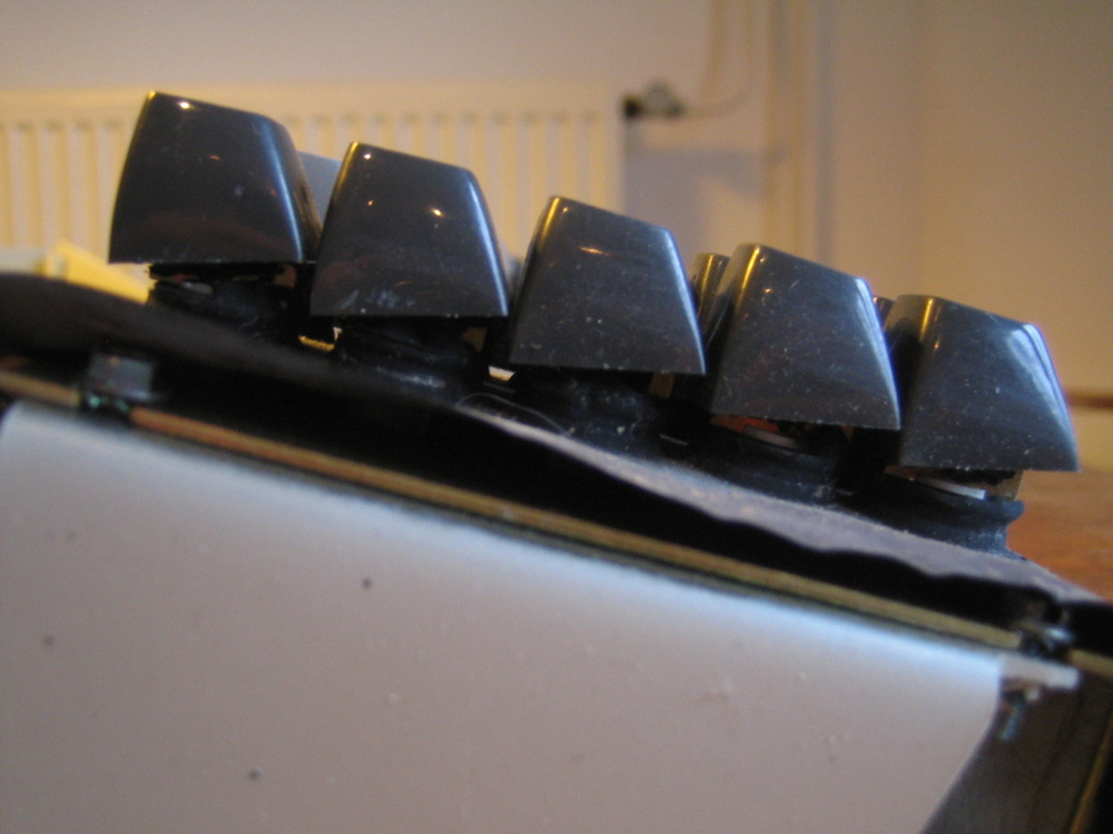

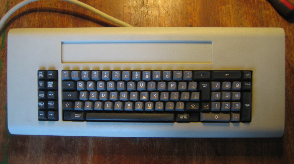

I really like the keycaps: very tall, nice rubbery feel and great font. On the whole the keyboard seems to be in very good shape: no external damage really and keys nicely lined up. The 'field+'-key on the far right missed its stabilizer, but I found it inside the keyboard. The part of that key that has the hole for it has come off on one side, in the not so recent past it seems, so I need to figure out if I can re-attach it somehow.

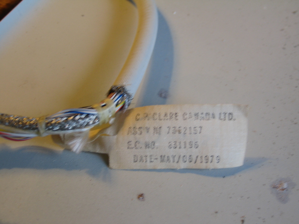

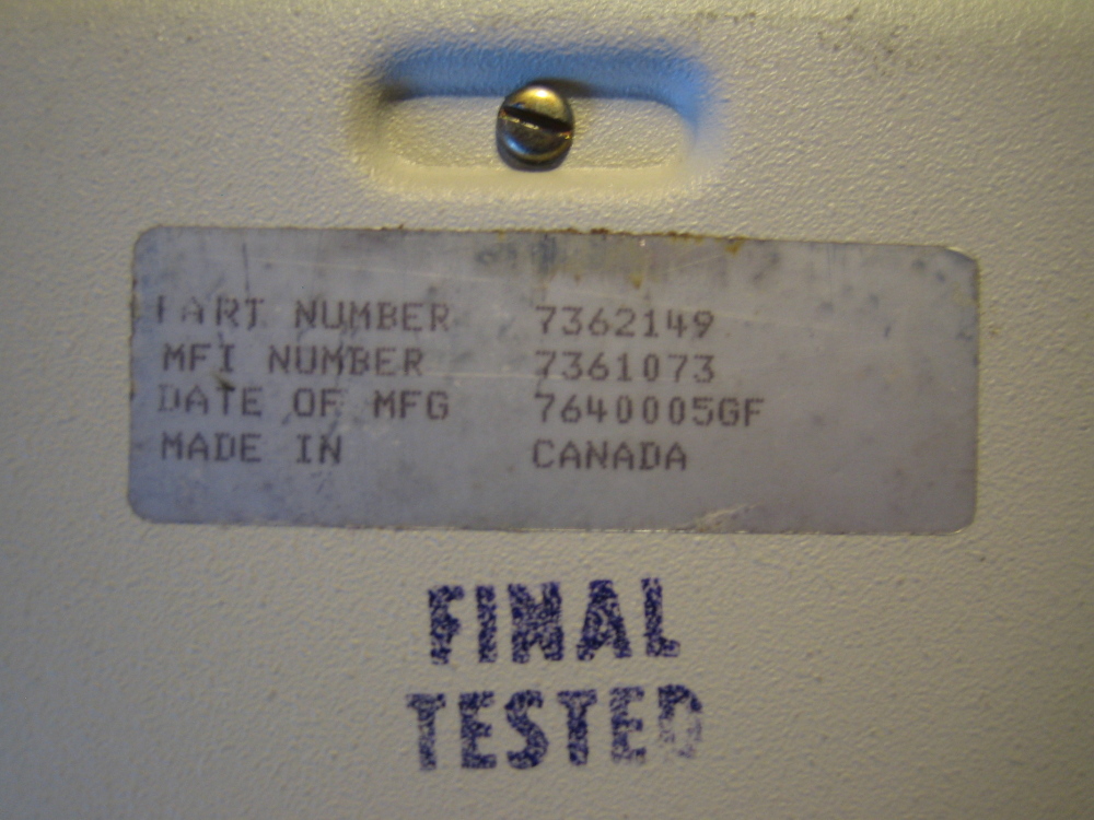

I don't really understand what date it says here, I thought 1976, but that is not right, see later...

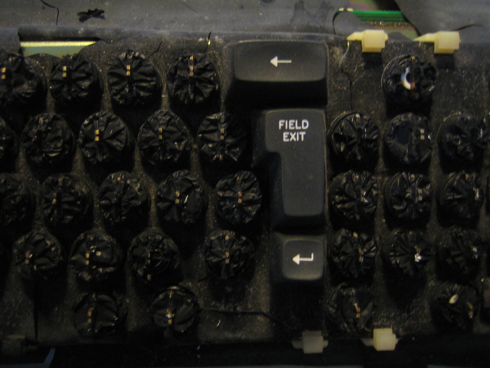

the rubber shielding under the keycaps is disintegrating and little flakes get into the switches, so I removed it completely.
Here http://geekhack.org/index.php?topic=46134.0 is a description how to replace it with poly, but I'm think I'm going to try and find some more rubbery material first.
Some dust and mostly traces of plant life, not so many human remnants, considering its age.
This was a surprise; the picture is very crappy, but this says the keyboard was assembled on the 6th of may 1979, almost 35 years ago.

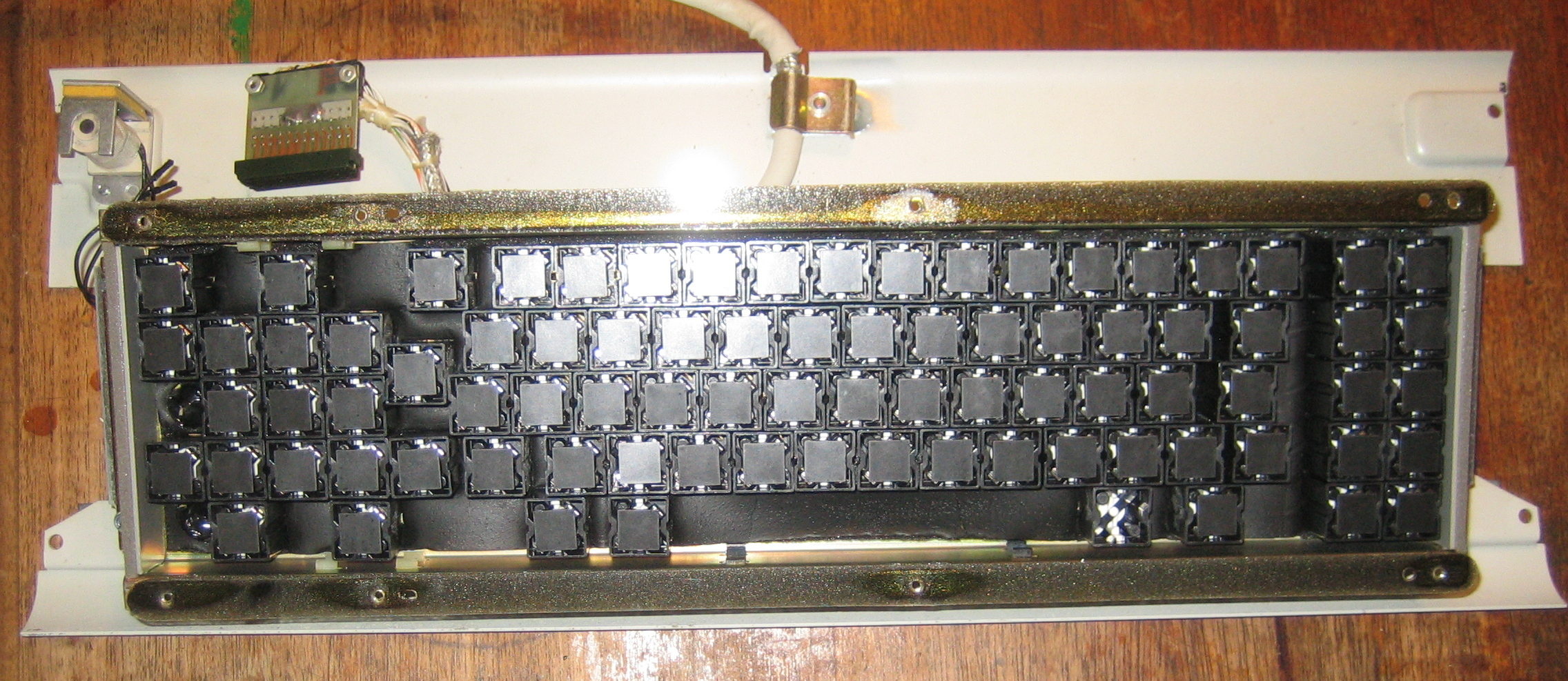

I took out the metal keyboard assembly, and attached it to the base upside down, so that I could take off the bottom plate without risking that the switches fall apart. Here a great look (but crappy picture) on the fly plates and the rows of individual switch units:

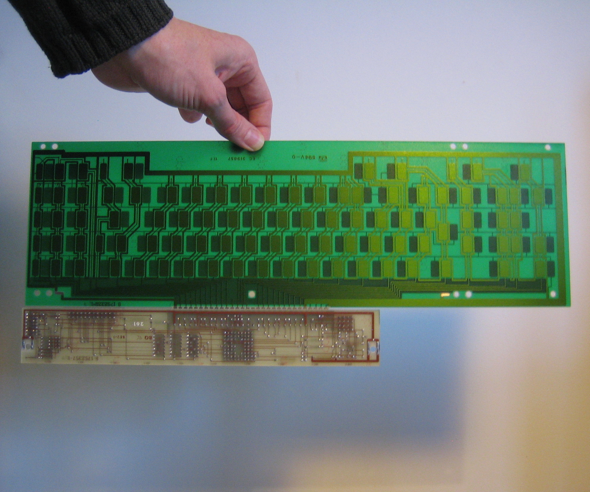

and here the pcb:

About the date, my practise is usually to just pick the most recent date on it and call it that, but that might not necessarily be the case. If IBM makes up 100 housings in 1976 and keeps them around as production uses them, you might end up with a KB that's from 1976, but the cable is from 1979. Also, the cable could have been replaced at some point in the KB's lifetime.
I think in mine the cable is a good year older than the rest of the KB, so I would imagine KBs and cables were paired up at some late point in manufacture.
That's a good idea with attaching the keyboard assembly upside down when you take off the bottom. I just held it, and it was much harder to get a good picture.
Using Webwit's "unique" beamspring naming convention, this is a "C R CLARE CANADA" keyboard.

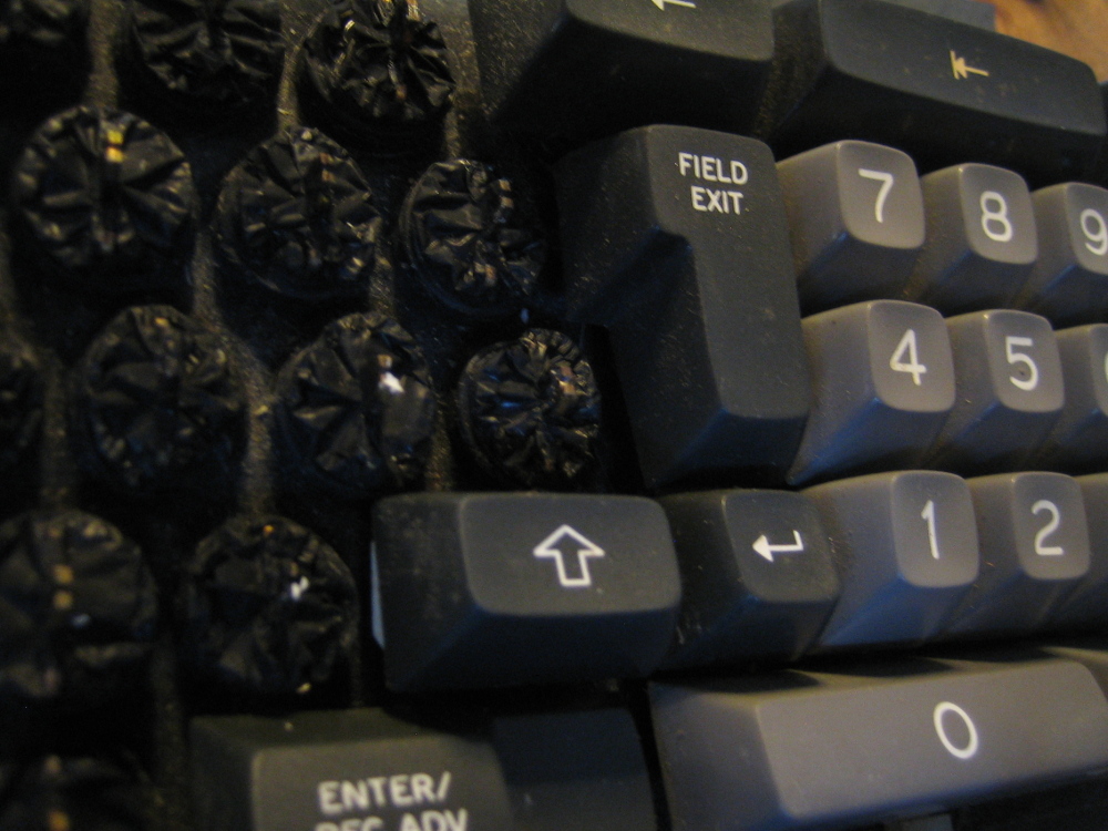

Also thanks for including the keycap profile picture. The function keycaps look to be the same profile, but is the rest of the KB like that? On my displaywriter, the functions are on the same profile (as it should be, same with tenkeys.) but the alphanumerics are all sculpted.
As another interesting note: I had to be very careful when replacing the H key, as the center profile is almost (but not quite) flat. It's like 0.5mm or less of difference between straight and flipped, but noticeable nontheless. I took a picture to show this and can upload it if anyone is interested.

funny you say that about the 'H', as I was flipping out when putting the 'Z' key back on. I noticed the profile was weird and for a moment I thought that the keyboard must have had a german layout originally and that the seller had swapped the 'T' and 'Z' keys to sell for more.. But then I realized that 'Z', 'X' and 'N' are all keys you can put on in two ways....
It is true the function keys all have the same profile, but the alphanumeric keys certainly don't, also on the 5251. But the numeric bloc is again all the same (top row) profile.
It seems that you actually understand the date number on the back; can you explain ? I can see that it starts with 76, and that is sort of suggestive, but for the rest i do not get it at all..

ok, here some picts to, show the sculpted profile in the middle and the uniform profile of the function keys on the left and the numeric block on the right:
