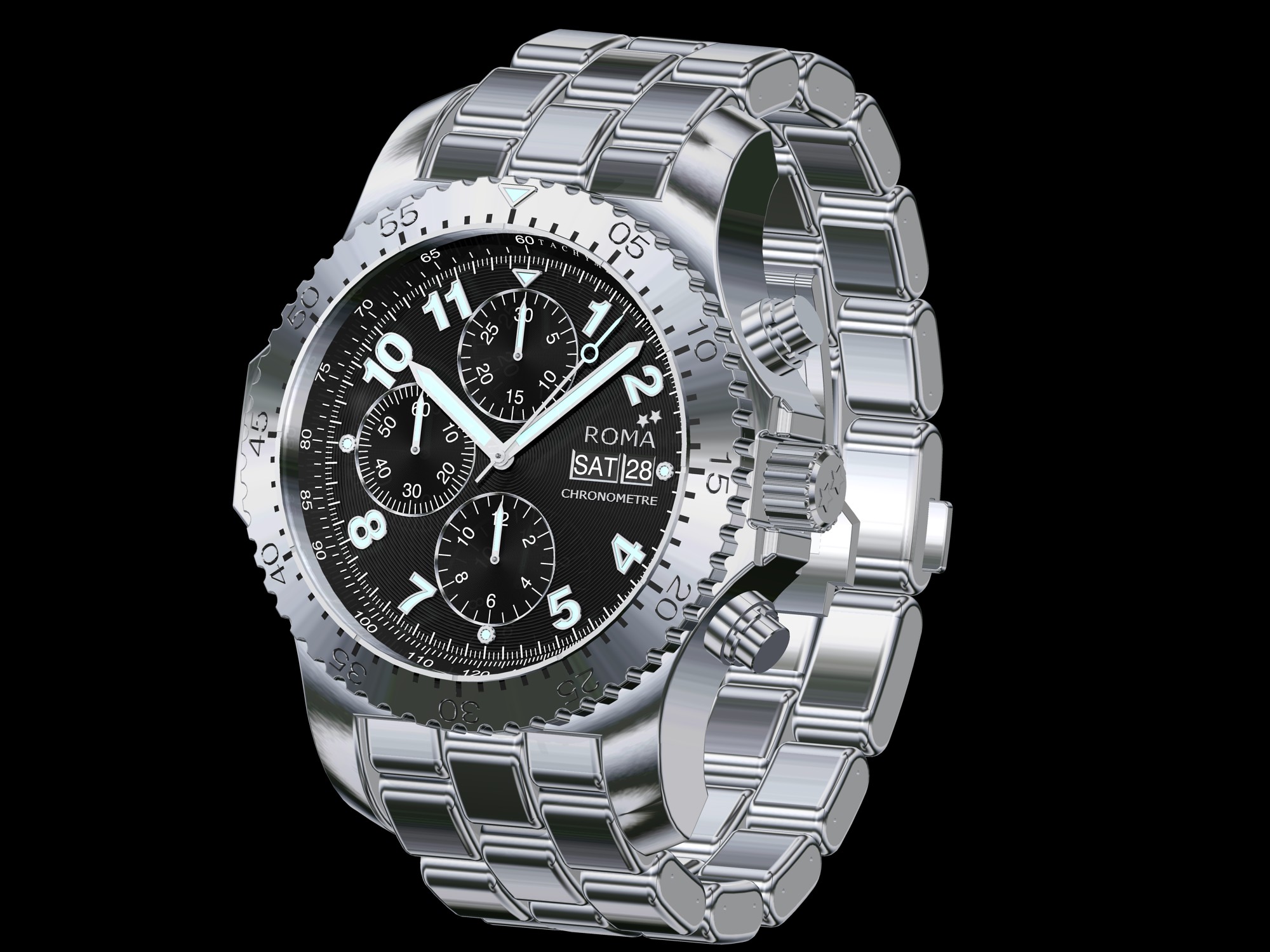

Well you failed to say so then. Your proposal:M'er Forever wrote:... I started this thread to display my ideas about complex watches ....
If you just wanted to show off your rendering skills go ahead, do an M'er show. But I thought two times before posting the speedmaster and wouldn't have bothered if I had the impression this thread is just your vitrine.M'er Forever wrote:As a hobby several years ago, I taught myself 3-D solid modeling and photorealistic rendering, mostly to indulge my interest in complicated chronograph watches. Here's an example of a design I did a while back:
[attachment]
Anybody else out there share an interest in this type of watch? I have many more examples, some of which I'll post if there's interest in this subject
Then you go all out about complications and such like you have to teach little children basic mechanical watch abc. You are aware that the globe in the Greubel Forsey GMT is a complication? website:M'er Forever wrote:...No, it's irrelevant criticism that I can't take. You know, like suggesting my designs should have "more globe" in them. I started this thread to display my ideas about complex watches. If you don't like complex watches, this is not the thread for you....

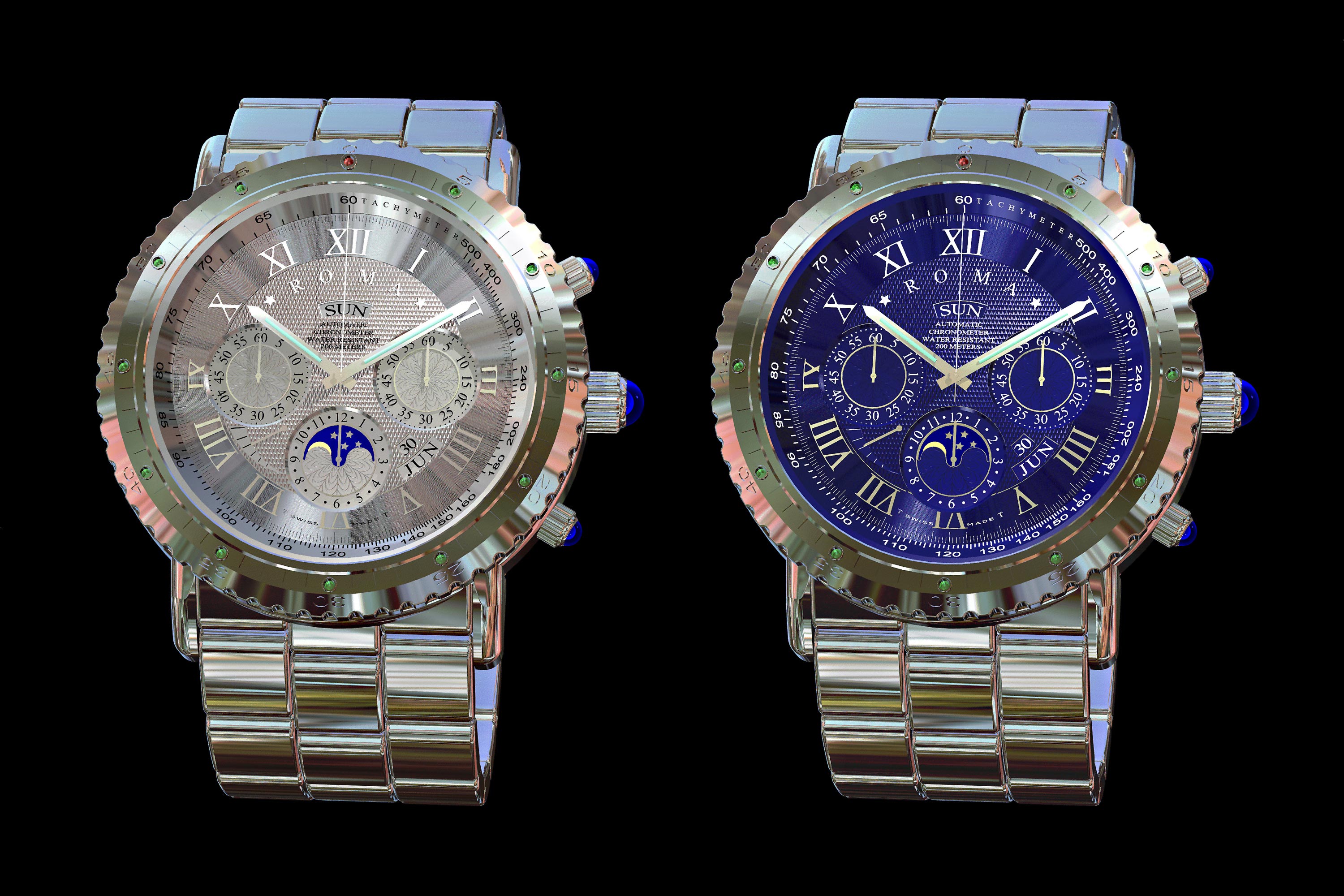

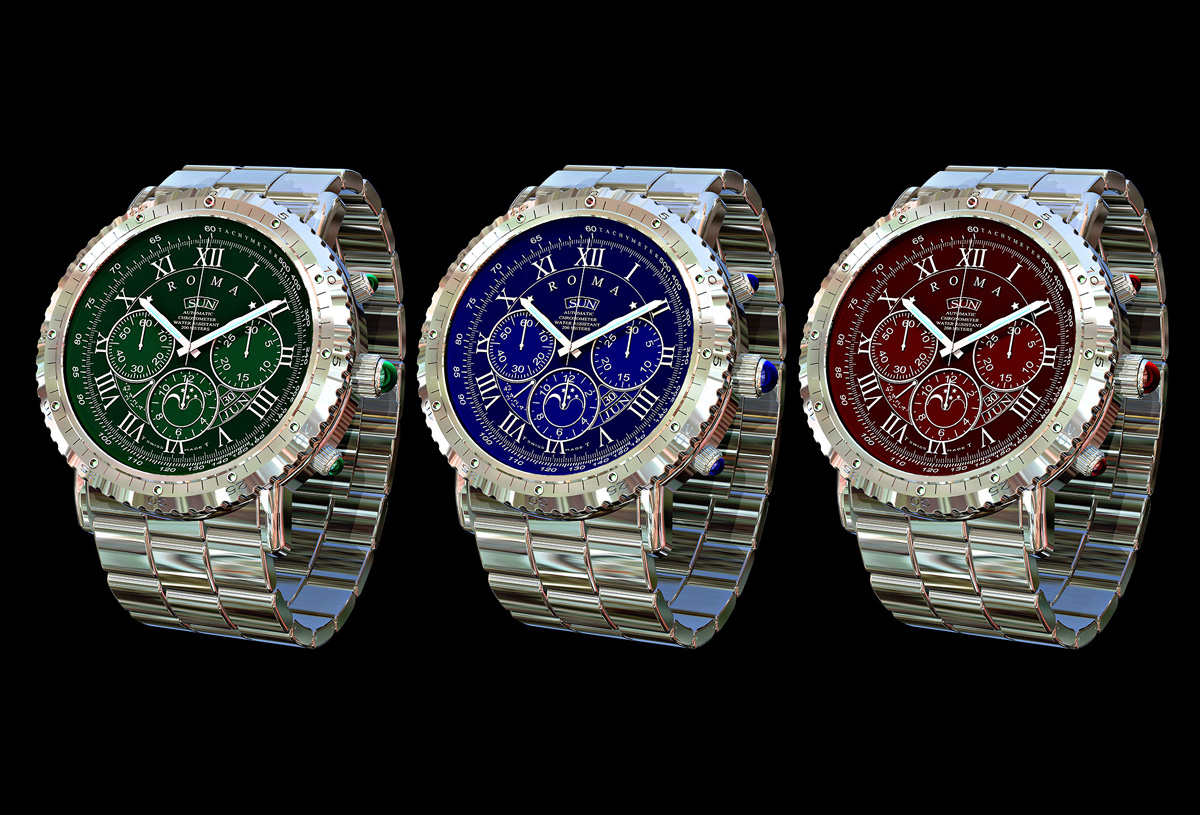

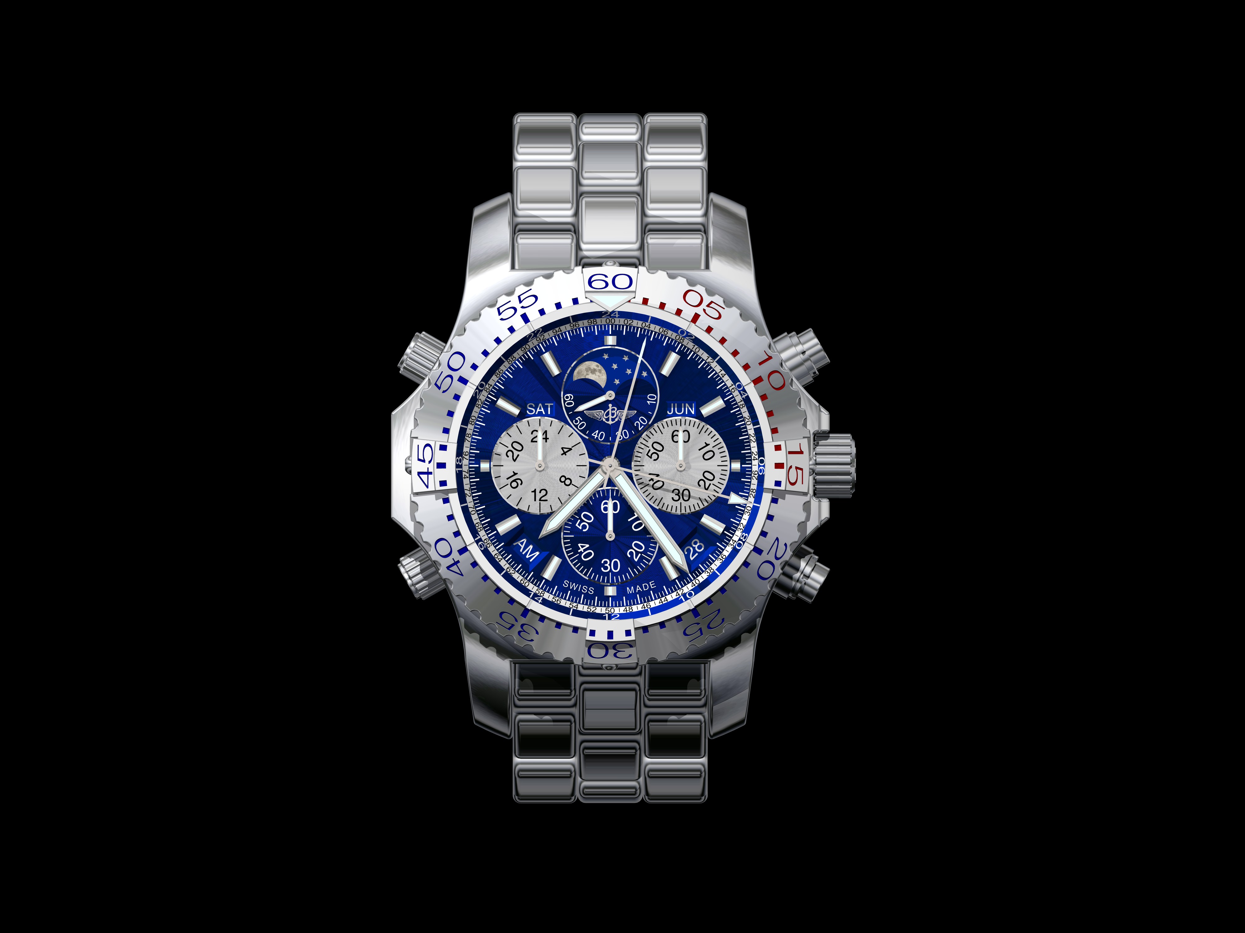

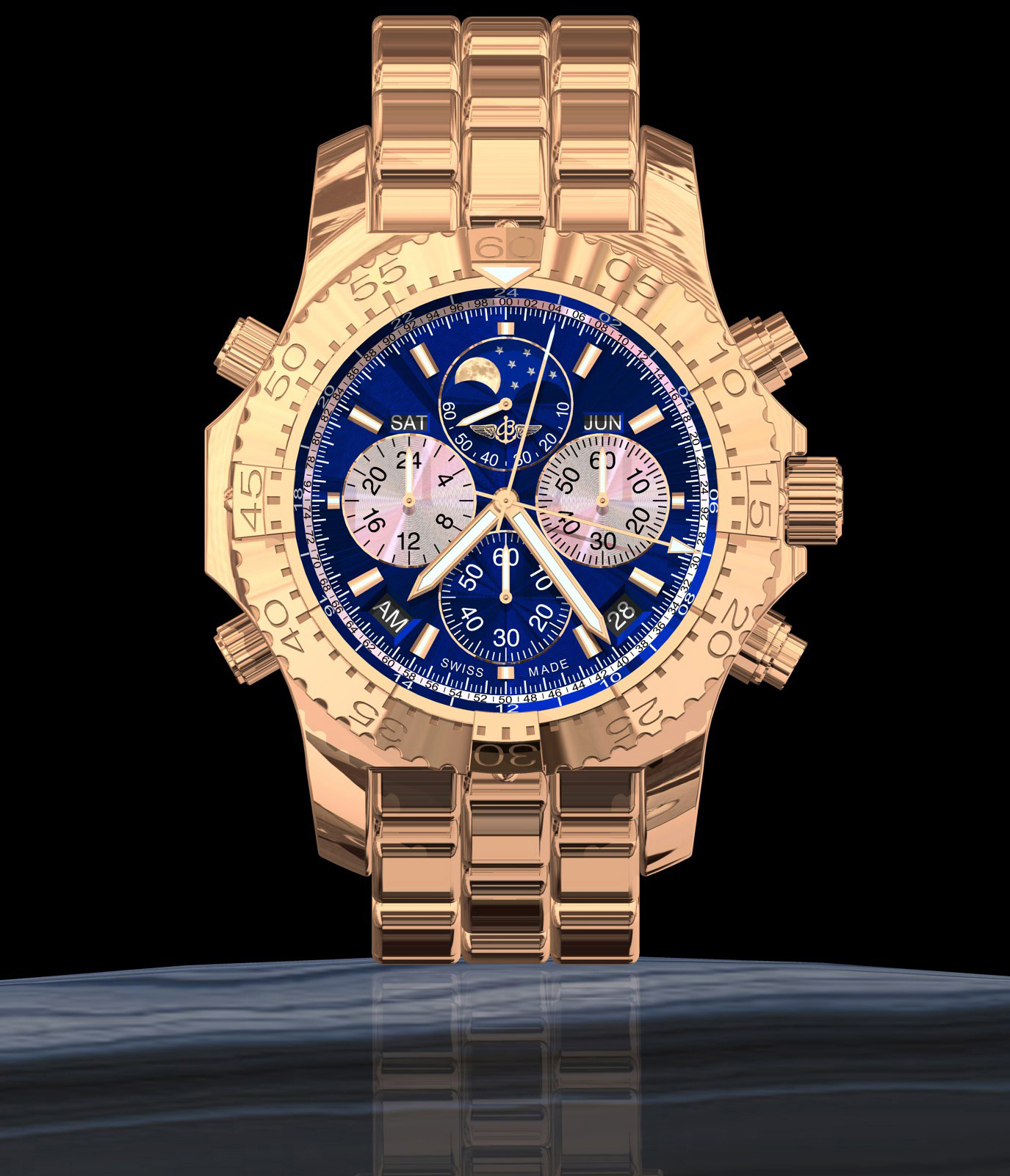

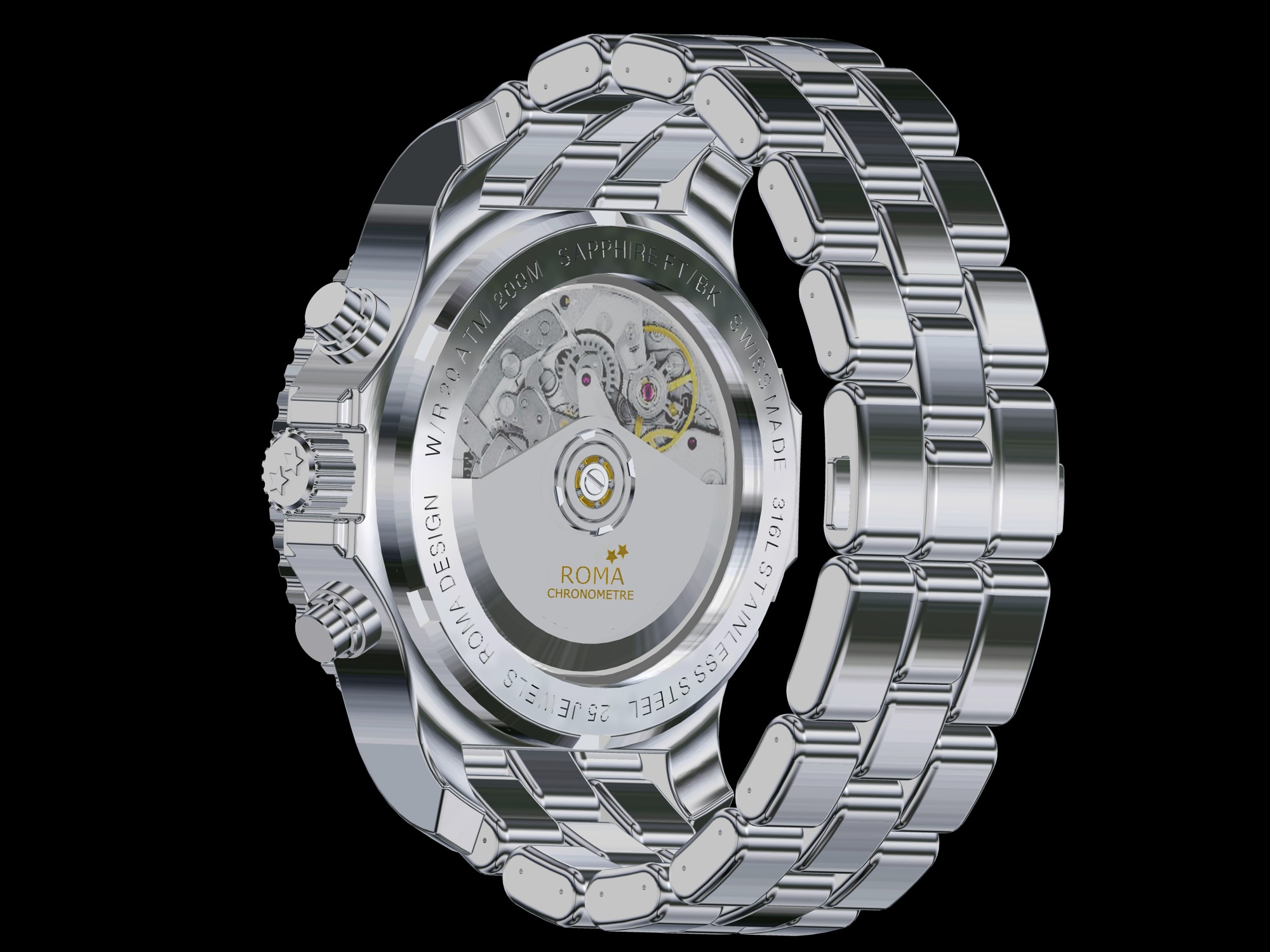

Some general tips would be to:
-Use anisotropic shaders for the brushed areas
-Make the chrome less perfect, that looks like a surreal mirror.
-Adjust the focal length, several of those renders appear to be completely orthographic.
- damorgue
- Location: Sweden
- Main mouse: MX500
- Favorite switch: BS, MX Green and MX Clear
There are free options such as Blender. There are several free standing ray tracing engines which could also be used. None of them will accept your models straight from AutoCad though. The issue is that you are unfortunately attempting to create "photo realistic renders" with software incapable of doing it. AutoCad does solid modelling, which isn't meant to do these things and even if exported to a decent render engine won't generate very good results.
No, I have not used AutoCAD much. I mostly use ProE and Catia for solid modelling, Alias for surface modelling and Blender for polygon and mesh-modelling in my work as an industrial designer. Not their separate uses. I am just trying to encourage you to either switch tools and realize that those are quite far from photo realistic if you intend to progress with this.
