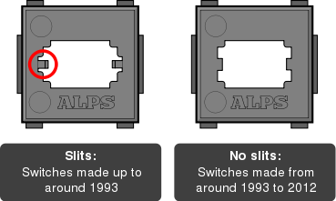

Currently rewriting the Hi-Tek/Stackpole pages (starting to figure them out) but I do need to do a clear diagram to show the branding and numbering differences between complicated and simplified. The design of the shell is essentially identical. The key change around 1993 was the removal of slits:
There was no change after that, but the circles were removed, and the mould numbering was reduced to NW and NE, with no SW number retained. The Alps logo also became a lot puffier. Interestingly, the base retained the old oval Alps logo that was long obsolete by then. Considering how terrible some genuine Alps shell mouldings are one has to imagine that complicated Alps production must have been expanded or simply moved or Taiwan in the early 90s.
