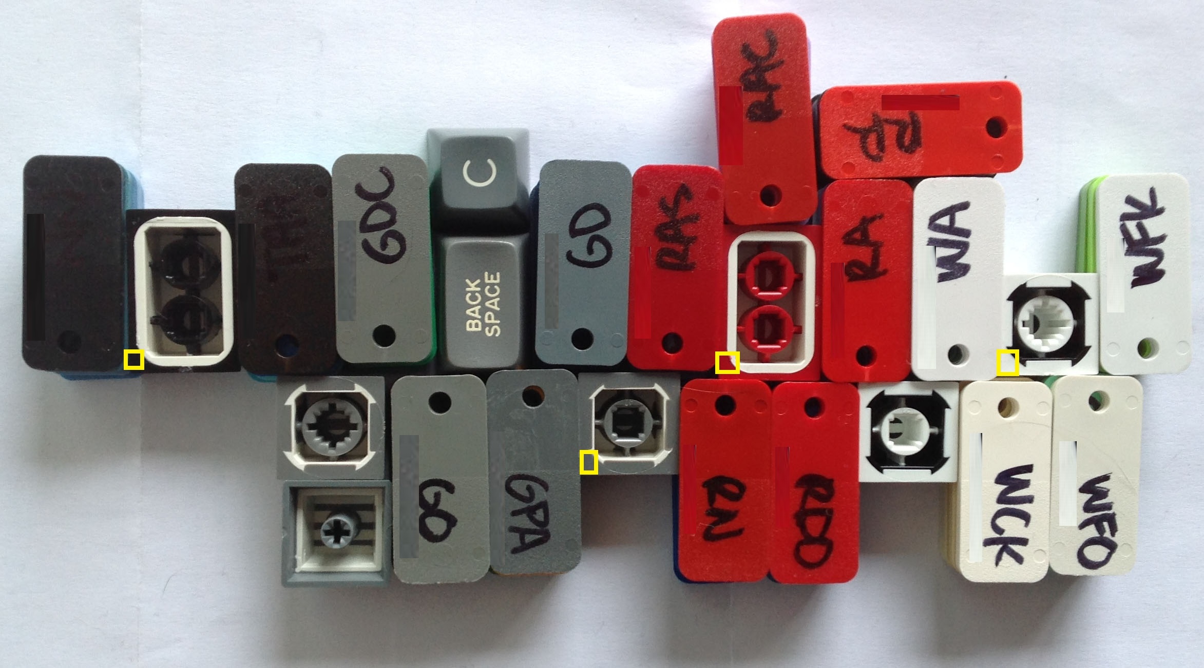

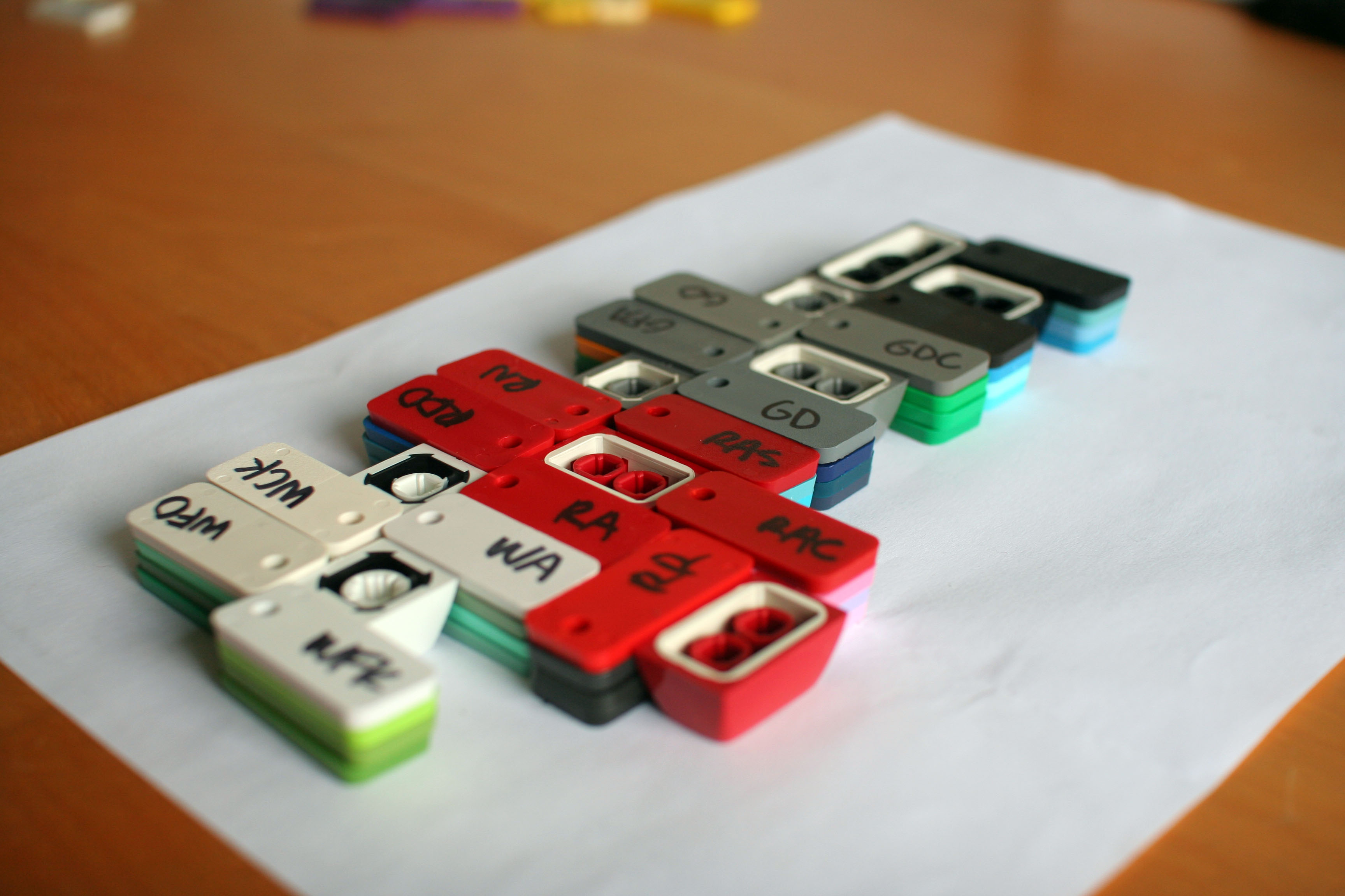

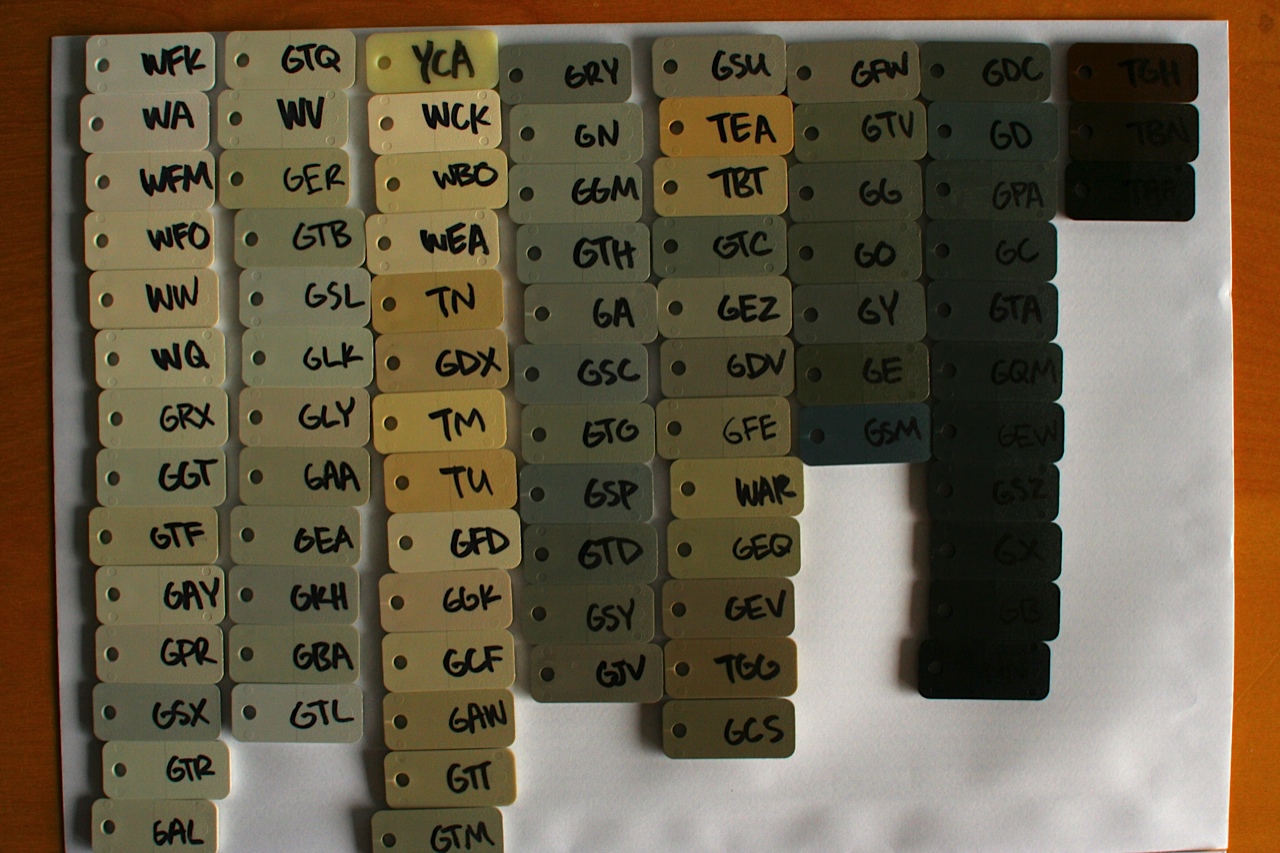

Signature Plastics' ABS samples are here and 7bit has set me the task of matching the original Honeywell colours for Round 5. I arranged them by shades on my desk and picked out the best candidates for each of the four colours. Matching is harder than it looks because these 30 year old caps have a very shiny finish (the tops are matte but a little yellowed) while the samples are less reflective. So, take a look for yourselves.

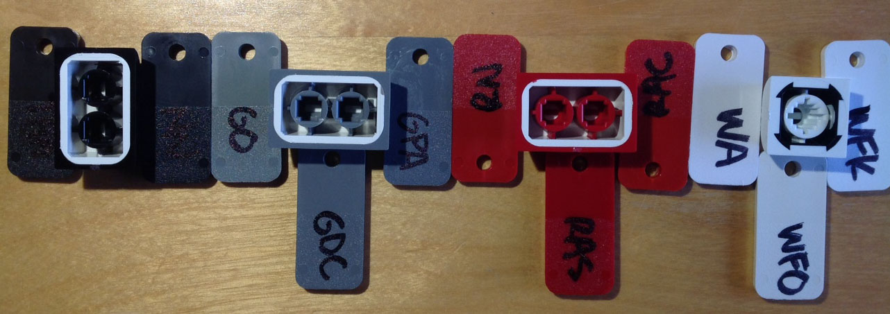

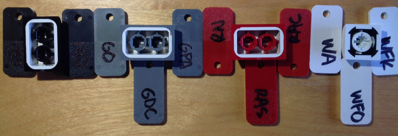

Natural light: The blackest black in SP's set is NN, on the right. Yes, they write in black felt tip on those ones too! The Honeywell's black looks darker yet because it's shinier. (The difference is even more obvious in real life.) But NN is really, really black. So I think we're alright. It's just that super glossy Honeywell finish.
And with a boost from a harsh blue/white LED lamp: My IDs are…
Black: NN (including legends on white keys)
White: WFK (including legends on all non-white keys)
Grey: GPA or GDC, they're very close.
Red: RAS
I'm sure my first attempt at pictures will make our favourite GB-running robot cross. Suggestions are welcome before the sun peeps between the chimneypots again and I have a second go tomorrow!
Red: RAS

True. I pulled it out to emphasise the difference in the greys. It overdoes it, but increases the contrast between those three a bit for comparison's sake.

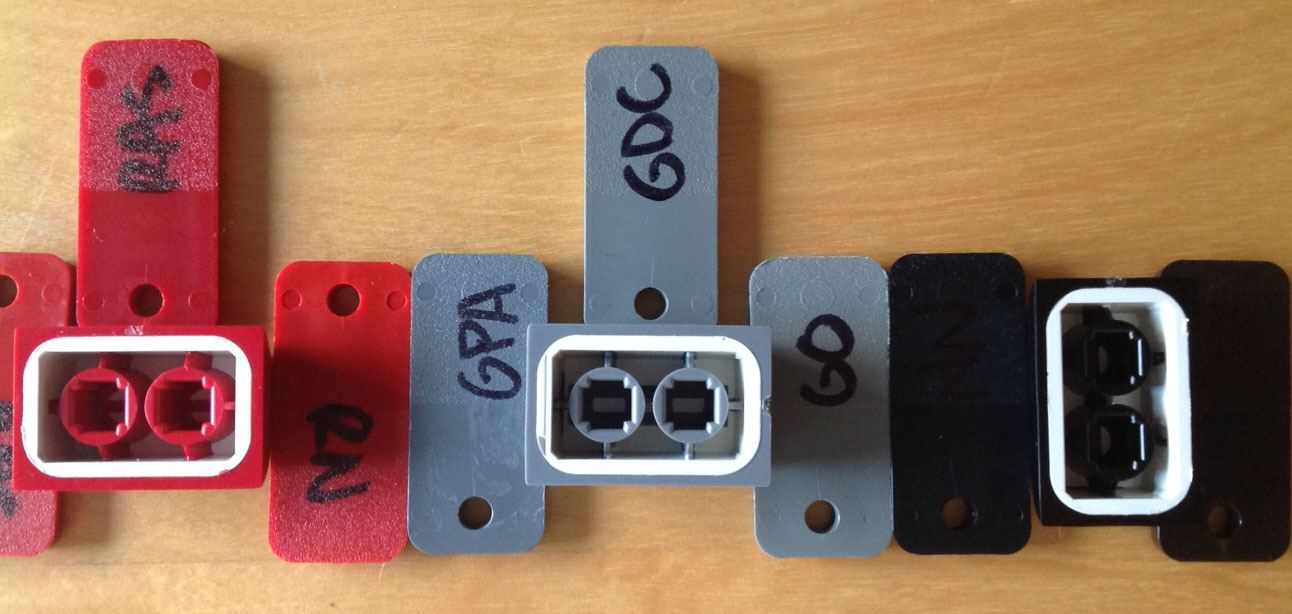

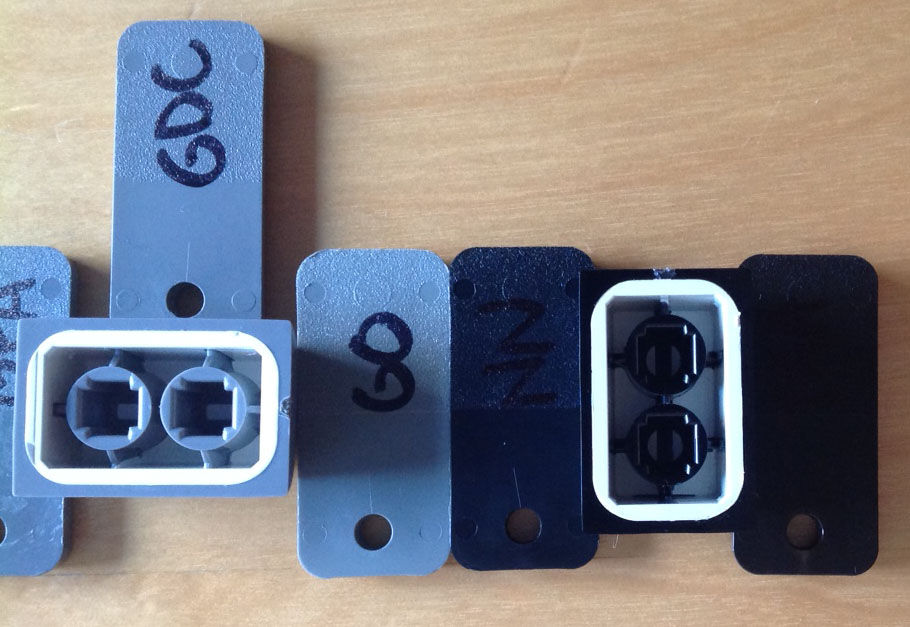

Is GD too different from the Honeywell grey?
- Muirium
- µ
- DT Pro Member: µ

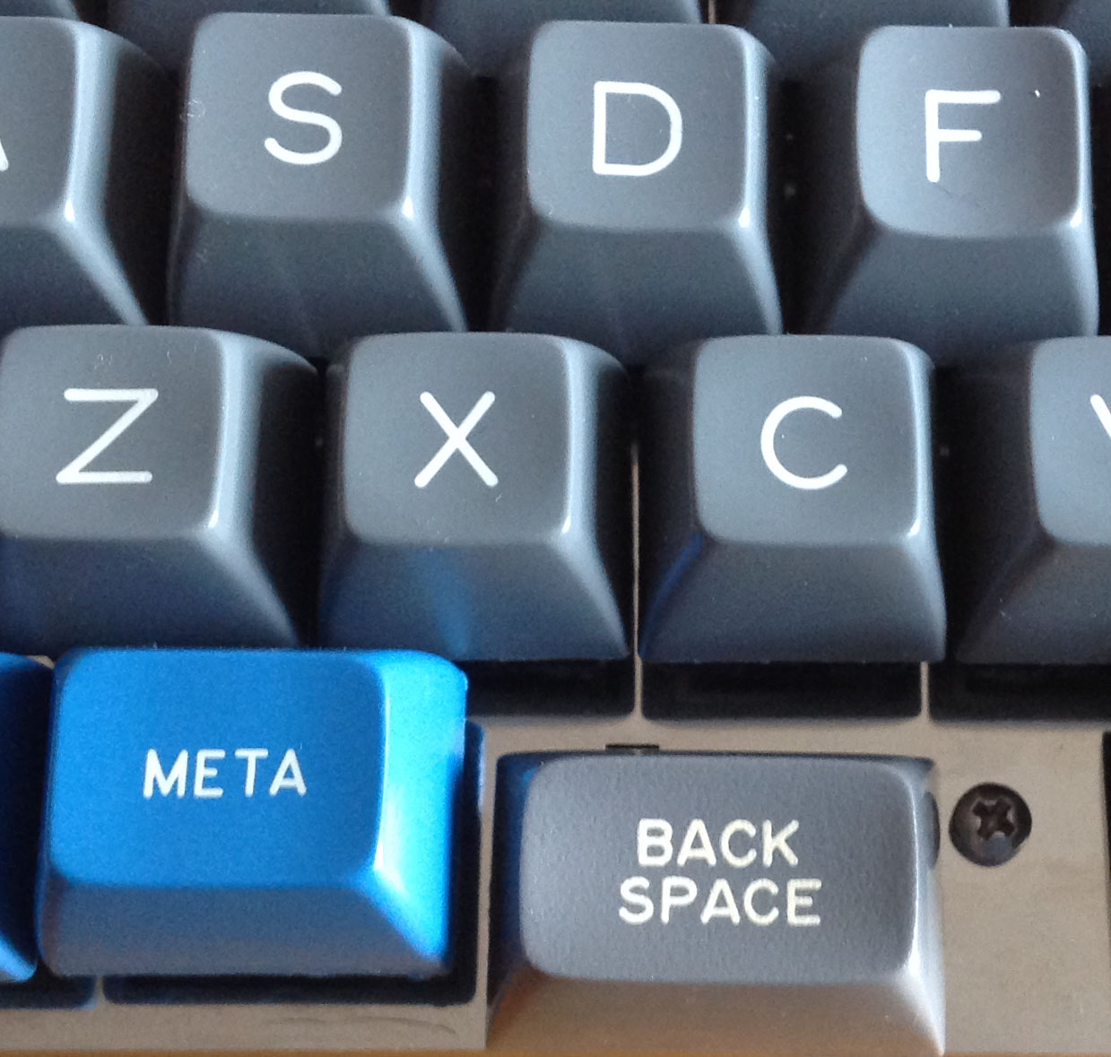

GD's pretty close, actually. Let me guess: is that R4 SPH's grey colour?
Honeywell-SPH-SPH-Honeywell. (More pictures.)
RA isn't such a near match. Honeywell red is a bit darker in shade, more like RAS. I'll get them all out and shot tomorrow.

RA is a lighter red, that's true, so I think we should go with the darker one.
I don't think we should go with pre-yellowed legends this time and stick closer to ther original as it was when new.

the only decent red seems RAS to me, RAC looks... cheap...
GDC looks pretty close, just a pinch too dark maybe? but GO is a bit off

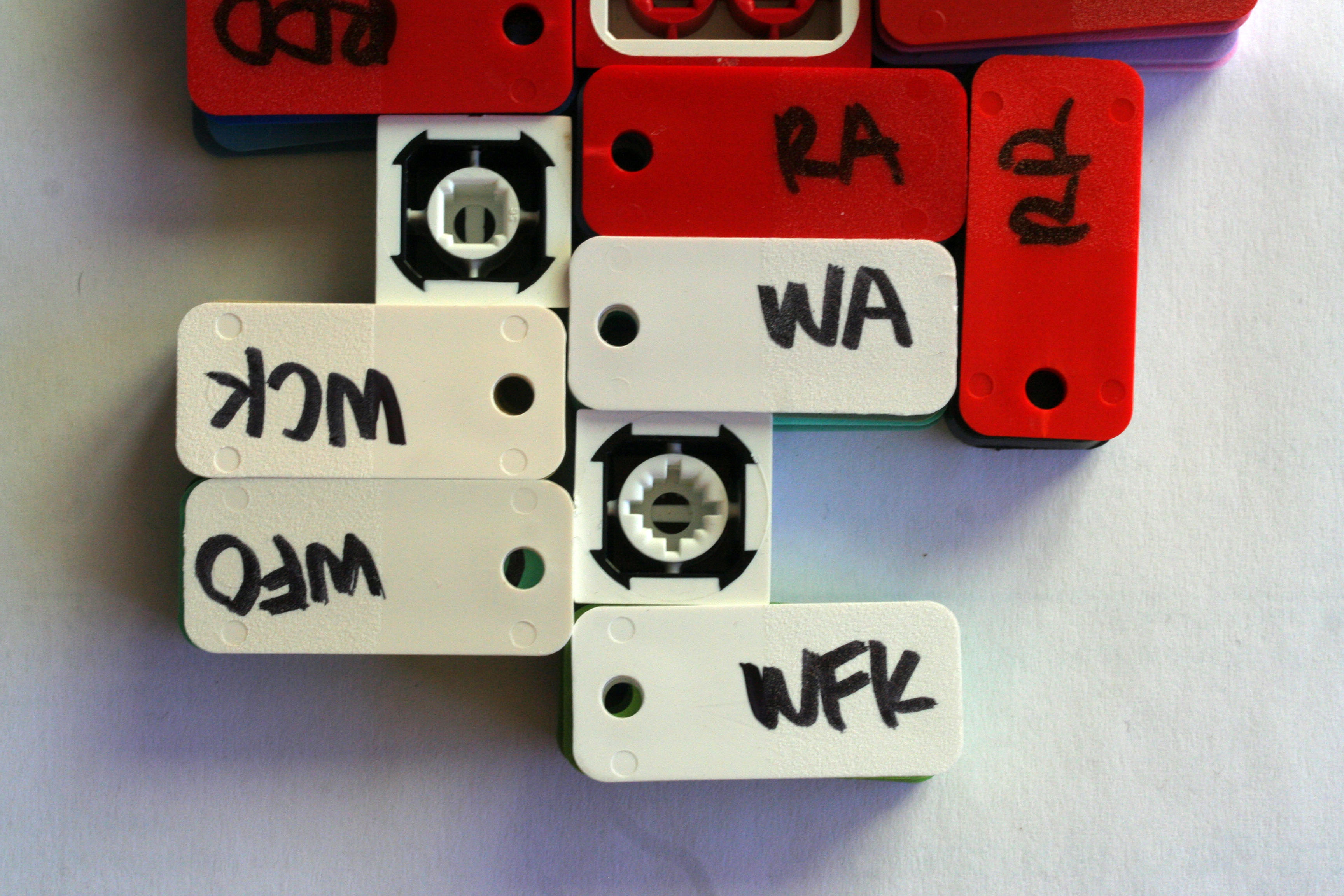

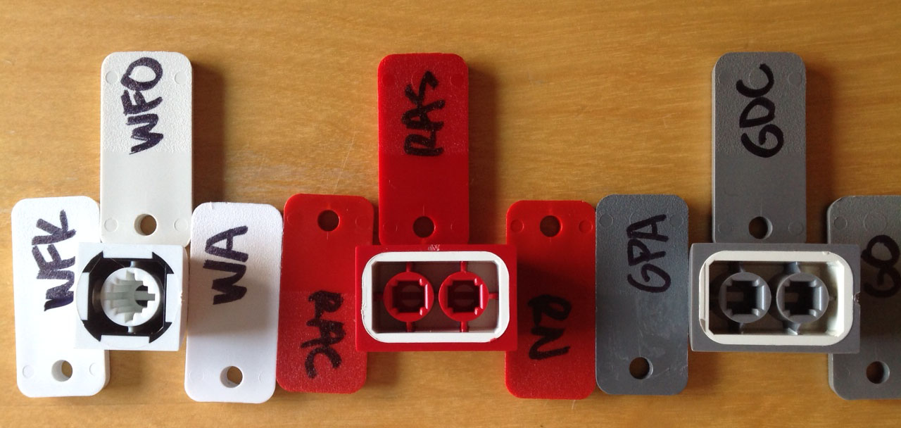

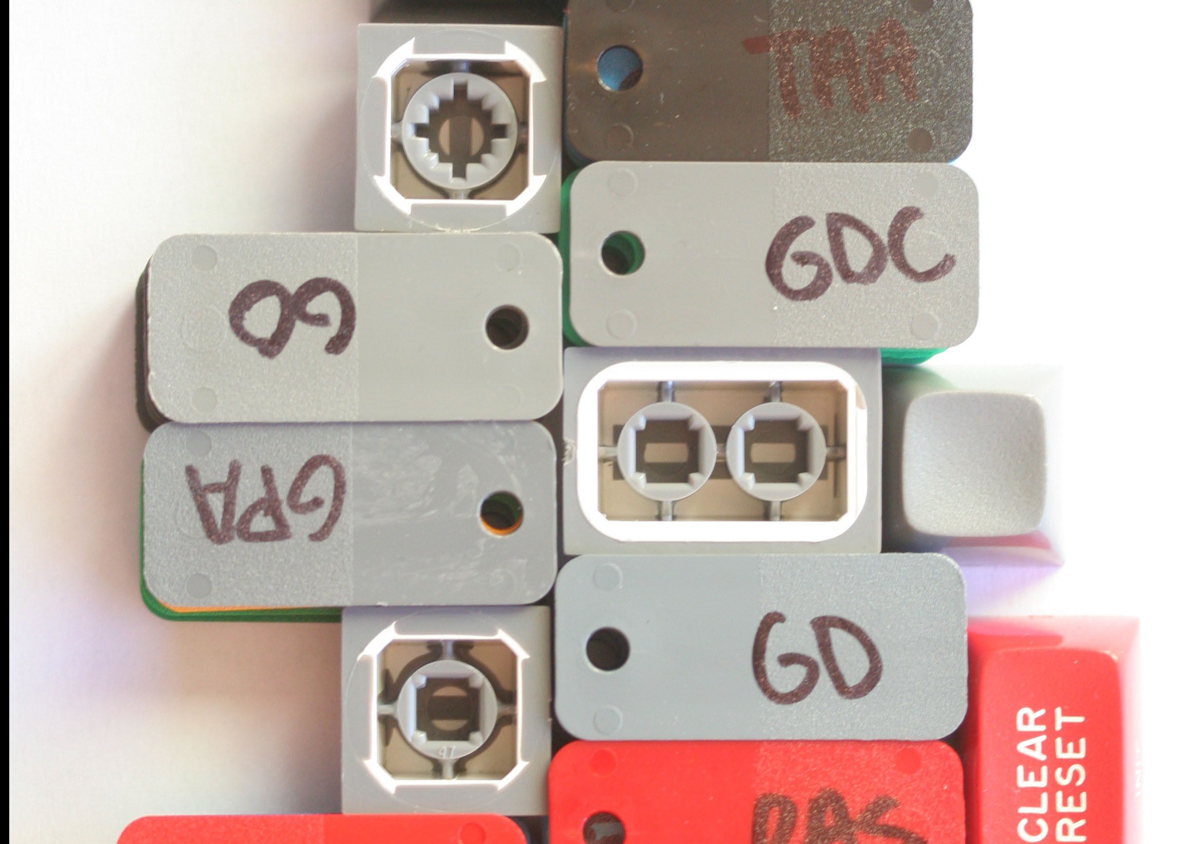

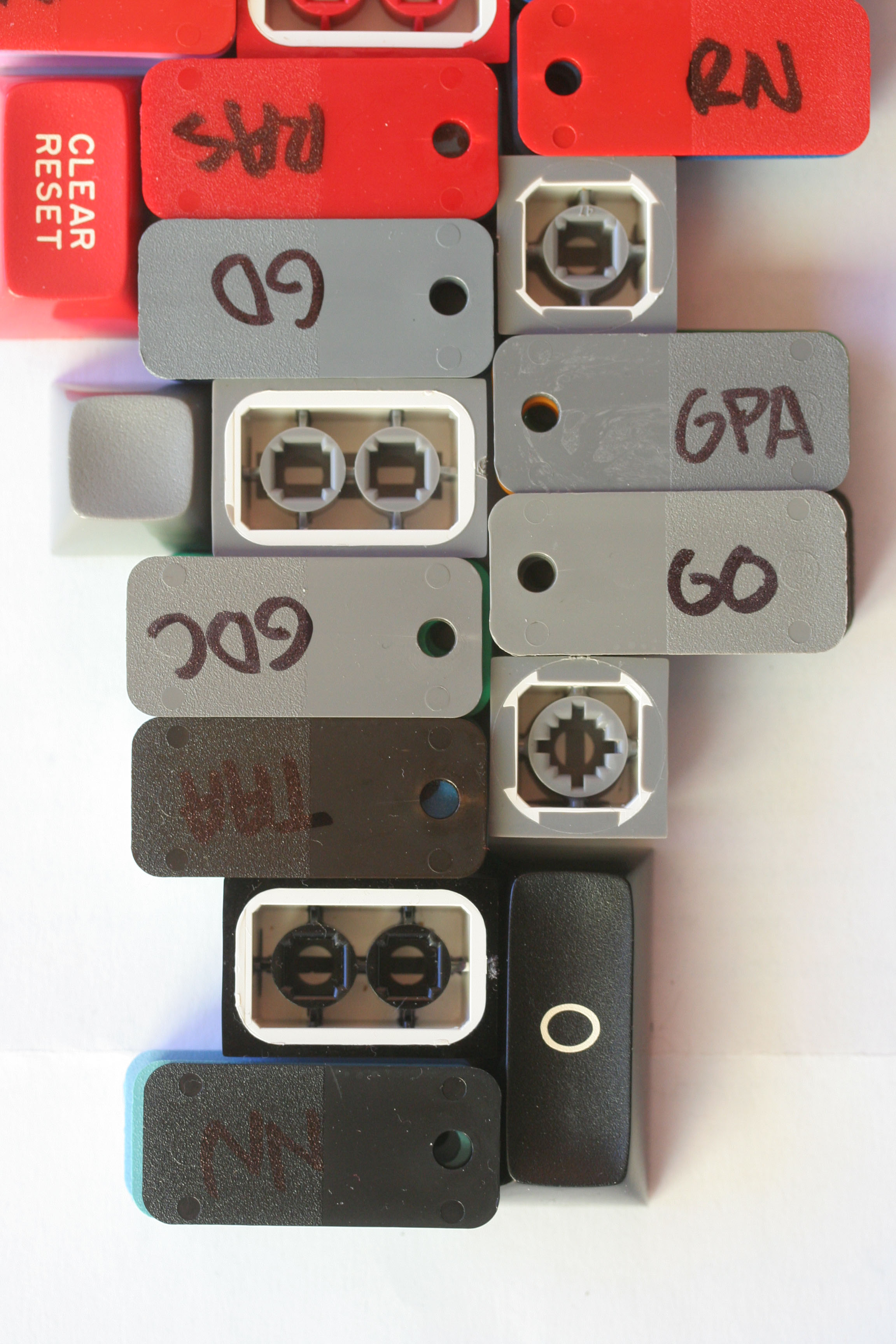

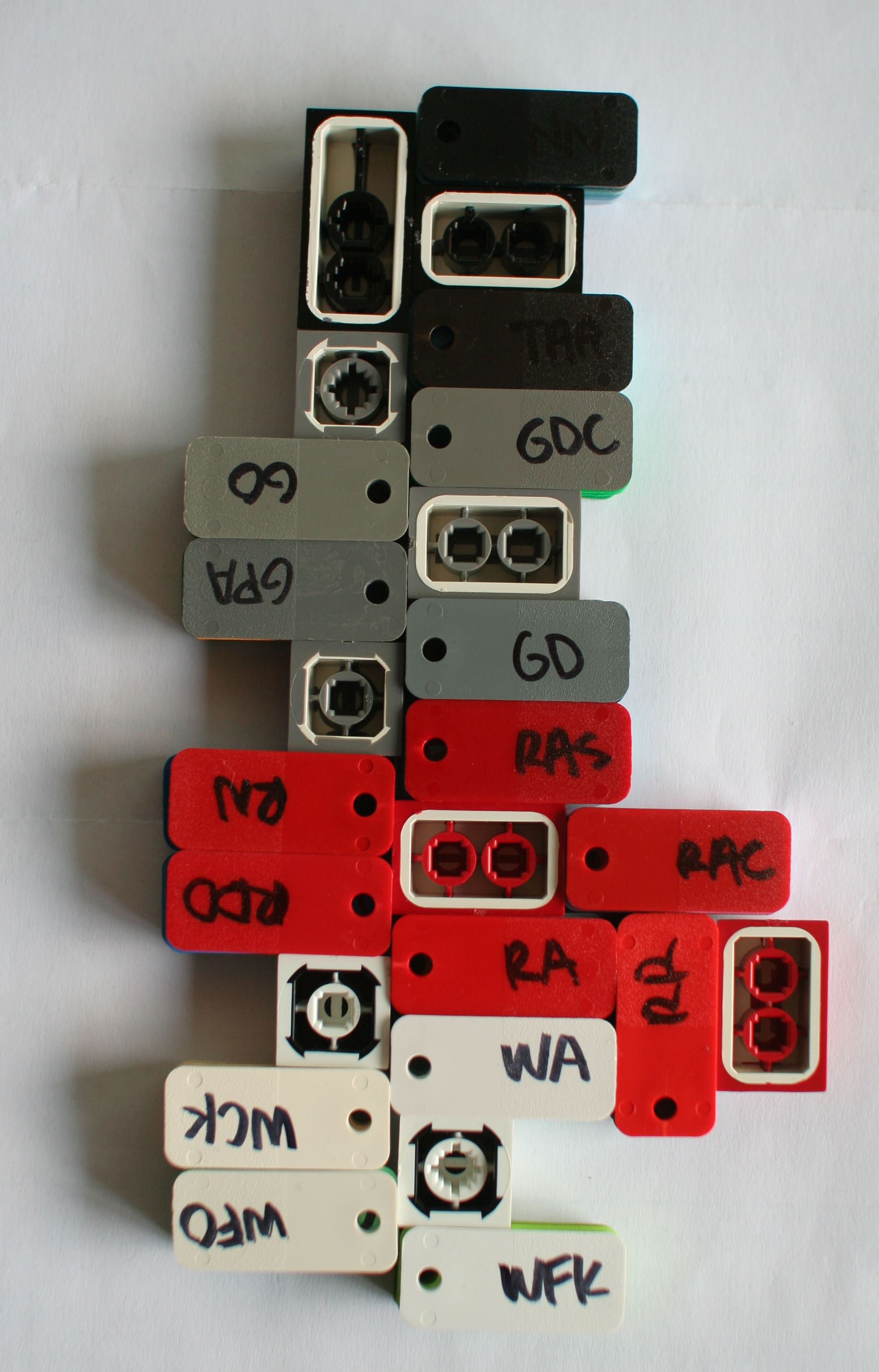

Honeywell colour matching shoot: Take Two.
Now with white balance! I calibrated my old Canon against that sheet of white paper, so the colours come through much better this time. Stacked samples, to match the caps for height as well as, hopefully, colour. All illumination is natural, indirect sunlight. I picked out several Honeywell caps of each colour. Here's the white section: My eyes still say WFK.

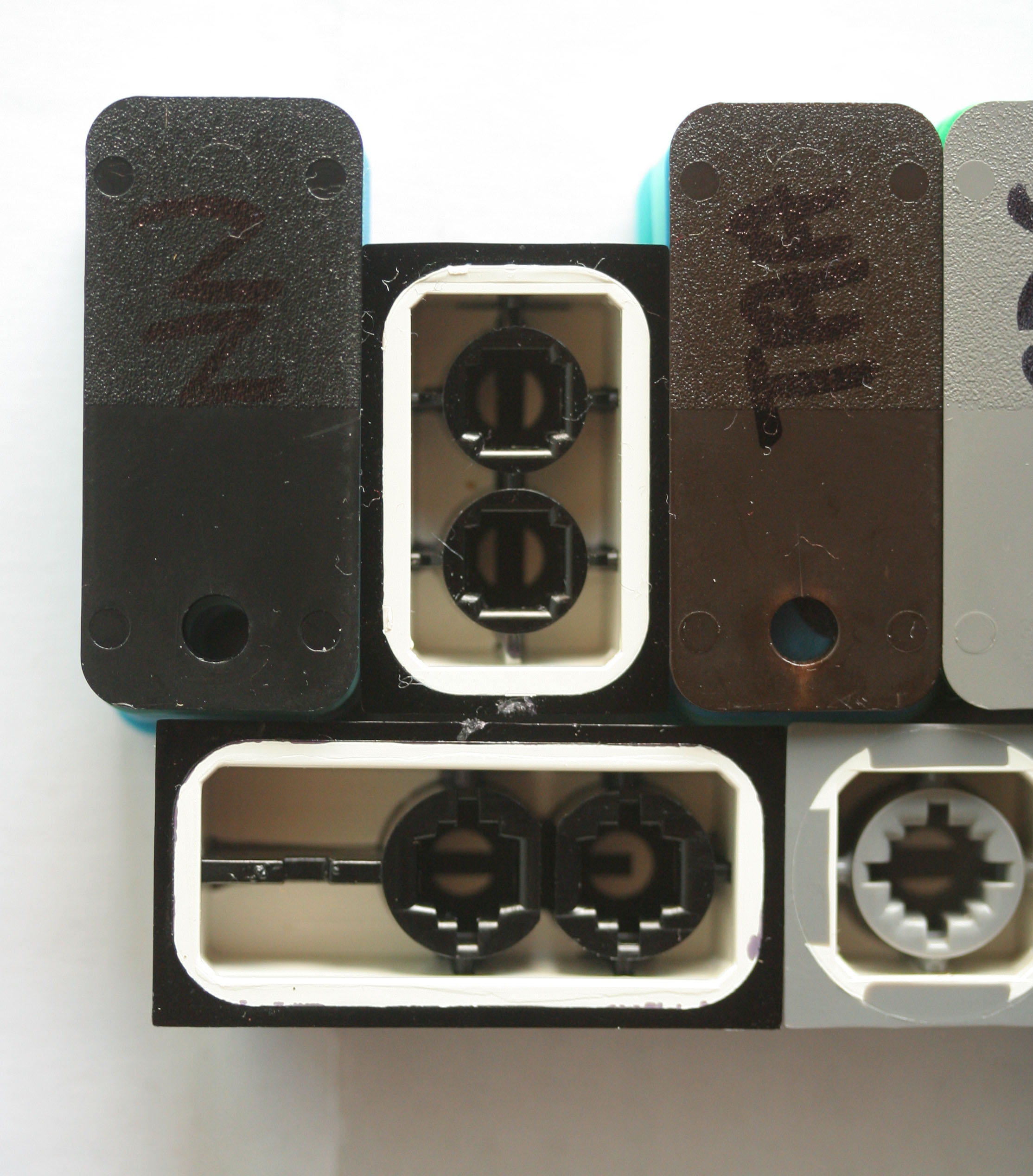

Harder to see are the blacks. So here they are overexposed on purpose: Definitely not TAR, which is a deep brown. NN is the closest black we've got. The Honeywells are impressively dark, even with lighting that should be identical.

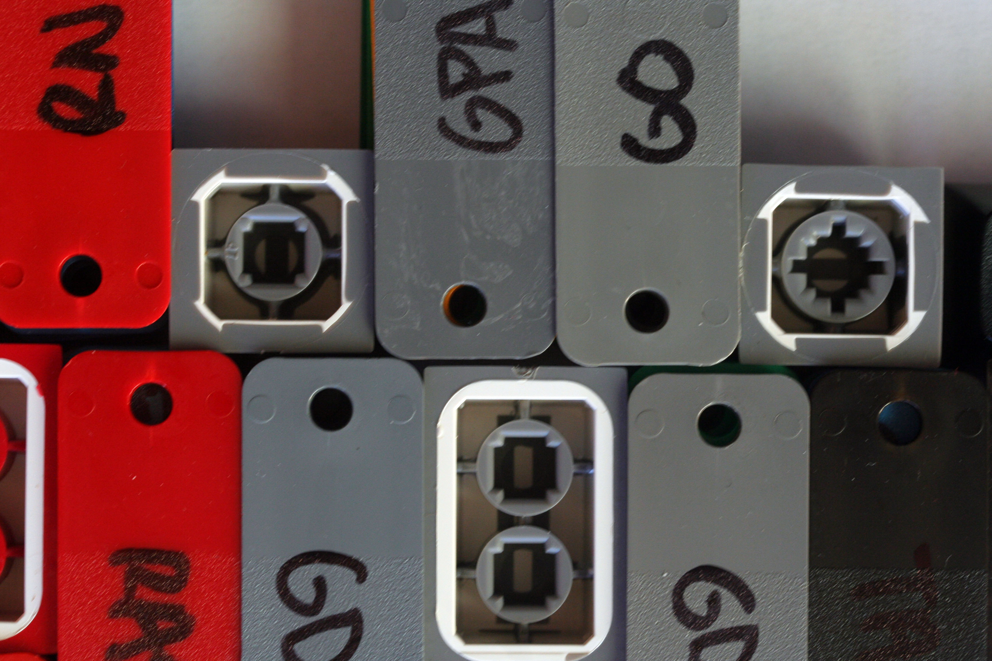

Now for the greys. The Honeywell has a lot of grey caps, so I pulled these from far ends of the keyboard. They do seem to differ a bit. The bottom one in this picture is a bit yellowed, and looks quite like GDC or even GO. A darker shot: The greys are mostly a more neutral shade, closer to GPA I think than GD. Though not so far away from Round 4's SPH alphas, really. You can see the Honeywells are paler when they're side by side, but it's not the worst: R4 SPH below a Honeywell. And what they're like above: Finally, the reds: The differences between these are quite difficult to make out, thanks to cameras using RGB. (Red is basically black as far as the green and blue channels are concerned.) Here's another version, taken with a different camera: To me, RAS still has the edge in real life. Although these shots lean towards RAC. Both are a little richer than pure RA red, a nice touch I think.

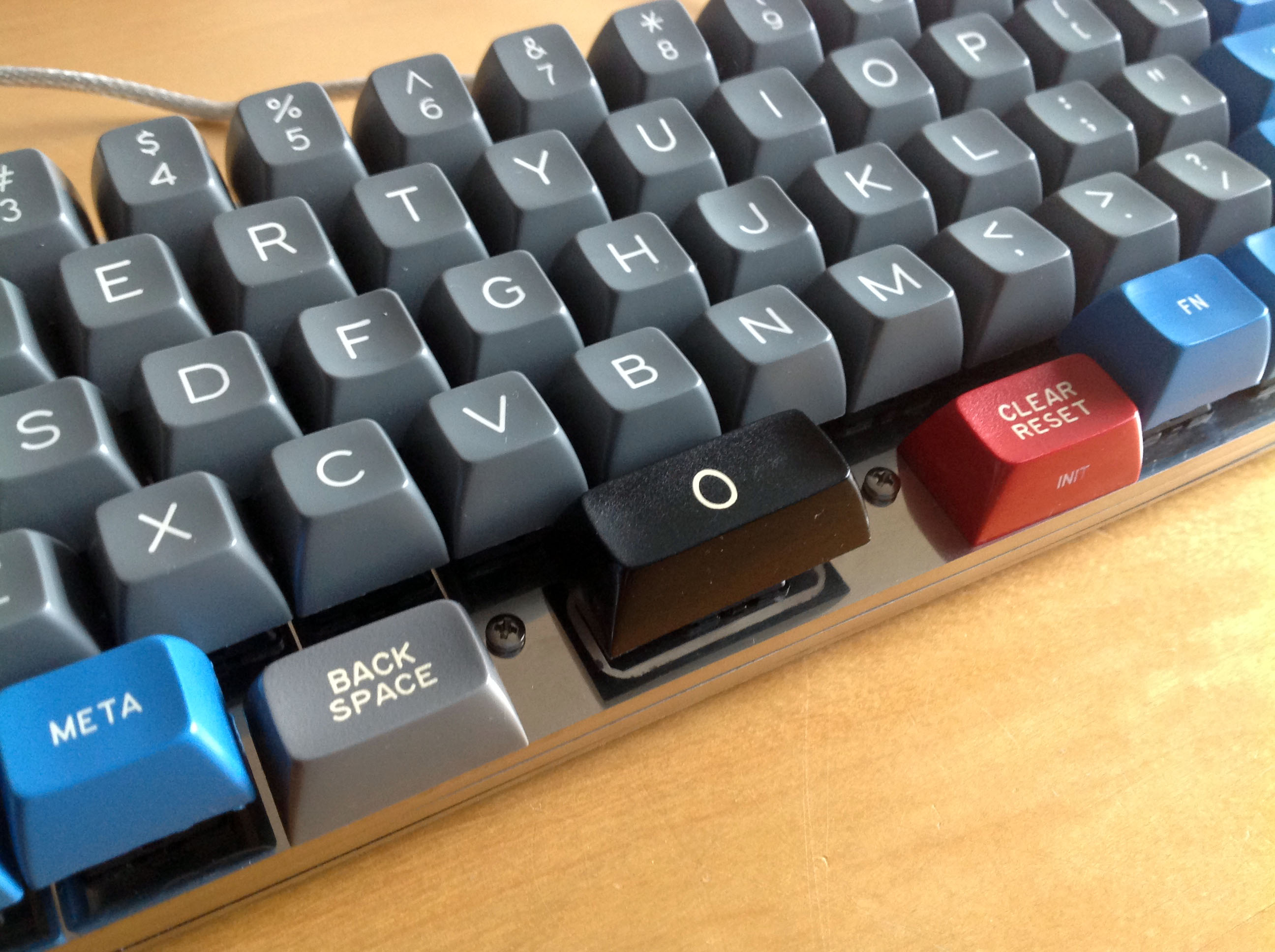

And here's a peek of the Rounds 4 and 5 combinations to come: Honeywell grey, black and red sitting on my custom 60%. No, they do not fit. But they're already not a million miles away from SA, in font as well as profile. I'm looking forward to mixing these up for real!

Great job!
Here is how I see things:
grey: GPA
white: WFK or WA
red: RAS
black: NN, though it seems to be super very dark grey instead of just black.
grey: GPA
white: WFK or WA
red: RAS

Indeed, I'm pretty sure about WFK white and NN black. GPA grey and RAS red are the hard ones, but those are my precise picks. Glad to see it's come through in the photos now, too.
As for legends: NN on the white caps, and WFK for everything else. The Honeywells did indeed start out as white legends (as seen beneath) but developed their creamy text over the last 30 years! I like them either way.

I like! A little highlight on the source of each of those samples would be nice, too. (Some of the caps vary quite a bit, the greys especially.)
WFK's still looking good, a bit closer than WA. And GPA looks a dead match. Red's tricky, though. Maybe RAC instead of RAS? (They are my #1 and #2 picks in person.) Or RN? The sample stripe seems to be a bit of a gradient on those…

Grey is especially interesting to all of us with Round 4 SPH. I'm wondering if it's worth cheating a little and going with same grey as last time for maximum mix and matching's sake. Authentic Honeywell grey is pretty close to SPH. But I do prefer the creamy 1983 originals.Halvar wrote:So looking forward now to seeing how the grey turns out.

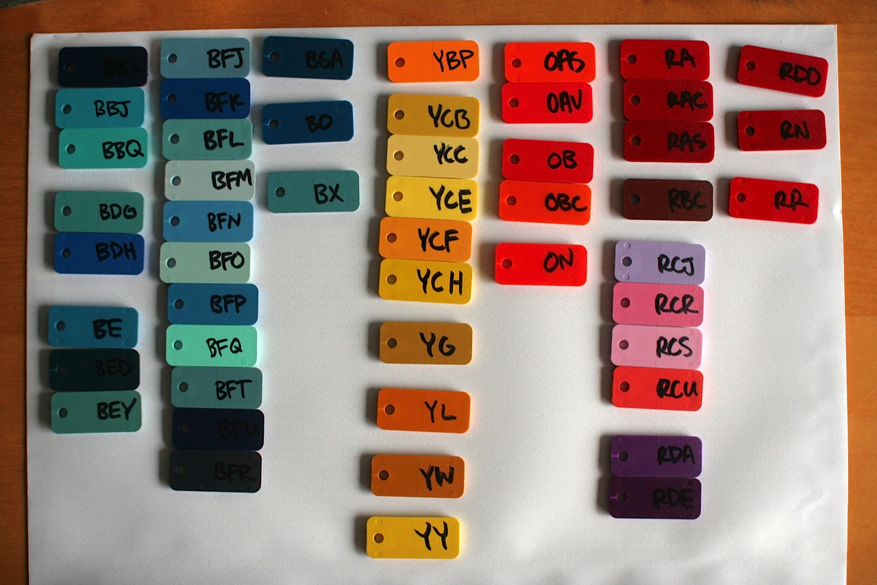

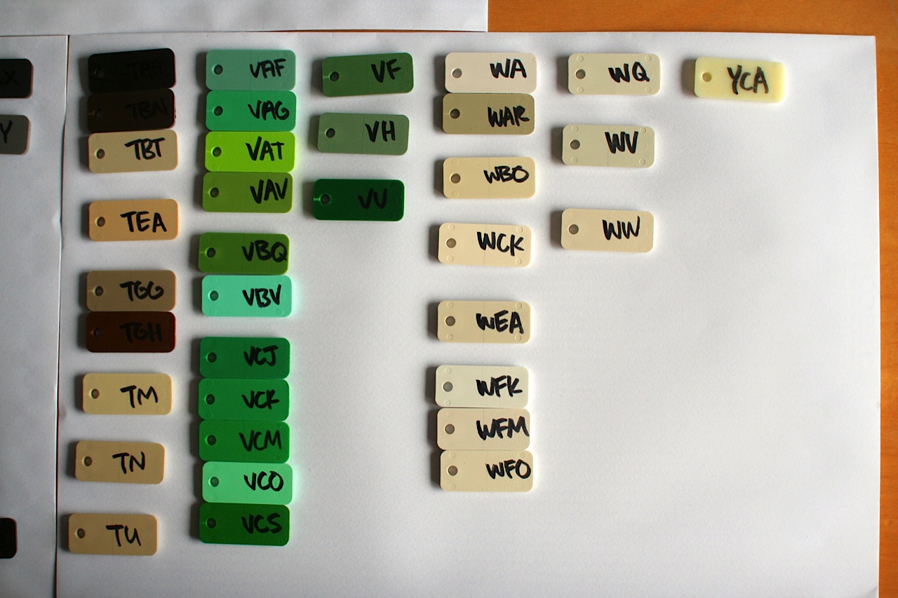

Here's the entire Signature Plastics ABS colour sample set, shot against white in neutral daylight for accuracy, in case it's useful to anyone.
The greys: The strong colours: And then grouped alphabetically by their code: (Yes, YCA should be with YCB etc. but I only spotted that mistake after the set left my hands. Incidentally, YCA is quite translucent. It does look different to every other code in the deck.)

YCA is supposed to be glow-in-the-dark, no?
This is the wiki list from ijprest's measurements: [wiki]Signature Plastics ABS colours[/wiki] which appear at first glance to look roughly the same. I knocked up a simple linear template arrangement for the colour sample pages (i.e. separates out the HTML/wiki markup from the data), but it might benefit from some sort of logical arrangement. I was only interested in getting the data filed and accessible.

Glow? Damn it, I never thought to look at them in the dark! It definitely looked distinct from all the others. Pictures don't do it justice, it had a pearly depth to it.
