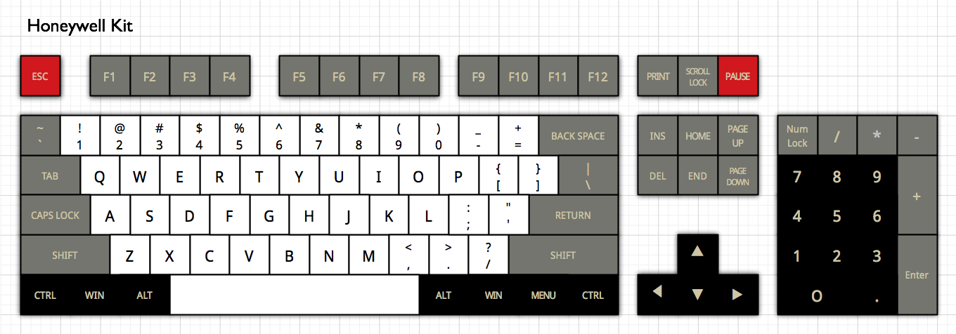

Here's a graphic I prepared earlier. TKL is exactly the same as full size, minus the number pad.

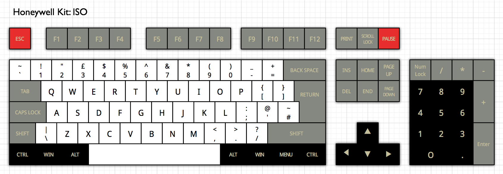

ISO UK (from memory, could be a few swapped legends somewhere)
Honeywell Kit ISO.png (141.53 KiB) Viewed 7662 times
The physical differences you care about (because blanks obviously ignore all the legends) are:
  • The Return key's shape.
  • Backslash is a normal single unit key on ISO instead of ANSI's larger size.
  • The shorter left Shift on ISO. It's 1.25 units wide instead of 2.25 on ANSI. This smaller key allows the last difference.
  • ISO has one extra alpha key.
So an ISO set would leave you without a replacement for Return, backslash and left Shift. And you'd have one spare key kicking about. Otherwise all sizes are identical. Just be sure to get 1.25 unit mods.

It seems ok then, if I buy the grey ones in ANSI for what is grey and black in your graphic, and an ISO in white for every part in white in your graphic. I just need to worry about the quality of the keycaps.
