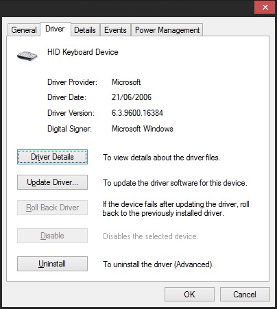

Maybe it's something to do with USB drivers or something similar, anyway here's a picture of what I re-installed.Muirium wrote:Keyboard drivers? Far as I know, any modern keyboard works entirely without custom drivers.
Edit: I formatted and reinstalled windows, the problems still persist.
- This is what I reinstalled
- Driver.jpg (49.75 KiB) Viewed 19547 times

Ya, forget about keyboard drivers. They all use default drivers, theres no need to uninstall/reinstall them.
