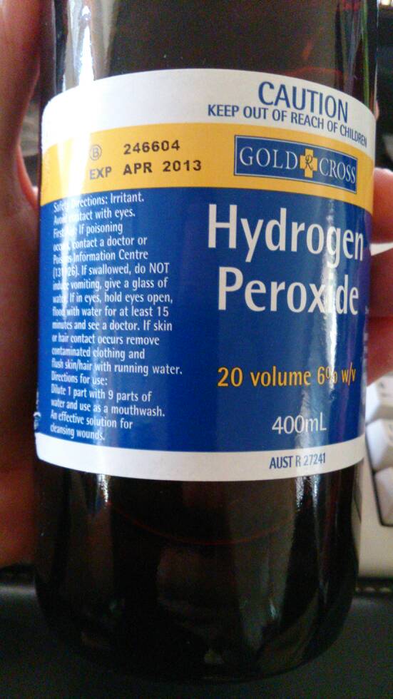

If it's just the caps, it shouldn't cost you too much.
Caps are easier because you can just soak them in the H2O2 and maybe sprinkle in some Oxi-clean if you are in a rush, no need for making the paste.
I dunno how easy it is to get H2O2 in Germany but you can get it from the Chemist here in Aus. Some people use it to make home-made toothpaste I think.

Ahhh I remembered it wrong. It's mouthwash, not toothpaste. The recipe is even on the bottle lolFindecanor wrote:Not tooth paste, but it is used for bleaching hair. I would never put some home made paste that contains H2O2 in my mouth...
