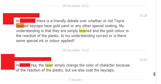

I asked a representative at Topre a while ago directly how they achieve the gold colour on their legends and was told that it's simply lasered with no infill. Besides, the legends on their lasered caps wear away so quickly that there's no way they're dye-subbed. I think there is just some wishful thinking out there that Topre would never stoop to some peasant level marking technique but, really, I don't think there's anything special about them.

Here we go:

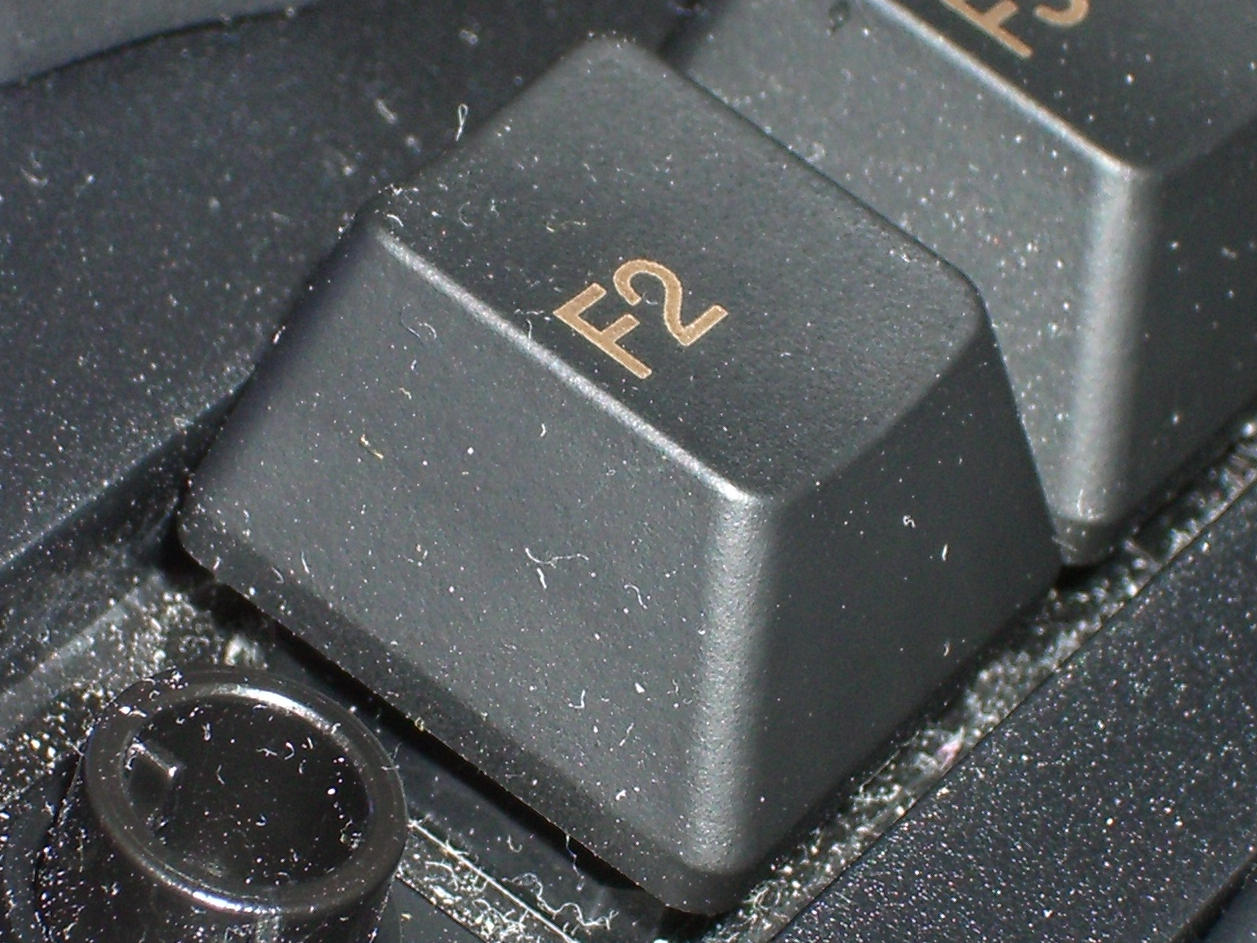

This is the closest I've got:
Topre gold legend detail.jpg (237.28 KiB) Viewed 1736 times
Not sure why the lettering has that white outline. I don't have the keyboard to hand.

Hmm... I'm no laser technician but could the outline simply be a temperature variance (cooler) at the edges?

Oo now that's nice. I should hassle Topre for one of those nice black labels and relabel mine. Never did like the silver label. (I removed it, but after realising that there are simply gaping holes above the LEDs, I put the now scratched label back on.)
The thin white margins around the lettering is not a trick of the camera, although it's only barely visible to the naked eye.
