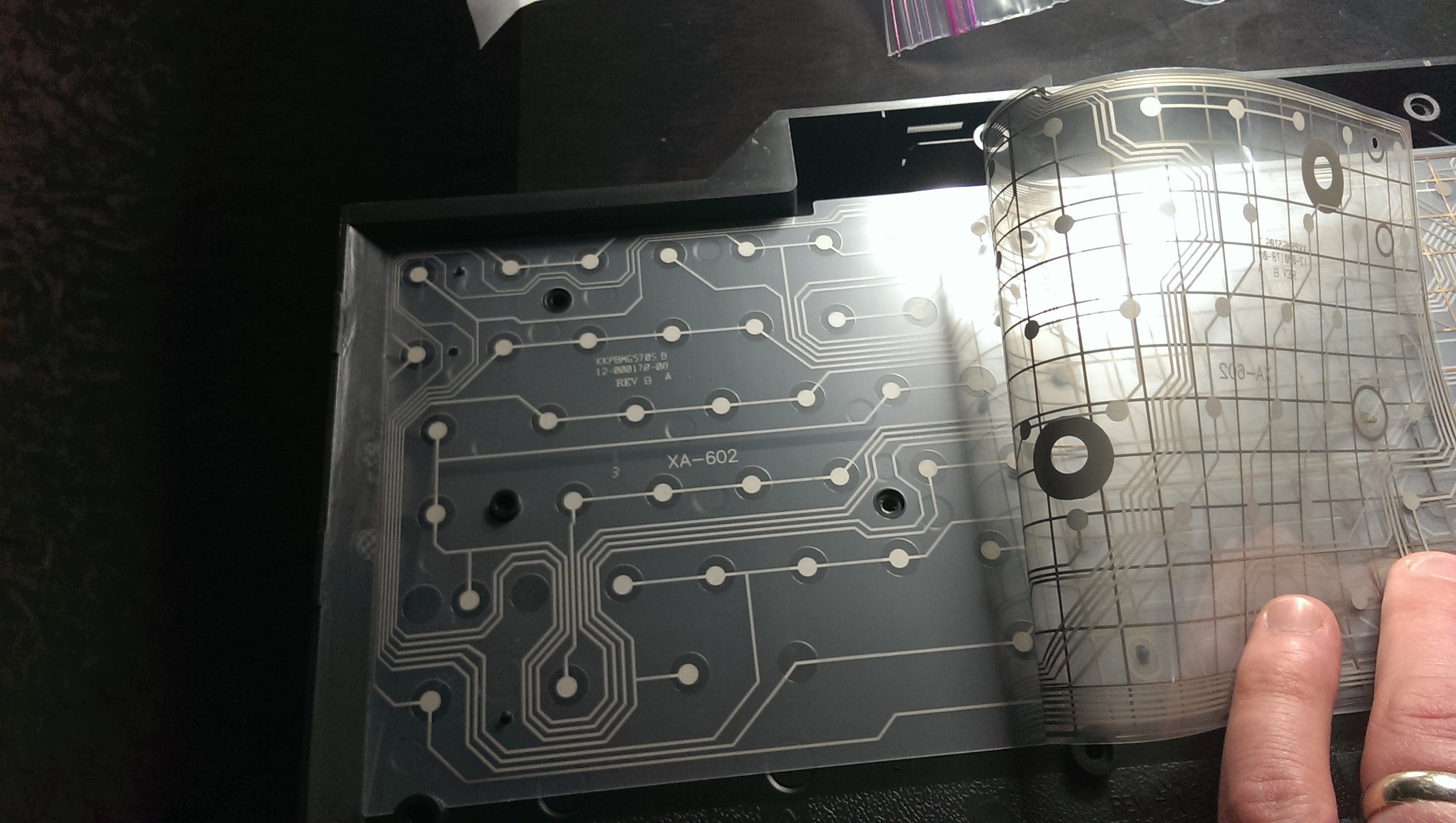

So I managed to get hold of some used keyboards including two keyboards removed from thinkpads. Four for ten dollars wasnt bad.
Got a good idea how the matrix is set up. I think I will need a thinkpad usb keyboard to act as a donor, just so that I can get full compatibility.

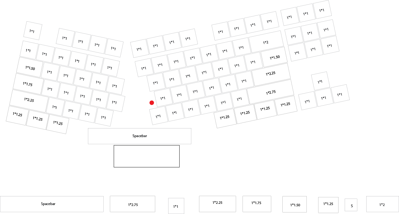

Here is the layout I will go with.
The other thing I noticed pulling apart another keyboard was that it had two different membrane layers. The closest I can figure out is that pushing the button connects the circuit by bringing the dots on each of the layers together. Can anyone else confirm this for me.

Interesting project. Are you trying to reuse the donor's controller by substituting MX switches into the matrix? If so, are you using the membrane in some way or are you wiring your own identical matrix into the controller?
It's quite a conversion!

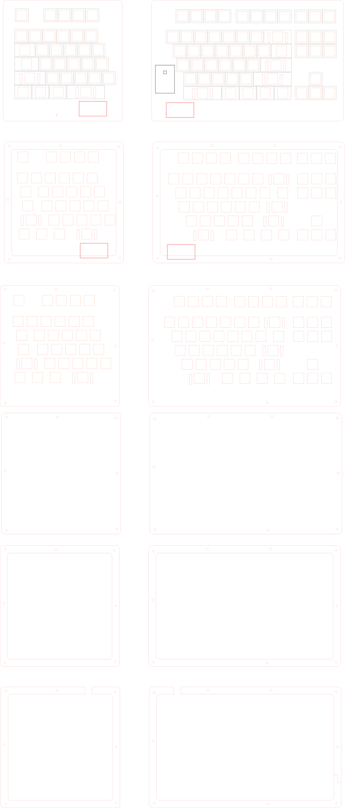

Well got the quote back from a local company based on the design.
The stainless steel portion came in at $170 and the acrylic came in at $140.
I have a few old PS2 keyboards lying around, so I will take a dremmel to one tonight and cut it in half to see how typing on it is at that angle.

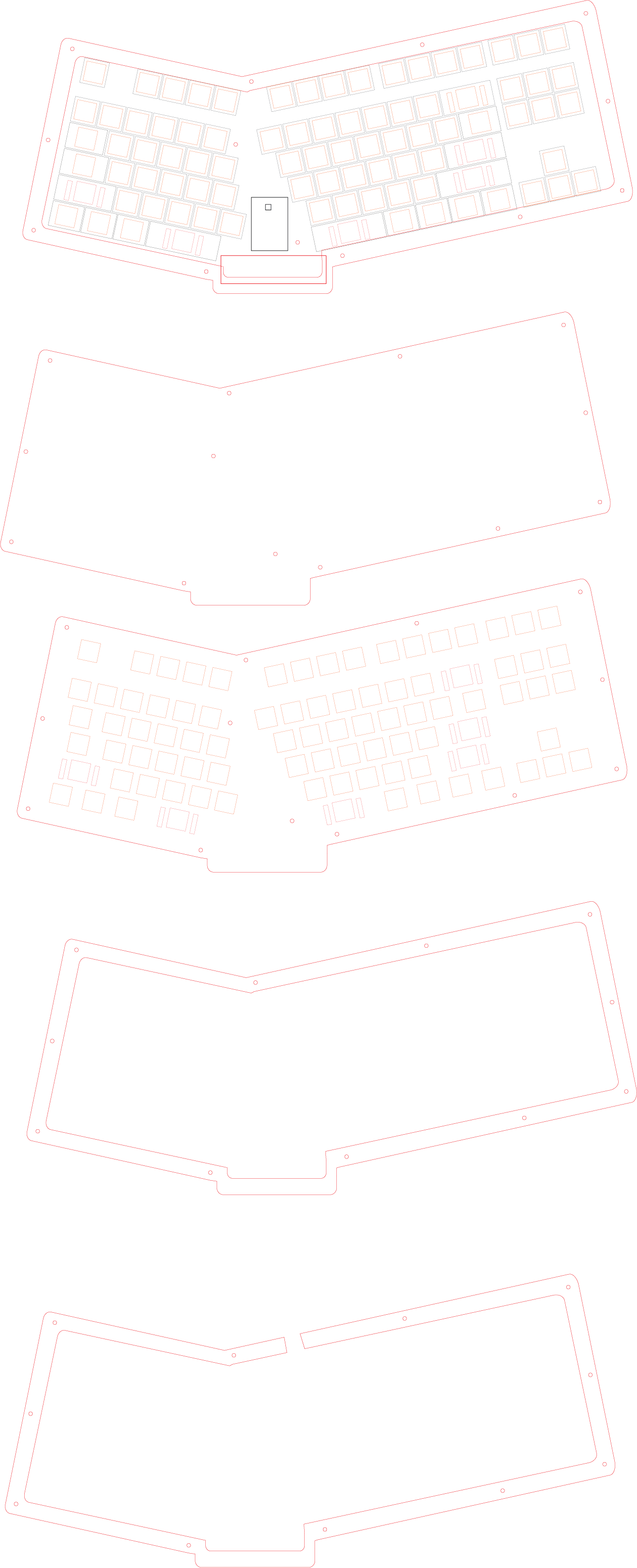

Ok, thank you very much for the suggestions, they were very useful.

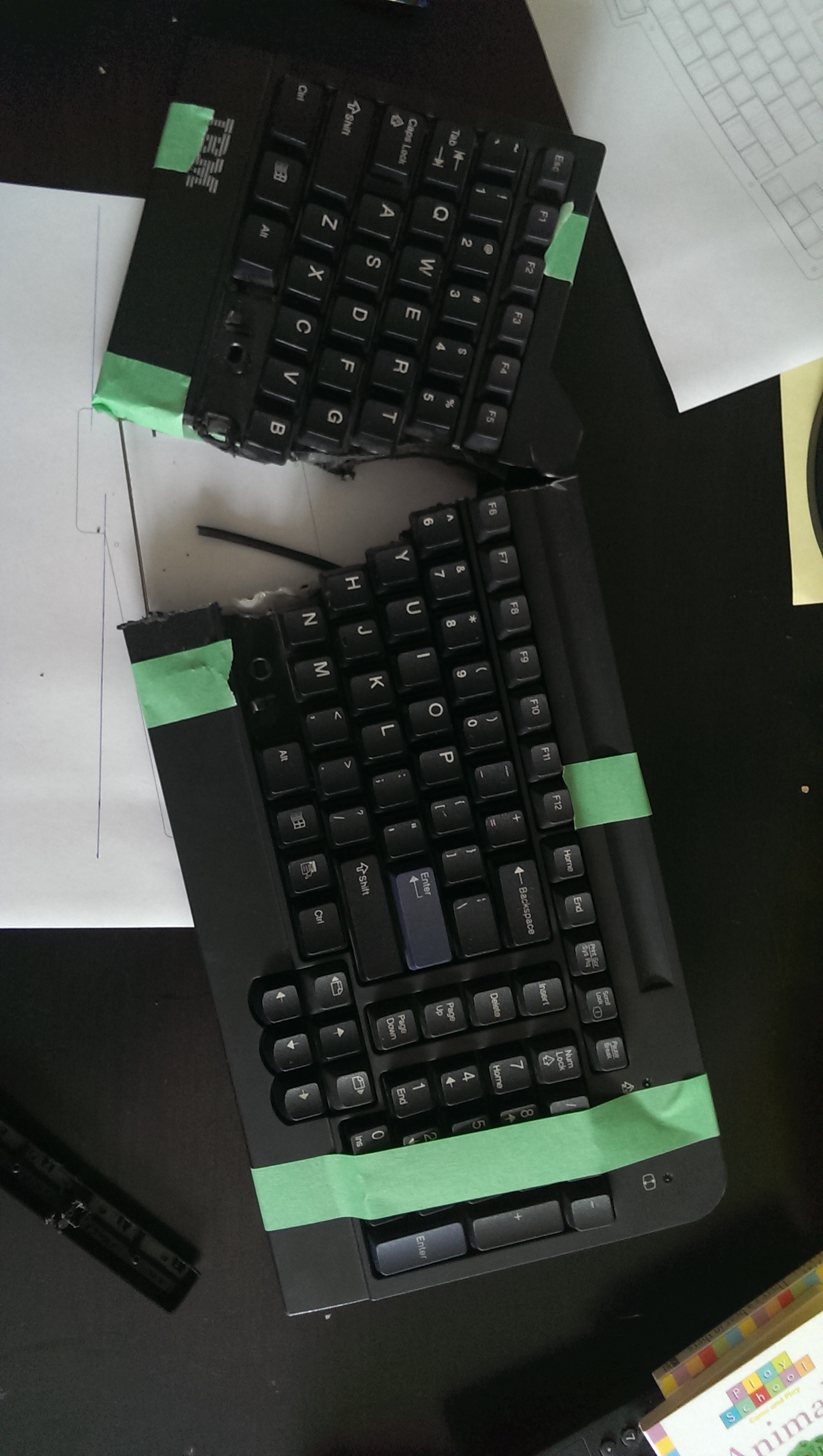

I decided to opt for a split layout as suggested. I am going for a kinesis freestyle type look but with a trackpoint. I intend to keep the staggered key layout. To confirm this, I took one of my old usb keyboards (I have stacks of them) and took a dremel to it and split it exactly the same way that I am looking to.
The change also decreases the amount of stainless and acrylic that I use which will help keep the cost in line.
I also plan to use the teensy as this layout really necessitates the use of a simple keyboard matrix .
Let me know what you think.
My future plan is to use CAD and create something very creative like some of the members here. First my goal is to make something that I can feasibly make.

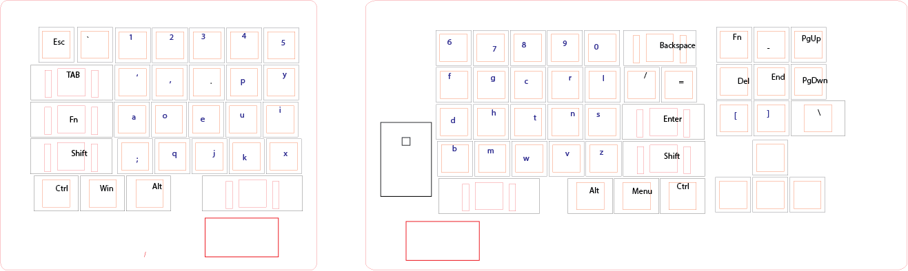

Ok so I had a crack at doing a linear layout. By symmetrical I assume you mean linear layout.
Definitely not perfect, need to adjust the positioning a bit.
I tried to use existing keycaps where ever possible, as it will minimize the number of blanks I need to buy.
Suka: I tend not to mess around when I get into something, I am hoping to have something sent off for laser cutting within the next week. I have some super crazy ideas along the lines of some of your projects but want a good grounding beforehand.

Symmetric stagger:
Webwit's μTRON. Standard staggering on the right, but the mirror image on the left.
And on Jesse's custom.
I like the look of this one especially!
What you're doing is a matrix layout. Like this:
I have that very keyboard on my desk. It takes a little getting used to, let me tell you! I find the P key a real stretch, because it's further out to the right than on standard stagger. Pure matrix keyboards make sense for point of sale and other specialised purposes (they often have relegendable keys and are always programmable) but they are not exactly ergonomic.
Jesse's post also has another model with good ideas:
Note the keys being moved to match the hands, rather than the ruler. That's more like it!
For more on staggering, there's the wiki.
