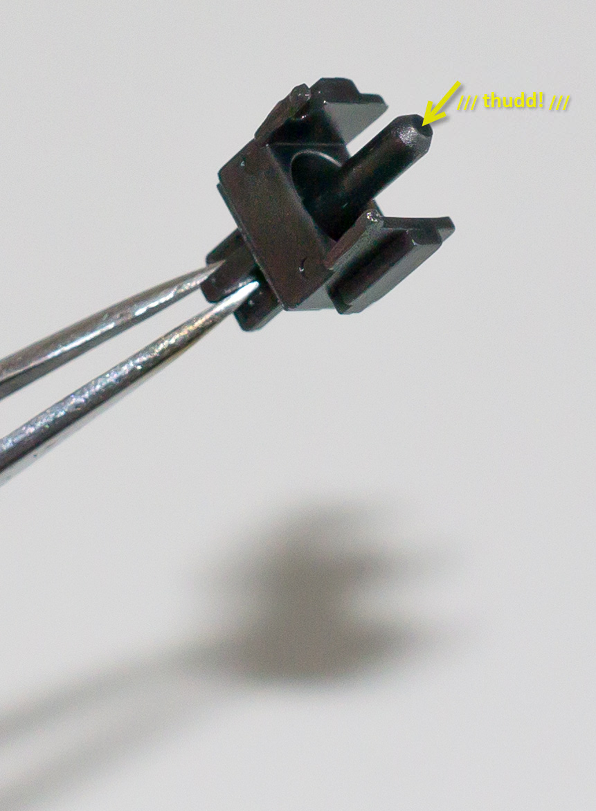

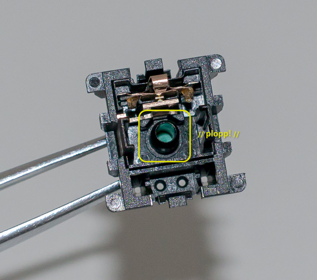

hargon wrote:Interesing, is it as effective as an O-Ring?
It does absorb very well, i'm lacking any o-rings to directly compare though.
I think it's going to feel a bit different since with o-rings you bottom out on top of the switch casing.
Once i got the pcb from ting i will do a full mod for testing. Also i need to source some proper rubber, those common rubberbands are notorious for aging rapidly.
Another advantage is that you don't mess with cap seating and clearance, so you can use cherry profile with this. Should you decide to shorten the plunger to compensate for the reduced tube depth you could even manage to not lose any key travel at all.

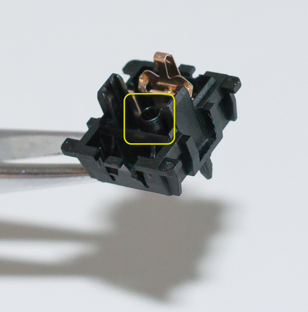

For removing i managed to get the upper one out easily by skewering it with a needle, the 2nd one was not so easy.. that's why i'll try to find thicker rubber so i need only one - that should be easier to pick up then.

I don't see a chance to dampen the upstroke.. i've stared intently for long hours at the switches.. nothing.
One possible spot to add more rubber would be between switch bottom and pcb (just like a rubberdome sheet) this could help with sound travel through the "structure" thus also dampening the upstroke.
(i'll try that sometime).

I was convinced the tube bottom would be the regular contact point.. looks like it's actually the "rails".
Still this works with minimal travel loss given the right rubber thickness.. i'm not gonna chop off the stems.

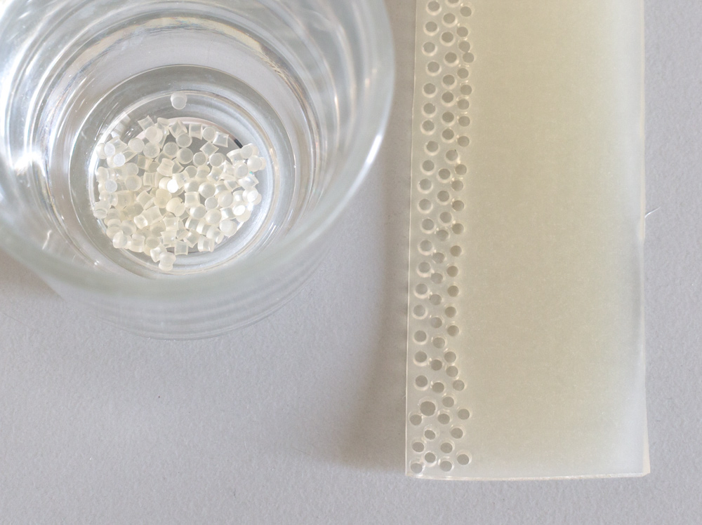

Found some silicone sheet the other day; now only waiting on customs to release my purchase so i can put it to the test.

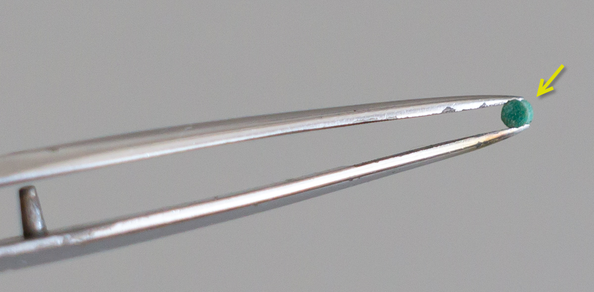

I will not be distracted by some crazy dentists:
2.0mm dia, 1.5mm thick, hard
i settled on 2.0mm diameter, 1.5mm thick, hard silicone;
2.5mm diameter / 1mm thick pads will fit tightly and not be removable; they also will compress little so a 1mm thickness is enough (else you lose too much travel) - this option feels more "professional" though;
Update: 1.5mm thickness is probably slightly too much: now on an assembled keyboard when normally typing i'm squeezing the pad only minimally (when bottoming out), thus not really 'reclaiming' any of the lost travel.
I'll try 2.0mm dia & 1.0mm thickness next. Probably something uneven like 1.2 would be perfect.

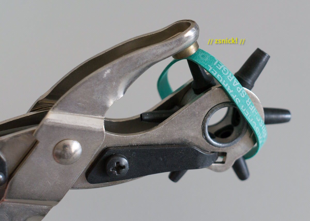

what is the tool used to make the little dampeners? this could be a silencing solution for SA caps!

tricheboars wrote:what is the tool used to make the little dampeners? this could be a silencing solution for SA caps!
It looks like a leather hole punch normally used to punch holes in belts.

Umm i can give some more in-depth answers later when i have more time. As a quick overview i can say: i love it, the silencing totally works - any switch i open up gets the little silicone pellet treatment. I finally got my hands on 1mm (exactly) silicone which is juuust barely thicker than the gap below the stem-'stick' thus just dampening while reducing travel not at all:
http://www.ebay.de/itm/221351433388
(thanks to the guy who used the thin sheet for topre)
The tool is indeed a belt hole tool - luckily the smallest of the wheel was just right (i sharpened it a little).

Jmneuv was kind enough to send me some of these 1 mm thick tiny silicone discs so I can try them myself. They are indeed pretty neat. I lined up some MX blacks in a spare plate, and tried direct comparisons between this damping method and o-rings on various caps.
O-rings lose a noticeable bit of key travel, of course. These internal dampers (I-rings?) are a notable improvement in that regard. And the damping itself is very similar. I recommend anyone interested in o-rings gives these guys a shot.
The downside is installation, of course, You have to open up your switches, and it's a tiny plug you've got to slide down a tight hole. I lucked out by finding a good sharp pin, however, and I just stab them in the middle when they're lying on my desk, and insert with that.
Typically, I'm not a switch modder. These MX blacks are sacrificial for keyboard science (they all lost a leg in The Battle of Tipro that I fought against a Slovenian army of veteran solders) so I'll try some lube while I'm at it. A bit of practice and I might even be up to the task of damping my greens.
