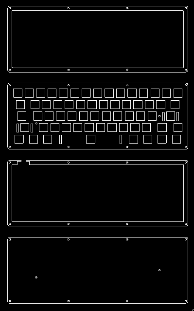

Following my step by step guides I'm here to offer you the chance to laser cut your plate or complete case in Aluminum and/or Stainless Steel.

Designing a new plate/case is no easy task. Each design would need to be tested and prototyped. Making few small mistakes is very easy and you might end up with an expensive piece of useless metal. You are responsible for your own design. I take no responsibility on your design even if I help you with the CAD file.
How to place an order
The Brownfox is a keyboard that I already prototyped and it turned out pretty well. So small changes to that layout should put you in a safe spot. Here enclosed you'll find the DWG for that keyboard. You can use it as a starting point.
Note that the keyboard has 6u spacebar with not standard mounting points and distance between keys is 19mm (instead of the suggested 19.05mm because in my experience it doesn't make any difference).
I'm also going to post the layout for an ALPS based plate.
Post your ideas/requests or a mock up of the keyboard you want in this thread and I'll try to help you out refining your design. I also hope that other keyboard gurus might chime in and help me with tutoring. Once your design is finalized it will be made public and others may use it.
All DWG must be in MM, I don't want to see nonsensical inches :P

My layout is all done. You even laid out my plate for me already:
I'd like an aluminium plate, as I trust your advice on its superior feel to steel. But the rest of the body is a different story.

Hi Matt3o. I'd like to get this plate cut from 1.5mm aluminium.
It's just a regular phantom plate with 1.5x mods and 7x spacebar, except it's designed for my TEK-80.
If you could get me a quote that would be great. The timing of this was perfect. I was just about to look for people who could laser cut this plate.
DXF can be found here : https://www.dropbox.com/s/hsqjp4pmiqrvv ... 150.SLDPRT

photekq wrote: Thank you very much and let me know if you see any problems :)
there shouldn't be any problem with your design. tomorrow I'll have a look at the DWG.

by matt3o
These are the layers needed by Muirium's board.
And this is the DWG.
muirium.dwg.zip
(14.41 KiB) Downloaded 388 times
Of course you need 2x the top layer and 2x the third layer.
Please triple check it. Print it 1:1 and verify that everything's fine.
Especially the top frame is extremely fit, you need to check if the perimeter keys can actually be pressed. Maybe I should add at least 0.5mm clearance. Also check if the screw heads have enough room in the top frame.
If you need it I should be able to export a PDF.
Posted: 08 Jul 2013, 15:26
by Muirium
Thanks Matt! Yes, a .pdf would be pretty useful.
As I understand it:
  • 1x mirror steel trim layer of 1.5 mm
  • 1x aluminium plate layer of 1.5 mm*
  • 3x aluminium case layers of 3mm
  • 1x mirror steel base layer of 1.5mm
Corrections welcome!
*You said this about 1.5 mm aluminium in your Brownfox build thread:
matt3o wrote:The aluminum plate is 1.5mm thick, but I have the feeling that I could have done it 2mm for better stability. Next time I might try that. I had a similar keyboard done in steel and keys stick better on 1.5mm steel than they do on 1.5mm alu. Steel is too stiff though and typing is a bit tiring.
Have you changed your mind about 1.5 mm aluminium's feel?
