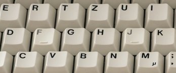

I bought an old cherry g81 with lasered keycaps just because of the spacebar, alt, ctrl and window key.
I already have a full set of Doubleshots, salvaged from an old g81 winkeyless and I need those keys to get rid of the stock black caps on my Quickfire...
And now this: Image
What... how... why?

Yep. The Cherry G81 keyboards with 1.25 Windows keys are like that. G80 keyboards are not.
One thing that you should also know is that no G81 or G80 Space Bar will fit the Quickfire. When the windows keys were added to the G80/G81 line, the location of the space bar switch stayed the same even though it was one unit shorter on the right side. The Quickfire has the switch in the centre of the space bar.
If you are lucky, maybe someone has a Moogle kit to sell.

I already knew the issue with the spacebar but the alt, ctrl and win key shoked me :/
Man this sucks :(
I am thinkin gabout to mod the keys, I have the keys from the numlock wich are left over...
I have no idea why they did this... This makes no sense to me at all :(

You can mod them to fit. Try the search here and on GH. There should be some threads about it.
Posted: 20 Apr 2013, 18:42
by cookie
I already know those threads but I really wanted to avoid modding them... the good news is, it seems they are thick PBT so thats at least something ;)

Yeah, that is unusual. I have two sets of G81 keys that are all thin PBT...
