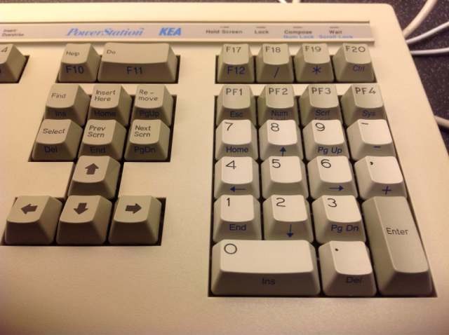

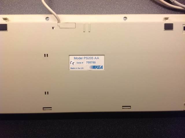

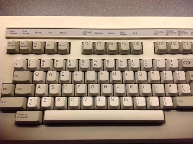

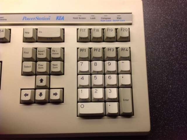

Picked this up a few years ago new in box. Designed for use with KEA terminal software for Windows.
Would be interested to know more about the sliders.

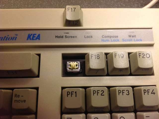

Mitsumi mechanical switches
Typically they took Mitsumi mount keycaps (square peg, as above), but those are the Cherry MX variant. The switches are reported to be fragile, which figures as they're really quite tiny.

lemon flavored cherry mitsumi switches. I had identical ones on a quantel video editing keypad. My board is with Haata, he has more info.

[wiki]Mitsumi mechanical switch[/wiki] — I've merged in my MX-mount page, as I had created a new page without realising that one already existed for the same switch.
"Mitsumi mechanical switch" is a terrible name, because they made several mechanical switches. Maybe "Mitsumi compact mechanical", not sure, as there's a larger version of the switch that uses the same lateral spring mechanism (which is not used in MouseFan's, which I guess is the linear version?) and I don't know quite how they should be classified.

Or you know... It's just another DEC LK201 clone, this one (opposed to most others) even copied all the spacings pretty much exactly.7bit wrote:Lowerring non-retard level to minimum:
The keyboard in the pictures comes with Mitsumi switches.
The keyboard in the wiki (G80-1306) comes with good old Cherry blacks.
Key caps on both are labelled the same way (more or less)
Layout is the same.
=> $THIS is the Mitsumi variant of $OTHER.

- Location: USA
- Main keyboard: KEA POWERSTATION PS205
- Main mouse: Looking for one
- Favorite switch: Cherry Blues
Trying to figure out dip switch settings, any chance you have the manual for the keyboard?
