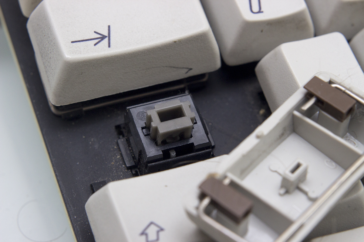

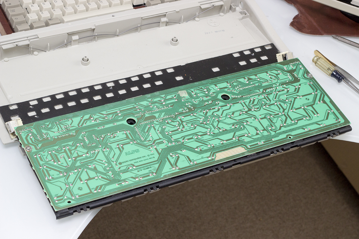

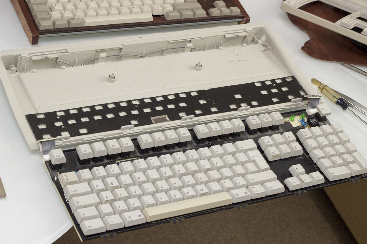

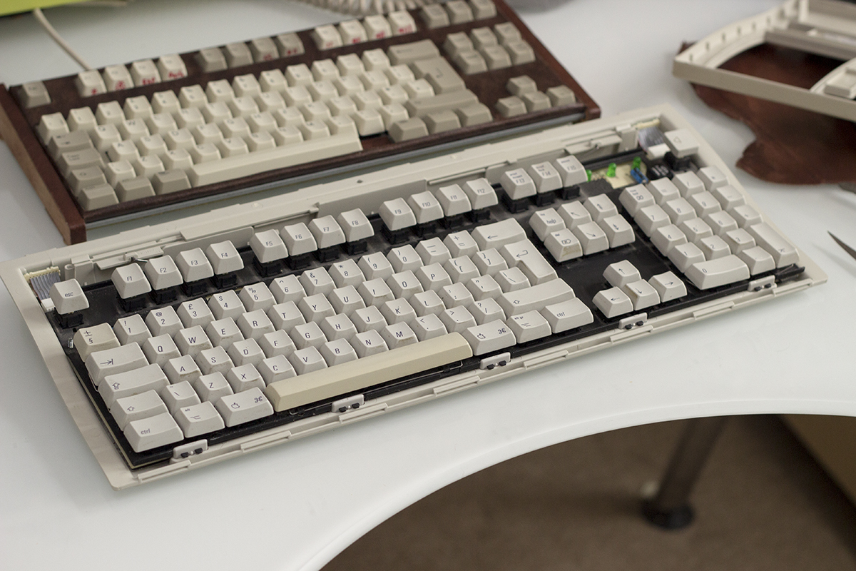

Recently bought one of these, along with a Griffin iMate ADB to USB adapter.
(http://deskthority.net/photos-videos-f8 ... t5300.html)
Someone recently took some nice external pictures that are on the wiki, so these are to compliment those.
The AEKII also has this nice Locking Alps switch for the Caps lock, here is both a picture and a little Gif showing off the mechanism too.

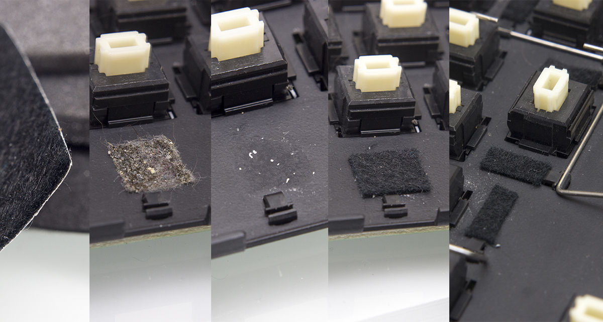

I also replaced the dampening pads on the space bar while I had all the keys off cleaning, I used this thin fibre like wool padding that I use to prevent light leaks on film cameras. It works great to dampen all the keys with stabilisers, though I took them out from under the Caps Lock as it wouldn't always disengage easily.
I am happy to license all of these photos for use on the Wiki.
Posted: 05 Mar 2013, 23:13
by Charlie_Brown_MX
Great photos. Personally, the first thing I took out was the grey locking switch, though; I remap Caps Lock to Control, so having it as a locking switch isn’t ideal.
What did you replace the dampening pads with? Mine could probably do with being replaced.
