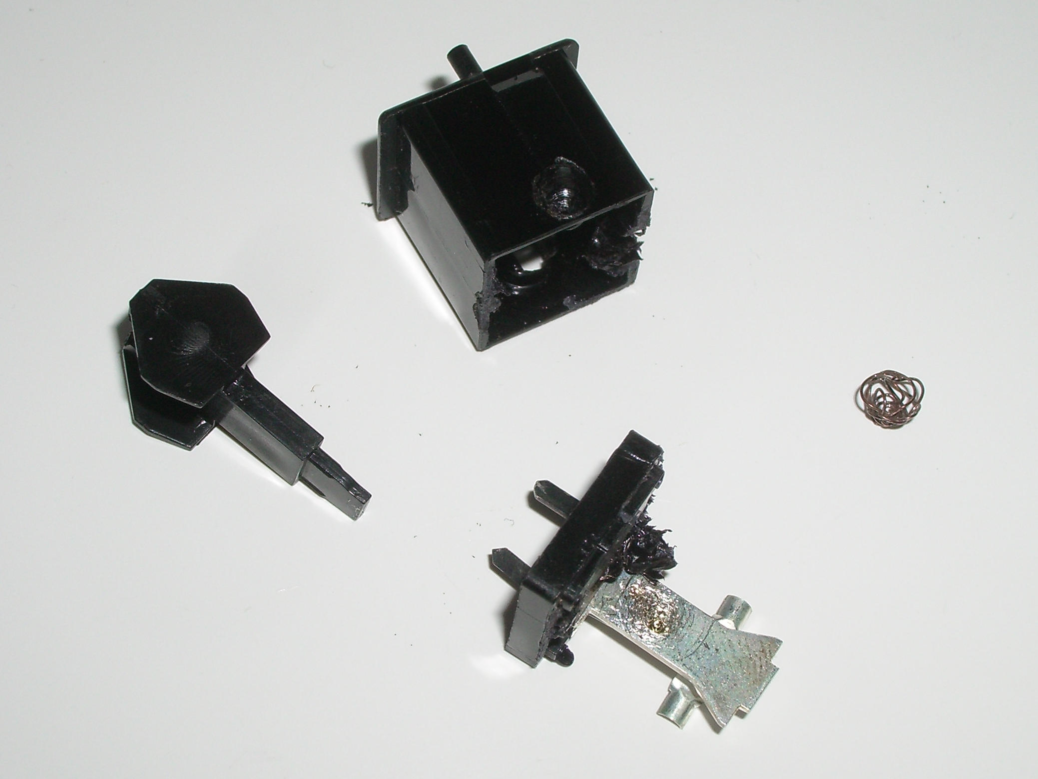

07 Feb 2013, 00:14
I don't have a saw, so I took the lonely nerd route and just hand-drilled an Electronic Surplus M6/M7 full of holes until the base flew off. (I should have just drilled into the base in the first place.)
Cherry M6 or M7 Drilled to Death.jpg (178.57 KiB) Viewed 15354 times
To avoid drilling, just wrap the switch in a cloth for grip, hold the thick leg with pliers, and pull the base off via the leg. It comes off relatively easily, but in the process you destroy whatever it is that made the base stay on in the first place. The switch will never go back together again.

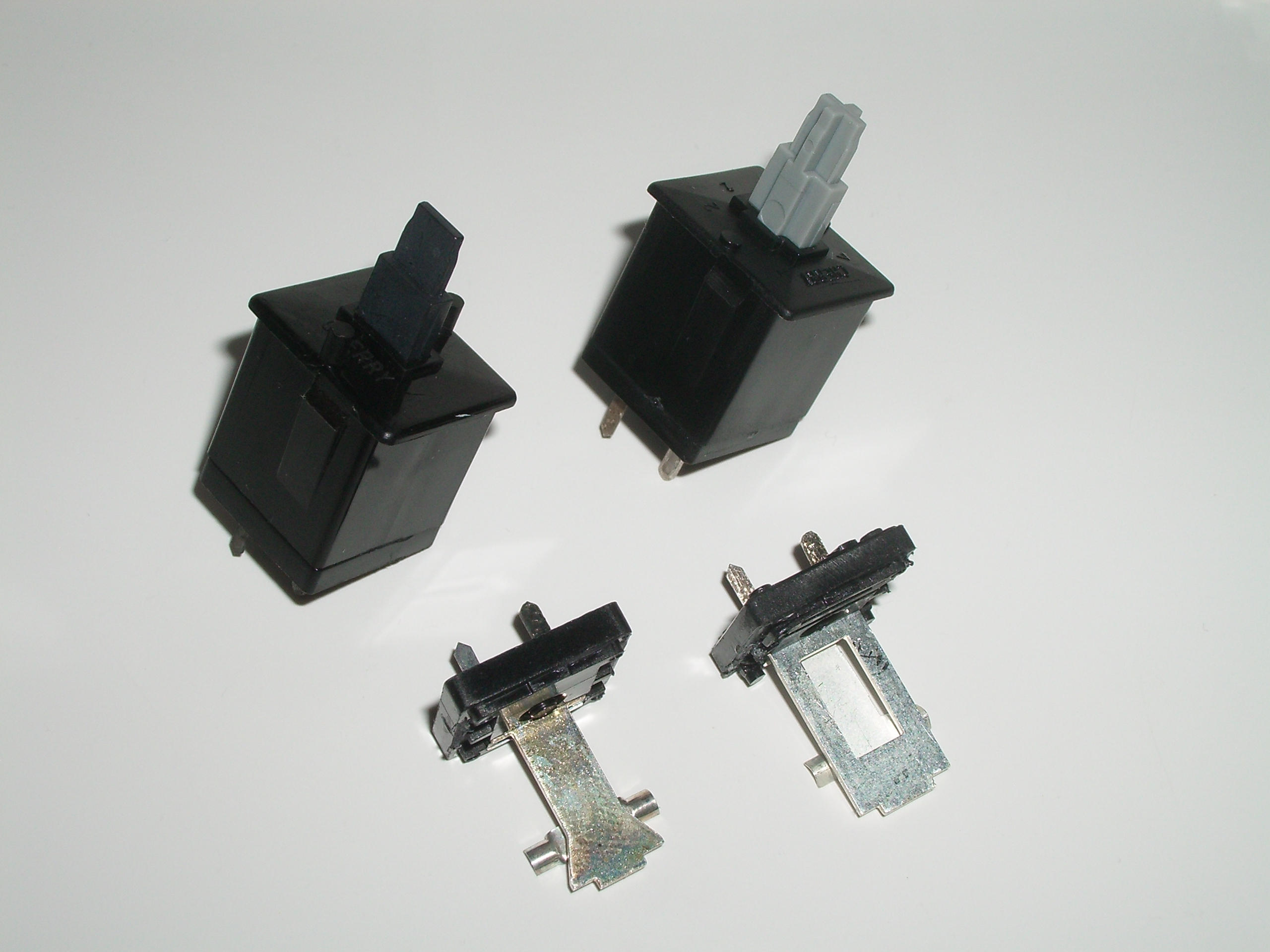

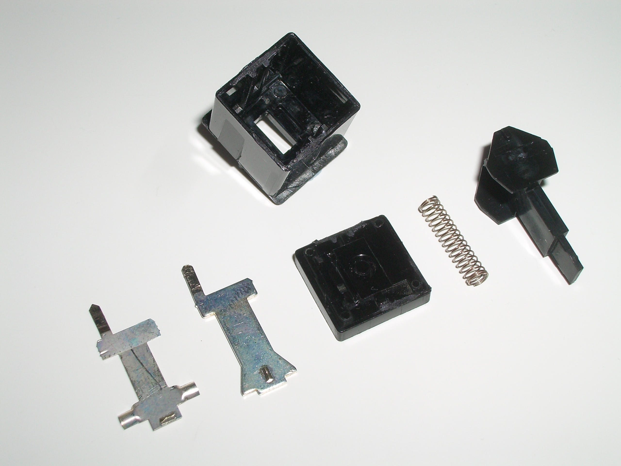

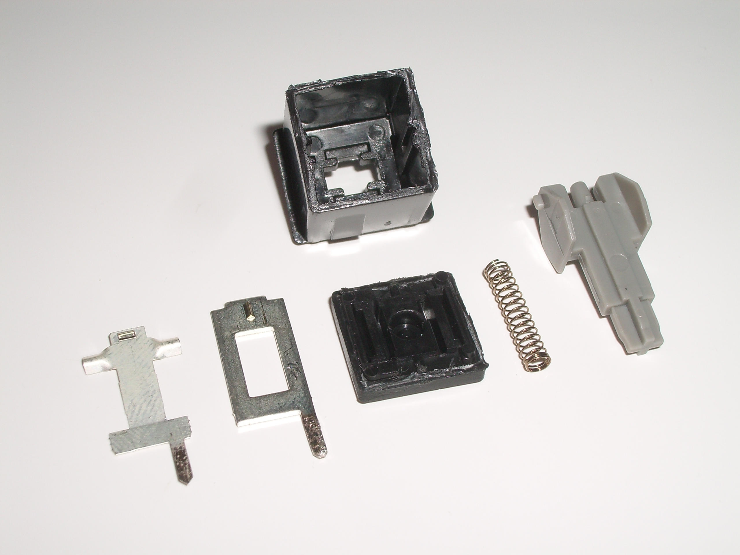

Will upload all of today's Cherry pics to the wiki later — spent all evening just photographing them. (I wasn't going to touch Cherry any further, but I specifically bought these switches for the sole purpose of analysing them.)
Black bar mount Cherry Msomething fully disassembled:
Cherry Msomething.jpg (271.33 KiB) Viewed 15064 times
Grey cross mount Cherry M7 fully disassembled:
Cherry M7.jpg (265.38 KiB) Viewed 15064 times
Comparison shot of the contact mechanisms:
Msomething vs M7.jpg (269.42 KiB) Viewed 15064 times
I got a couple of spare grey ones from ped, which meant I could sacrifice 2/3 of my greys to research!
The question is: what are the black ones? Are M6 and M7 in any way different? I don't know what to upload the black ones to the wiki as — M7? M6? I can't use "Mx" as that would be confusing ;-) Mn? Msomething?
