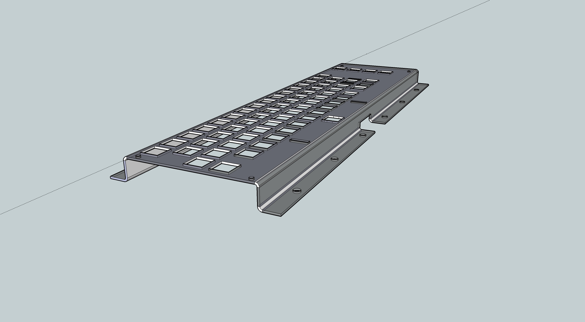

Another design idea (that was suggested in the MeC64 topic) is to have a mounting plate with bent edges. This gives a keyboard with a simple bare bones look what can look good if done right. Maybe you can put a thin plastic layer on the back of the PCB to protect it a little and against the sharp component pins. The short sides could also be bent down to for a box, that wound make it steadier and maybe look good?
This is a picture of the mounting plate in the MeC64 to show the general idea.
With this you get the benefit of just having to make one part for mounting plate and case. Bending adds an additional cost thought.
Corsair has a keyboard with the case as mounting plate http://www.corsair.com/en/vengeance-gam ... board.html
A problem I have discovered is that Aluminum is easily scratched, is a coating needed?

Anodization creates a fairly protective layer of aluminum oxide on the surface. It will by no means be scratch proof mind you, but at least more tolerant.
The problems I see with it is that in order to make the corners look decent you pretty much have to weld the flanges together, and then grind them smooth, and then user a covering paint to cover the differences in color. Other than that, the case is fairly easy to make.
I personally don't like it when the switches show though, it sort of reminds me of an idea for a case I had a very long time ago:
I suppose, since one has to weld the corner edges shut anyways, it would be easier to just not bend them and just weld the sides to the main plate. The sides could then be made to cover up the upper switch housing as well.

If you start welding than the simplicity of it is gone and you get something that is as complicated and expensive to make as a milled case, but less attractive.
I really like your milled cases and would personally rather have something like that. Are you going to make a cases that will fit the Hyper? I'll be interested in that.
