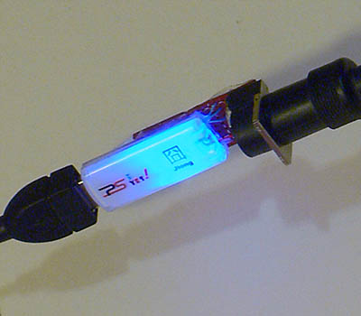

To build the smallest converter I could, I used a dongle made by TIAO:
The soldering was difficult and fiddly, and one of the dongles I got didn't work, but I did get one working very nicely in the end :)

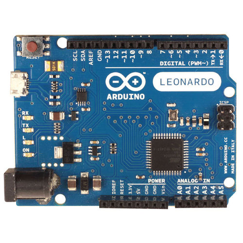

Lately the Arduino Leonardo and clones have become highly available, and while they're comparatively large, they are easy to plug bits into and experiment with.

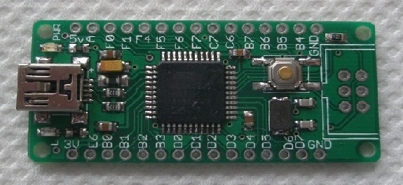

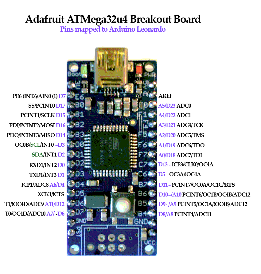

Today I spotted a breakout titled "Leonardo Nano Pro Mini ATmega32U4 ..." on eBay
This one looks quite nice - a little bigger than a Teensy, but it has a couple of nice features. The pinout is more regular, with the pins for each port mostly grouped together, so it would be nicer to use for a replacement keyboard controller. Also, it has mounting holes, so it should be easier to secure inside a project box, without having to first solder it to some stripboard.

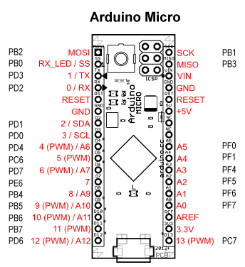

There was an official leonardo mini introduced a few days ago. I don't know if it's the same layout and dimensions of the one you posted.
More info about it can be found on the arduino-site.
http://arduino.cc/en/Main/ArduinoBoardMicro

I hadn't heard about that one... how timely this thread is!!
Interesting board - the dimensions look similar to the one I posted, and it has mounting holes. The pinout is different, but that's good - more choice for us!
I get the feeling that with Leonardo, and now the micro, we'll get quite a few clones and near-clones coming out.
edit: Couldn't find a pinout showing the AVR pin designations, so I knocked one up (beware possible errors!)...
PB0, PD5 and PC7 have LEDs attached to them, which could limit their use for other purposes. Or could be useful!

I use this board recently apart from Teensy. Its size is same width(600mil?) but 4pins longer than Teensy and I like its cleaner pinouts of PORTB and D. I think it is available only in Japan unfortunately.

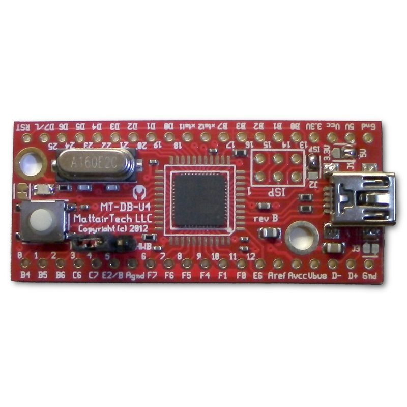

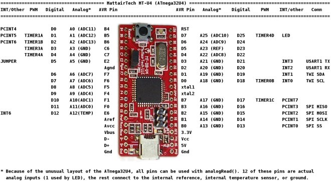

JBert wrote:BTW: Did somebody find a clone with through-holes just between the USB socket and controller to solder an USB cable to the board?

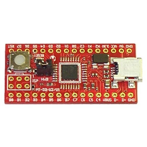

There's one by MattairTech that has the USB D- and D+ connections broken out: the MT-DB-U4. Currently also on eBay as "ATmega32U4 Atmel USB AVR Arduino compat. DAQ development board data acquisition".
Looks pretty good, and a good price :) Teensy++ sized, same as a 40-pin DIL.

I used a PS3 jailbreak dongle for an XT converter once. Under $10 for an AT90USB162 with HWB button and two LEDs. Soldering wires onto TQFP pins is not my idea of fun, though.
XT to USB adapter built on a PS3 dongle.

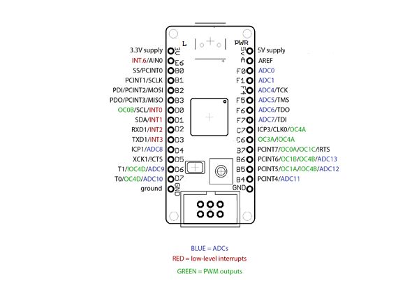

The "Leonardo Nano Pro Mini ATmega32U4 ..." on eBay mentioned in the first post appears to be using the adafruit design. Here's the adafruit board's pinout:
The attachment MT-DB-U4_arduino_pinout_660.jpg is no longer available
They also have a similar board for the 32u2. I bought a couple of these already. I like that they unlike the Teensies have external access to all pins, dedicated ISP headers, and a lot more jumper configurations. They lack room for a voltage regulator, but I guess that could just as well be placed on it's own somewhere.
They seem to have updated the board layout slightly for the 32u4 board as well. I think I'm going to get a couple of them as well =)
