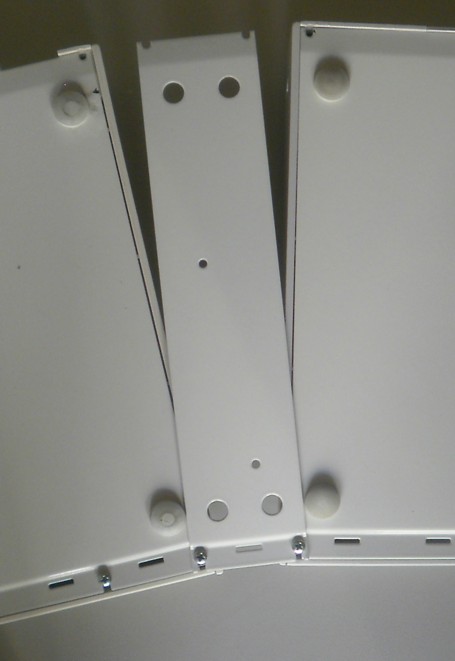

I have card reader actually, But I wanted it to be wedgeshaped to create a difference in angle between them. I Tipro block which is wider closer to you and thinner further away. i guess I could cut the card reader, remove a wedge from it and then glue it back together. I think I made myself unclear. When I said wedge, I meant a wedge as seen froma bove, not the general wedge shape that they have when seen from the side. I sort of want it too look like this from above.
/____\
Posted: 21 Aug 2012, 08:59
by Icarium
But why do you want them connected if you could have two parts that you can move separately?
Posted: 21 Aug 2012, 10:03
by kbdfr
Now I understand what you mean :idea:
No, there is no such triangular joiner.
Quick'n dirty solution:
