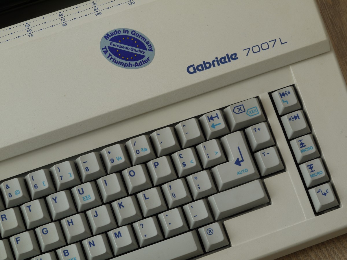

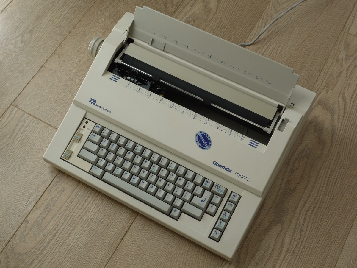

I've recently found a Triumph+Adler Gabriele 7007L electric typewriter in a shed on a garden party and I just knew that the caps had to be Cherry MX compatible. And gorgeous caps they were: thick PBT dye-subbed ones. Dark blue lettering on light grey with light blue alternative legends.
The space bar wouldn't fit on modern keyboards and the modifier keys of a typewriter obviously are different from computer keyboards. Besides that, the key spacing seems to be different so there is a slightly larger gap between the keys. Furthermore, the caps are in genuine Dutch layout :)
Gabriele 7007L (Dutch)
Close up
Close up

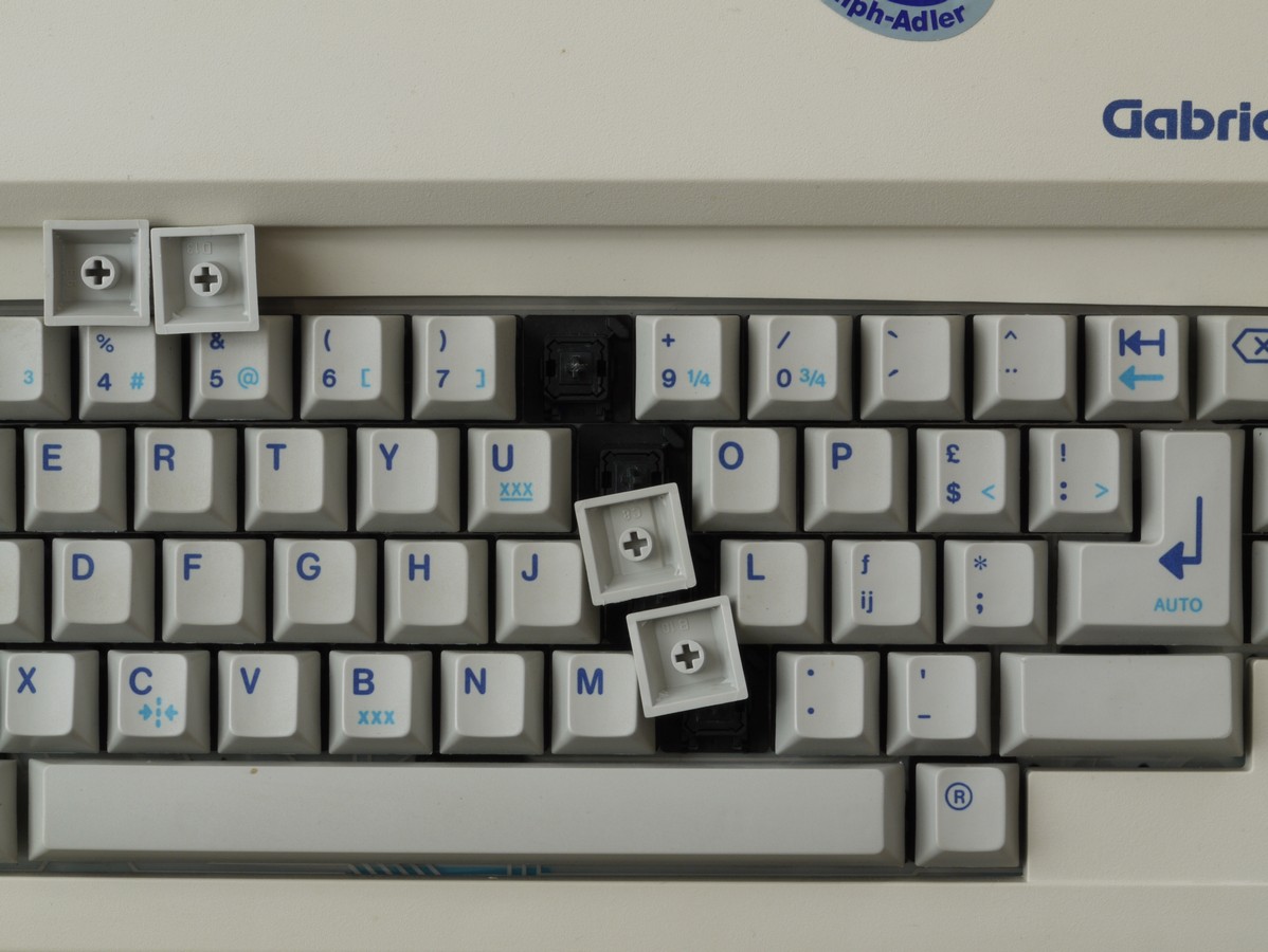

Thick caps.<br />MY-like switches but with higher resistance.
Thick caps.

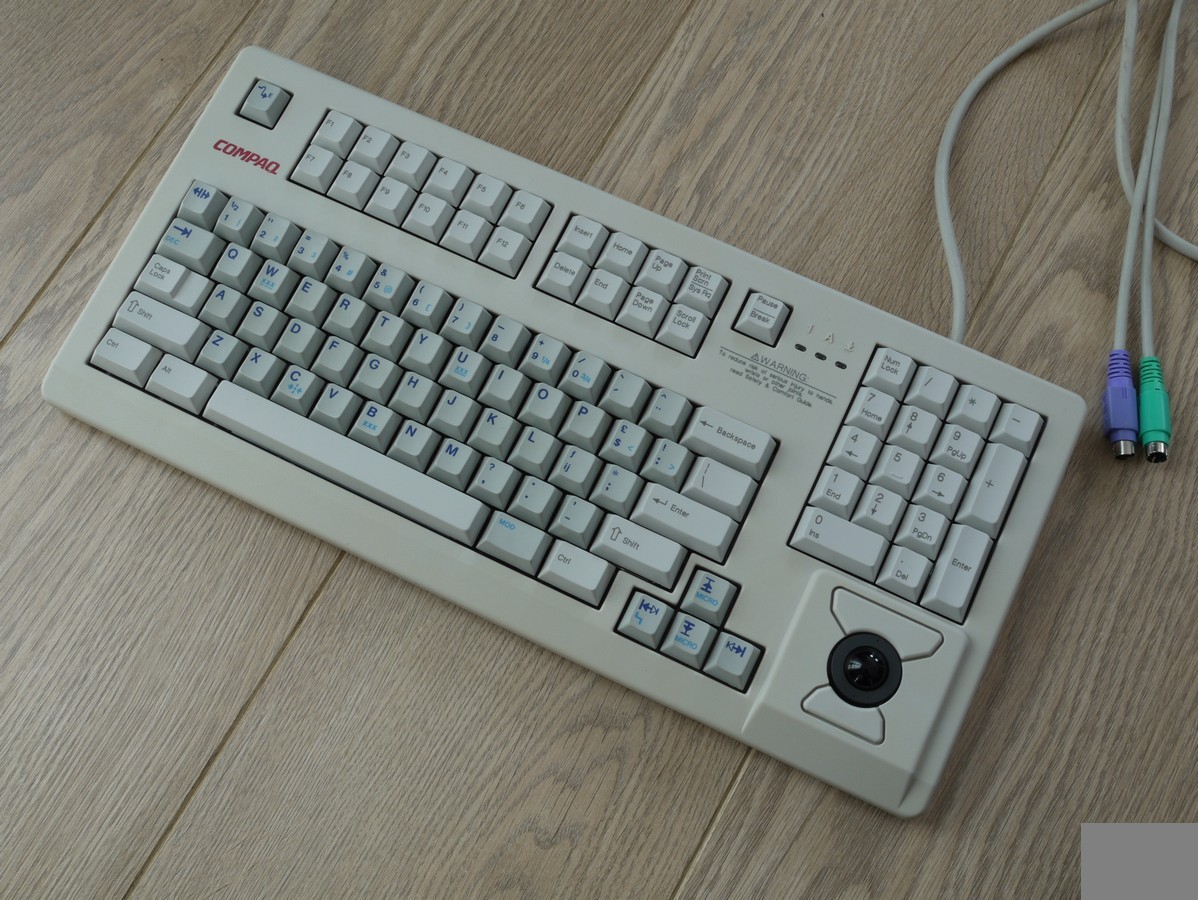

Here's how they look on a MX11800 board. There might be keyboards that look prettier and have better matching colour schemes but this was the best fit available to me.
Caps on MX11800
Caps on MX11800

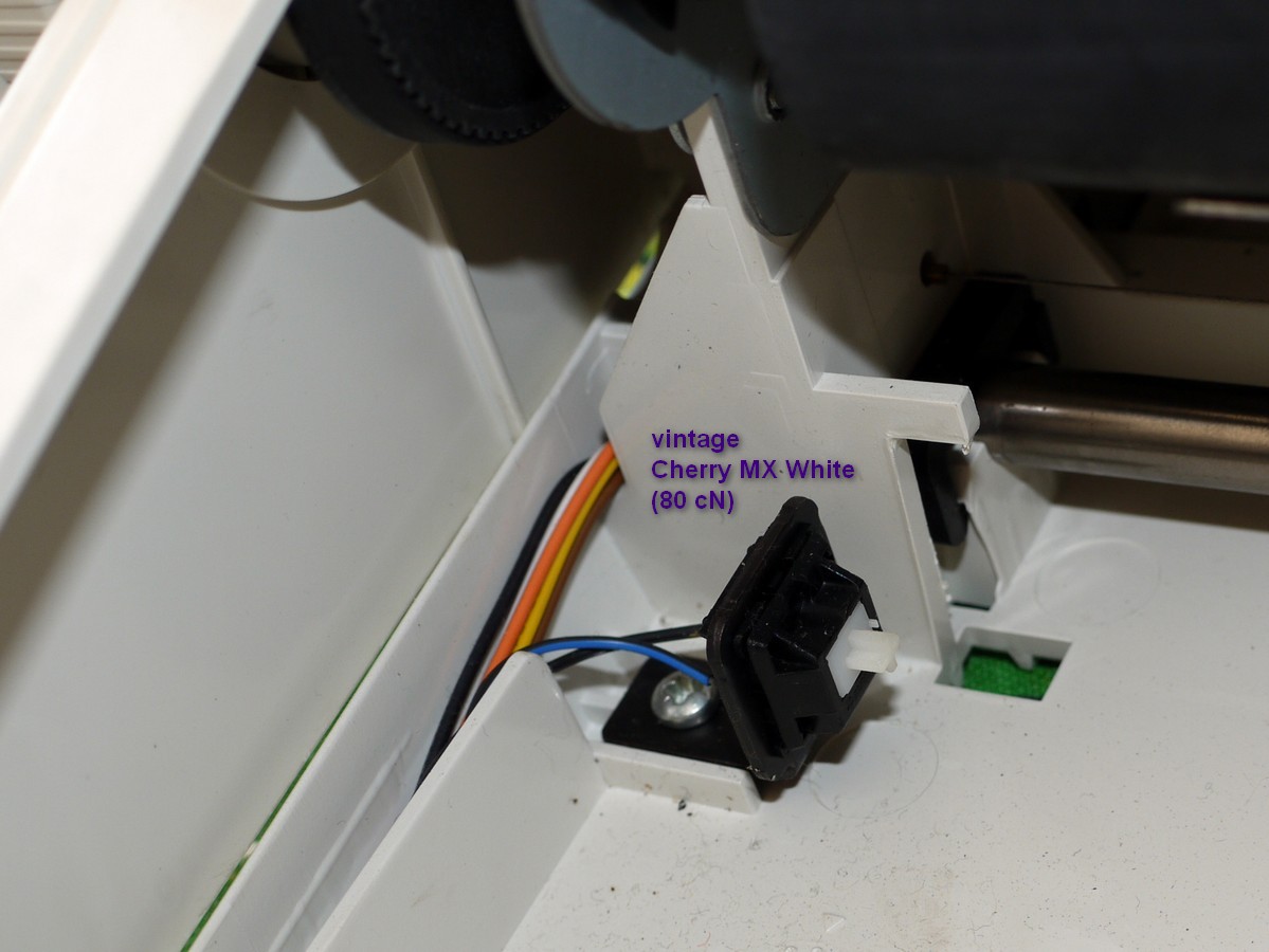

A Cherry surprise hidden in the guts of the typewriter: A vintage MX White (80 cN).
Surprise!
Surprise!

Spharx wrote:I knew it ! Some moths ago I wanted to buy one of the T+A electrical typewriters too just to see if the caps would be of any value for my keyboards.
Can the two keycaps below the tab cap be used to replace Caps and ANSI Shift ?
The blank 1.75 u key can replace a center-stemmed CapsLock but the 2.25 u blanks won't fit on the left Cherry ANSI shift mounts. They do have three mounting points but the outer two are separated by ~26.1 mm while normal ANSI left shift mounting points are separated by 23.8 mm. Some weird imperial measures for sure (23.8 mm is very close to 15/16 inch). But there is hope: it should be possible to mount them on costar stabilizers if you shorten the ends of the stabilizing bar a bit.
Spharx wrote:What is the purpose of the white mx switch ?
The MX switch is getting activated if the typewheel sledge hits the left side of the typewriter after pressing carriage return.
